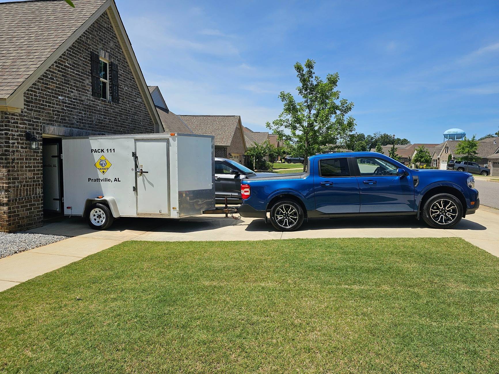

IMHO, If you need to tow a large camper, the Maverick is likely not for you. It is more useful pulled behind a camper than in front of one. However, I think the one asked about in the OP would be fine.
There are classes of trailer and what you see below would be what I personally would consider be the upper limit. Anything larger would need a larger vehicle. Can Maverick tow it? Probably. Do I recommend it? I don't.
Ford Maverick 4K tow package pulling an RV 20240608_111839
