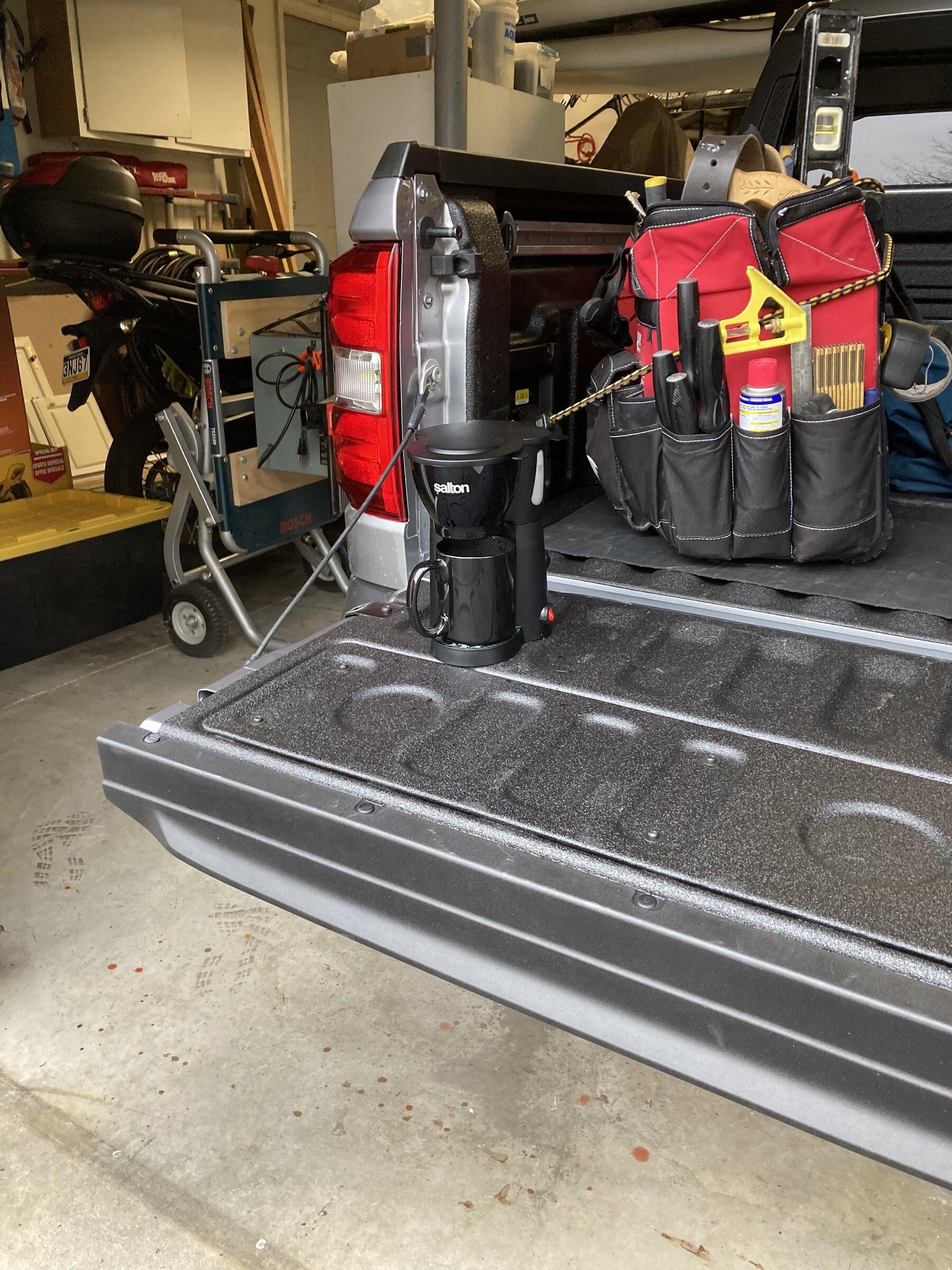

I did a lot of online searching for coffee makers that meet the 400W threshold. I found a single cup brew model online at Walmart that reportedly draws exactly 400 watts. I could not find any multi cup versions under 400w. I purchased and found the stamping on the bottom indicate only 350 watts and so it definitely meets the requirements. I did a test brew and it worked okay and will use for camping/tailgating. See pics below of model and test.
Walmart Canada list it at 300w, either way I'm grabbing one of these!

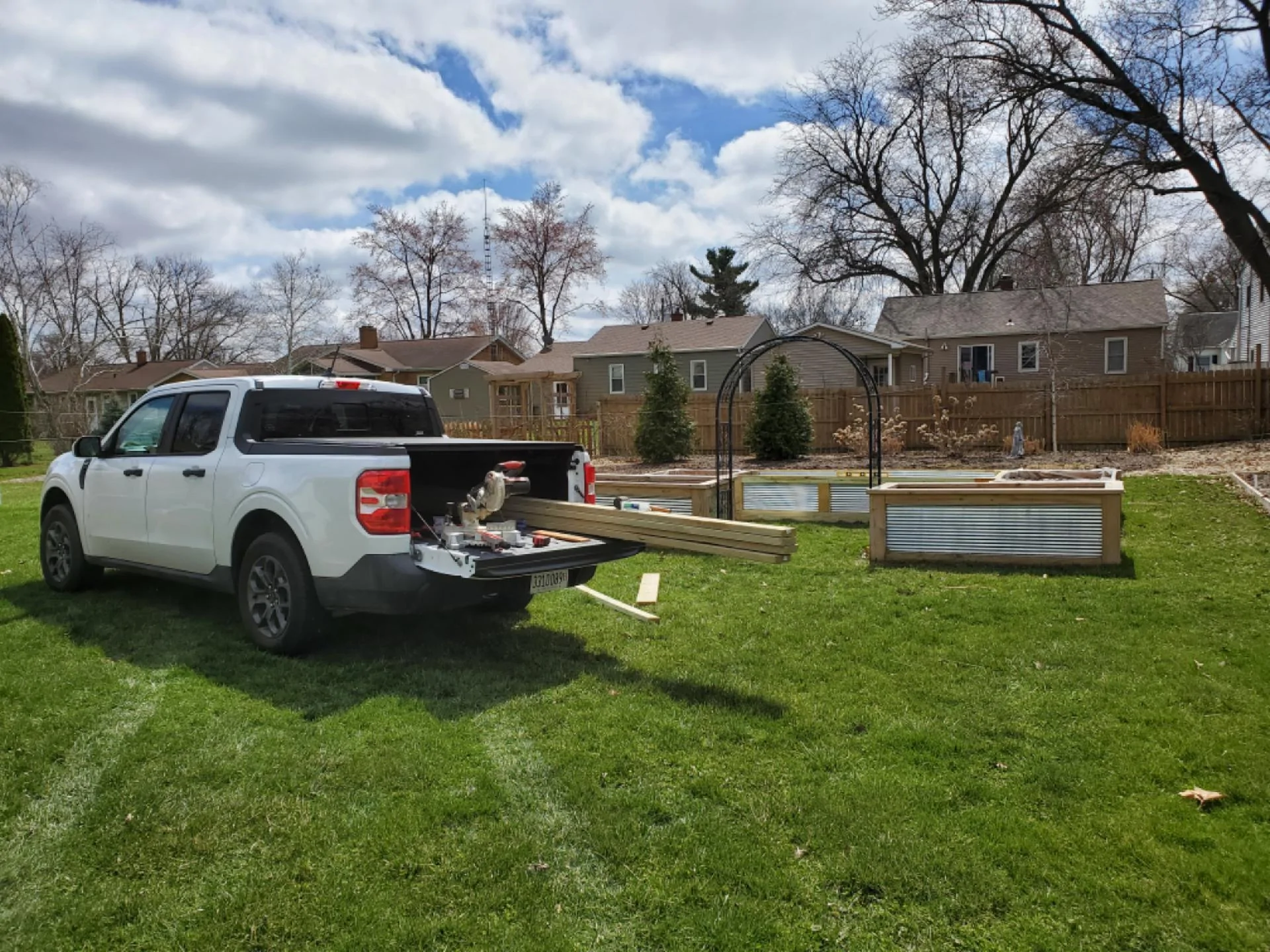

While it can't run a miter saw or even a circular saw it can charge your batteries while tackling a project that requires those tools. Ask me how I know....
