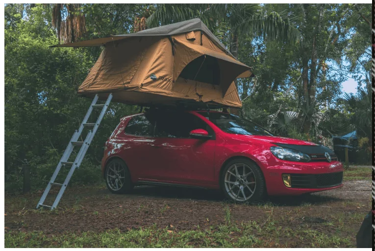

I have seen many people install roof top tents over the bed of their Mavericks but none over the cab. I ride mountain bikes and dirtbikes and would like to keep the bed open as much as possible. I could maybe understand concerns on roof strength compared to a Tacoma ect... but I kind of doubt it as the Mav is a modern vehicle with roll over strength and roof strength built into it. My previous ride was a VW GTI and people put tents on those all the time seemingly with no issue. Could anybody recommend a roof bar and tent set up to accomplish this? Thanks!
