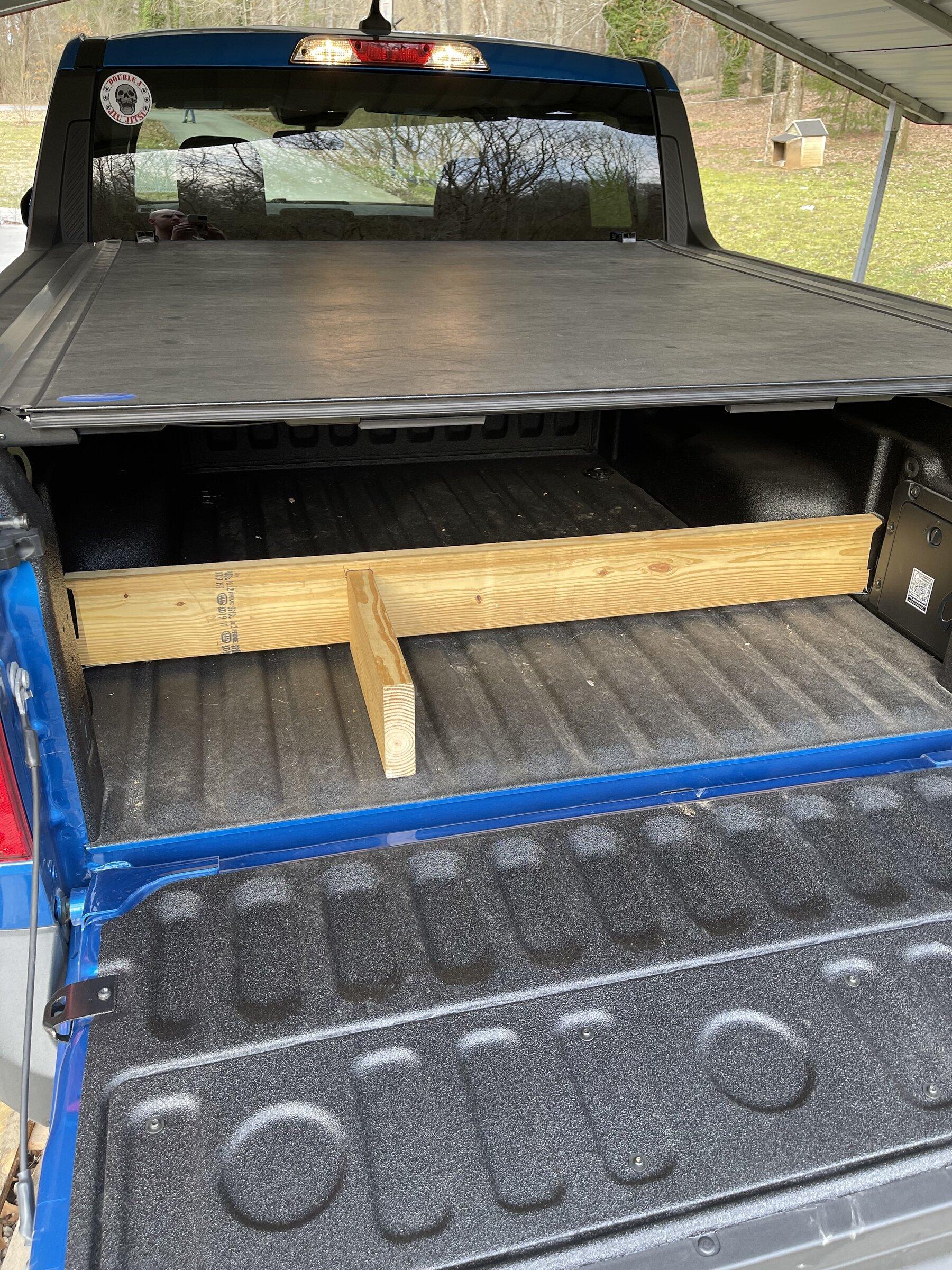

2x6 at 54 1/4. It fits, I just think I want a taller one. Maybe 2x10? Might just stack a 2x4 over it. Don't know yet. Anyways, just sharing in case anyone wanted to see the 2x6 specifically. Going to paint whatever I use a matte black or maybe some type of bed liner spray if I can find some.

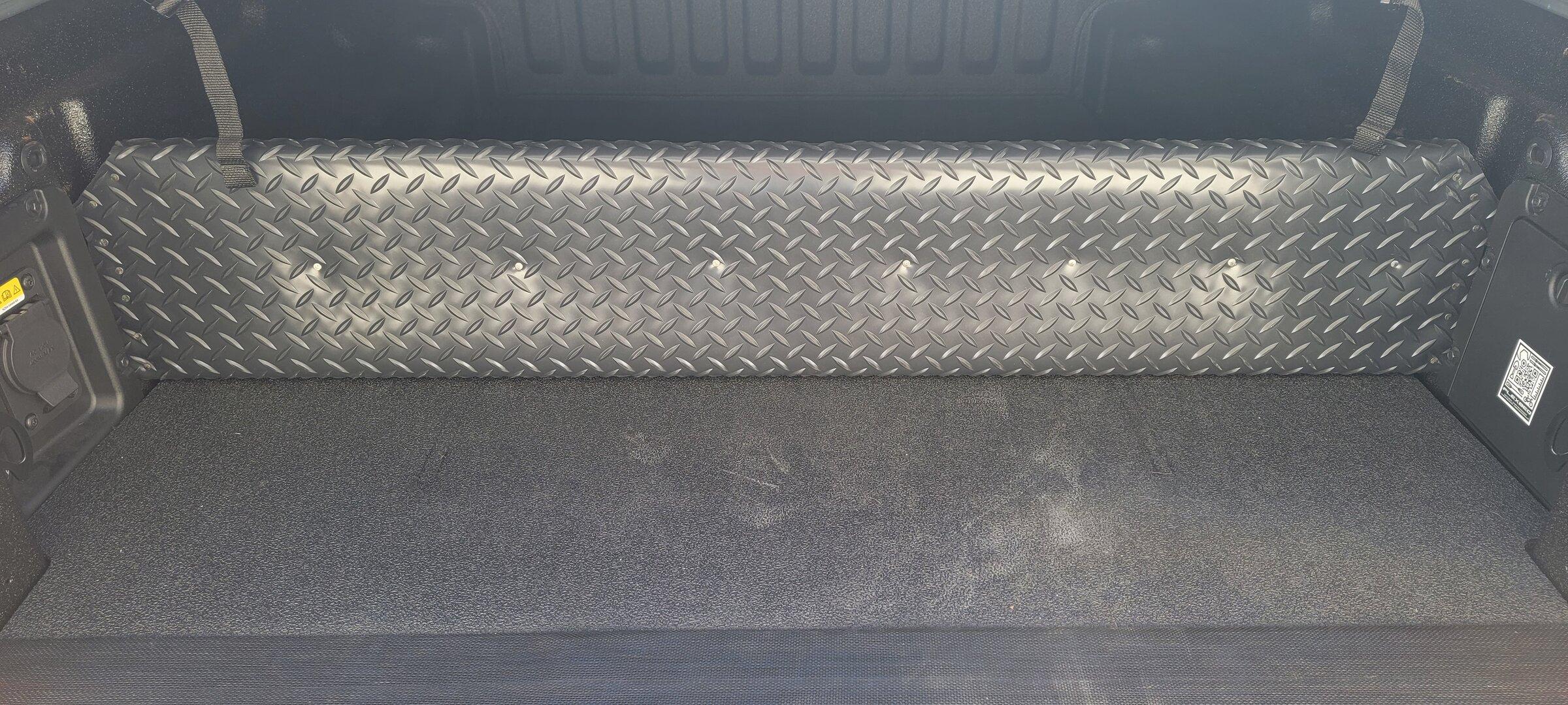

I did a 2x10, angle on top corners to clear bed/bed cover, a tight fit into slot. I wrapped the Board with floor rubber matting. No noise at all. Decent look. Those are nails that you see. I put spray adhesive under it, but its not strong enough to be permanent.

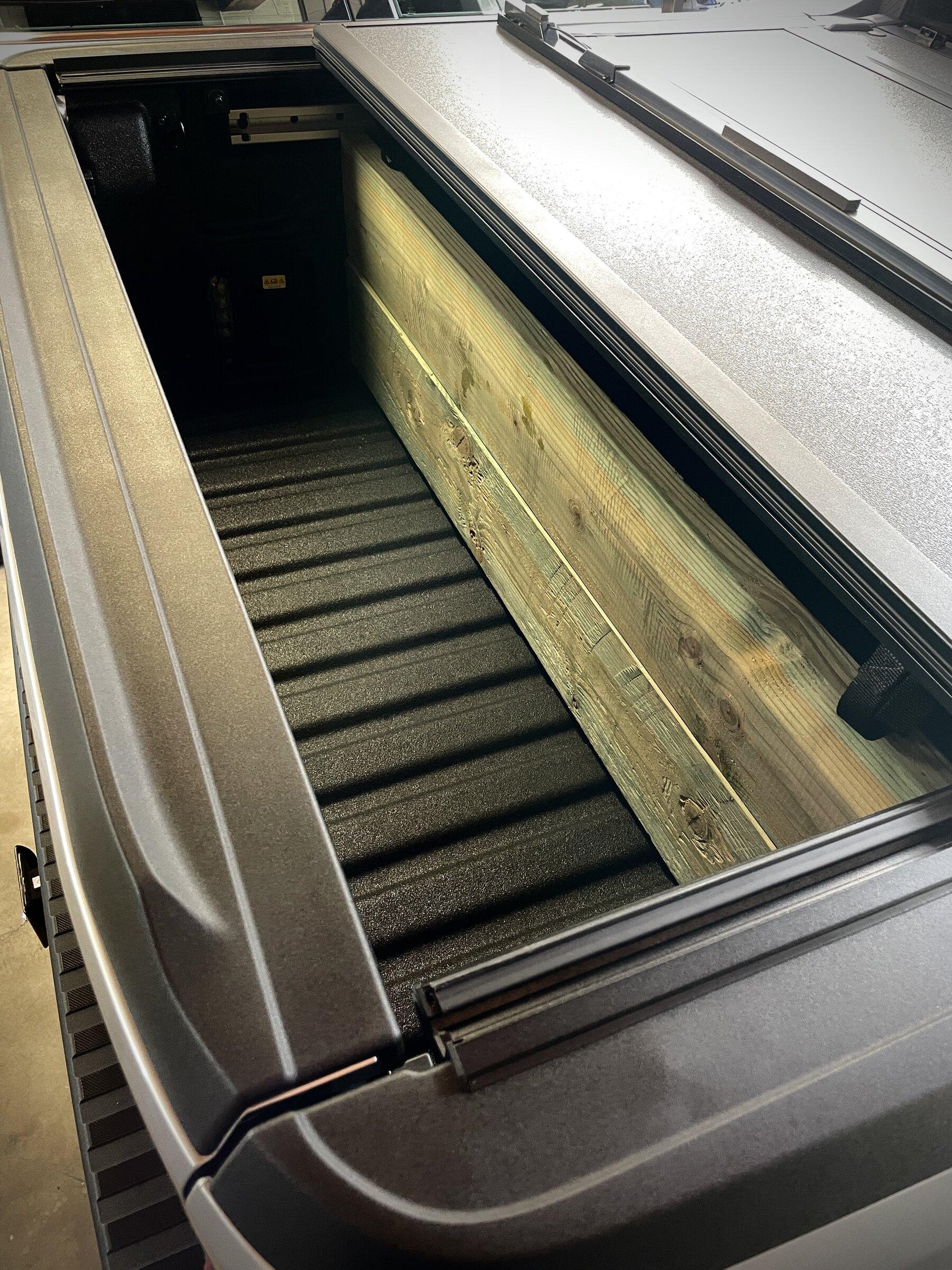

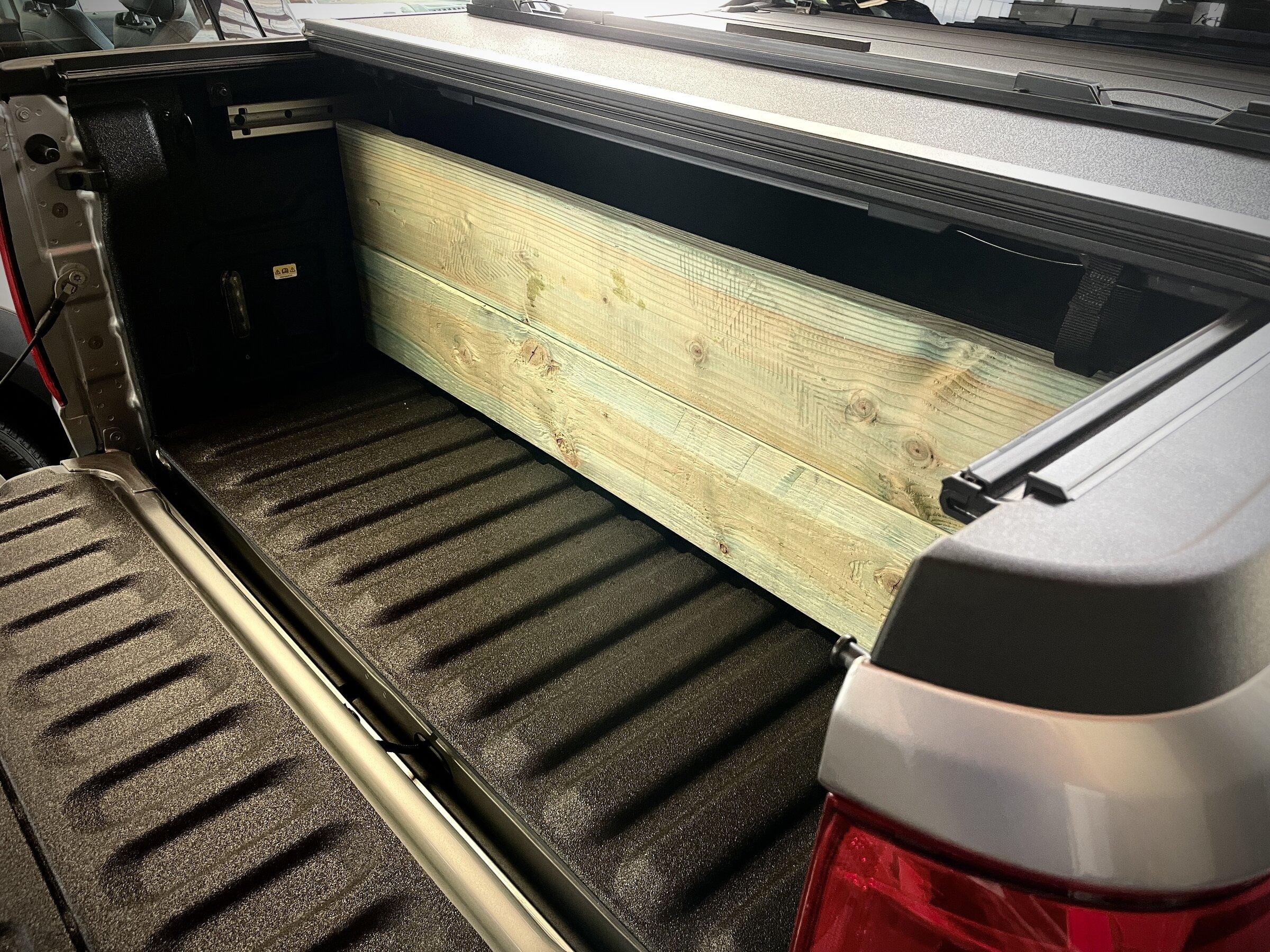

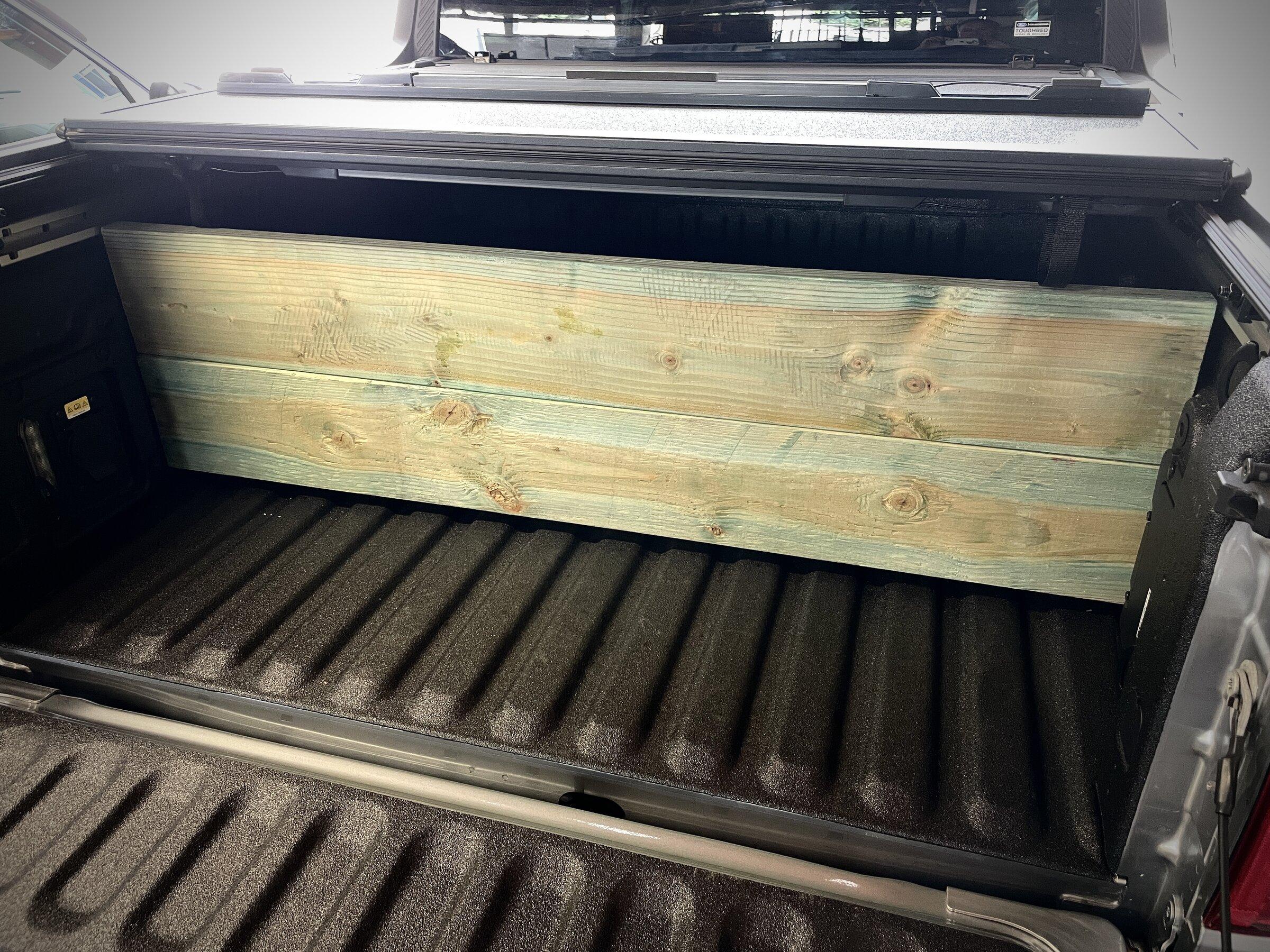

2-2x8s work perfectly with my BAK Flip MX4 tonneau cover. The two pieces are jointed together with Velcro strips and will be painted black. Confirmed that cut length is precisely 54-1/4”.

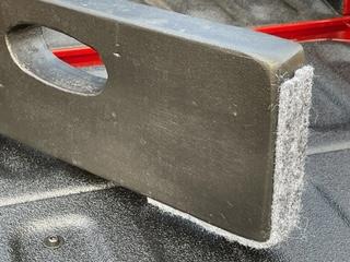

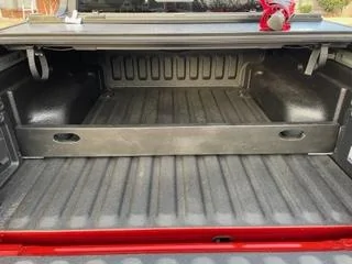

2 x 6 with handles cut out and sprayed with Rustoleum bed liner. Added felt pads on ends to keep snug.
