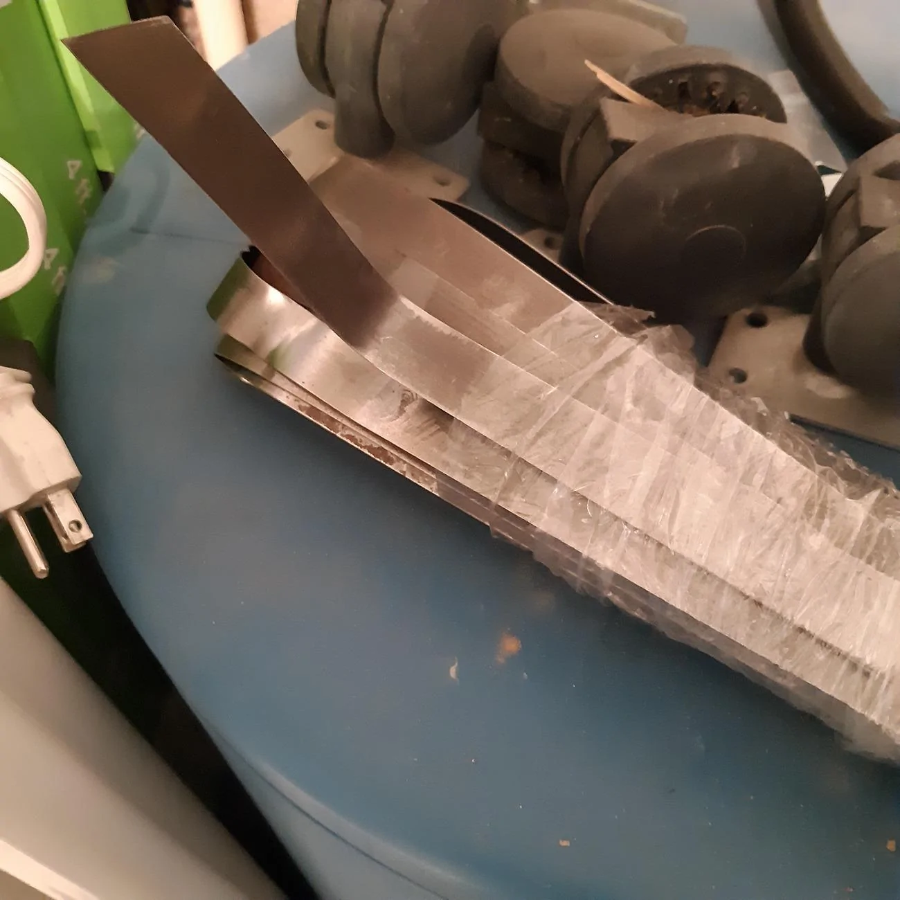

I used large piece of cardboard, and a pencil and magic marker for the template and I kind of eyeballed it. I used steel strapping, that I pulled out of my trash, for the curve around the wheel well transferred that to the cardboard with the magic marker.

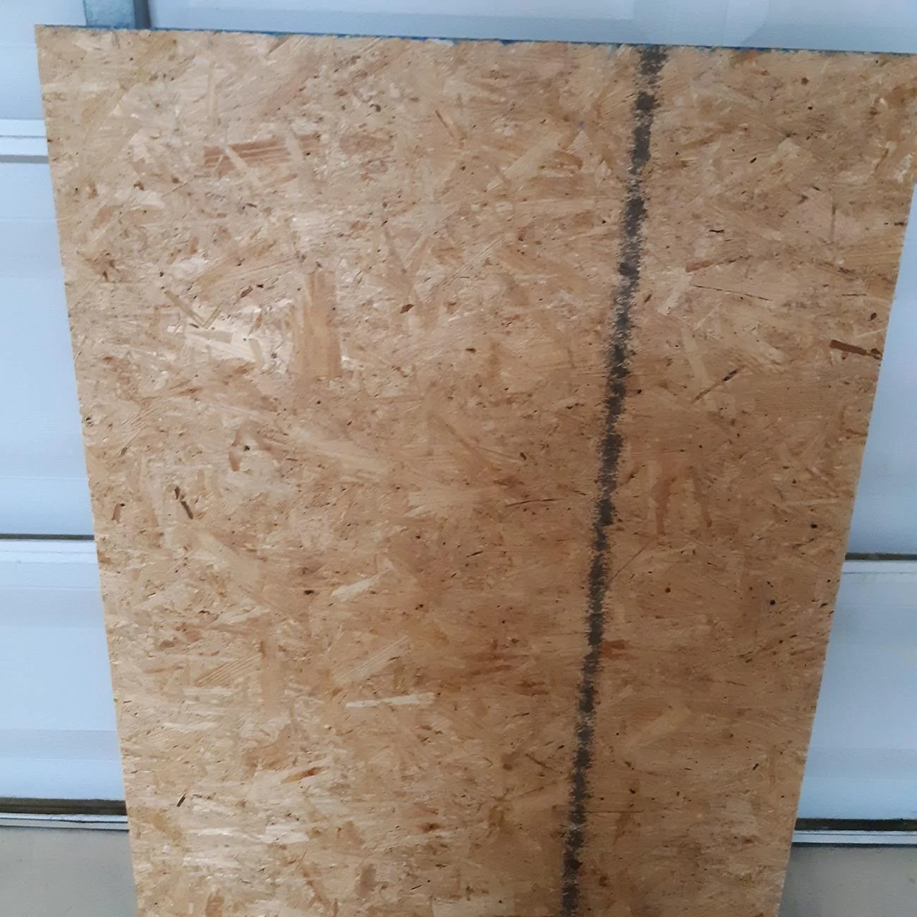

I transferred that, to the particle board. I wanted to use plywood because it was lighter.
I wasn't going to pay the price they wanted for sheet of plywood. I saw a piece of particle board that was already missing two feet so Home Depot sold it to me for $8.50. It was originally over $17

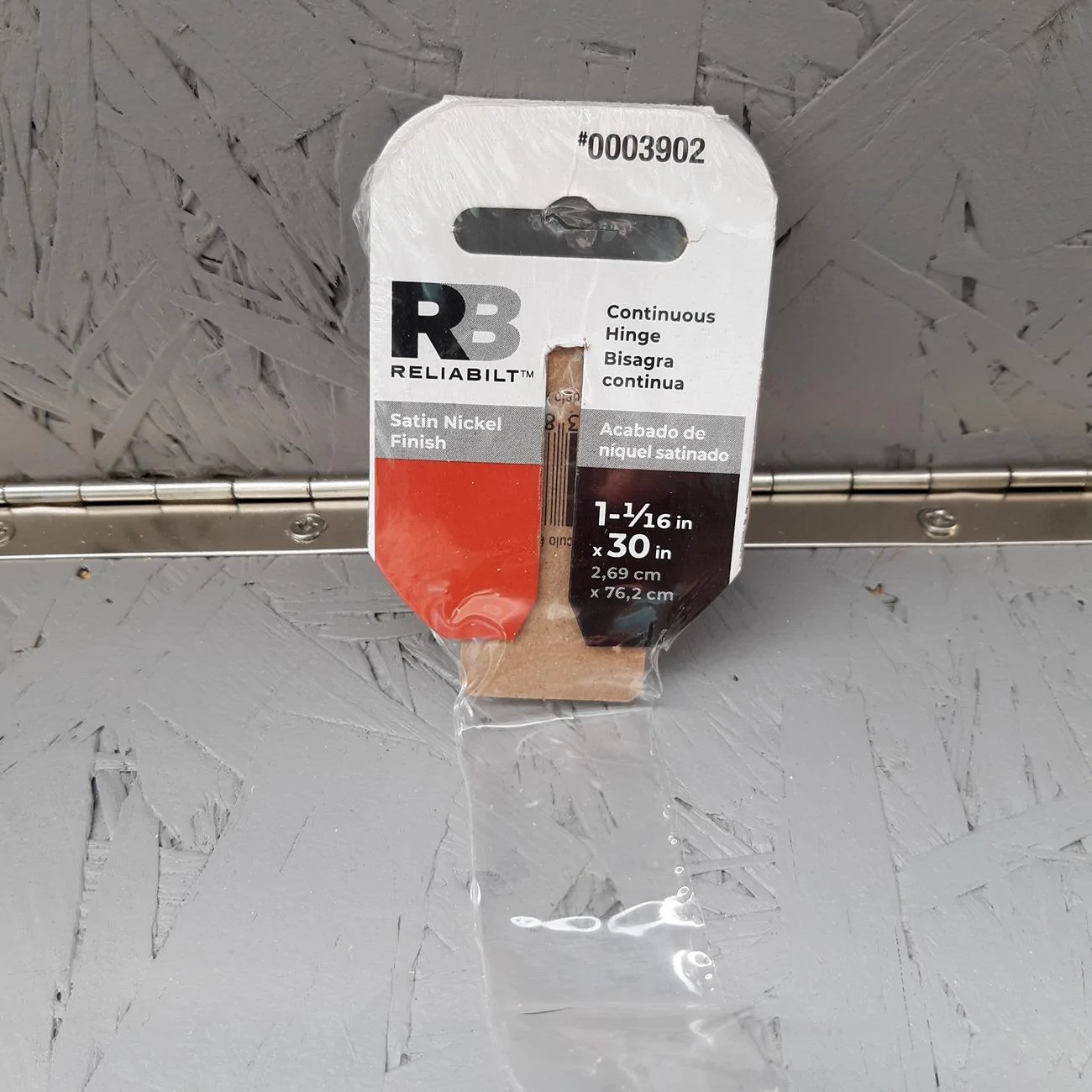

I honestly couldn't tell you the thickness. I looked at it and thought it'd work. I bought the piano hinge at Lowe's it was about $10. The steel rod that I used to make the support brackets I bought that also at Lowe's was $2.50. The paint was $2 one of those samples or whatever that people didn't want.

The hinge
Ford Maverick Beyond the 2x6. Increase the usability of your Maverick's Bed. 20240721_172547
The strapping I use to make the shape of the wheel well
Ford Maverick Beyond the 2x6. Increase the usability of your Maverick's Bed. 20240721_172731
Leftover particle board
