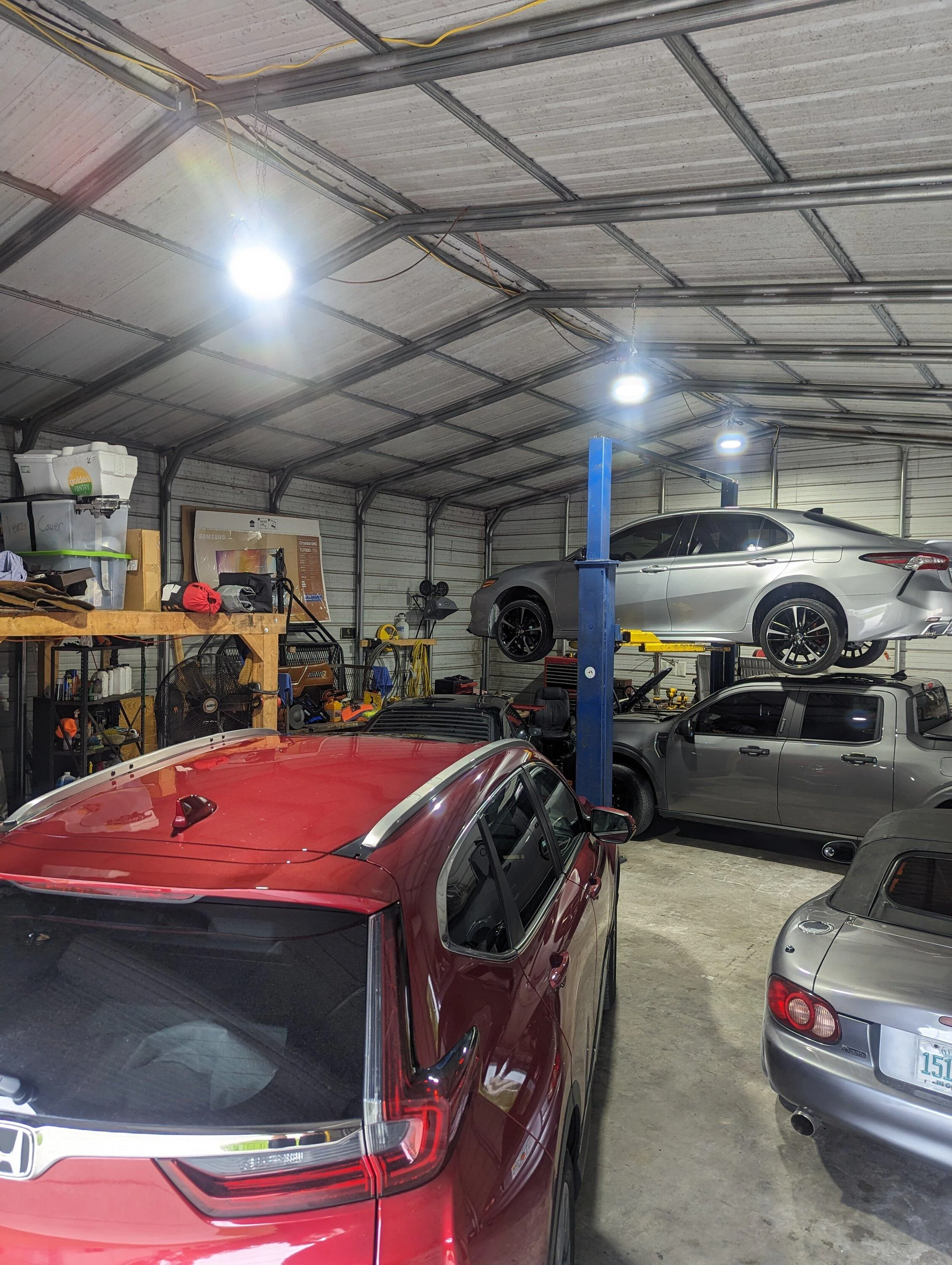

My wife's Maverick is AWD and has the FX4 package and yes, there are a lot of bolts and fasteners on that skid plate but I have a shop with a lift behind my house so it is somewhat easier to deal with the skid plates.
