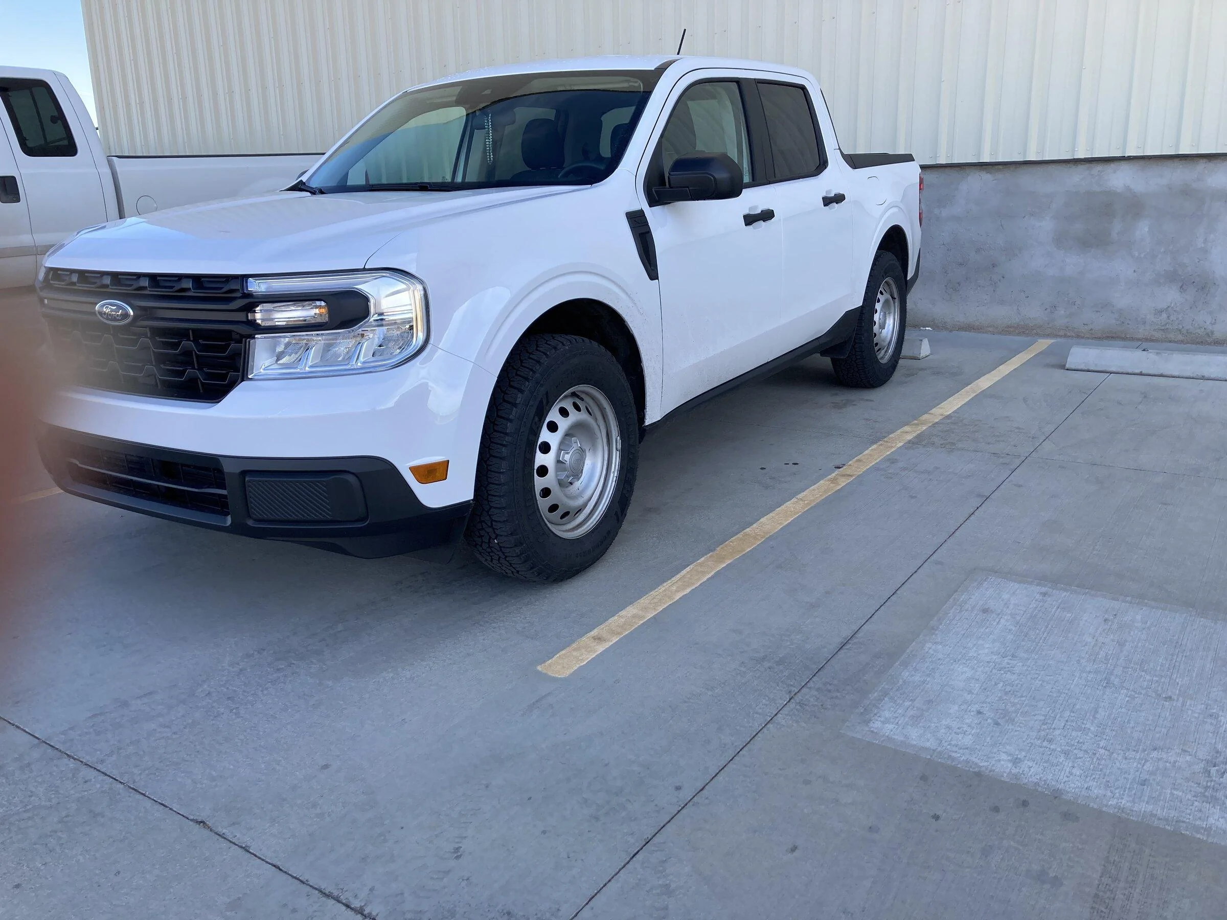

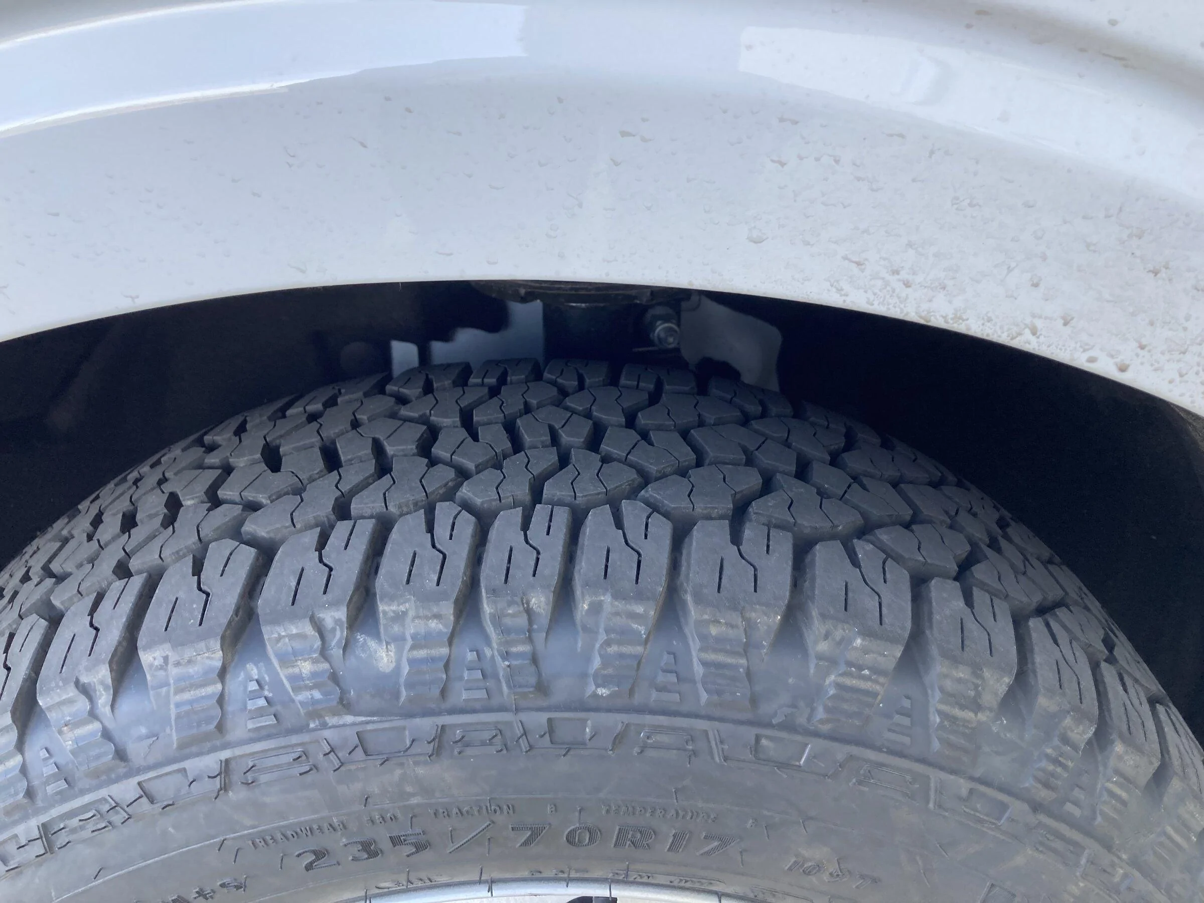

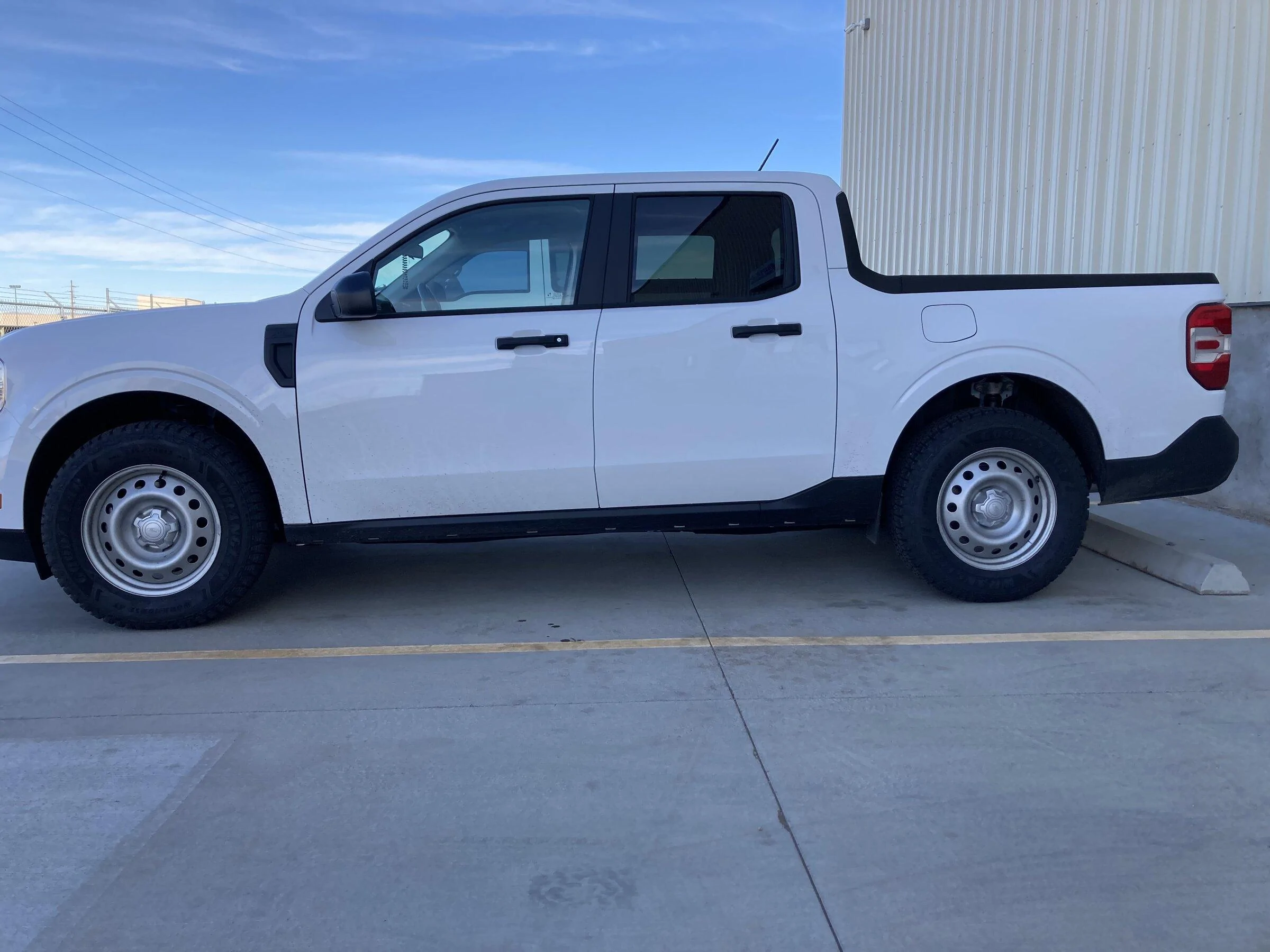

So what am I missing? Why has no one done a 235/70R17? Seems like there might be some advantages.
I've yet to see anyone on the forum post pictures of a 235/70R17 tire on a Maverick. I'm looking for a more aggressive tire that would be good in the snow.

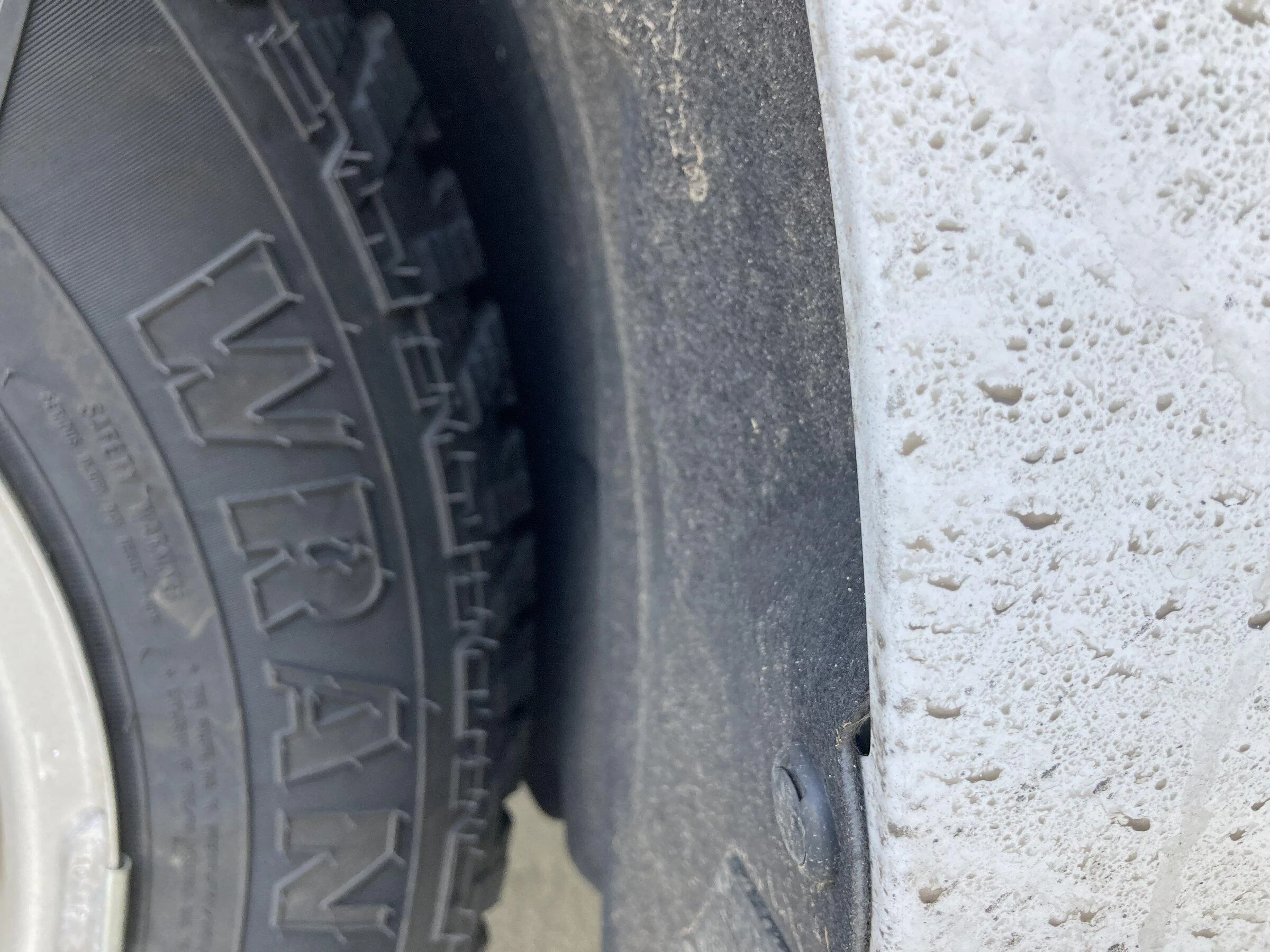

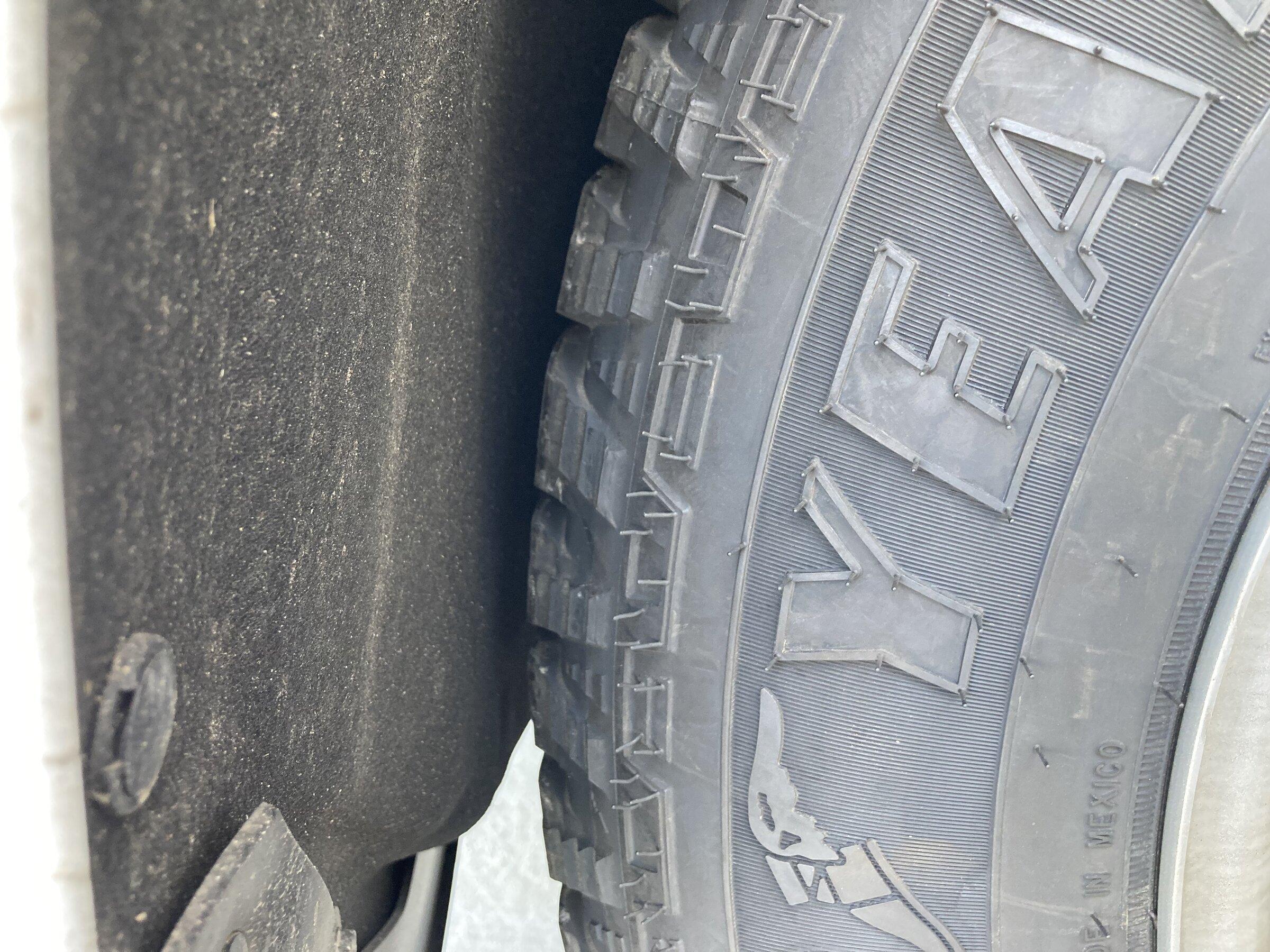

It seems like a 235/70R17 might fit without a lift and likely wouldn't rub, would offer more ground clearance than a 245/65, would give less rolling resistance and could be up to 6 pounds lighter for better MPG and a little smoother ride?
Wrangler Workhorse AT 235/70R17 Diameter 30" Width 9.4" 697 Revolutions per mile / 33lbs
Falken Wildpeak AT3W 245/65R17 Diameter 29.5" Width 9.7" 719 Revolutions per mile / 39lbs
My stock tire - Pirelli Scorpion AT + 225/65R17 Diameter 28.5" Width 8.9" 729 Revolutions per mile / 31 lbs
