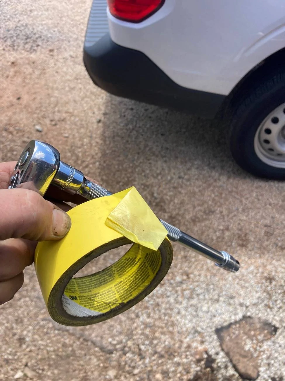

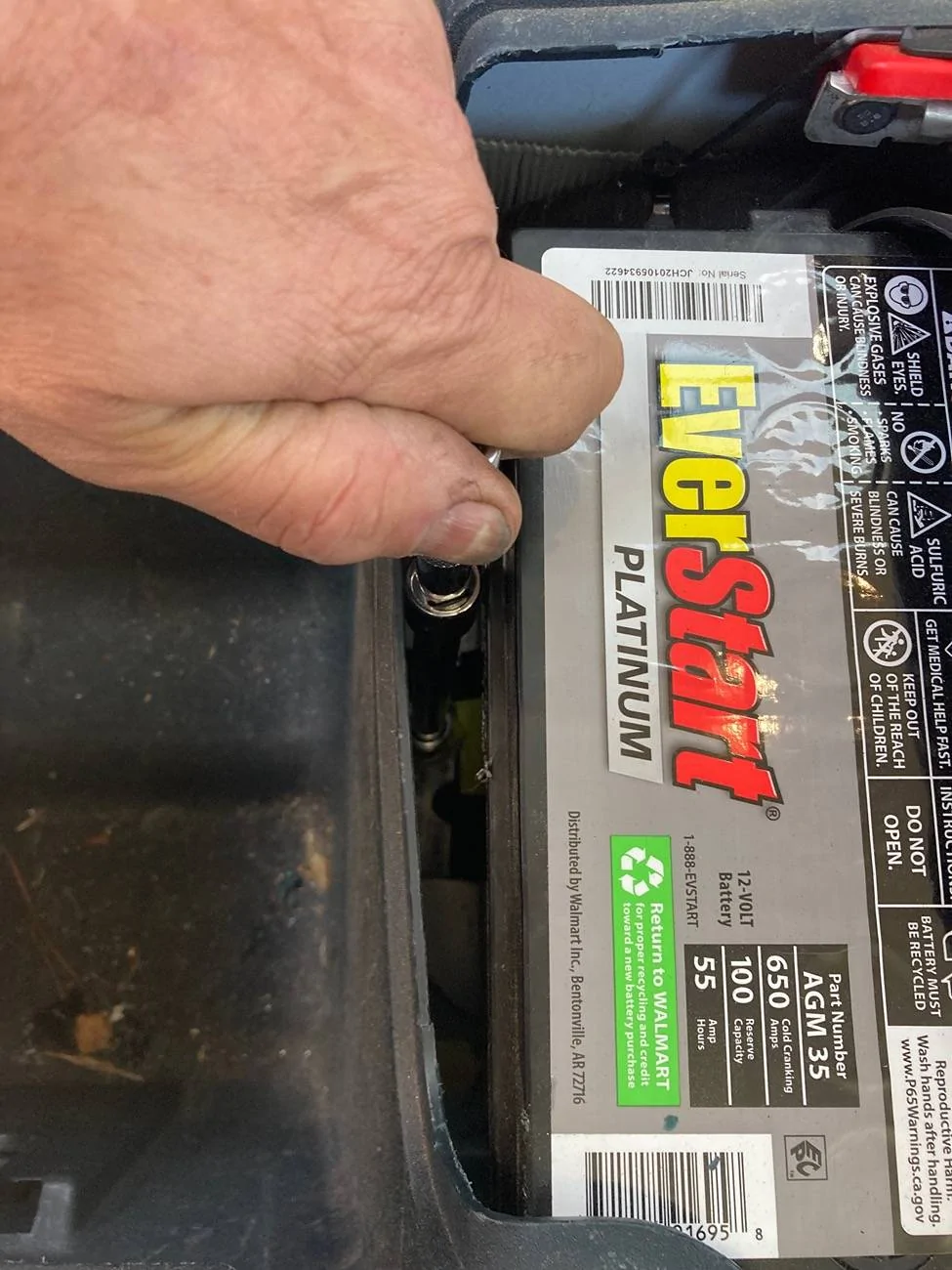

No, it's not. I used a long 10mm T handle with a magnet stuck on it to remove and replace the hold down bolt, but a long extension will do (might need a long and short together). Trickiest part is removing the plastic cover on the positive terminal. 5 min. job, no need to pull the plastic panels for an original dimension replacement battery.

Why did you remove all the underseat trim panels? The replacement is easily done with a 10mm socket on a (say) 12" extension with a bit of tape in the socket to pull the bolt out. Its literally a 5-minute job and the mandatory full charge and BMS reset takes a lot longer.

I followed this guide and did it in around 10 minutes, using a magnet to retrieve the bottom fastener, and a piece of tape to hold it on the extension for re-install.
I would not be removing plastic trim pieces if at all possible. Pretty easy to break stuff, and it often doesn't go back together perfectly / snugly.
