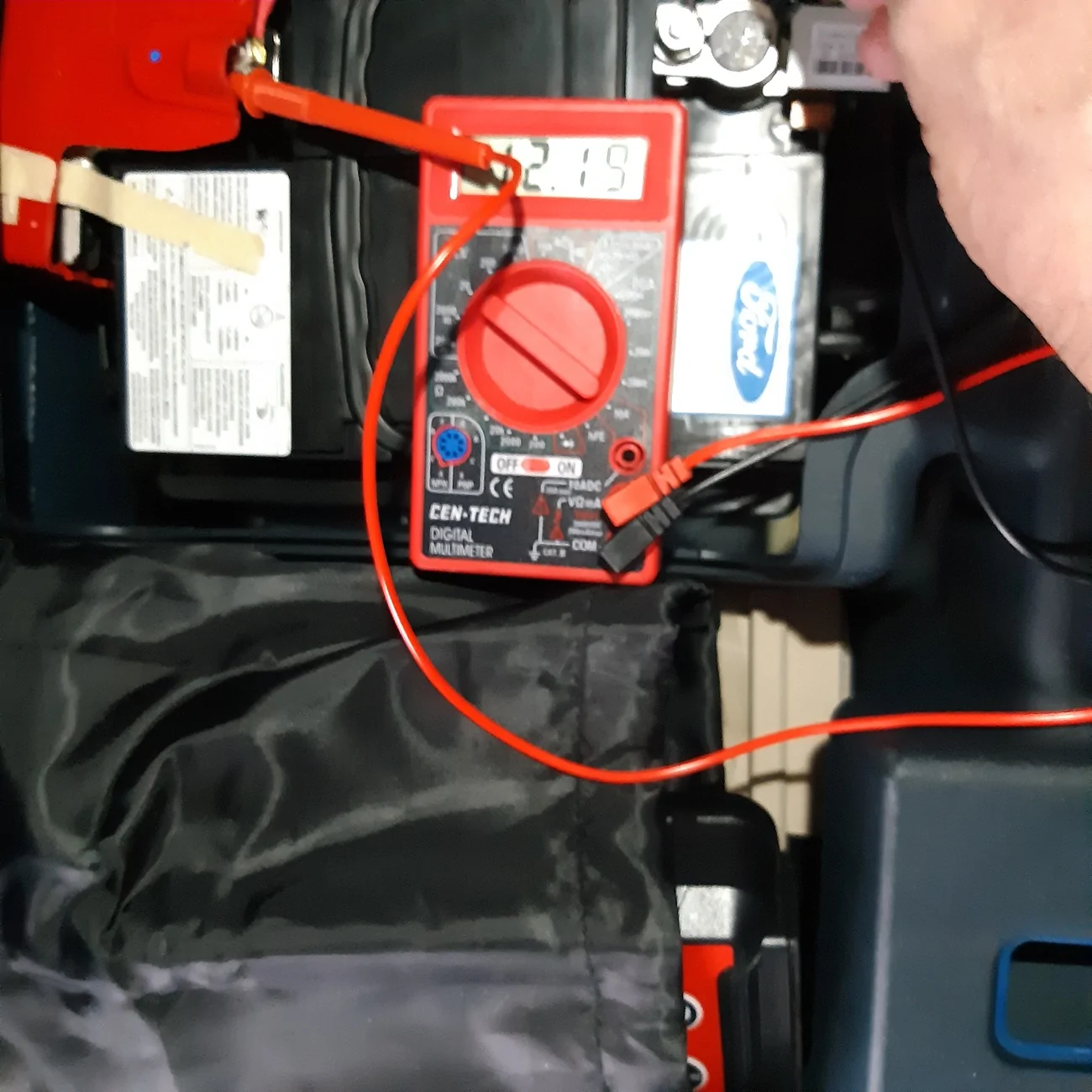

This is the original flooded battery that came with the truck.
I don't know if this is good or bad.
My truck has been sitting for almost 20 hours since I last drove it. A direct test of the battery is showing 12.19 V it could be more. I ran out of hands so the positive probe is just resting on top of the terminal. I hope.

If you opened the door to check your battery you have woke the truck up. It will be using about 0.2-0.35 volts to get ready for you to put key in and turn it to ready. If you leave hood up when you park it and take readings at jump post without raising hood, opening doors, or approaching with key fob you can get battery voltage without anything pulling current. 🤔😇
ETA: I have seen 12.7-12.8 volts at the jump posts on the OEM 390CCA battery three days after my noco g5 spent five days on the battery.
