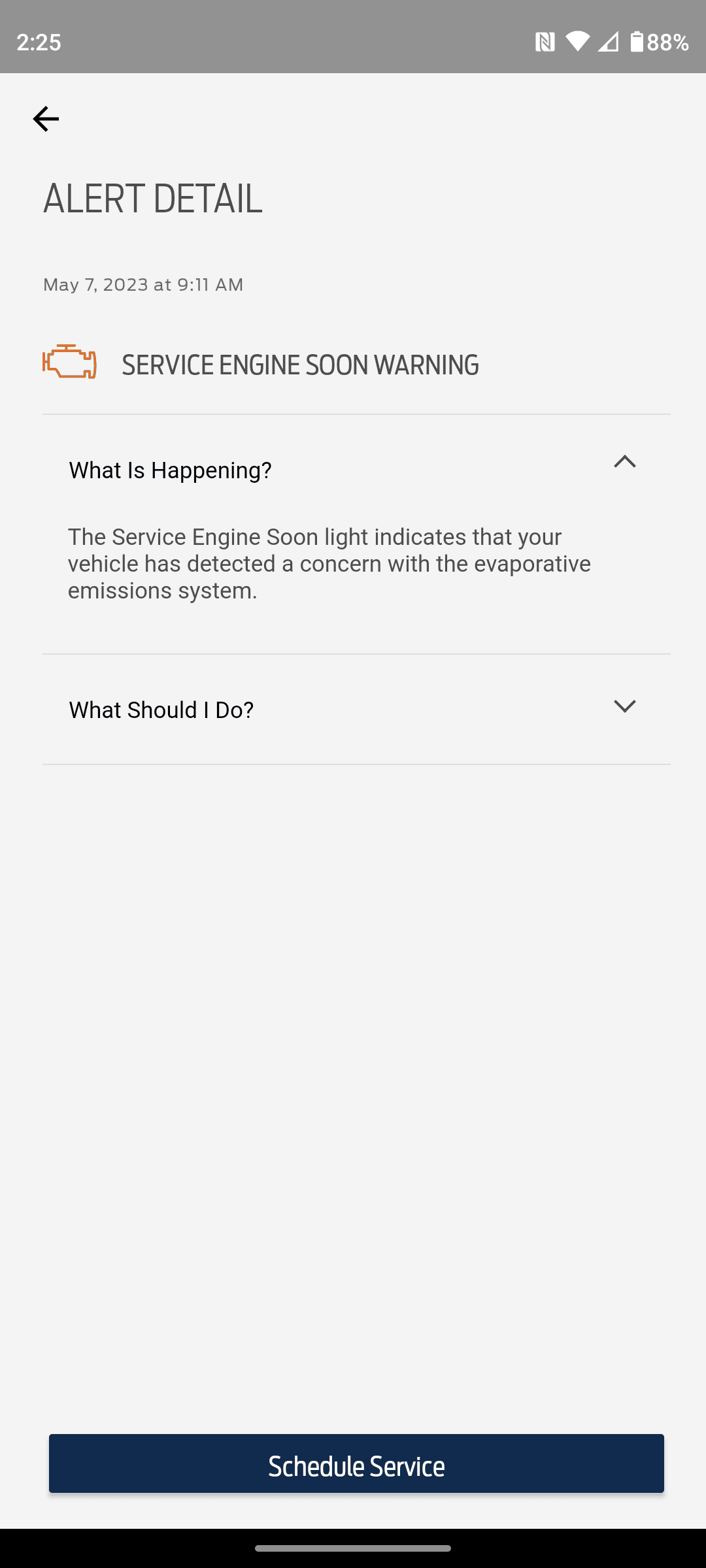

Livid? It took 3 tries for my dealer to fix this on mine. It all had to do with the vapor canister, purge valve, and associated parts. Neither the fuel nor clean oil has anything to do with this. Relax and take it to the dealer.
At this point, without using a scanner to retrieve the specific error code, there is absolutely no way for anyone to know whether the OP has a similar to yours, or not... Why raise his blood pressure further until he knows one way or the other?
As someone else pointed out, Autozone or Pep Boys (or almost any auto parts store) will read the ODB-II port and give you the detailed code that should help diagnose the problem. Without that, it's just wild speculation.

It’s not Wild speculation. It is years of experience with several different models of Ford trucks. All had emissions related faults.

Well we should all apologize on behalf of Ford motor company and this entire forum that you got a check engine light on your very expensive new vehicle that should be flawless. 🙃
Also if you fill the fuel while it's running or you excessively top off the tank and click it multiple times to get to the next even dollar then you may have caused this yourself. Evap is fuel tank pressure and vapor recovery and is a very common system to have issues on vehicles of all makes and models.
Figure out what the code is, let us know what it is if you would like actual help or advice.
