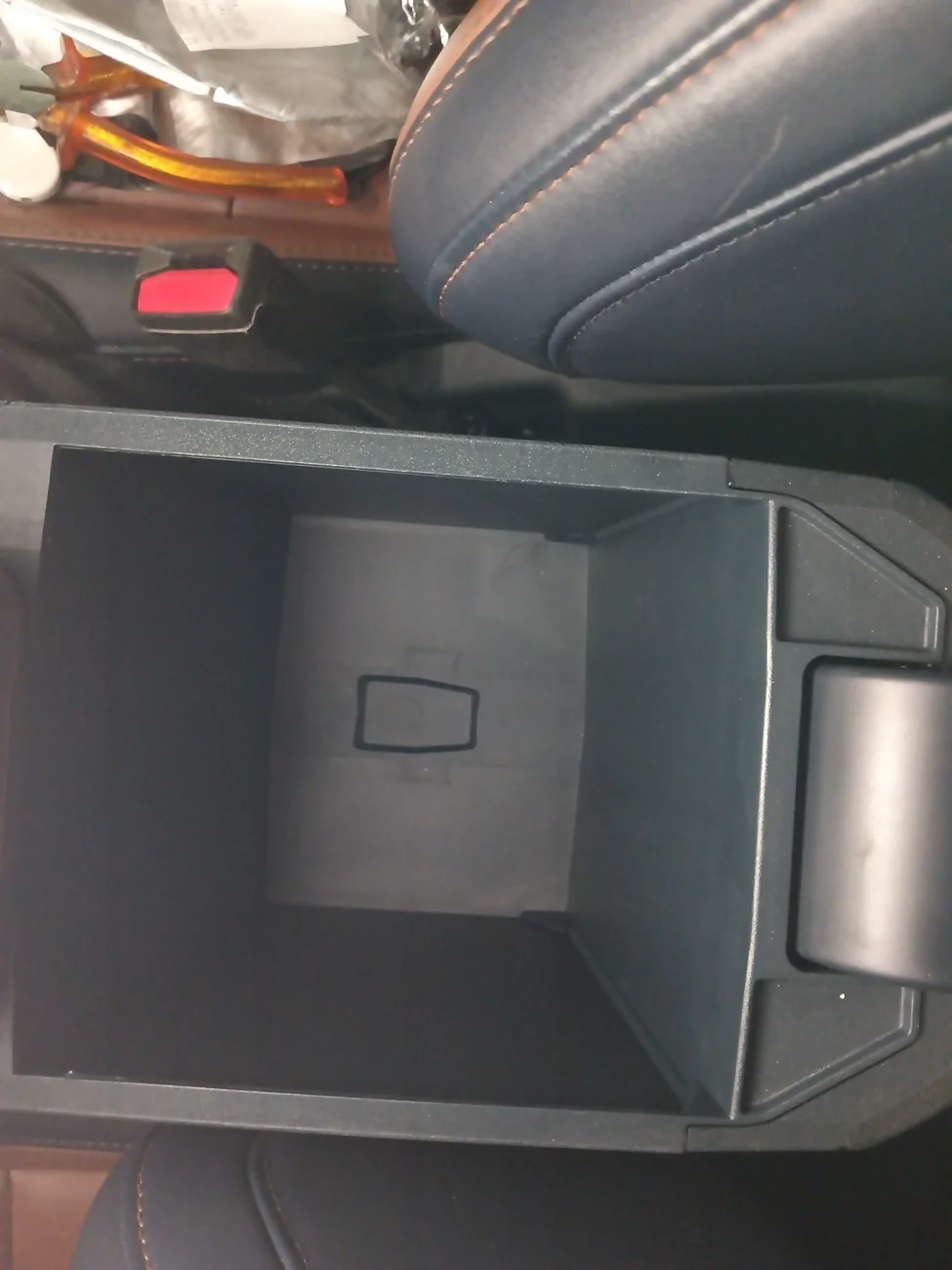

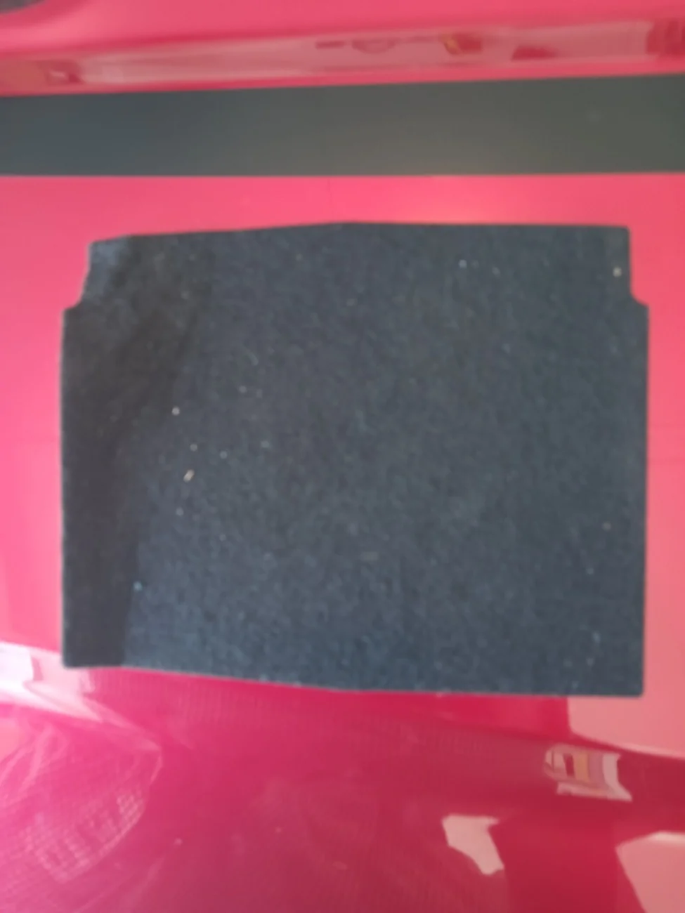

open the lid of the center console, there's a fabric liner in the bottom you need to remove

A
Any picture of it?
Here this the fiber liner pic is on my hood.
Ford Maverick 2025 XLT remote start with Cheap replacement key fob IMG_20250825_165939
Ford Maverick 2025 XLT remote start with Cheap replacement key fob IMG_20250825_170101
It is the spot you place your fobs when battery in fob is dead to start your push button start and when making more keys.
I got it now! TY pal
ETA: mine is a 2022. Not a 2025 it could be different in 2025???
Nope, same 22-25 with keyless
Keyed is an antenna ring at ignition cylinder
