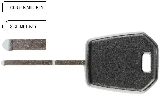

Be aware that the "center mill" key (Ford #164-R8269; StratTec #5939651) used by the Maverick has a blunt nose, while "side mill" keys used in other vehicles (Ford #164-R8130; StratTec #5923667 or Dorman 99294ST) have a slight "chisel" taper at the end. This can make the side mill key tend to jam upon insertion into a center-mill lock because it tends to push the tumbler pins sideways. It's a very subtle difference, and if you're not a locksmith or have both keys in your hand for comparison (as I did) it is hard to tell the difference. The immobilizer chip is the same for both, so it's possible to have the wrong key cut and coded for your Mav.

FYI, I bought a cheap Chinese transponder key for a Honda Civic and the remote stopped working after a month, so I'm more than just a bit leery about low-priced clones. I've had excellent luck with StratTec so if you can find something suitable on their site it should work well. I bought one of their flip keys from North Coast Keyless online ($80 in '23) and it seems indistinguishable from the factory keys in form and function. I Googled your part and found this image in an Amazon listing for $10. It appears to be the more common "side mill" key blank. So... you might want to chat with your local locksmith about this AND to see if they can duplicate center mill keys. My guy had to upgrade the software in his key duplicator to handle my key.
