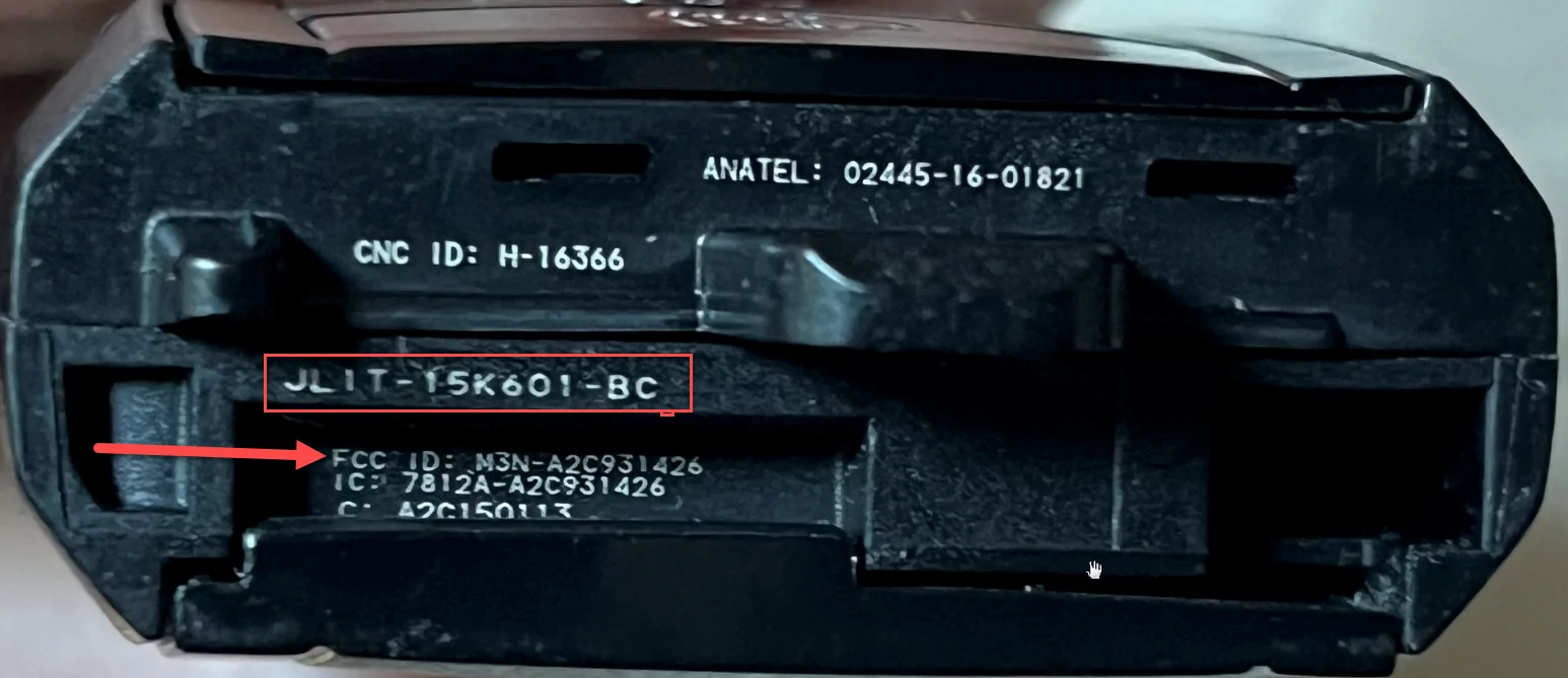

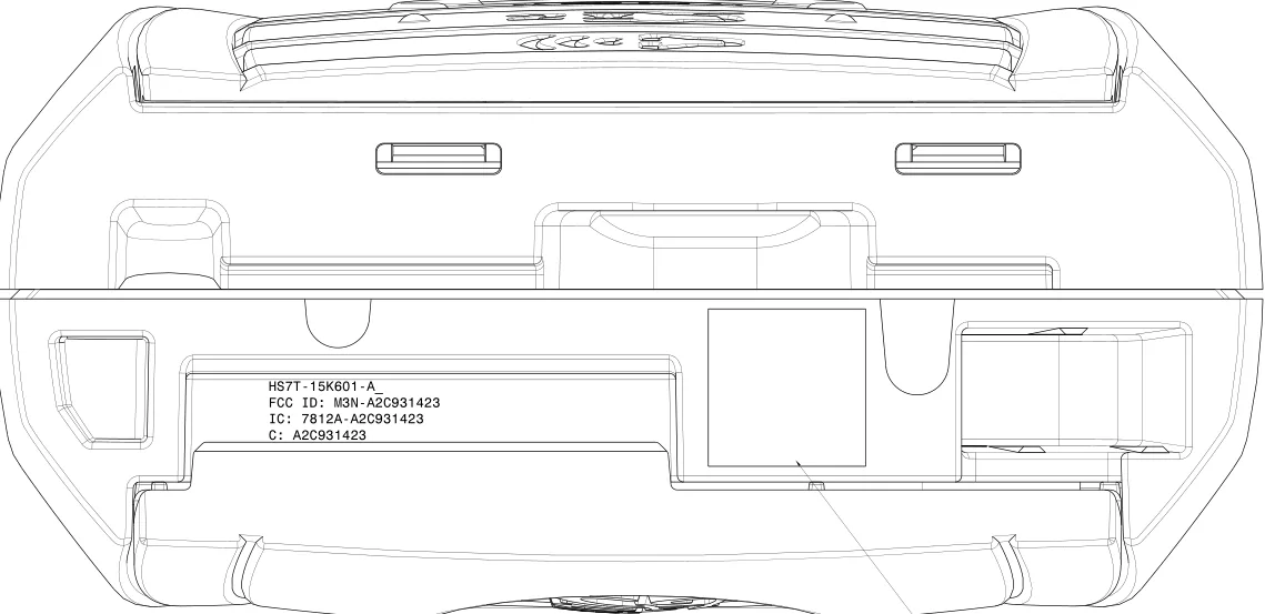

If you remove the manual key out of the key fob, probably can see the ford PN as well as FCC ID
Plugging in FCC ID into google or https://fccid.io/ can pull up some hits of it and frequency.

My Escape's key fob JL1T-15K601-BC, FCC ID M3N-A2C931426 pulls up info that matches its QR code frequency of 902MHz:

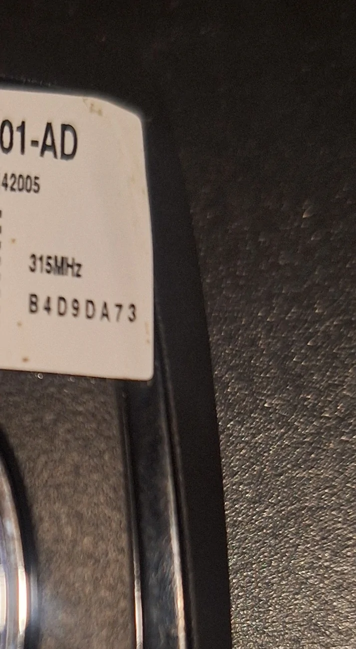

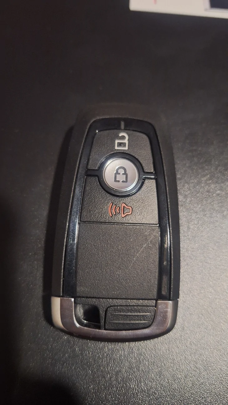

Great info! I plug my info in, and I'm seeing 314.95MHz. So the key that I ordered is not the correct one. I'm going to try to find the correct key and see what I can do. Hopefully, what @Quest stayed earlier that the "2x" will work without the module.
It's a 315MHZ for me as well please be kind and let me know if you find the correct key fob!
