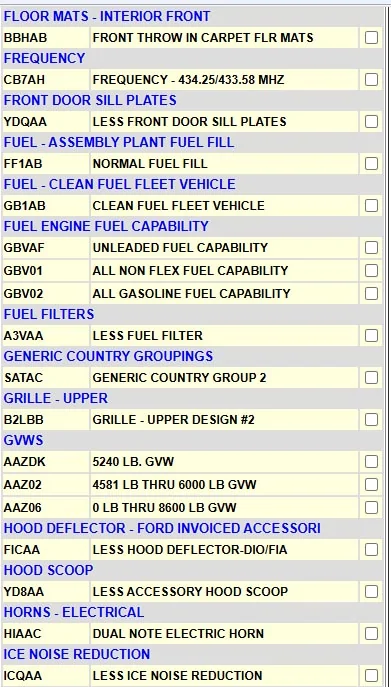

The key code is printed on the sticker on the BCM (near the passenger floor fuse panel) perhaps the frequency is on that sticker as well?).
The only place they show key frequency is the sticker on the key or the dealer access section of HvBOM /features
Ask your dealer service advisor or parts dept, it's always the first of the 2 possibilities
