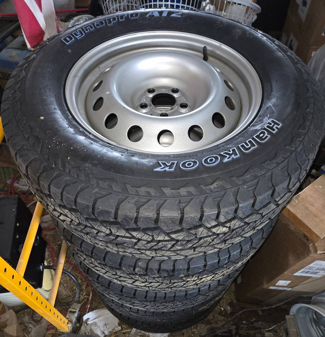

Well, pooh! I guess I'll take it my 315Mhz 2022 TPMS and install a set of Autel dual frequency programmable TPMS. I have an Autel programer but it won't read Schrader on my Superduty, so I'll likely have to use forscan to get their codes to clone from my OE wheels. Sadly, my lifetime license from forscan didn't transfer to my new laptop. Argh! I'll try using my Harbor Freight manual bead breaker to pull the tire bead down. Damn, so much extra work. Perhaps I'll pay the $20 each at a shop to swap them and document the sensor codes to clone?

Well shit. That causes some drama for all of us who have winter tires from prior years. I have a set of tires that have 315's in them that I guess I am going to need to have a tire shop un-mount from the rims, replace the sensors, and re-mount on the rims. Super lame.
Tire shop should be able to break the bead, push the bead down & remove then replace the TPMS without dismounting tire. If the tire person was taught correctly that is.
