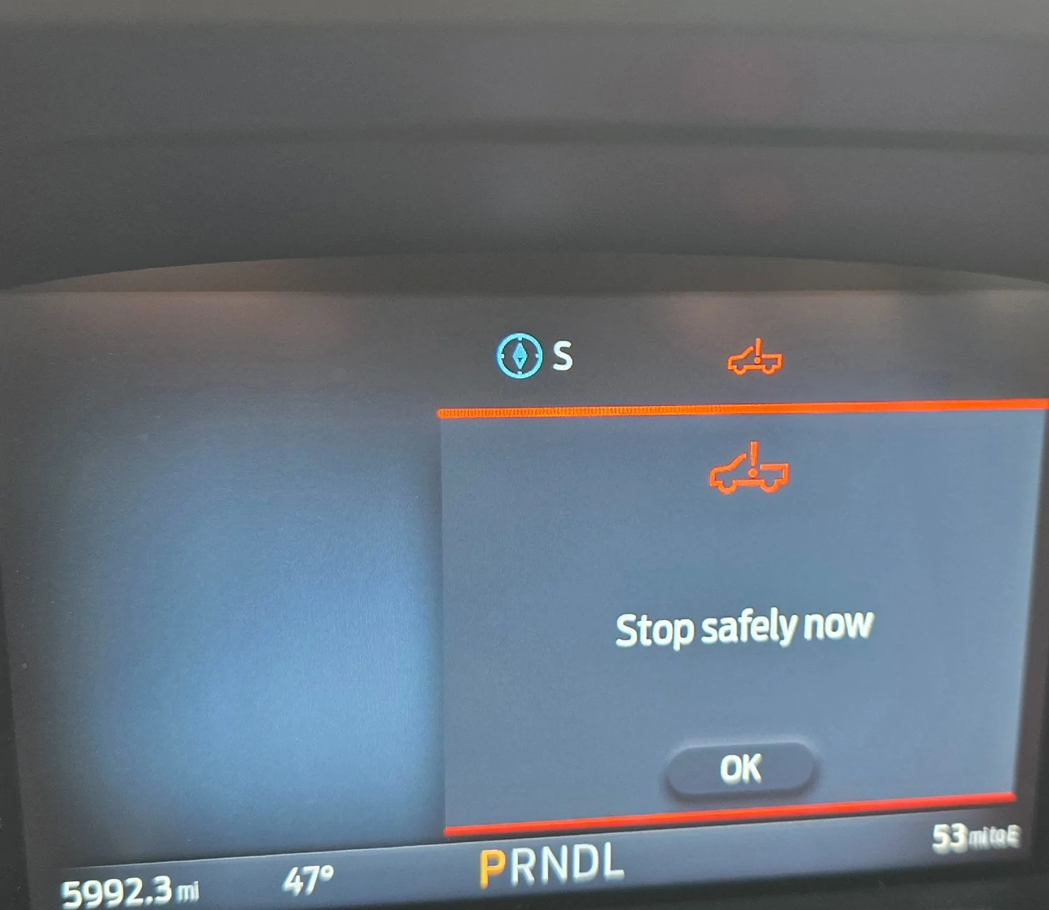

Well this didn't work. I got the "stop safely now" after trying this. Now the ignition turns on, but no ready light and no drive. Going to leave it it 30 minutes and try again.
Ford Maverick Activating New TPMS for the 2025 20251226_132435
