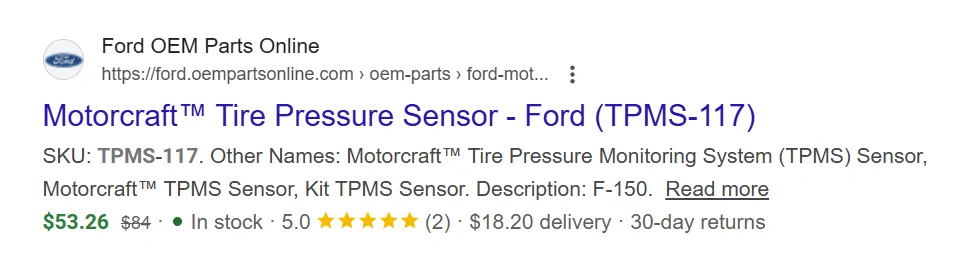

The TPMS-117's I got off eBay at $50 for the set are working great. Zero issues with the Dunlops in the snow (been getting a lot if it here in CNY this year) - all is well in the the snowy Northeast...lol
The retail price for those are $50ea, if you bought them from an individual great you have a good chance of getting a good set. If you bought them from a "company" then either they are old stock (that means lowered battery life), the are fake, or stolen. Fake mastercraft parts are all over ebay and amazon. I've had bad luck trying to cheap out, just had to replace two on my bronco that I installed the week prior. The programmer would read them but the Bronco would not recognize them, I was hoping running them would work but a week and over a 1,000 miles they didn't.
I just bought the same dunlops myself in a 245/65R17 at $110ea delivered. Going to run them on the factory steelies this season as well. For my all-seasons I went with a 20x9 rim. Next year I'll either paint the steelies black or spring for a set of aluminum.
