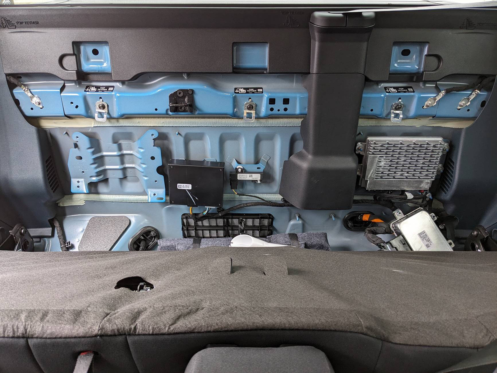

For how much room there is on the back wall, there is one strategically placed module to just make it annoying.
Hey, how did that tow hit module come out? Not sure how it's latched in there
The larger black module slides on the bracket, then there is a clip to keep it from sliding off. Reach behind the bracket, depress the tab, then it will slide off.
