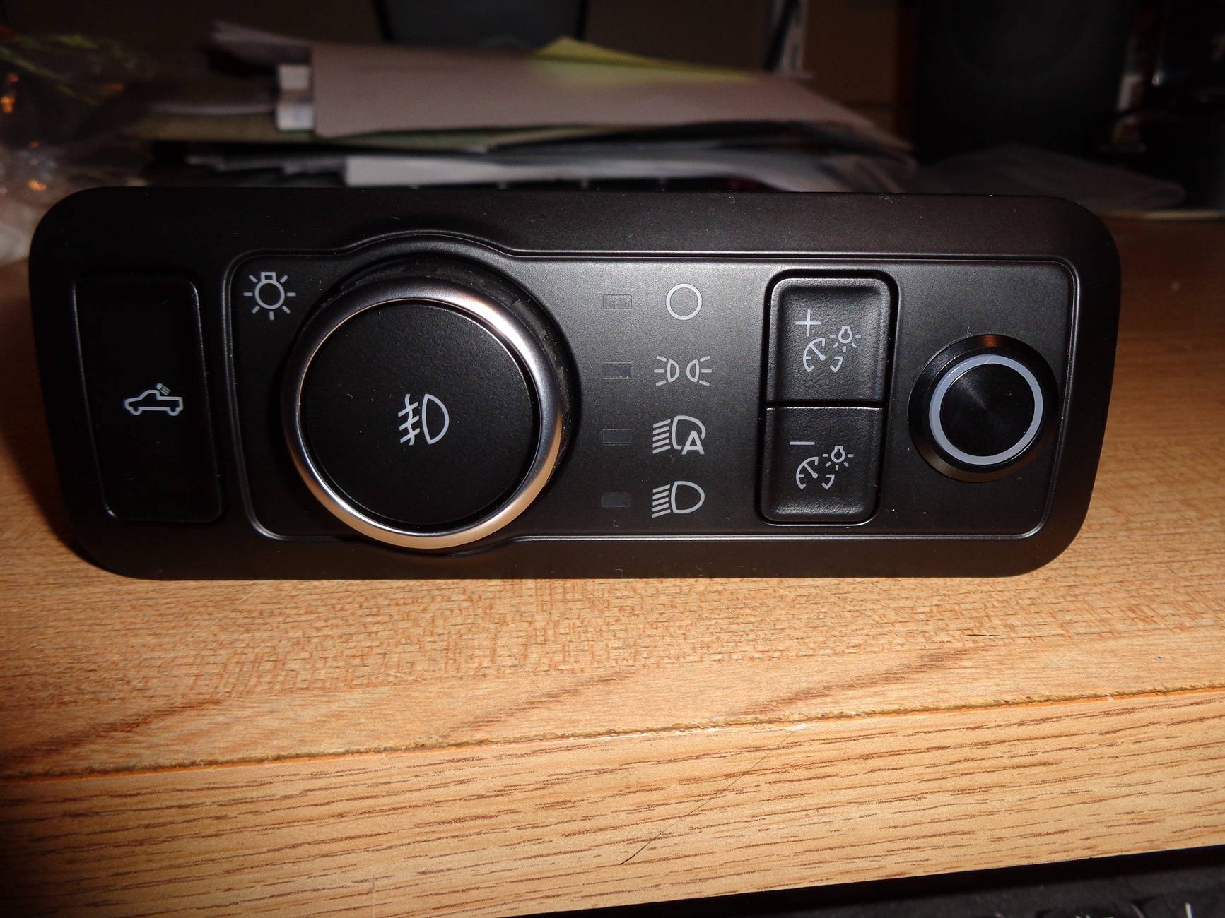

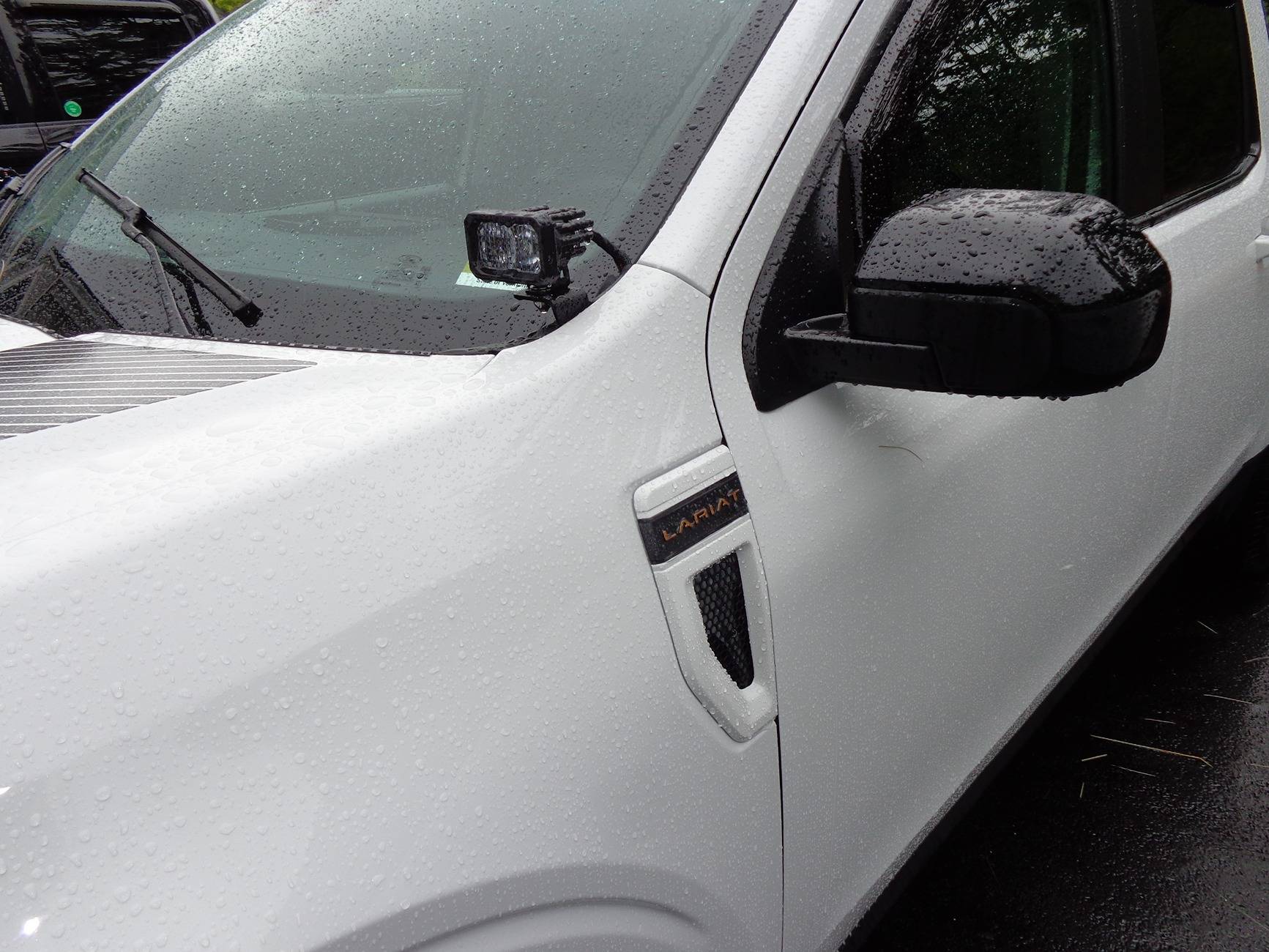

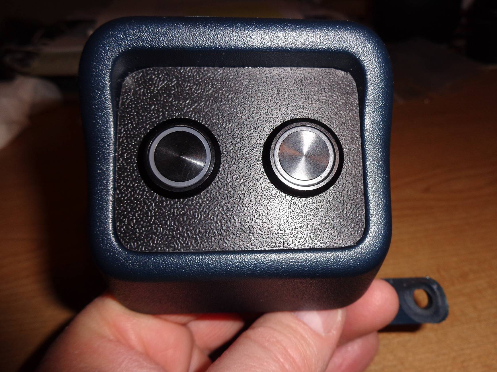

My Diode Dynamics SSC2 Ditch Light Kit arrived yesterday. I've been working on getting the switches installed in both the "trailer brake control" panel and the F150 headlight switch assembly, along with building out the pigtails to use with the DD HD wiring harnesses.
The switches are these: APIELE 16mm Latching Push Button Switch 12V DC On Off Black Shell with LED Angel Eye Head for 0.63" Mounting Hole with Wire Socket Plug Self-Locking (White/Black Shell): Amazon.com: Industrial & Scientific
The push switch in the headlight switch assembly is going to control a set of 7" round Old-School-looking LED driving lights that will be mounted on JJC grill mounts. There are two switches in the trailer brake panel for the DD Ditch lights: one to control the backlight and the other to control the main beams. These are normally run through a 3-way switch supplied with the HD harness.
At some point, the foglight button in the F150 switch will be run through the BCM, assuming somebody comes up with a clean looking foglight setup for the Tremor lower valence.

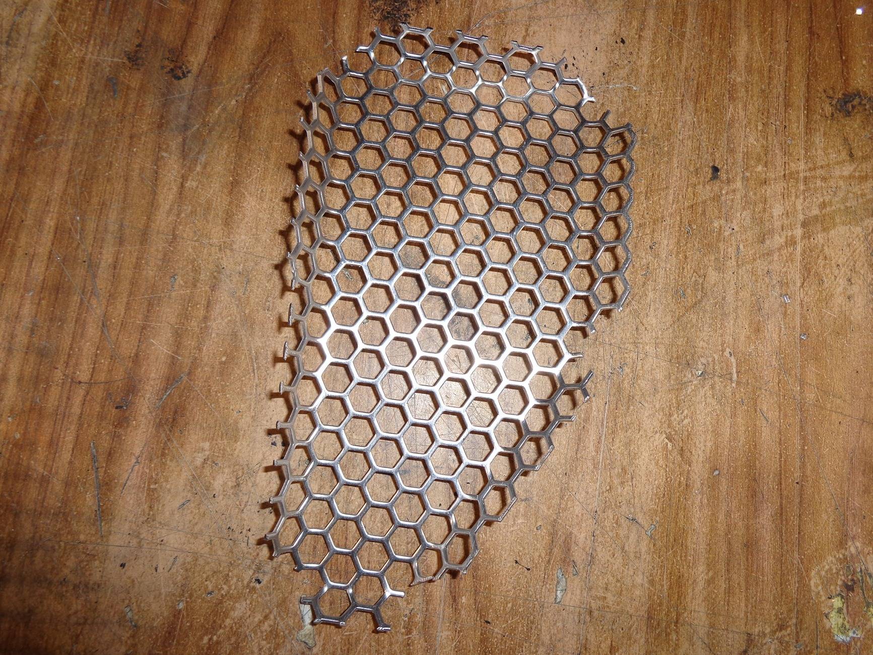

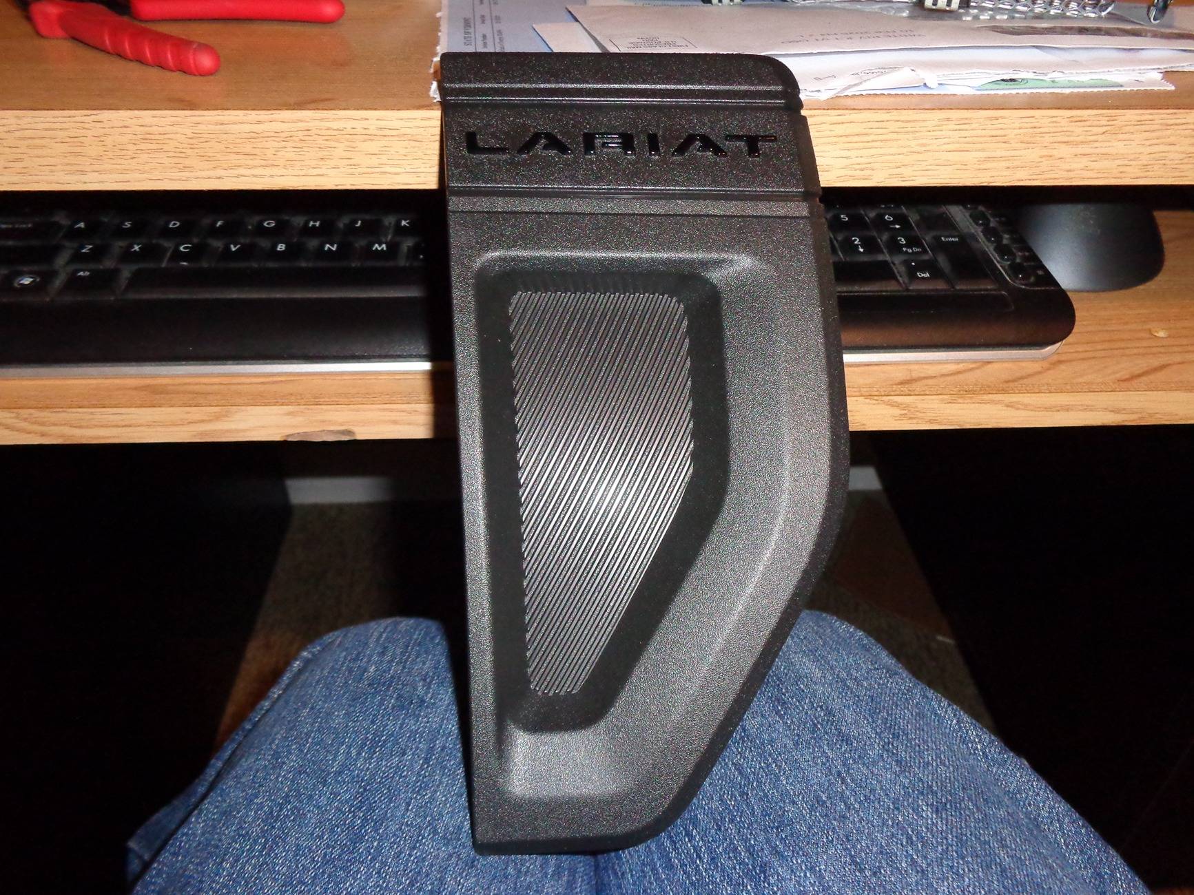

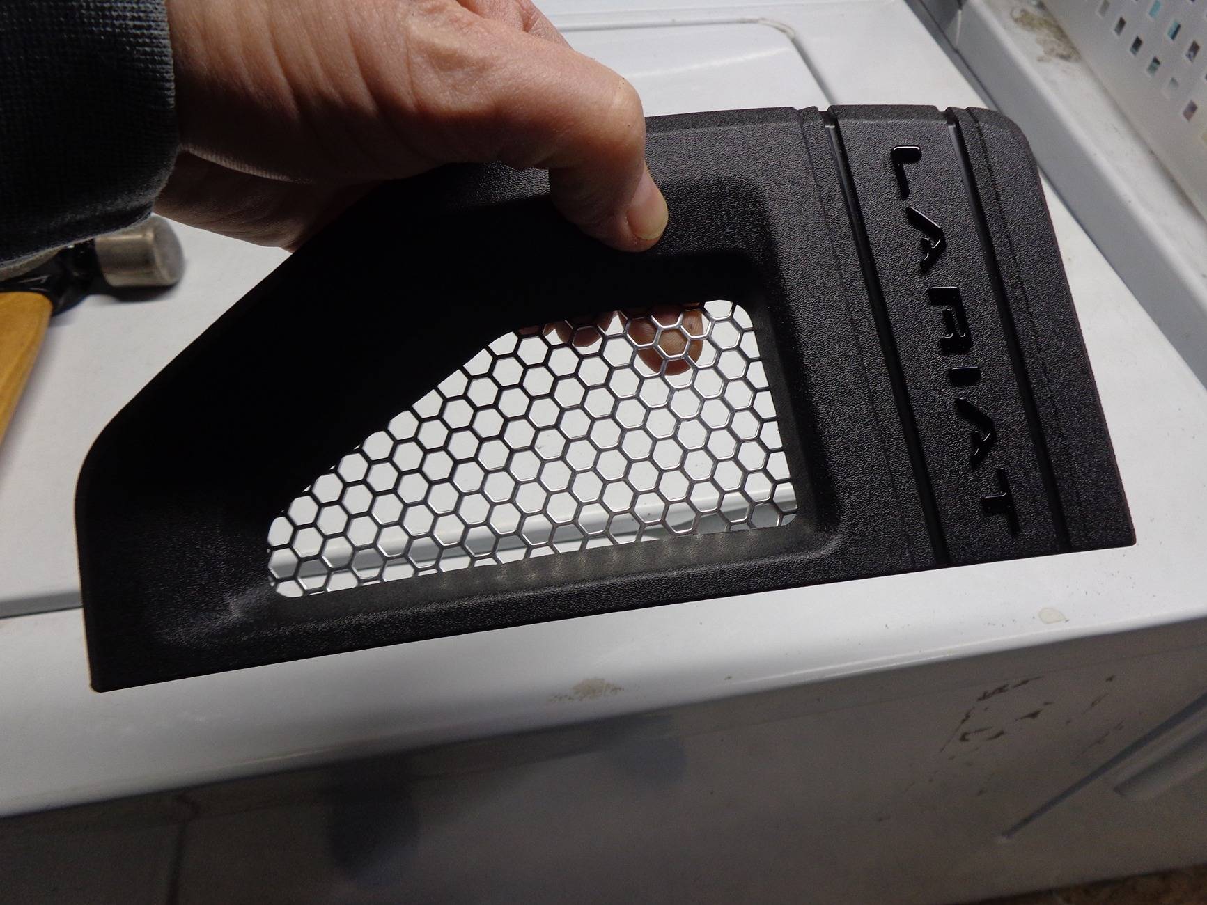

I'm also starting on another project: customizing a set of fender vents with a honeycomb mesh insert, which will be color-matched when the weather gets much warmer. I'll post pics when I get a little farther along.

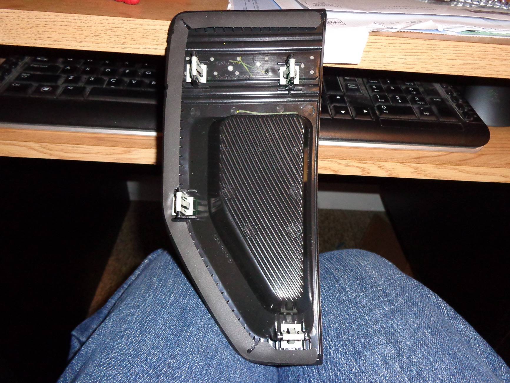

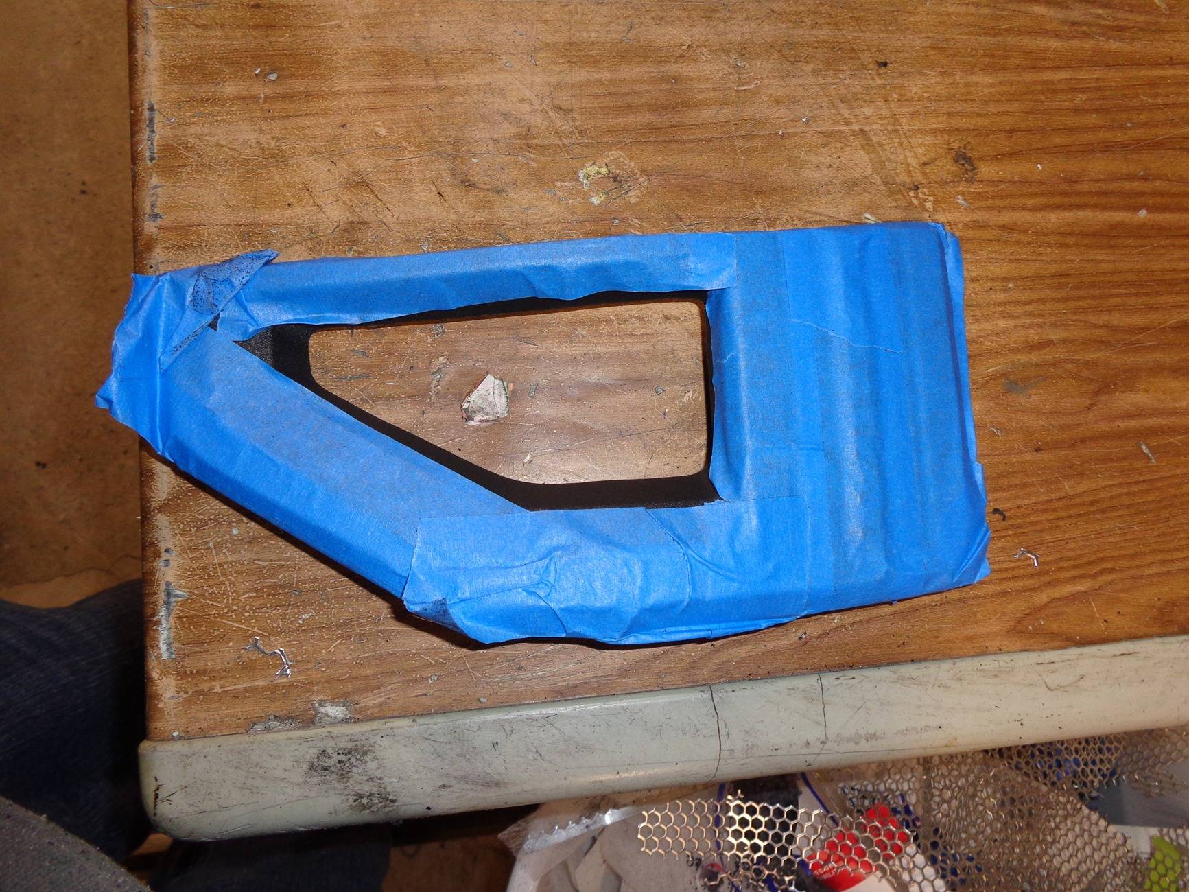

As promised, my next project was modifying the fender vents, just for something a little different. At first my plan was to make a mesh insert that would fit into a few slots in the vents, while leaving the backing panel intact.
Ford Maverick Build Log: 2024 Lariat Tremor "Poundcake" DSC00691.JPG
Ford Maverick Build Log: 2024 Lariat Tremor "Poundcake" DSC00692.JPG

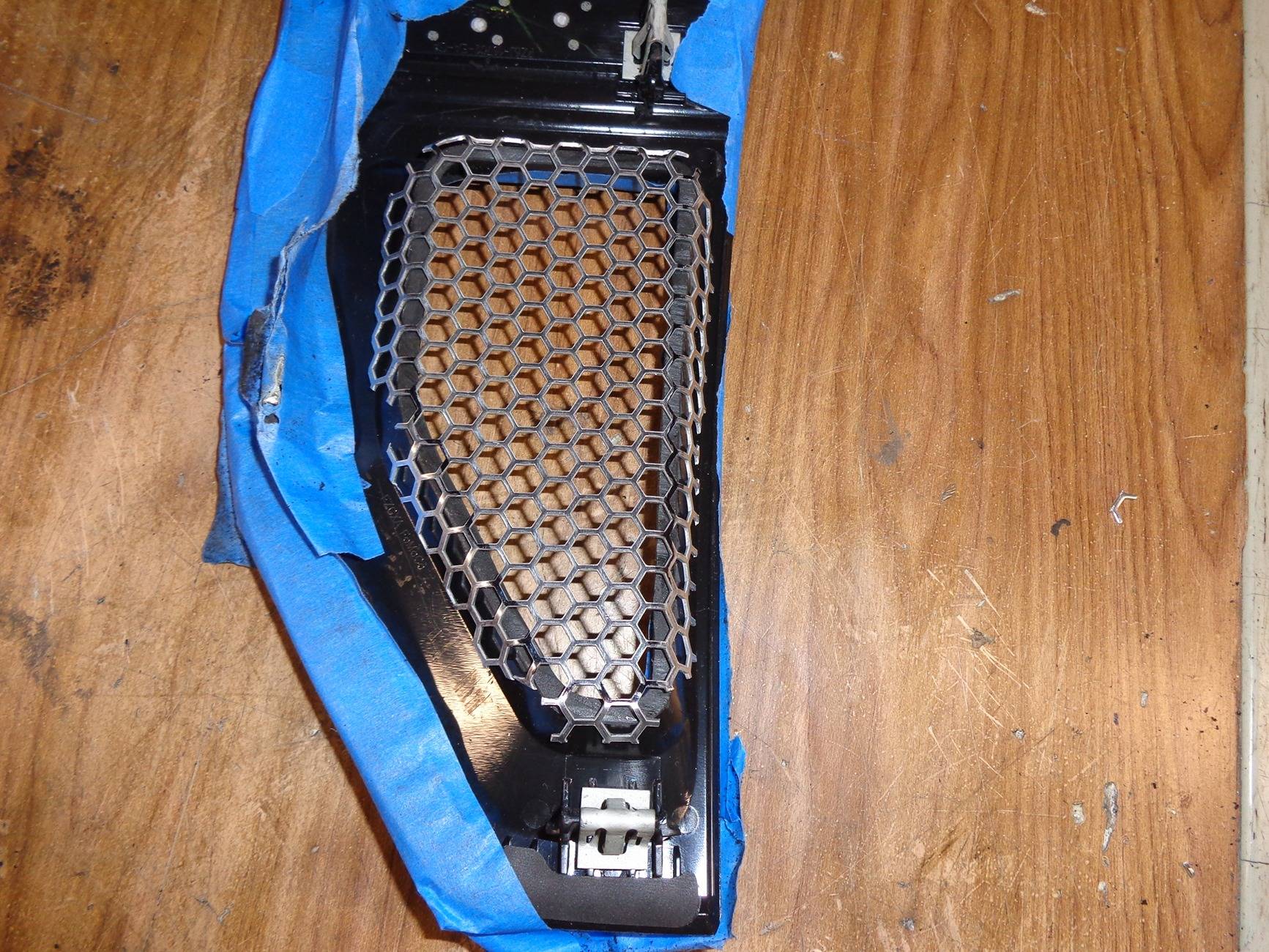

After much fiddling and aggravation, I decided to just grind the panel off from behind, a la the Focus ST Grille Shave, using a flap wheel.
Ford Maverick Build Log: 2024 Lariat Tremor "Poundcake" DSC00696.JPG
Ford Maverick Build Log: 2024 Lariat Tremor "Poundcake" DSC00695.JPG

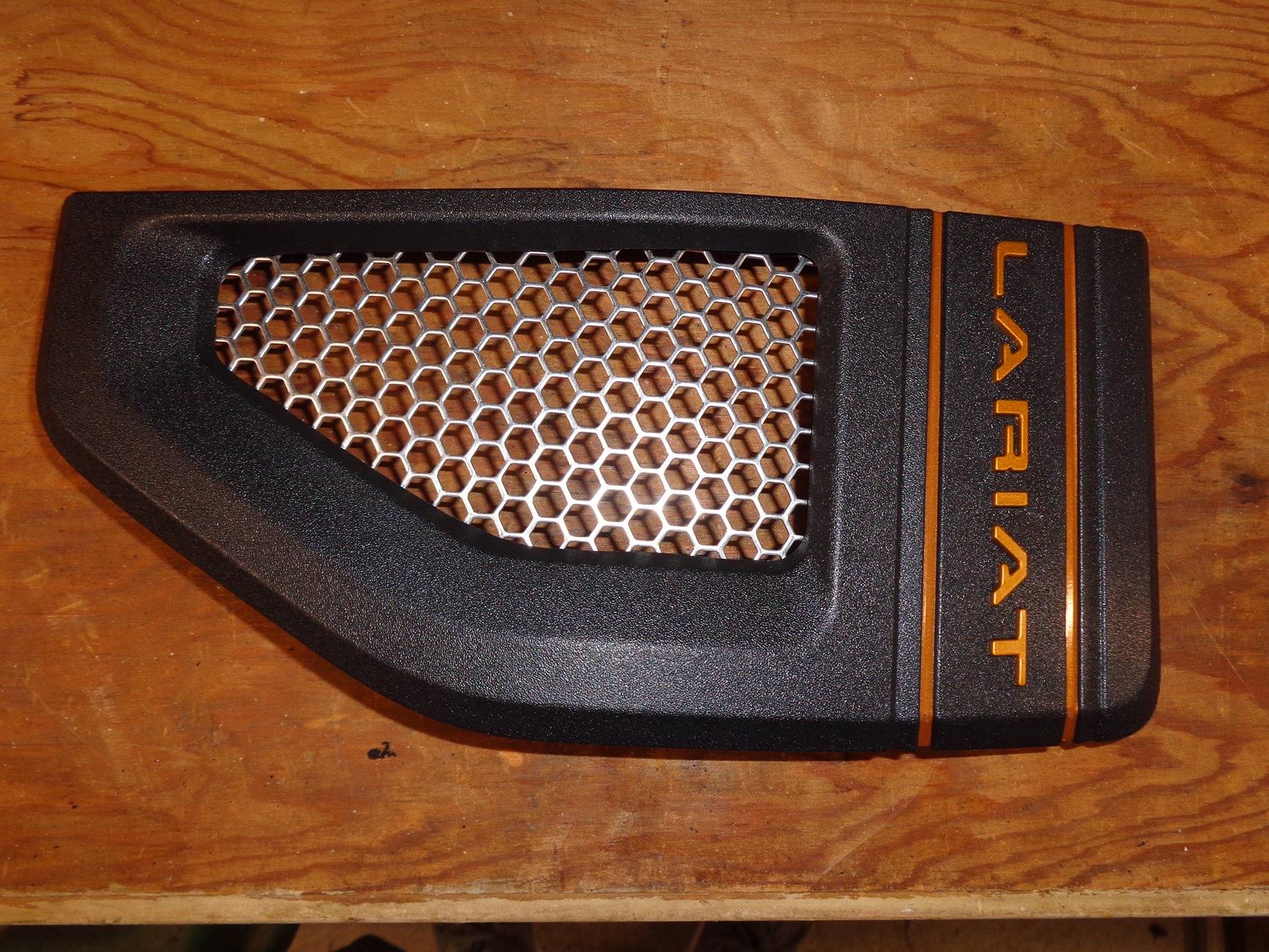

The nice thing about the honeycomb mesh that I'm using is that it is super pliable and very easy to work with. I cut it oversized to the rough shape of the opening, then cut notches in the overhangs to wrap around the sides of the opening. A little trimming, bending and forming, and it fits very well. I'll use some black J-B Weld epoxy to hold them in place, one I decide whether they're going to be left silver or get painted black. The vents themselves will be color-matched Oxford White once the weather straightens out. I'll have to figure out a way to black-out the fender opening, or block-off the mesh.
Ford Maverick Build Log: 2024 Lariat Tremor "Poundcake" DSC00697.JPG
Ford Maverick Build Log: 2024 Lariat Tremor "Poundcake" DSC00698.JPG
Ford Maverick Build Log: 2024 Lariat Tremor "Poundcake" DSC00699.JPG
I'm pretty stoked with how they turned out.

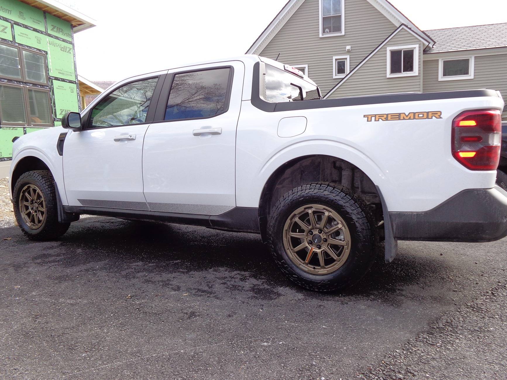

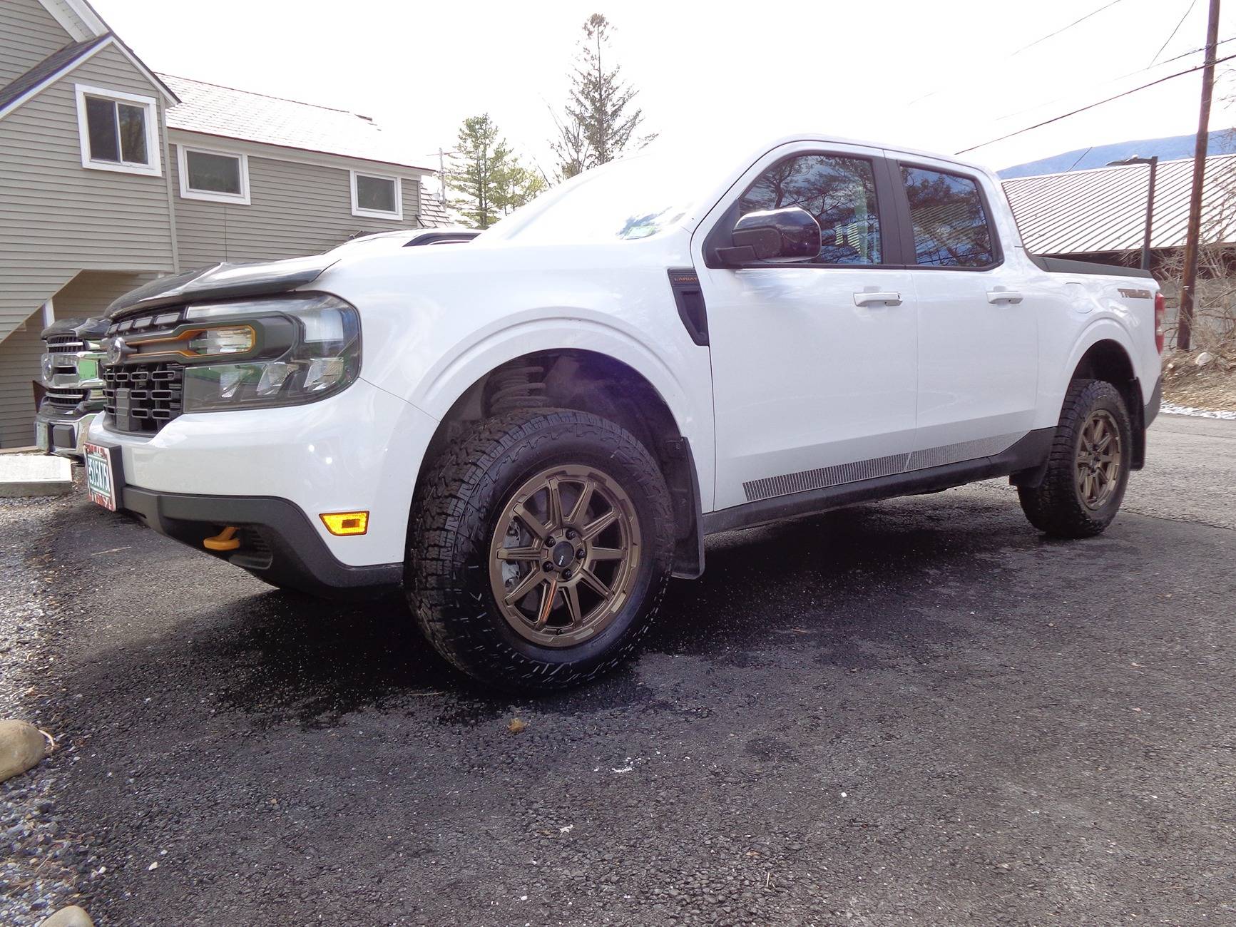

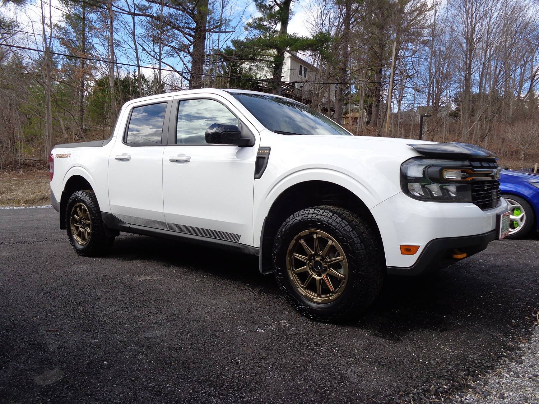

The truck needs a bath badly, but the weather cleared up this afternoon, so I hauled the new wheel and tire combo up from the basement.
They look super-aggressive, and the Bronze looks great with the Oxford White. Pics taken fresh off of the jack, so the suspension will settle a bit. I'm thinking that I'm going to pass on installing the Eibach lift springs.
Ford Maverick Build Log: 2024 Lariat Tremor "Poundcake" DSC00700.JPG
Ford Maverick Build Log: 2024 Lariat Tremor "Poundcake" DSC00701.JPG
Ford Maverick Build Log: 2024 Lariat Tremor "Poundcake" DSC00702.JPG
Ford Maverick Build Log: 2024 Lariat Tremor "Poundcake" DSC00703.JPG
Ford Maverick Build Log: 2024 Lariat Tremor "Poundcake" DSC00704.JPG

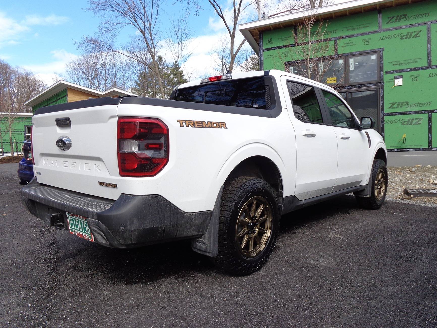

It's been a wild 6 weeks or so, trying to get stuff done as weather permits, plus way too much time driving loaner vehicles while the Maverick was at the dealer on 3 different occasions for the same thing--see here: (2) Dash lit up like Times Square | MaverickTruckClub - 2022+ Ford Maverick Pickup Forum, News, Owners, Discussions
Well, knock on wood, it seems to be fixed so I'm finally able to move on with some projects and installs. Getting ready to head to Carlisle for the Ford Nationals and MTC Roundup. It's been raining all day today, but I was able to get out and clay the paint, planning on waxing tomorrow. Sorry about the pics--still raining, but I wanted to post some progress.

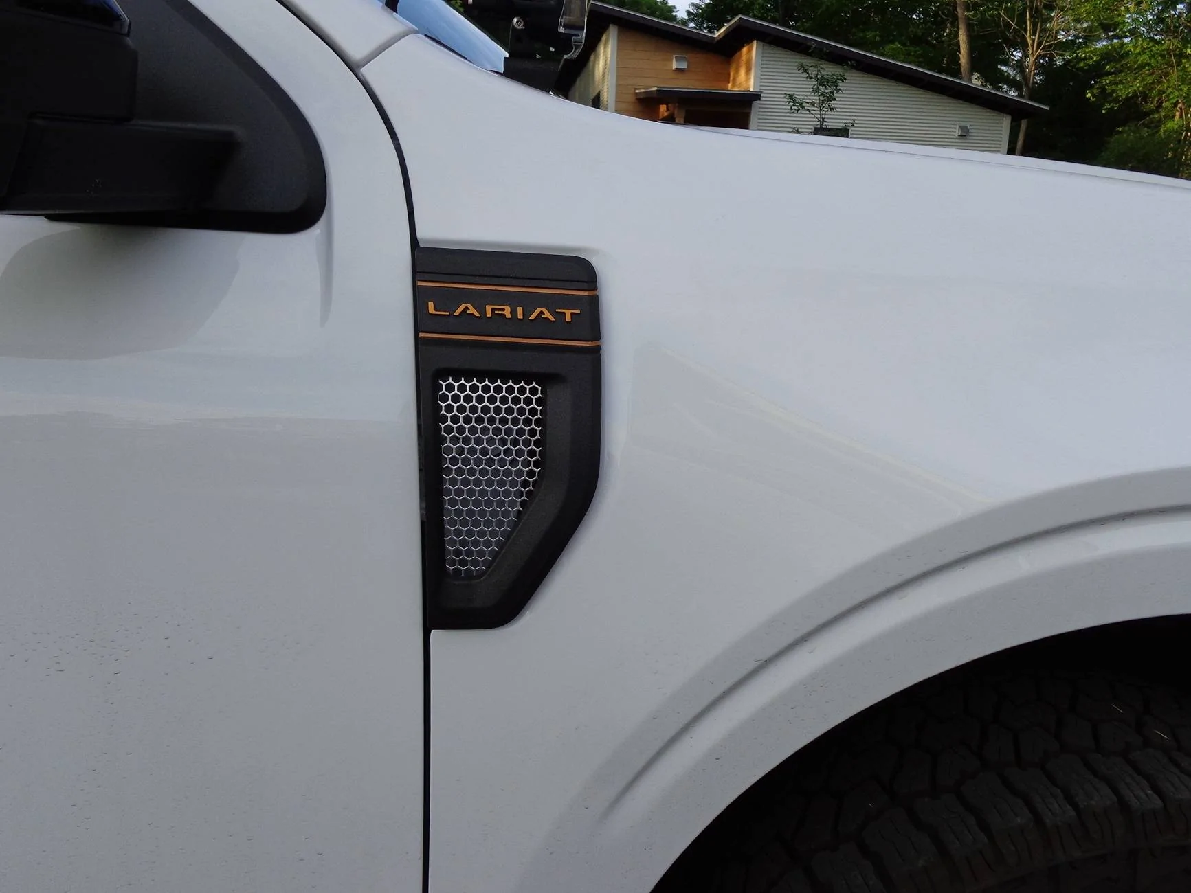

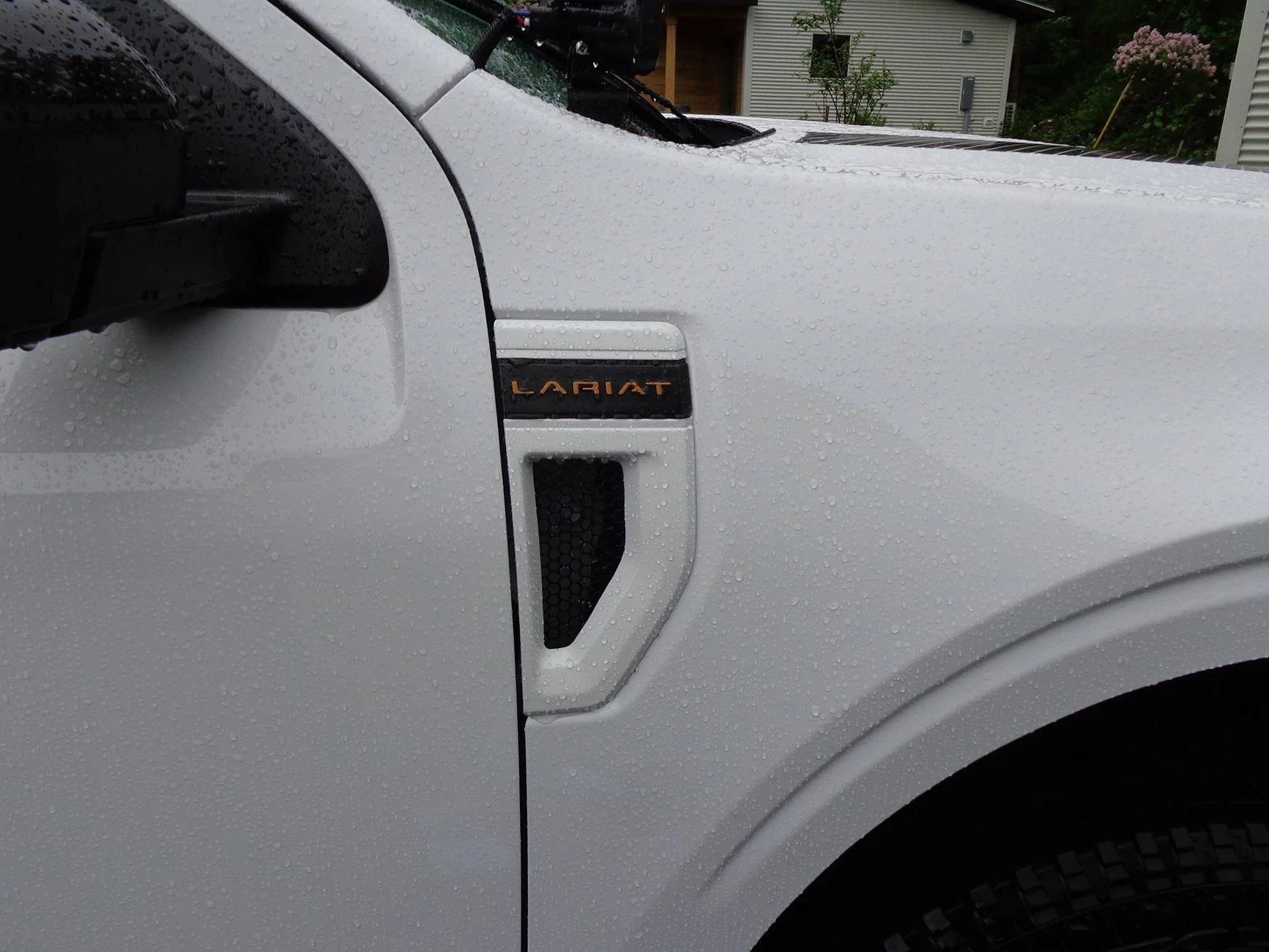

I got the fender vents finished up a couple of weeks ago and got them installed last weekend. I'm pretty happy with the way they turned out, just need to black-out behind them at some point.
Ford Maverick Build Log: 2024 Lariat Tremor "Poundcake" DSC00712

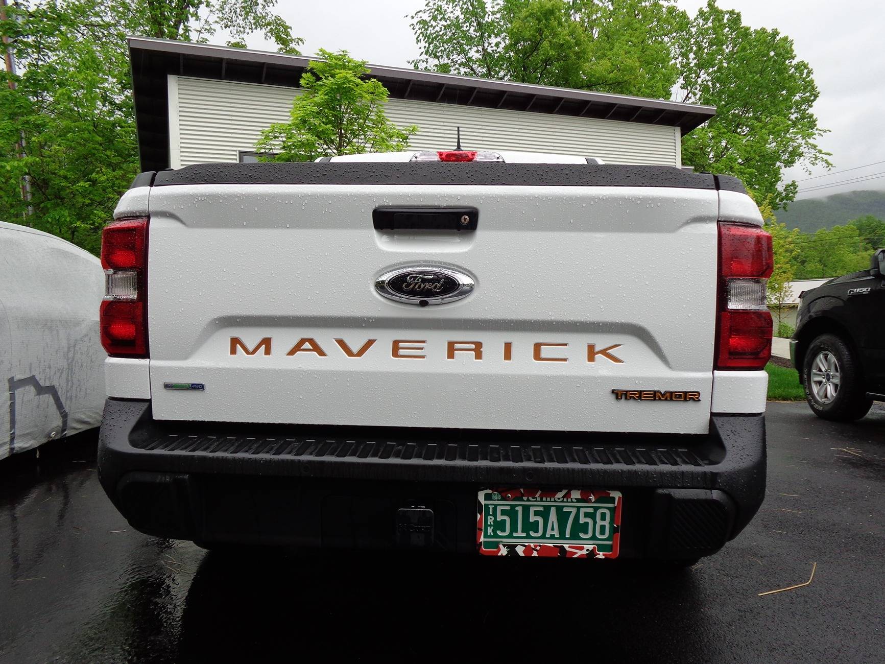

Tremor Orange tailgate letter inserts from Etsy were installed a couple of weeks ago.
Ford Maverick Build Log: 2024 Lariat Tremor "Poundcake" DSC00710.JPG

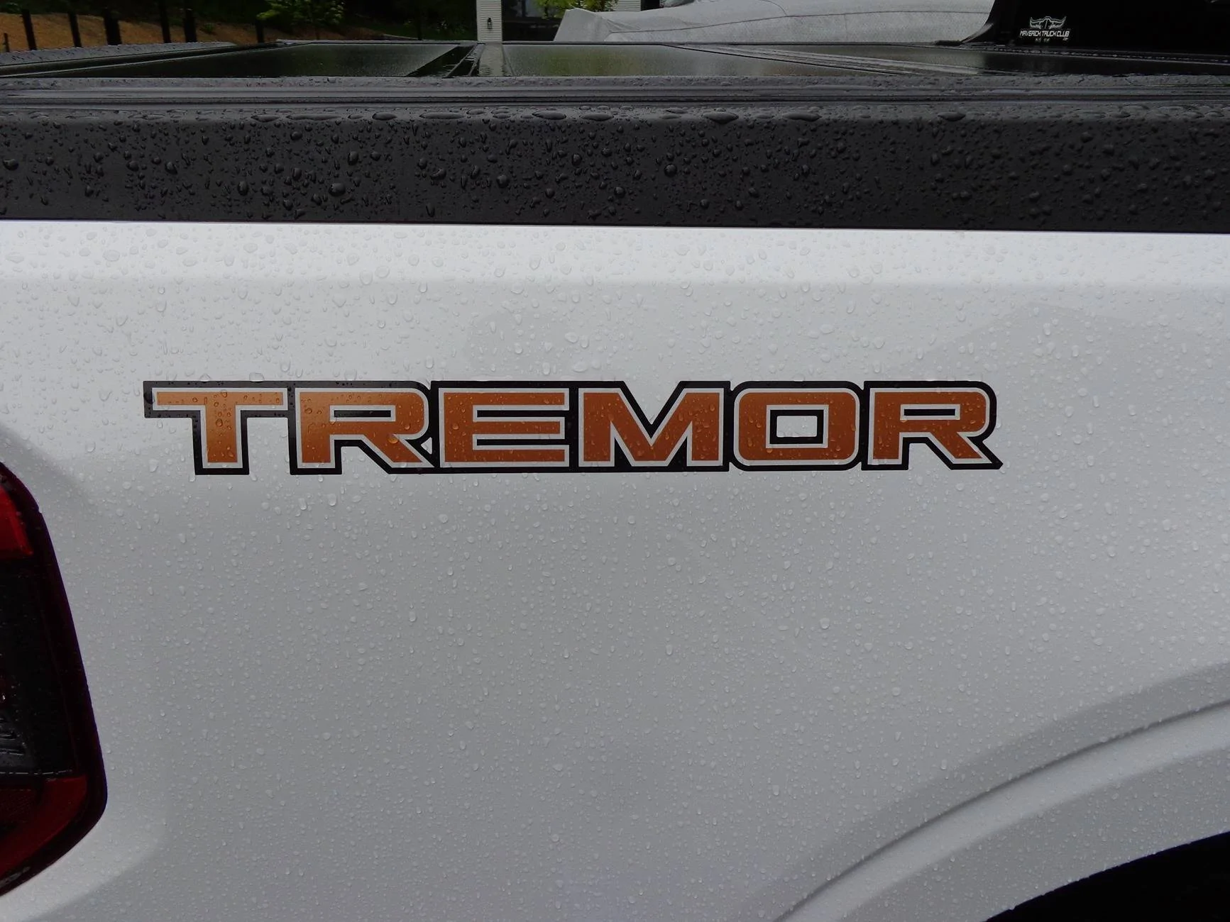

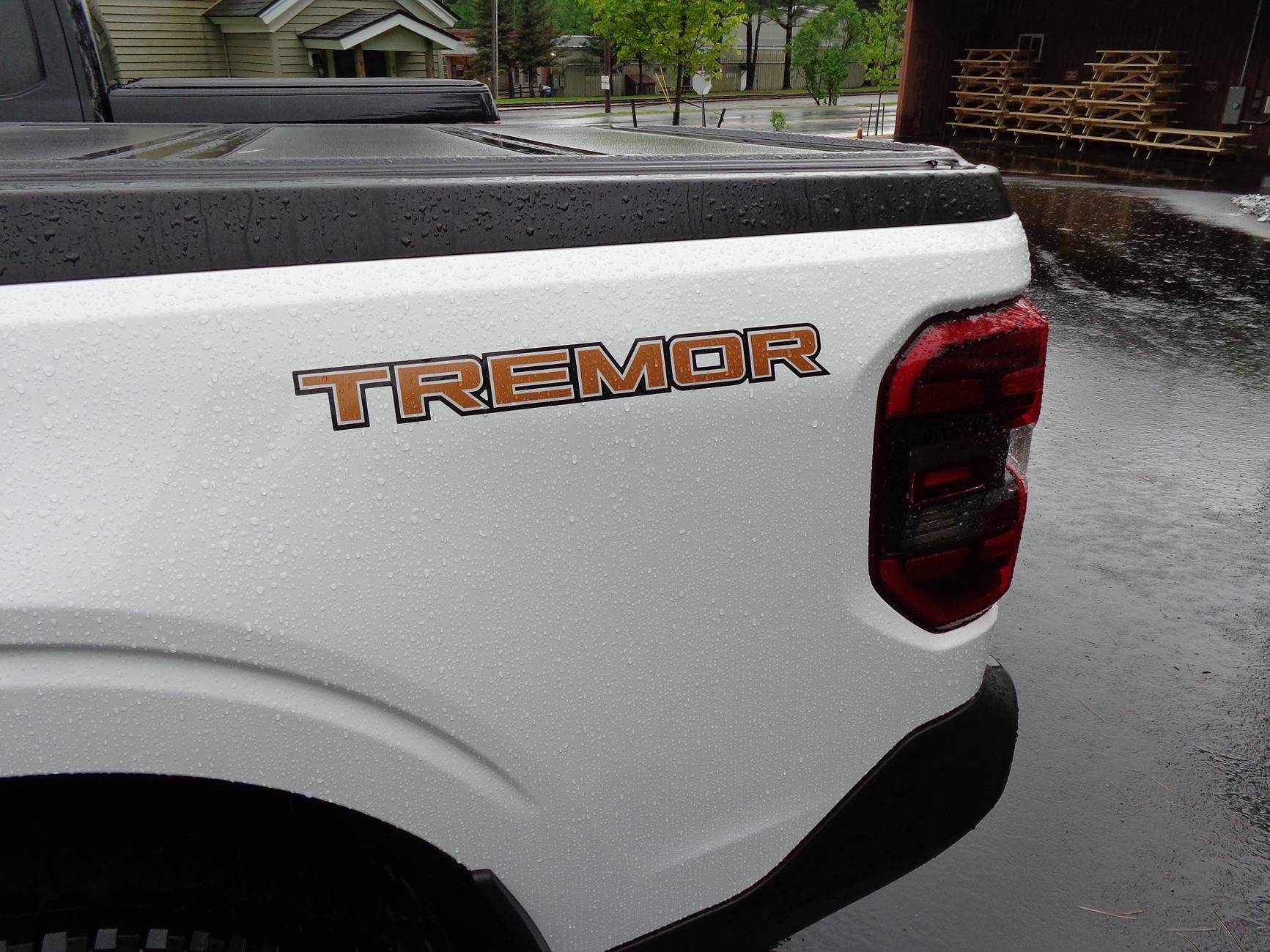

Custom Tremor bed-side decals from @VinylImagination installed the same time as the tailgate lettering. The white outline is reflective, which is a cool touch.
Ford Maverick Build Log: 2024 Lariat Tremor "Poundcake" DSC00711
Ford Maverick Build Log: 2024 Lariat Tremor "Poundcake" DSC00717.JPG

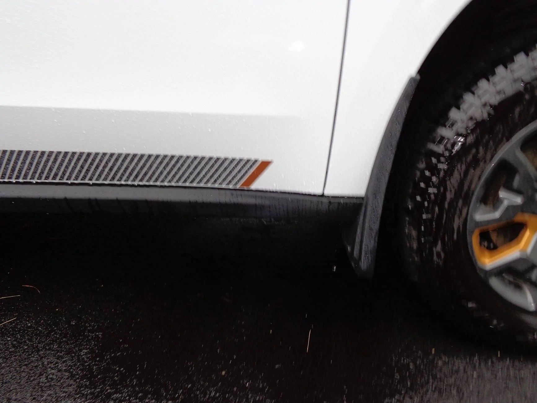

After many different iterations, I just went super simple with the rocker graphic addition--more like the 2025s. Same color as the Tremor decals.
Ford Maverick Build Log: 2024 Lariat Tremor "Poundcake" DSC00713

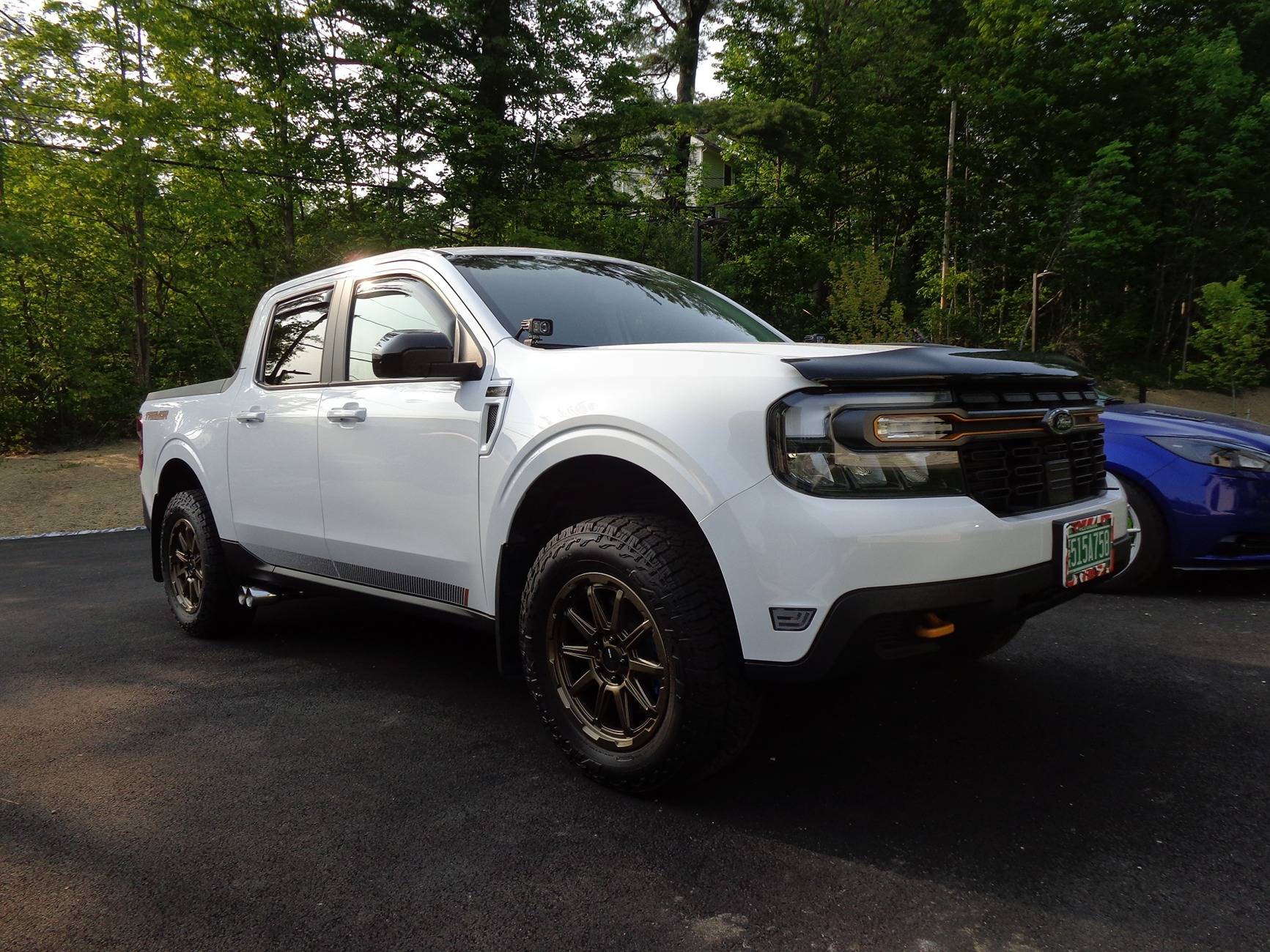

Diode Dynamics SS2C Combo Beam ditch lights have been installed for a while, harnesses are installed, still need to wire them up, but probably not before we head for Carlisle. Have a surprise for some grill lights as well, but not yet. Both sets of lights are mounted on JJC LLC brackets and are wired using Diode Dynamics wiring harnesses.
Ford Maverick Build Log: 2024 Lariat Tremor "Poundcake" DSC00716.JPG
I'm going to wait until Wednesday to reinstall the other wheels and tires; just want to make sure that it's really fixed this time.

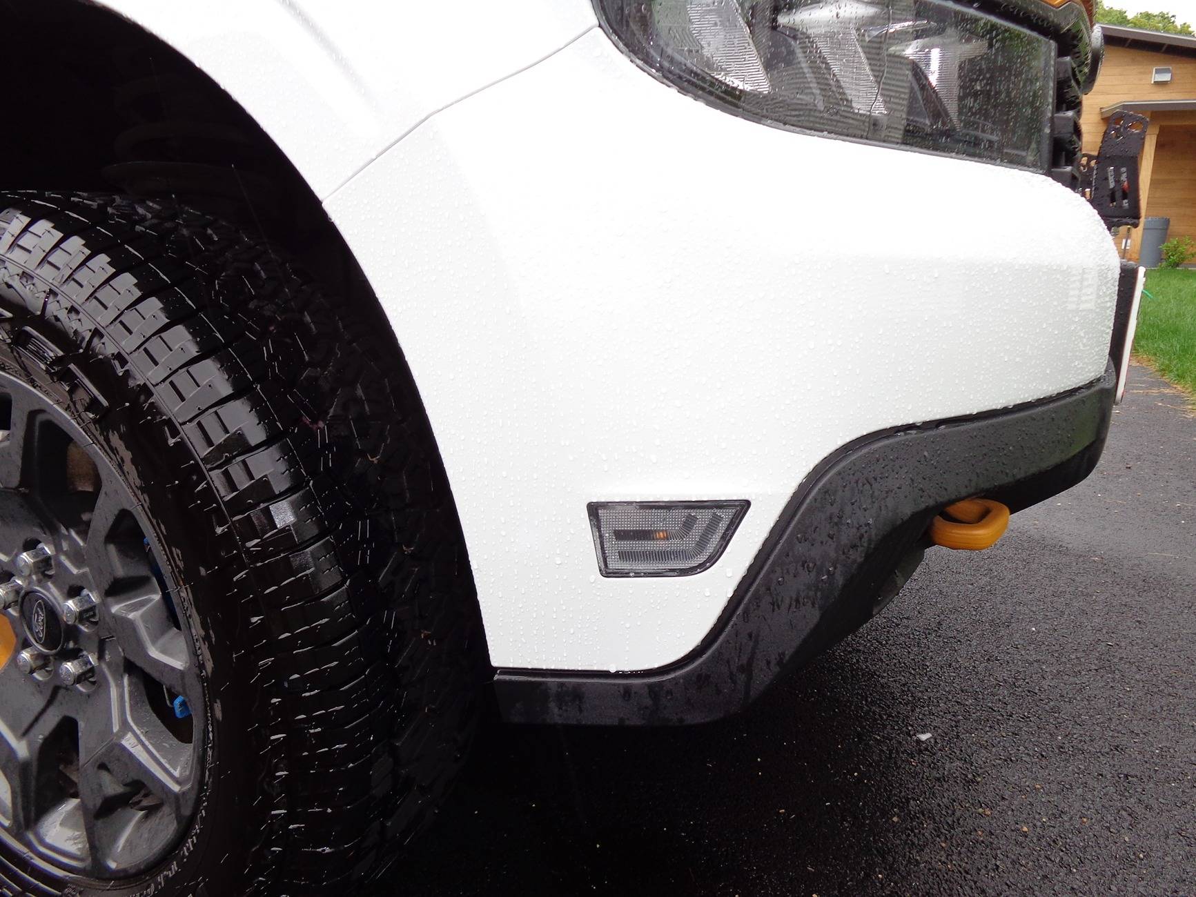

Forgot about the clean corner with Lasfit LE bulbs and the painted the brake calipers. I used G2 "Hawkins Blue" on the calipers, which is very similar to the blue on the Focus RS Brembos.
Ford Maverick Build Log: 2024 Lariat Tremor "Poundcake" DSC00714.JPG
Ford Maverick Build Log: 2024 Lariat Tremor "Poundcake" DSC00715.JPG
The blue will look much better behind the bronze Enkeis.

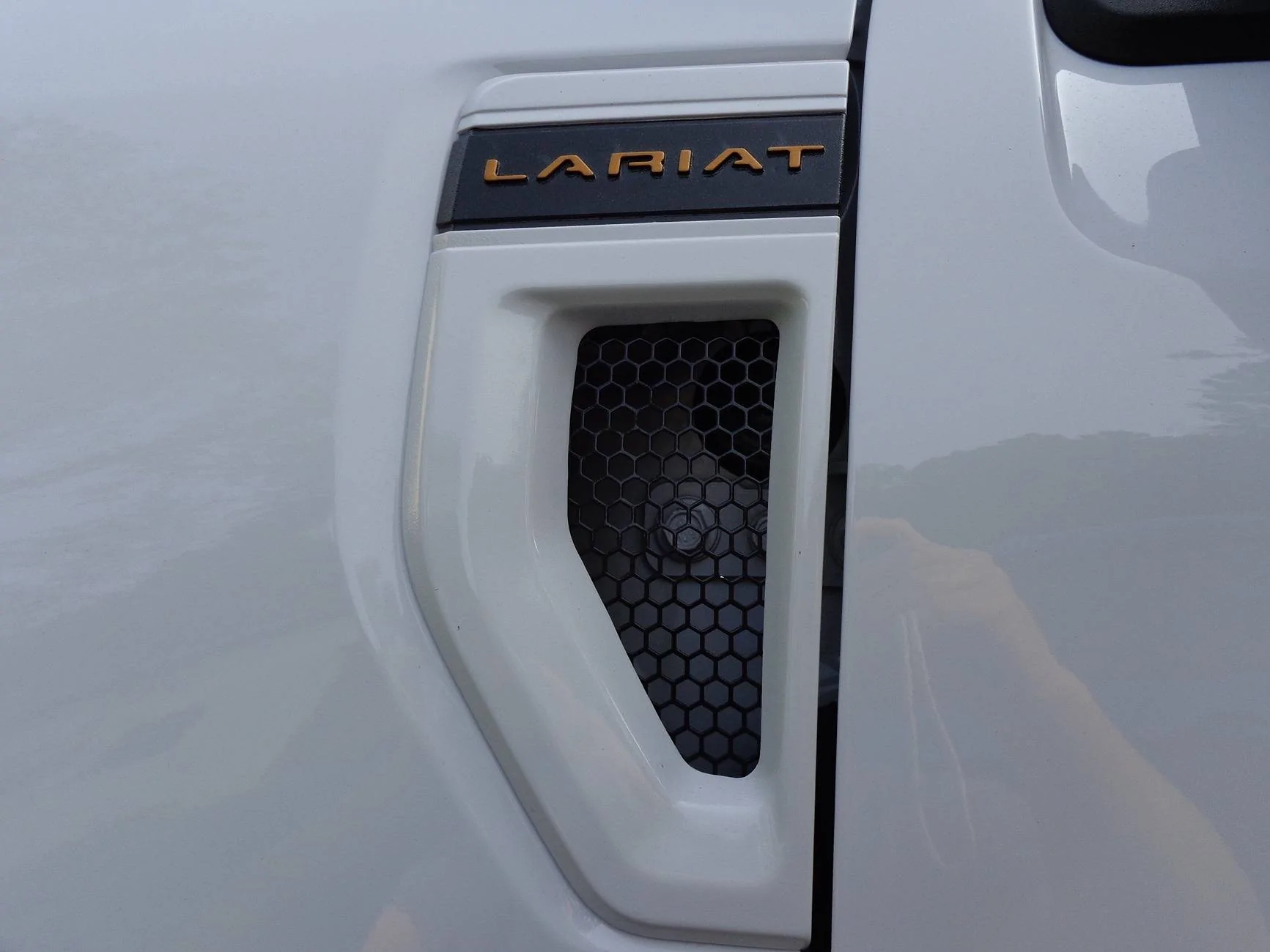

A better pic of the fender vents. You can hopefully see the hex mesh better.
Ford Maverick Build Log: 2024 Lariat Tremor "Poundcake" DSC00725

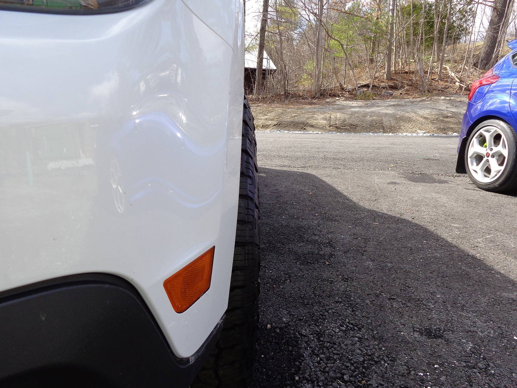

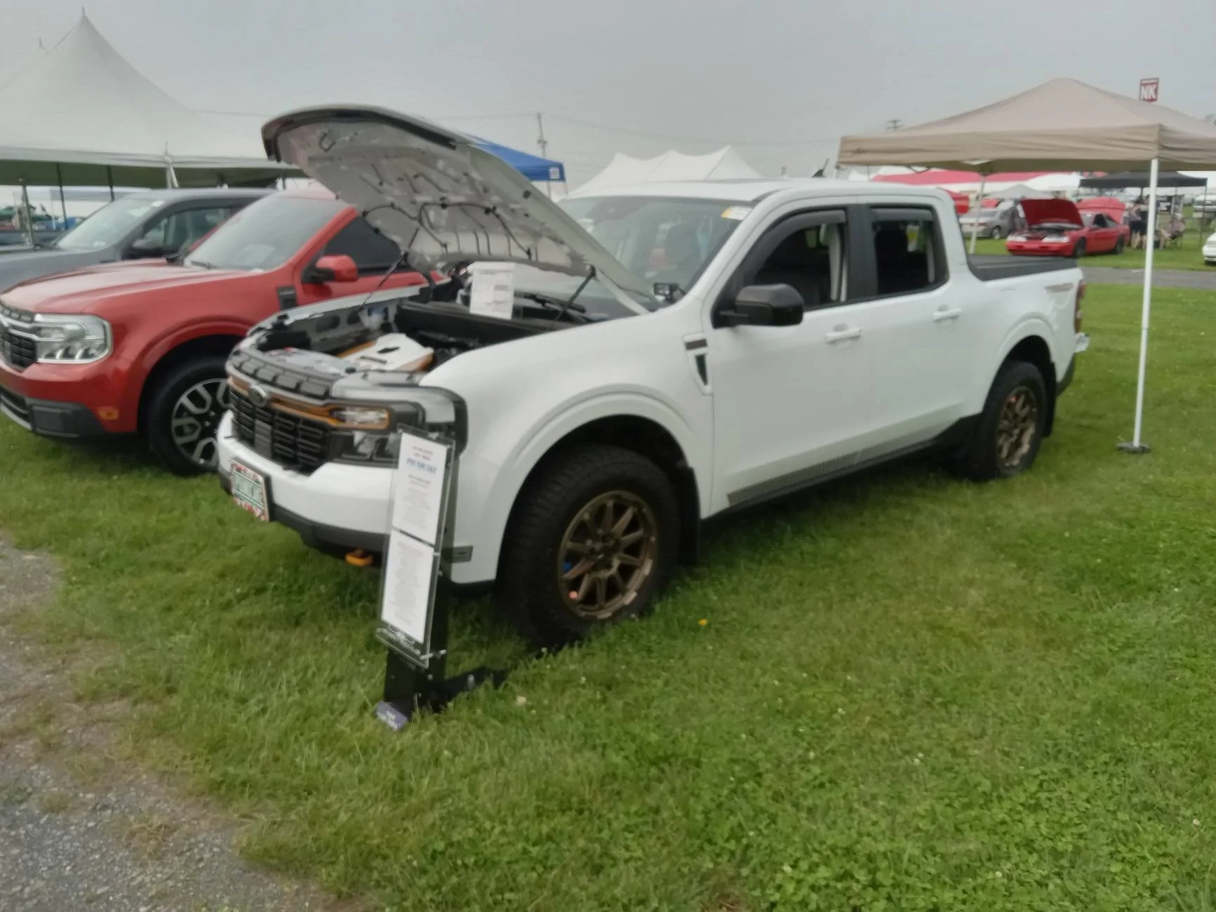

Two EcoBoosts ready to head for Carlisle Ford Nationals/MTC Roundup on Thursday morning.
Ford Maverick Build Log: 2024 Lariat Tremor "Poundcake" DSC00718.JPG
Got the Enkeis reinstalled, plus got some FORScan programming done: Global Windows, Auto Start/Stop delete, Double Honk delete, Ford Performance Splash Screen, and Turn-by-turn Nav in instrument cluster.
Both the Maverick and the ST are pretty much loaded-up with gear and ready to head-out.
Ford Maverick Build Log: 2024 Lariat Tremor "Poundcake" DSC00723.JPG
Ford Maverick Build Log: 2024 Lariat Tremor "Poundcake" DSC00722.JPG

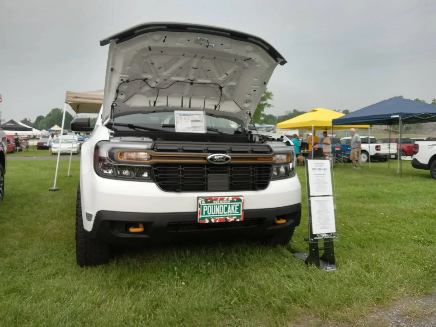

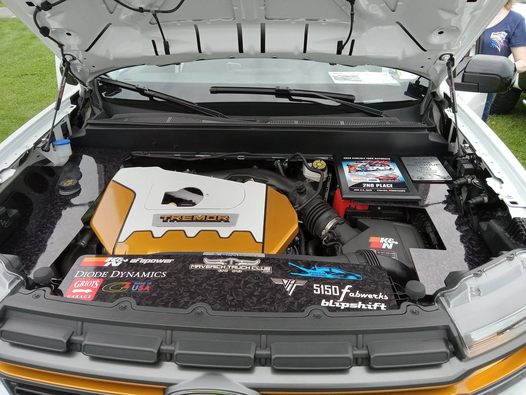

I have some catching up to do, but here are a few pics from the 2025 Maverick Truck Club Roundup at the Carlisle Ford Nationals.
Ford Maverick Build Log: 2024 Lariat Tremor "Poundcake" 20250606_084931
Ford Maverick Build Log: 2024 Lariat Tremor "Poundcake" 20250606_084941
Ford Maverick Build Log: 2024 Lariat Tremor "Poundcake" 20250606_084946
Ford Maverick Build Log: 2024 Lariat Tremor "Poundcake" 20250608_095054
Ford Maverick Build Log: 2024 Lariat Tremor "Poundcake" 20250608_095106

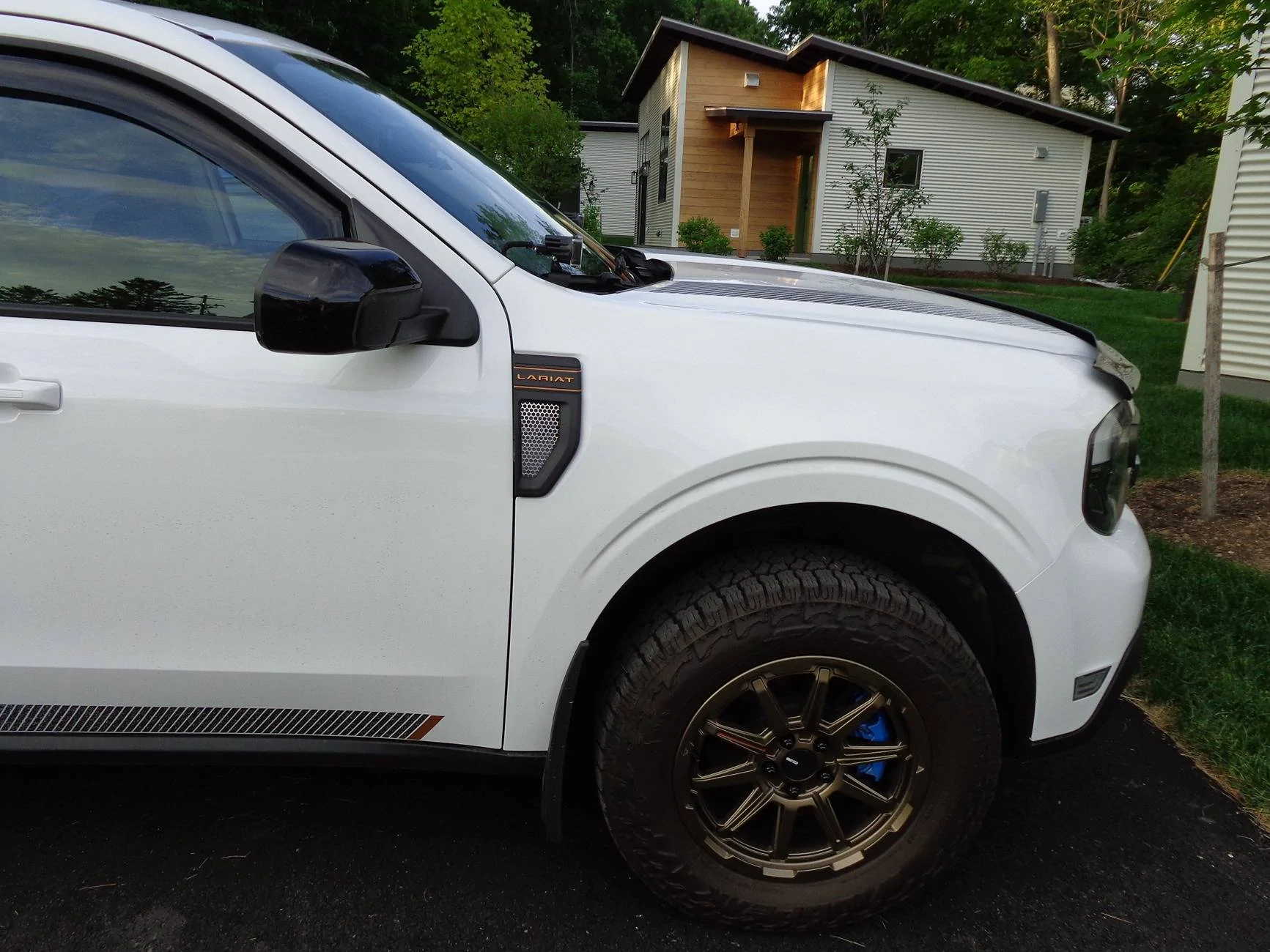

Many more additions to post, but I just finished Version 2.0 of my customized, semi-functional fender vents. The cutout/insert is quite a bit larger on these ones, and I'll probably leave them in the original textured black finish instead of color-matching them.
Ford Maverick Build Log: 2024 Lariat Tremor "Poundcake" DSC00730.JPG
Ford Maverick Build Log: 2024 Lariat Tremor "Poundcake" DSC00726
Ford Maverick Build Log: 2024 Lariat Tremor "Poundcake" DSC00727
