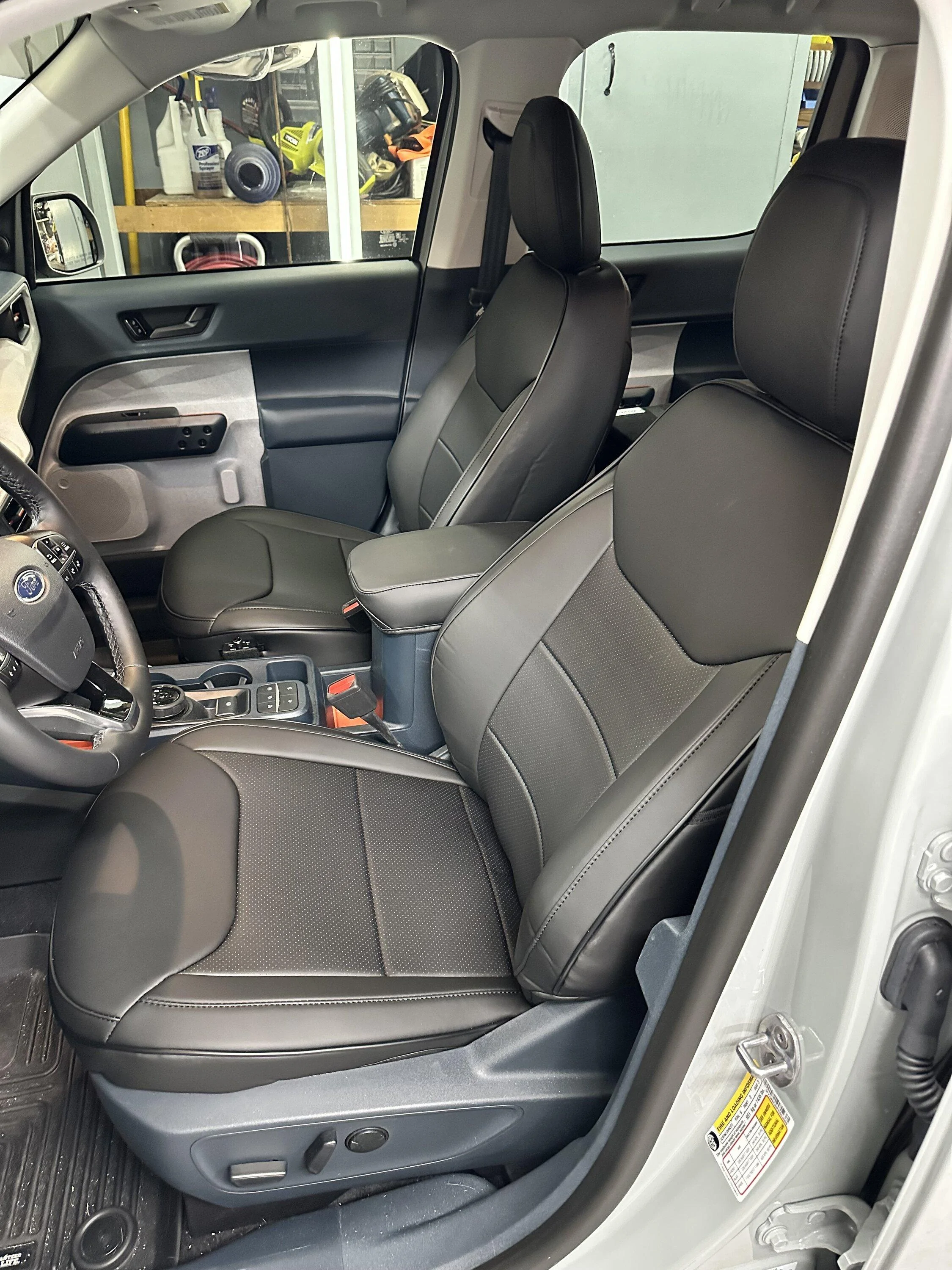

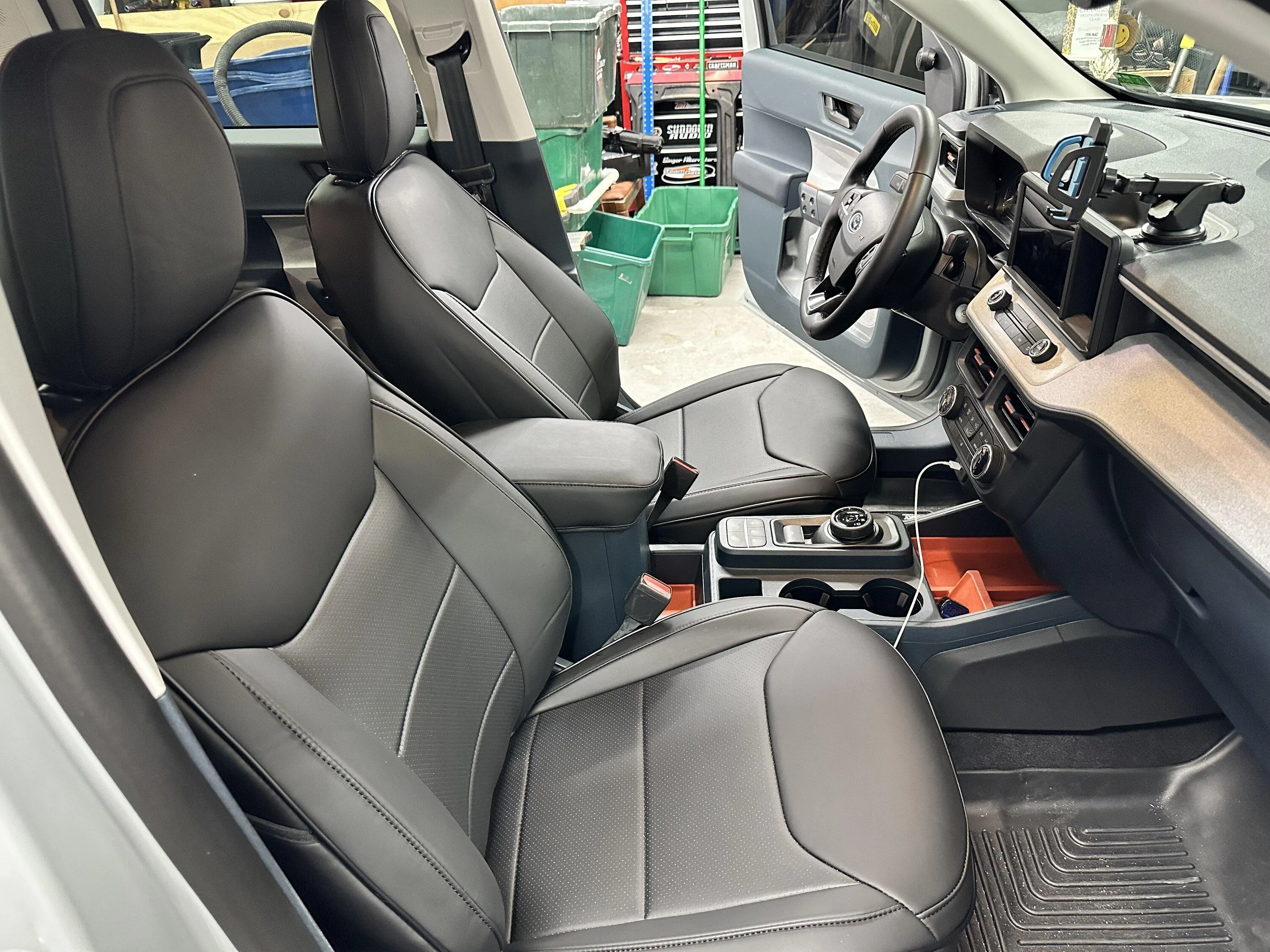

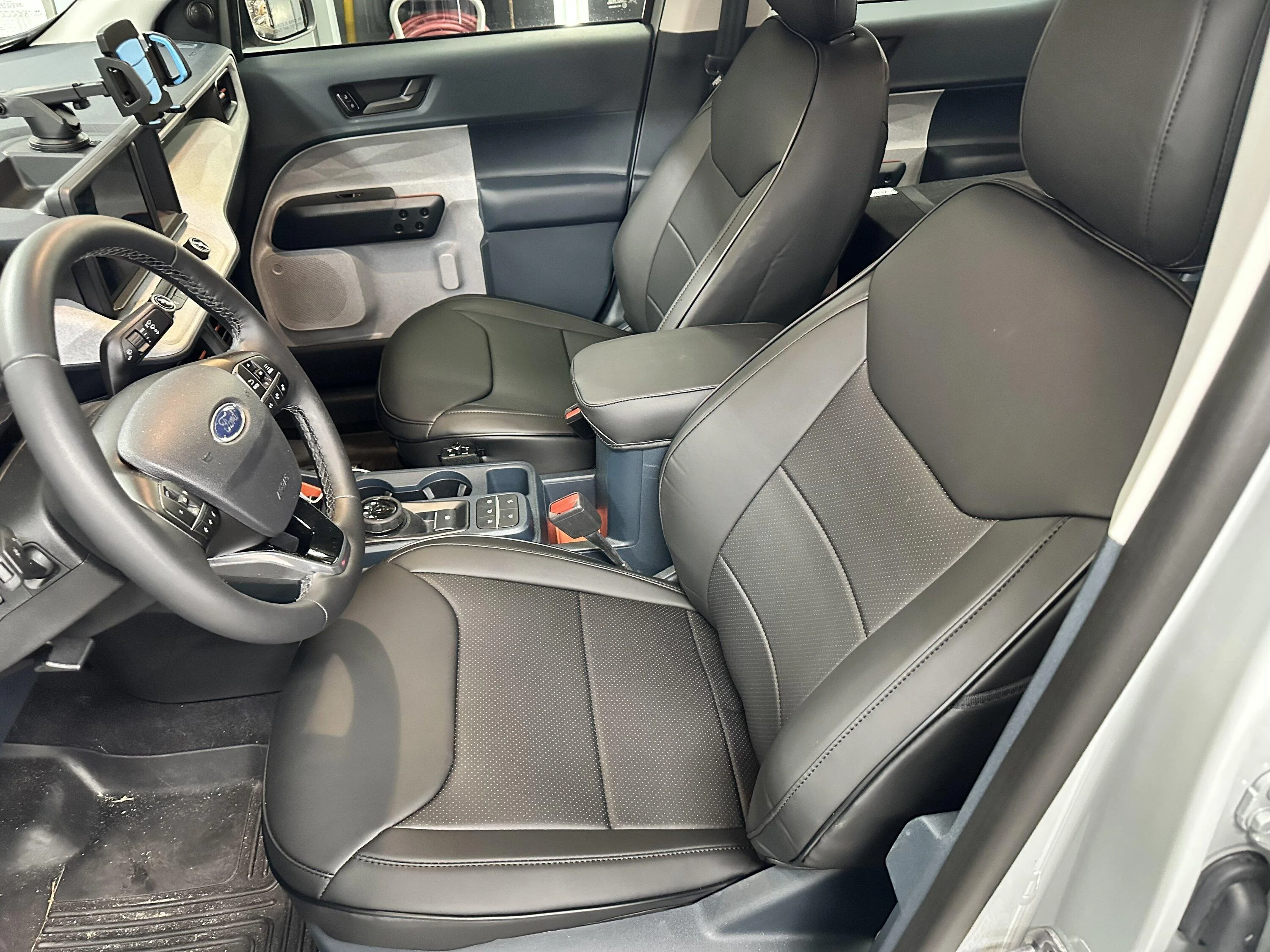

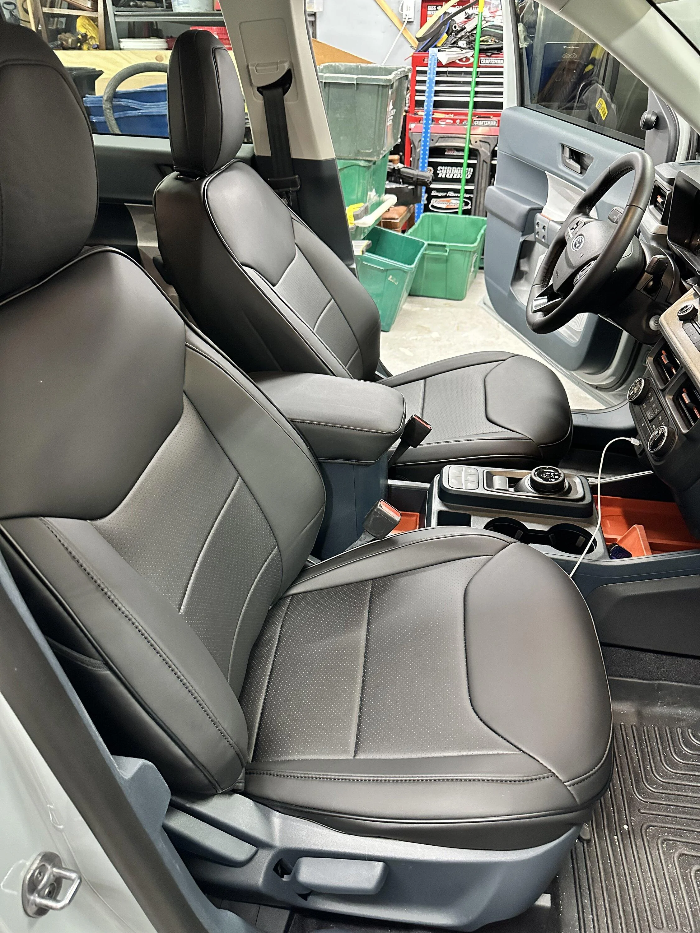

Picked up one of the first sets of seat covers from @MABETT the install was a little tricky but once I saw the video on youtube they posted about installing the Bronco sport seat covers I was able to figure it out very quickly.
Initial impressions are good, but having seat covers of this style before I will reserve final judgement for after a week or so when they have settled in and conformed to the seats more.
Here are some pics:

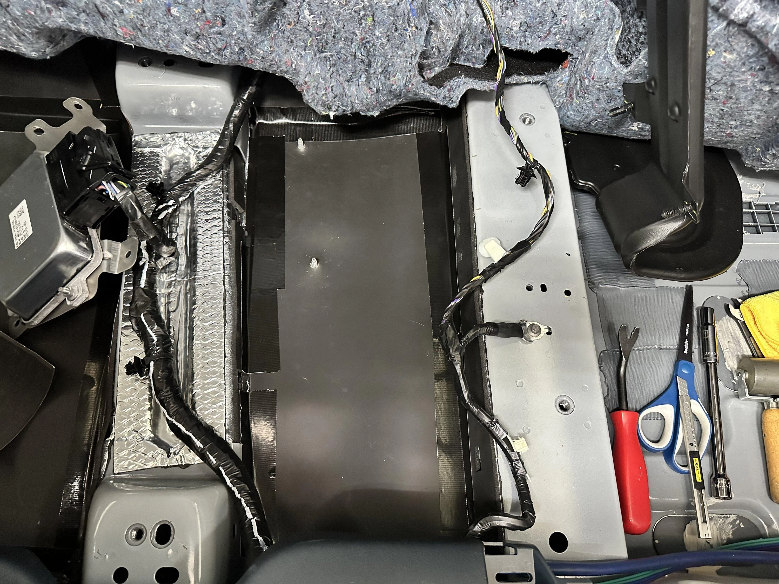

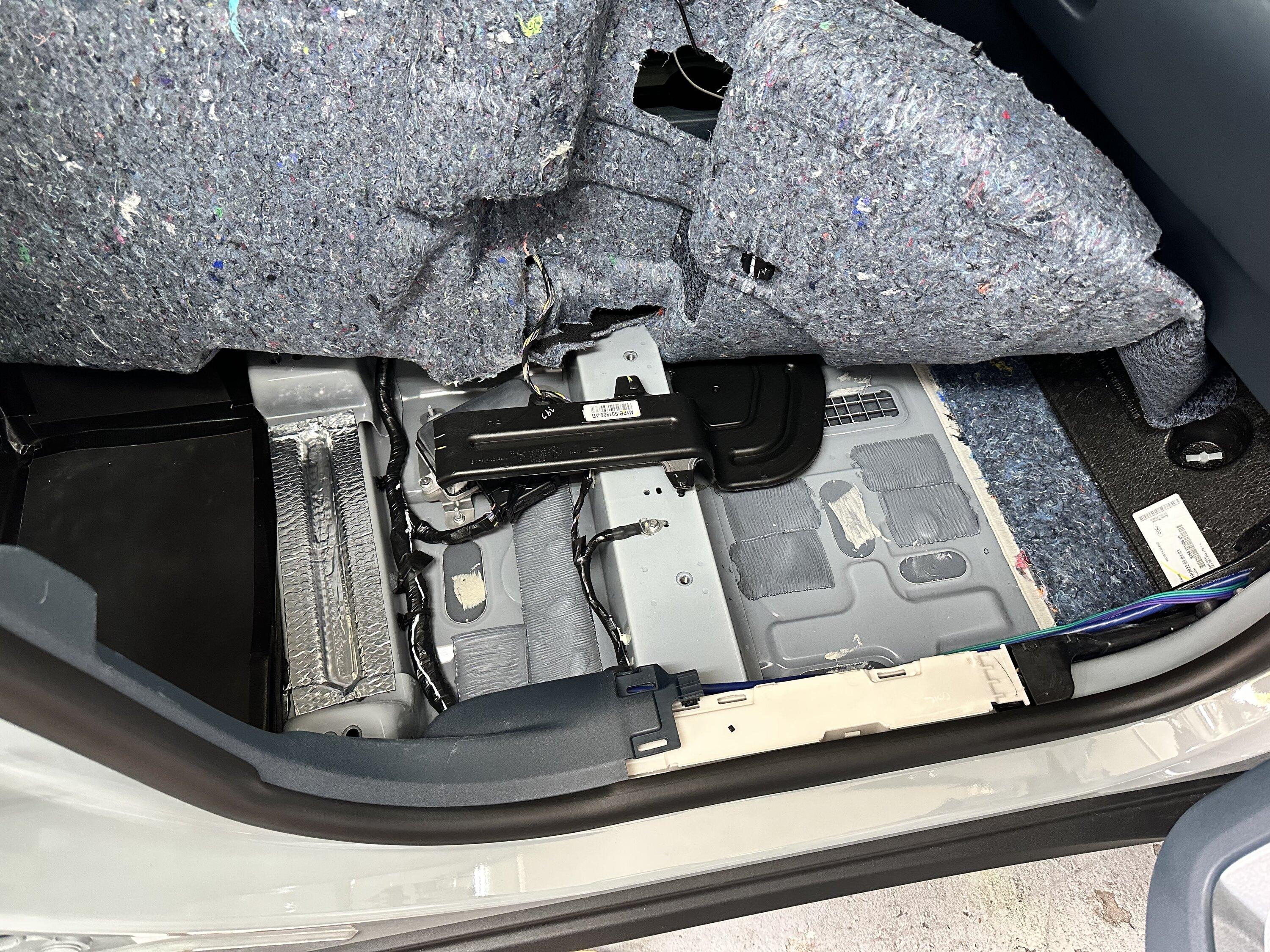

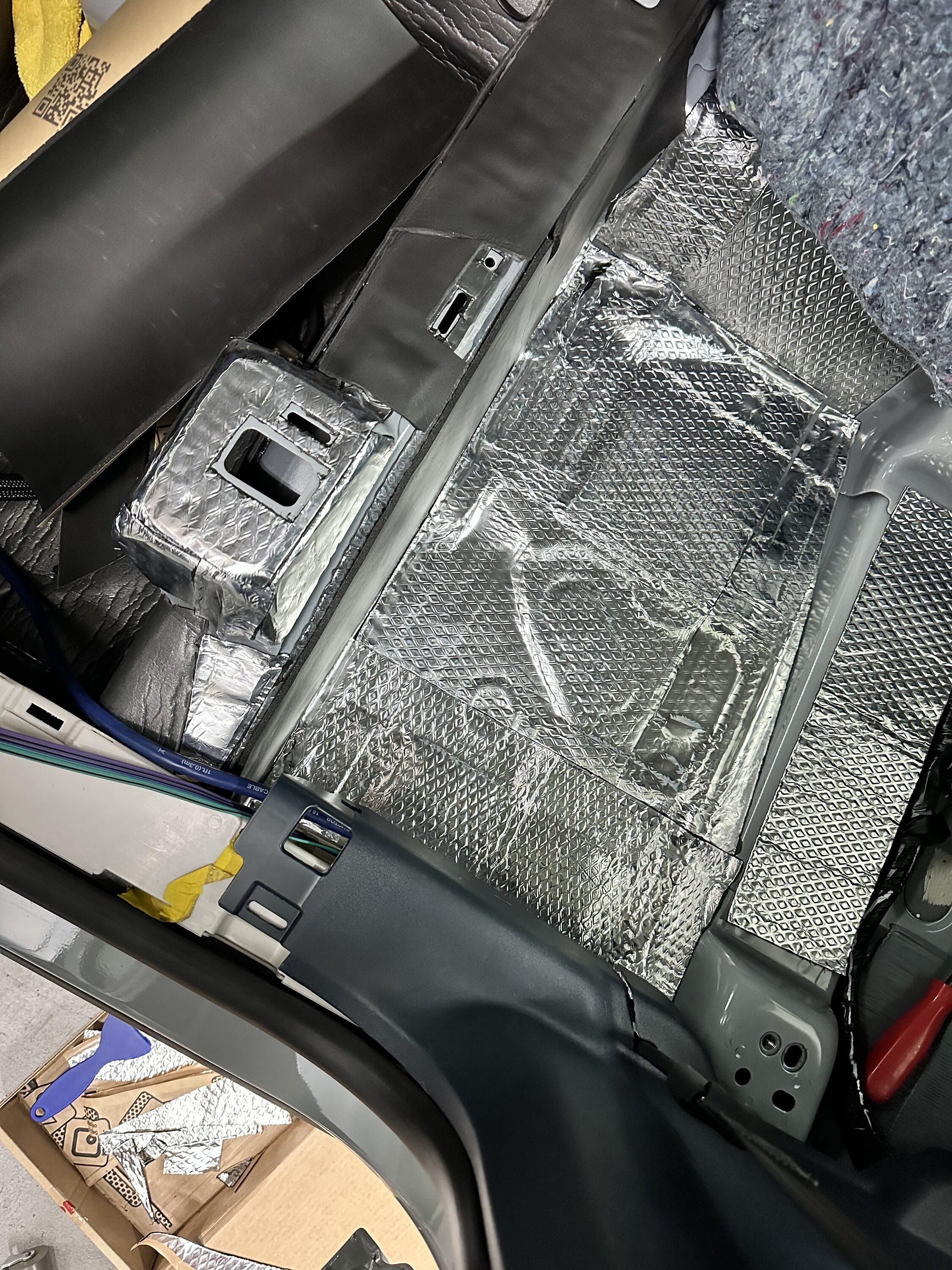

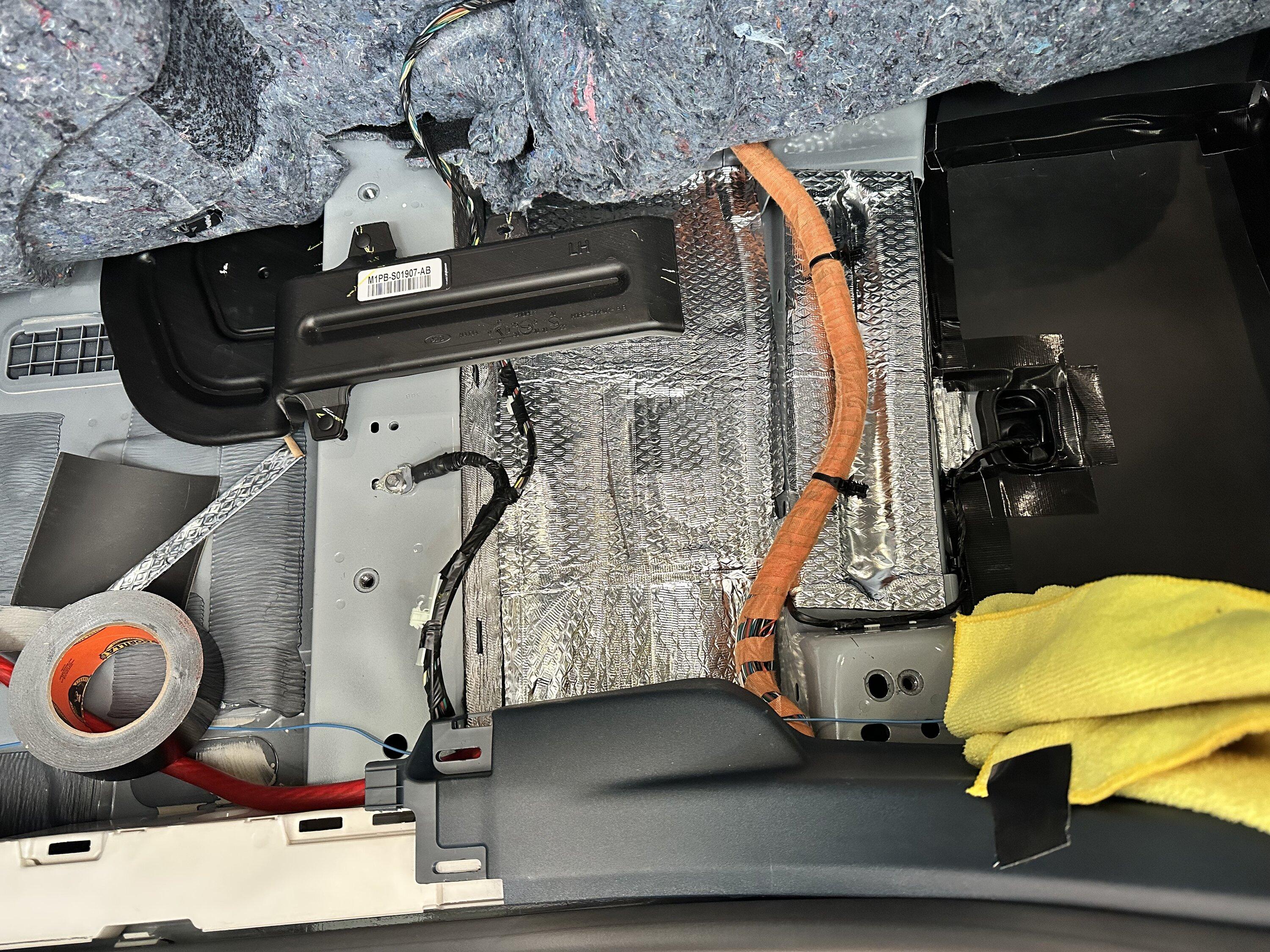

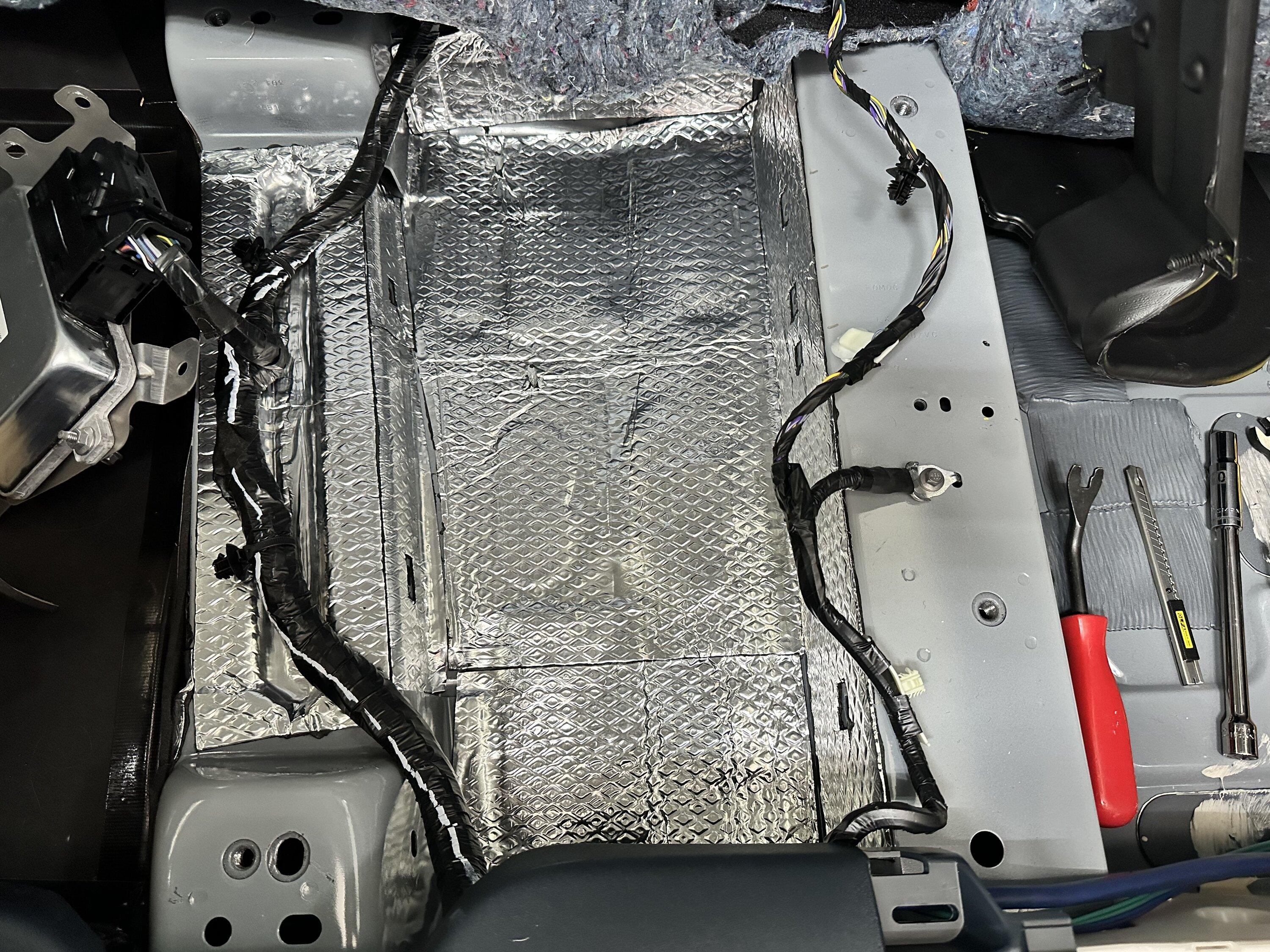

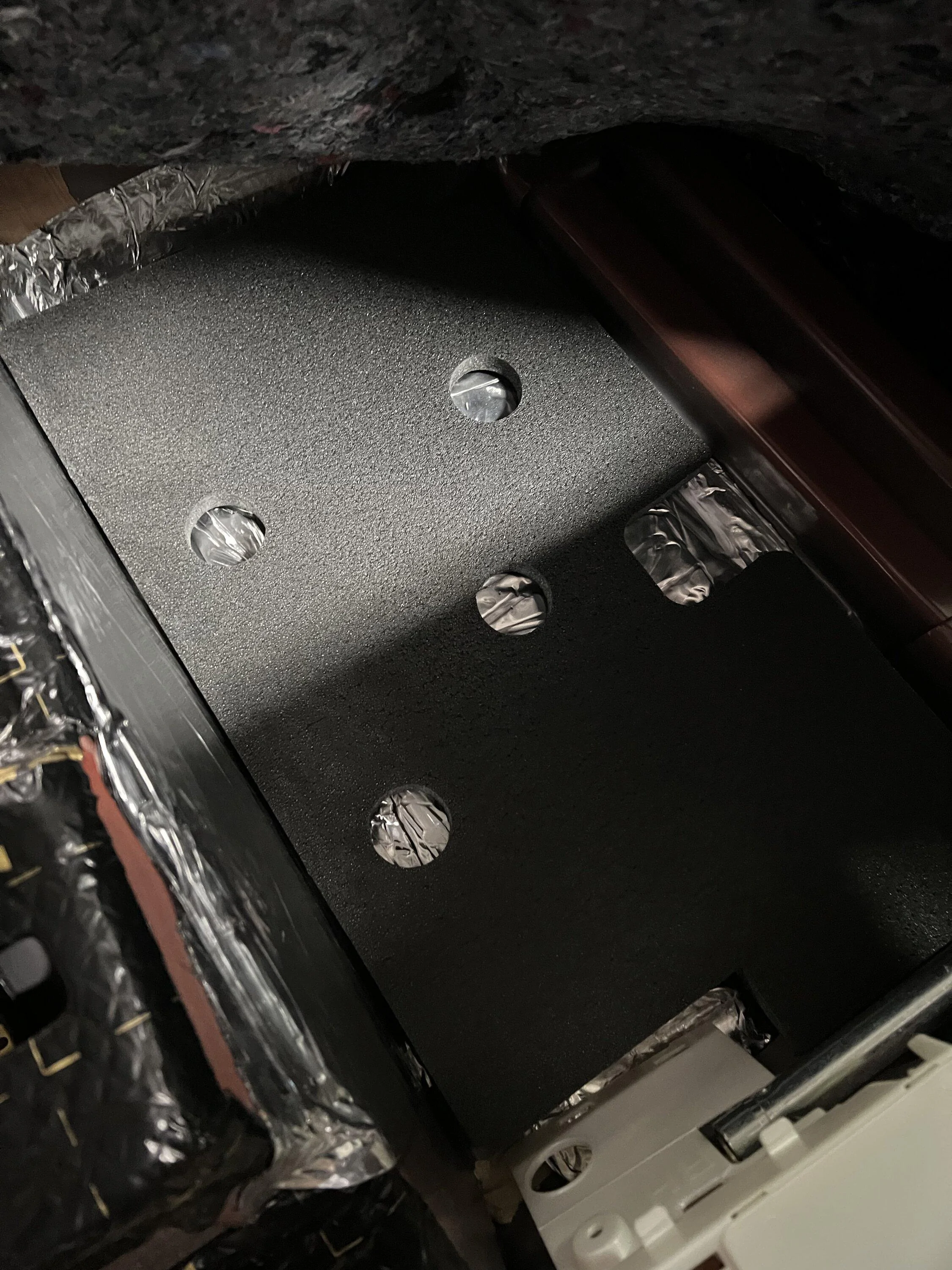

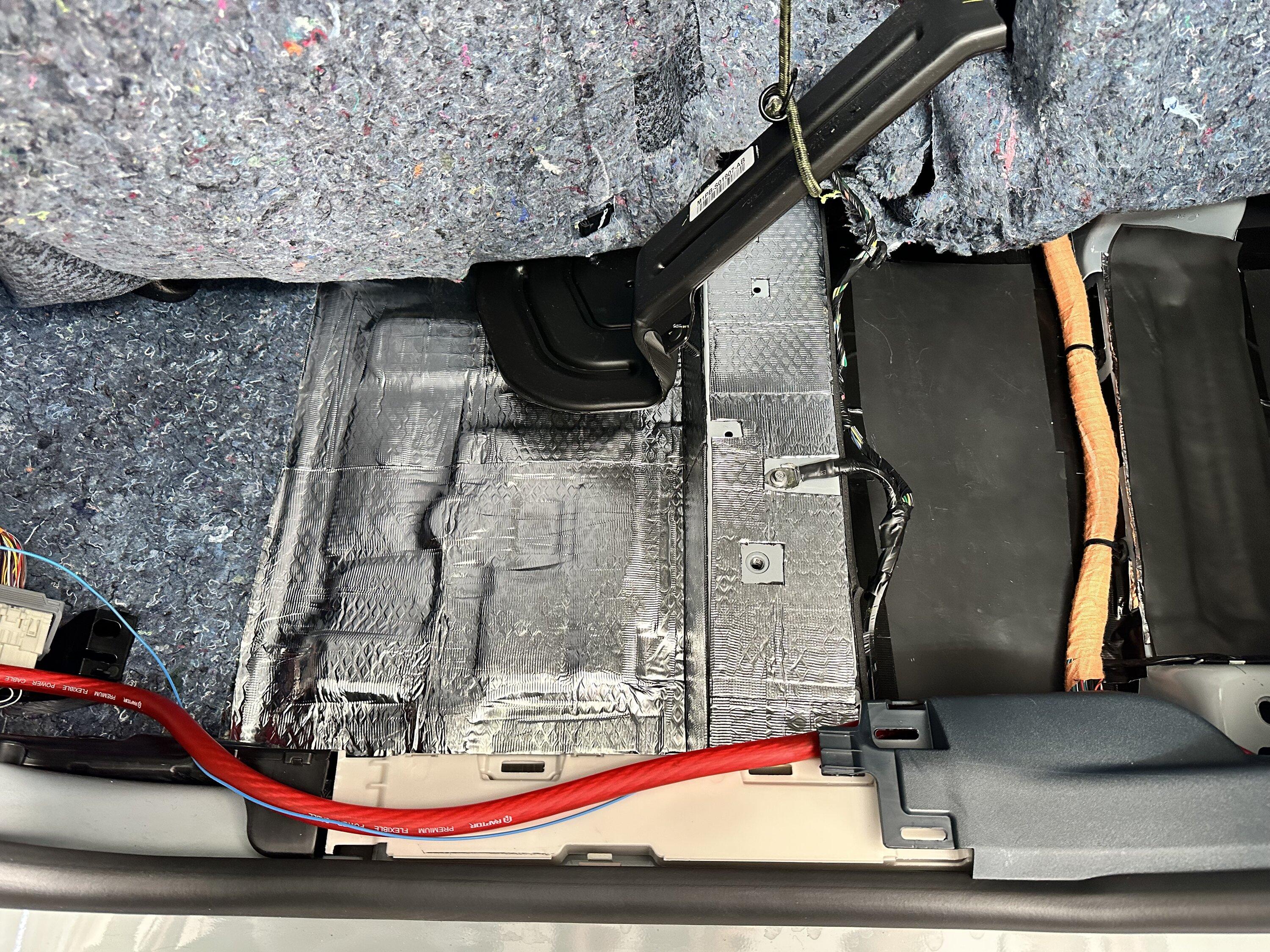

Got started on the passenger side floor area, I have a feeling I will only be getting this side done this weekend. The layers are simple, deadener, closed cell foam, and then MLV. I am exploring the option of maybe putting an extra layer of jute under the carpet in the pan areas. And yes I am being slightly lazy I am not doing under the center console area.

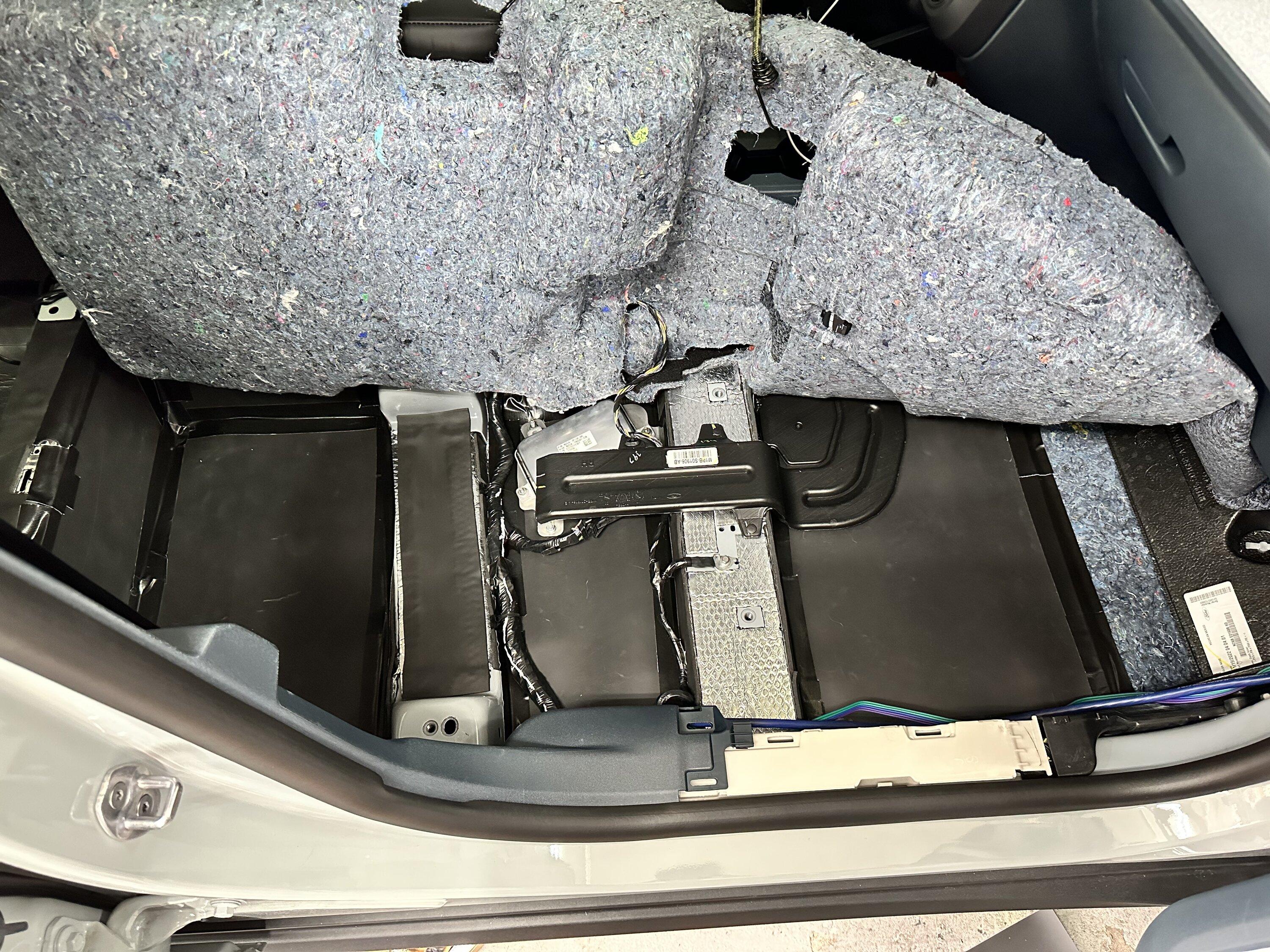

Was there a foam piece in the rear floor area? Or is that a Lariat only thing?

Yes I removed it and it will not be going back in.

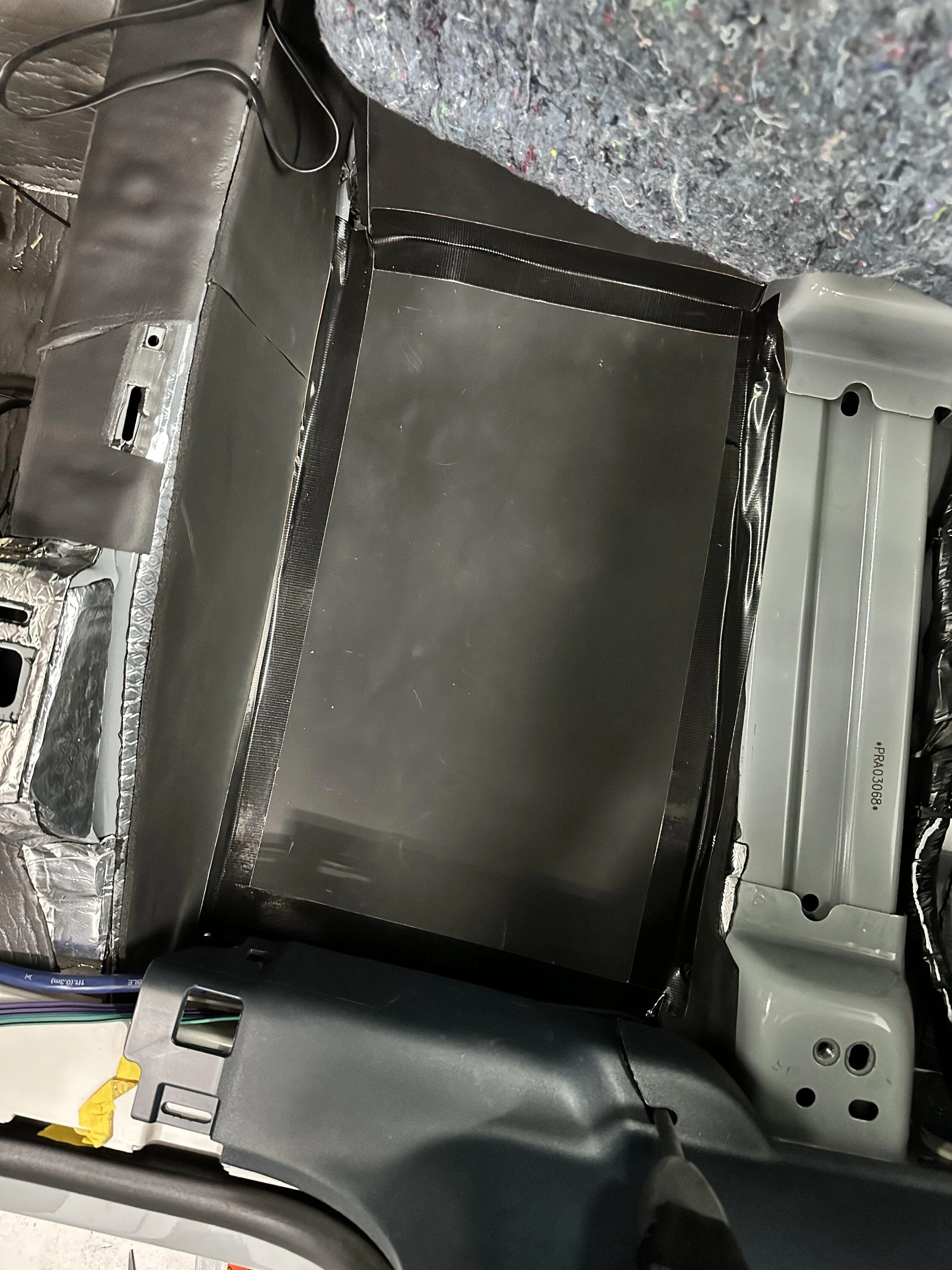

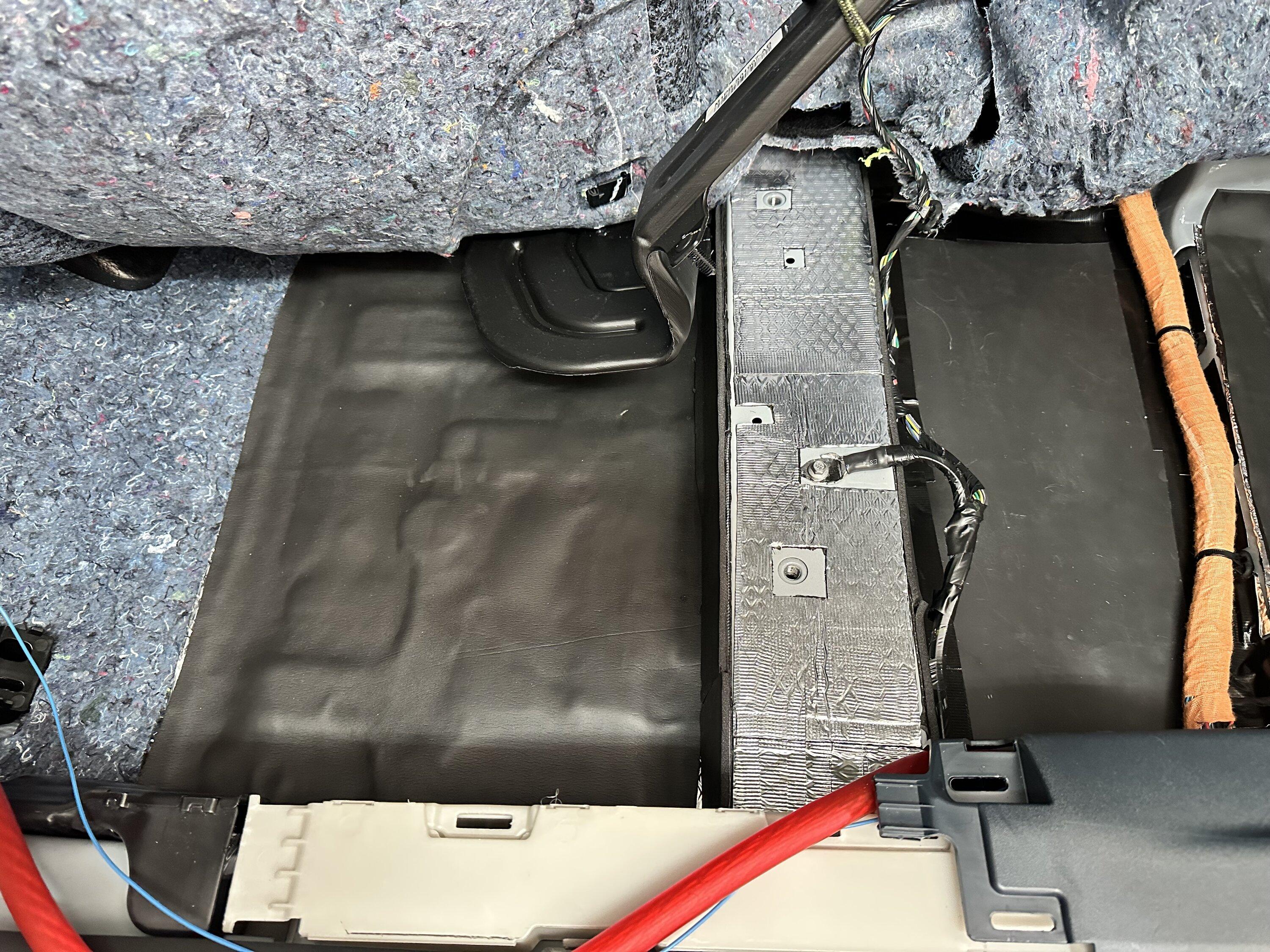

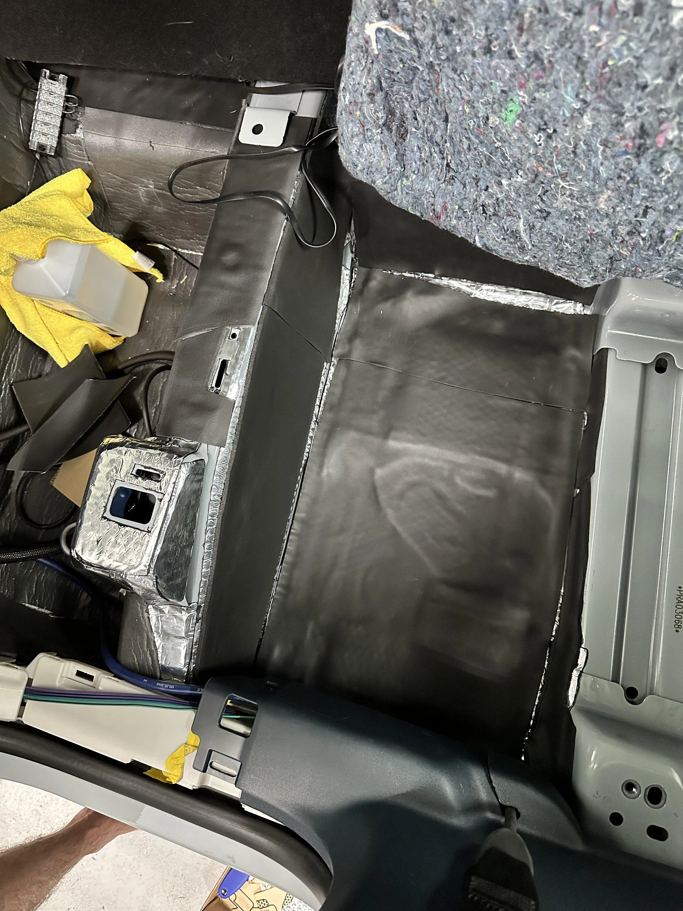

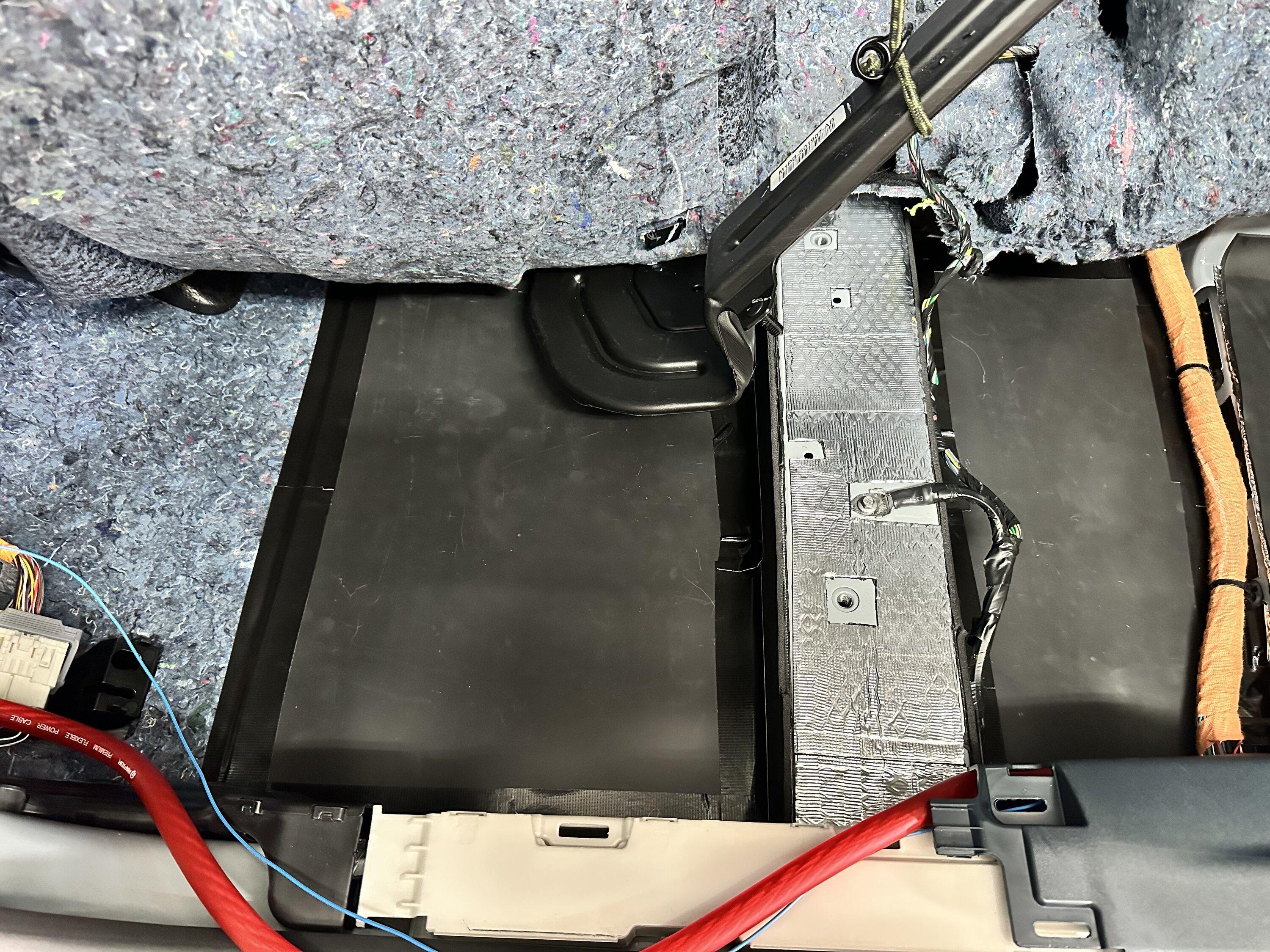

Well got the passenger side all wrapped up and done. I will do the driver side next weekend as I do not want to rush through it tomorrow.

I missed a couple pics of just the foam before the MLV, but its under there.

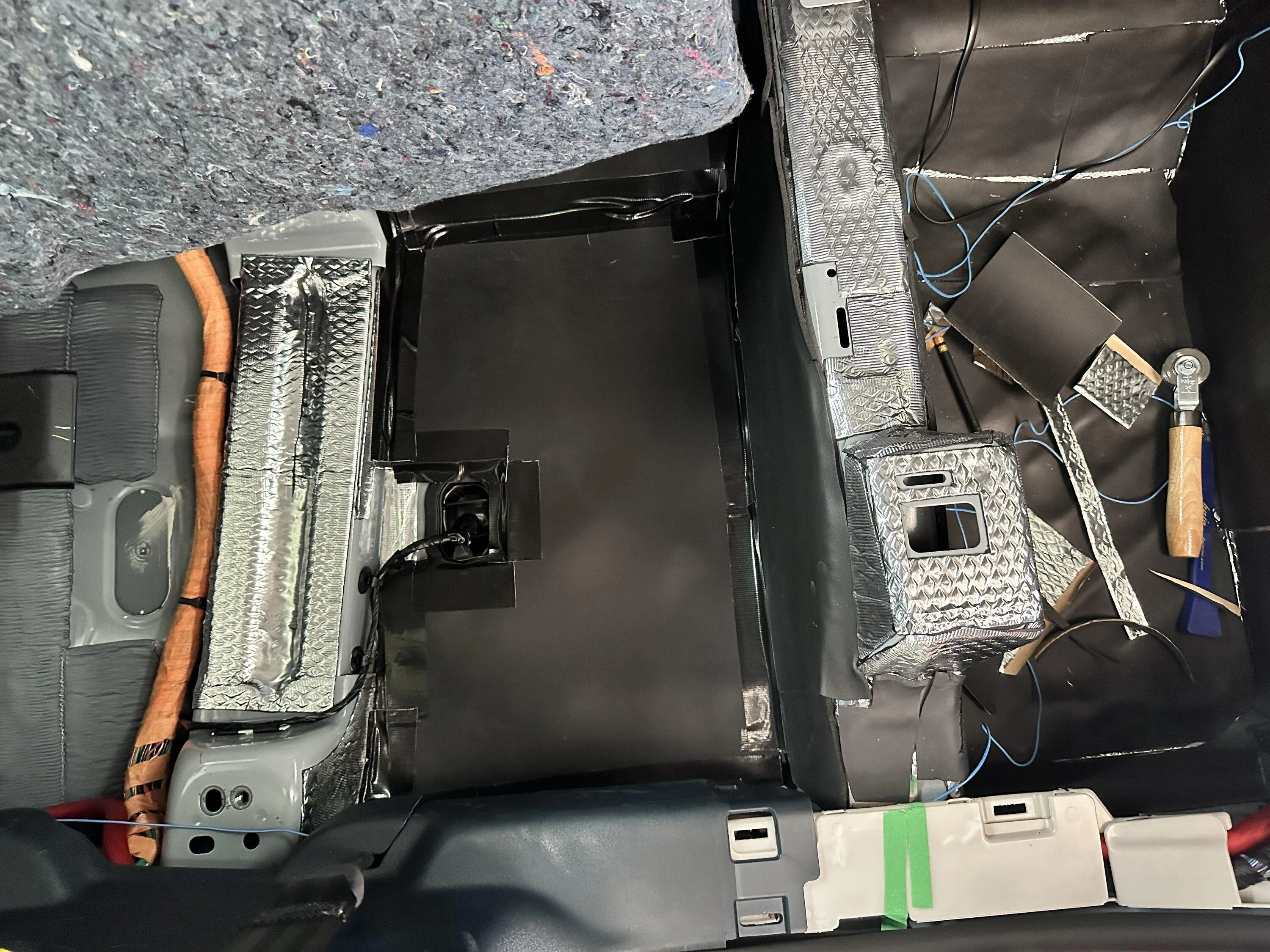

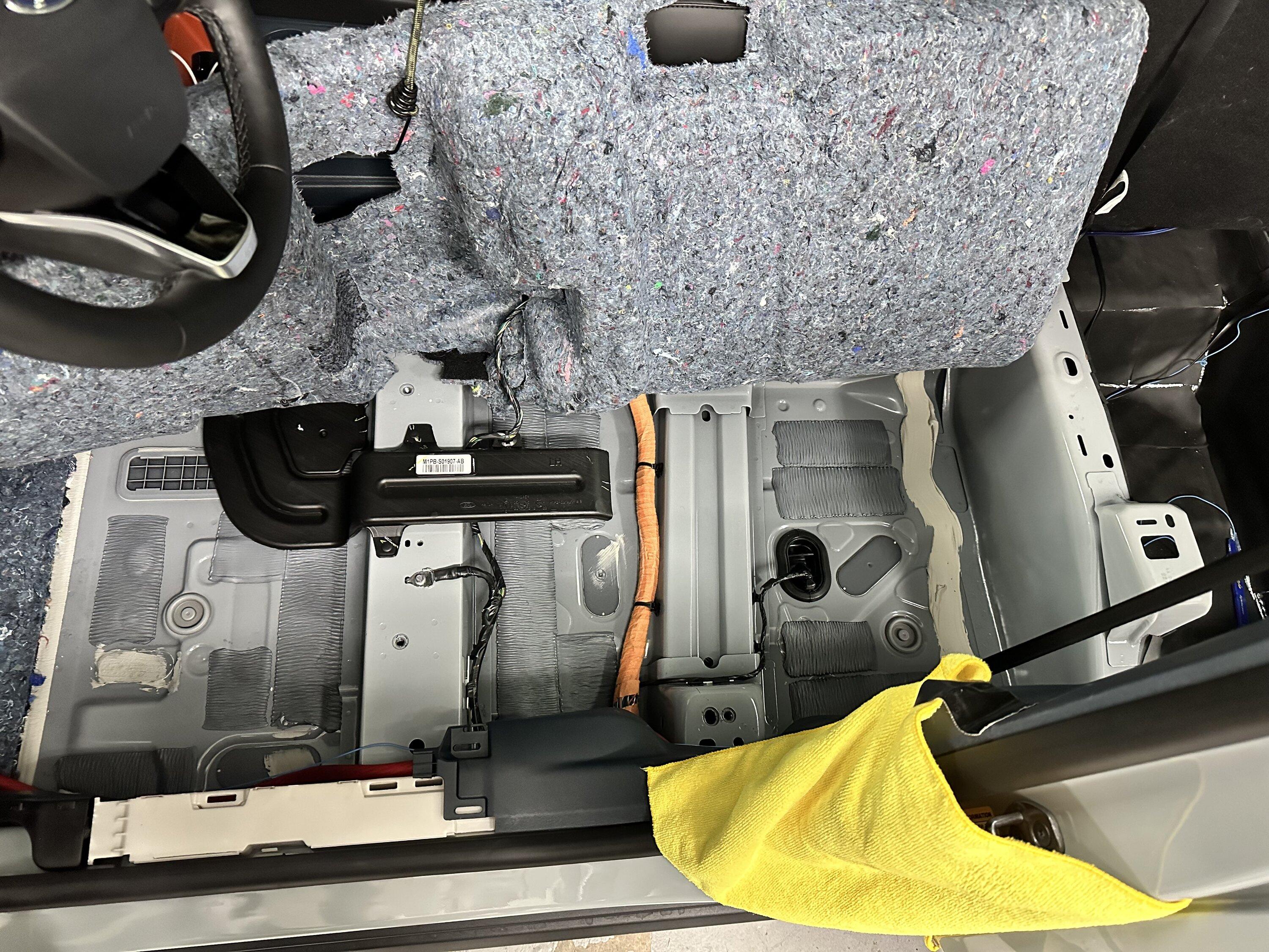

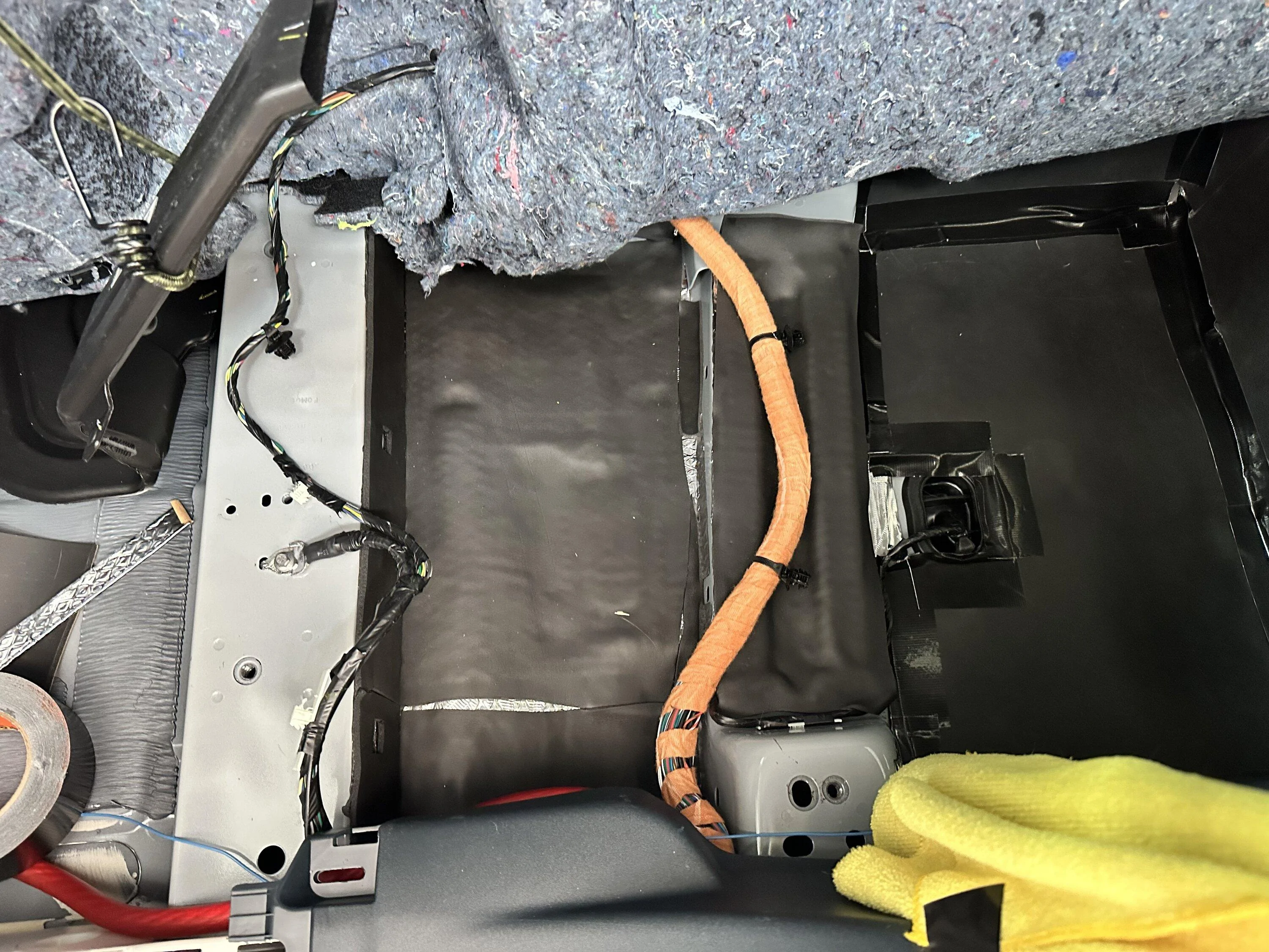

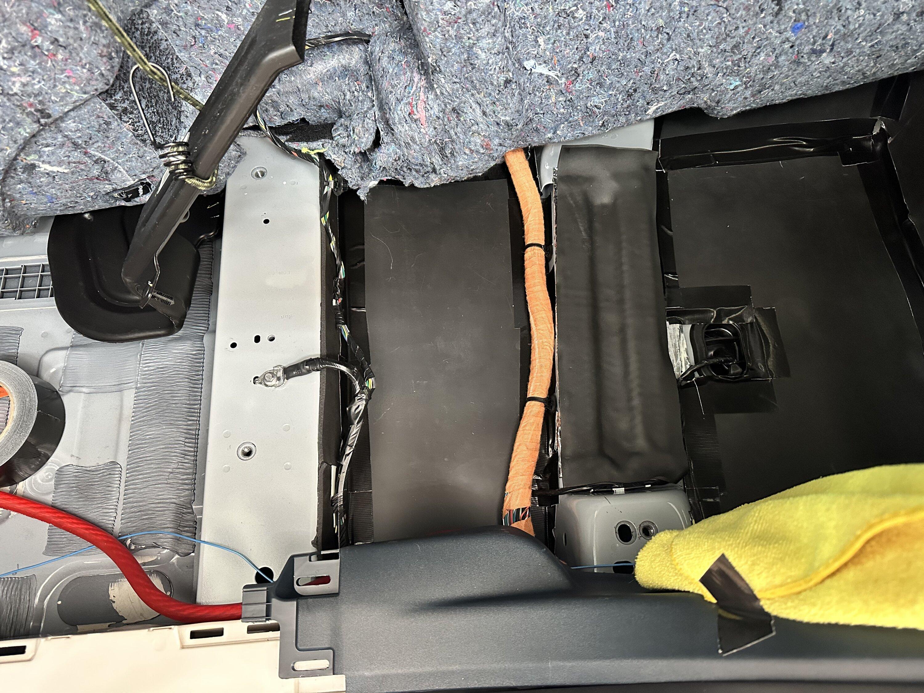

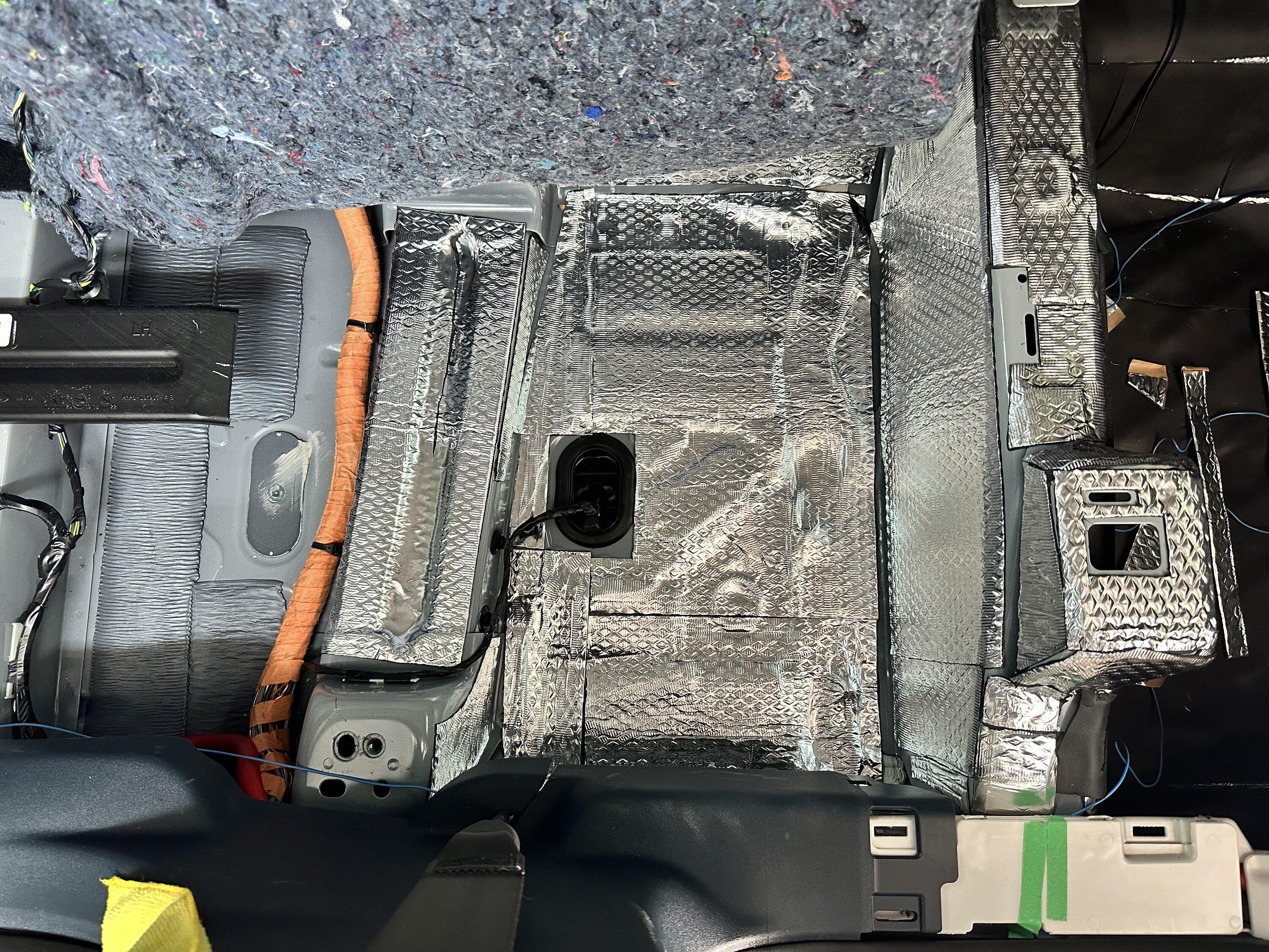

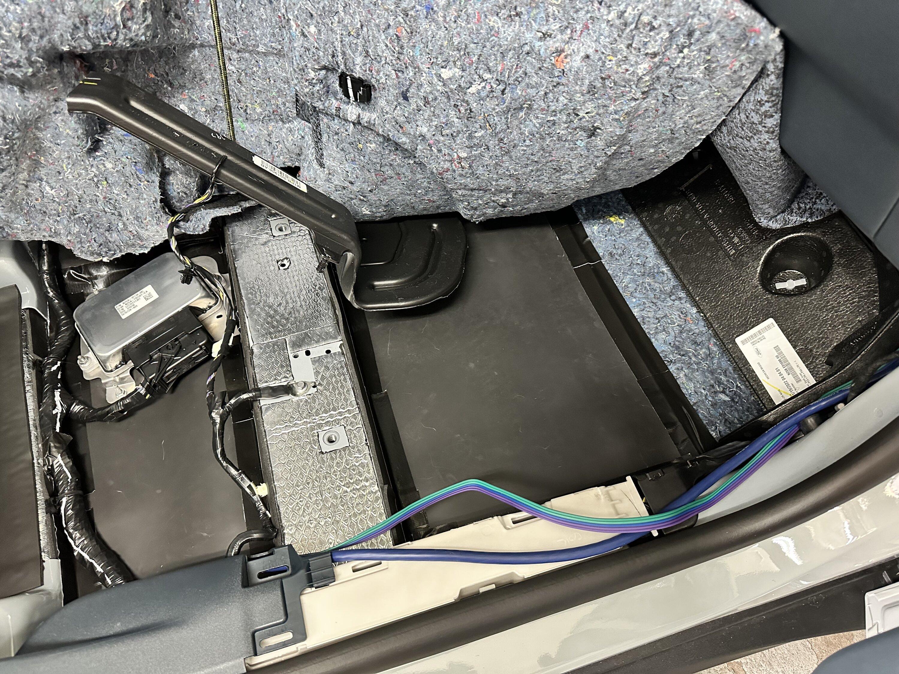

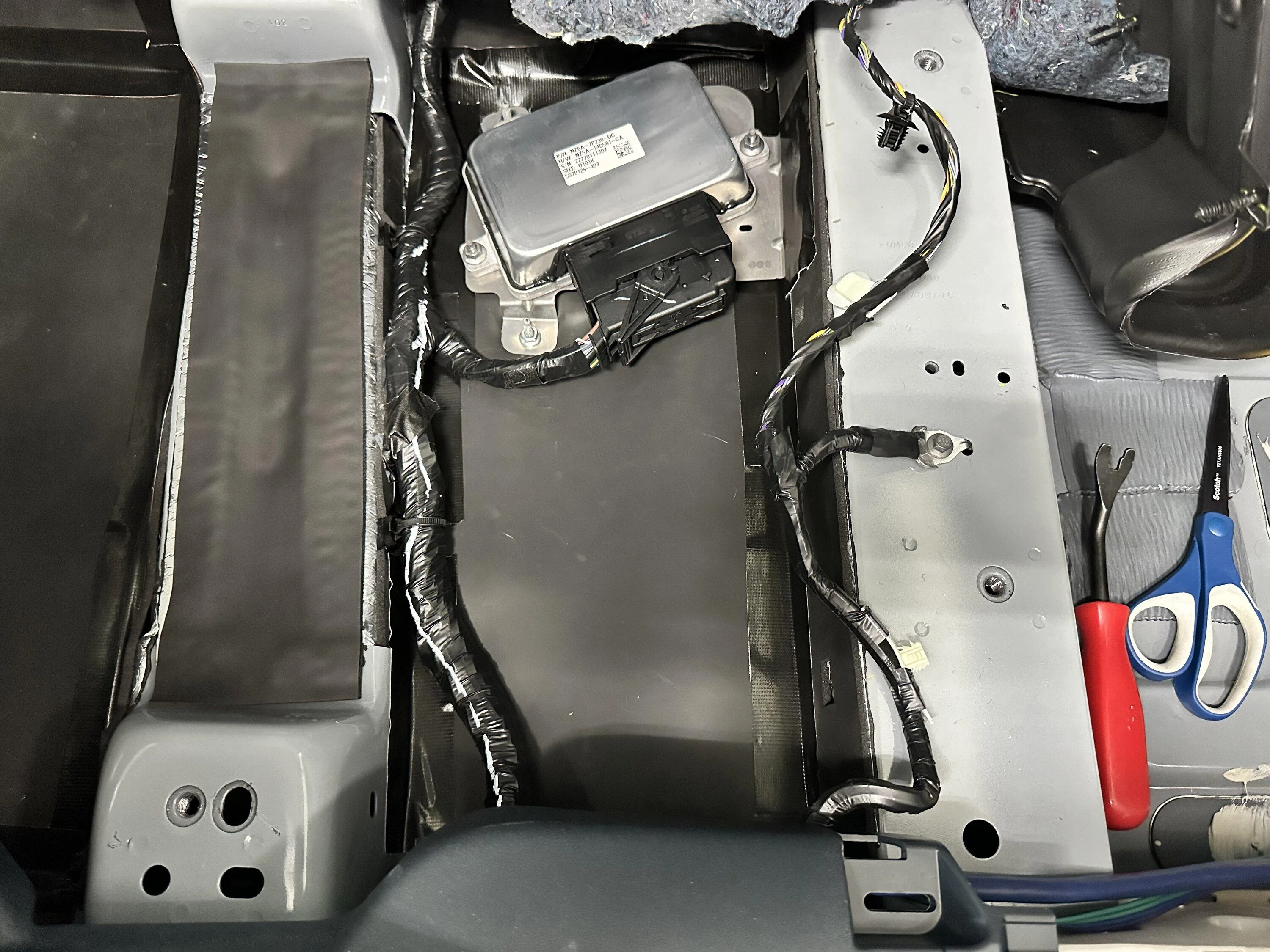

So I had the day off today and just said I want this done so I have gotten the driver floor board sound deadened, closed cell foamed and MLV applied.

All that is left now is to do the roof, I may tackle that this weekend.
