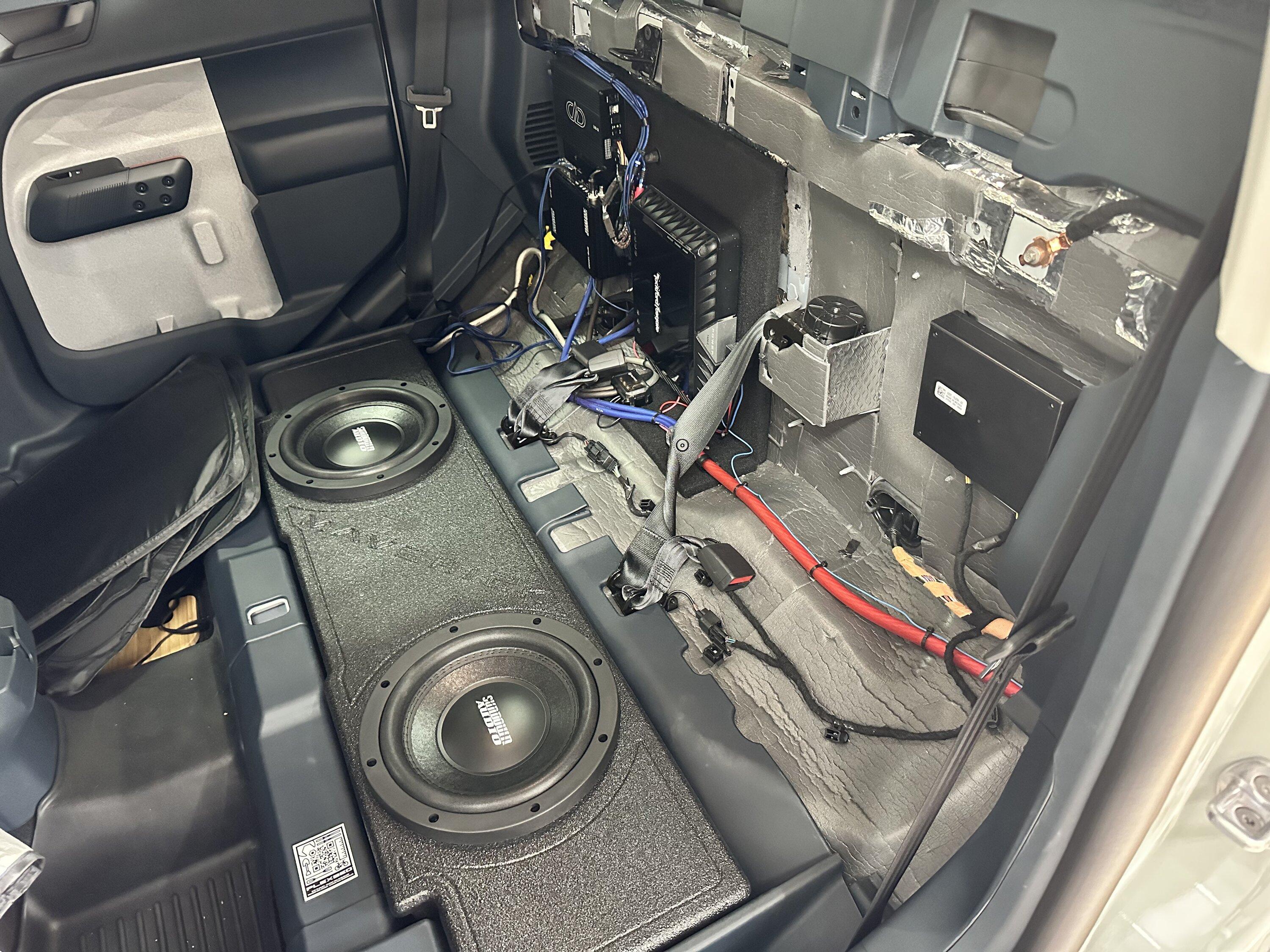

And for now its done, I will put the covers on the back seat and put it back in next weekend.
VERY impressed with these subs, the are performing very well. Not as much LOW end but that might improve as they get broken in.

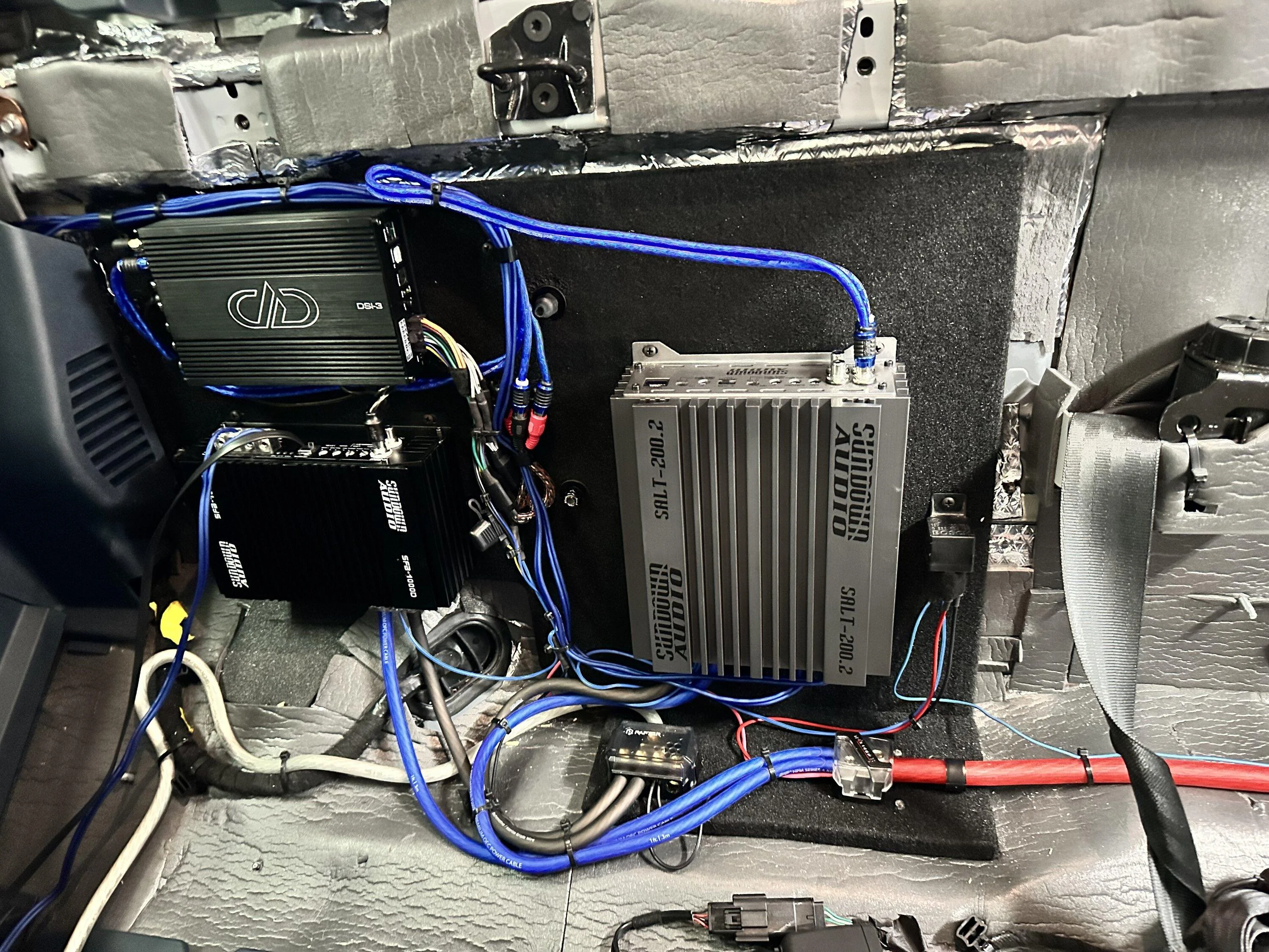

As much as I love class A/B amps they get hot fast, so I ordered up a new amp for the mids/highs and slapped it in today.
Does 200 x 2 @ 4 ohms RMS and 325 x 2 @ 2 ohms RMS which it is currently wired down to 2 ohms. I also added around 6-7oz of poly fill to the enclosure, not sure if I will keep it in but for the cost $6 I figured give it a shot.

Did you swap amps because it’s touching the seat or something?
My 4 channel RF amp barely gets hot at all (it’s the big one that uses its heat sinks the most, ugh)
I was running my T400-2 at 2ohm, and because of the mounting orientation it was getting to me uncomfortably hot on the top edge heatsink. The new class D full range is at 2ohm and after a 1.5 hour drive at a very good click volume it was barely warm.
