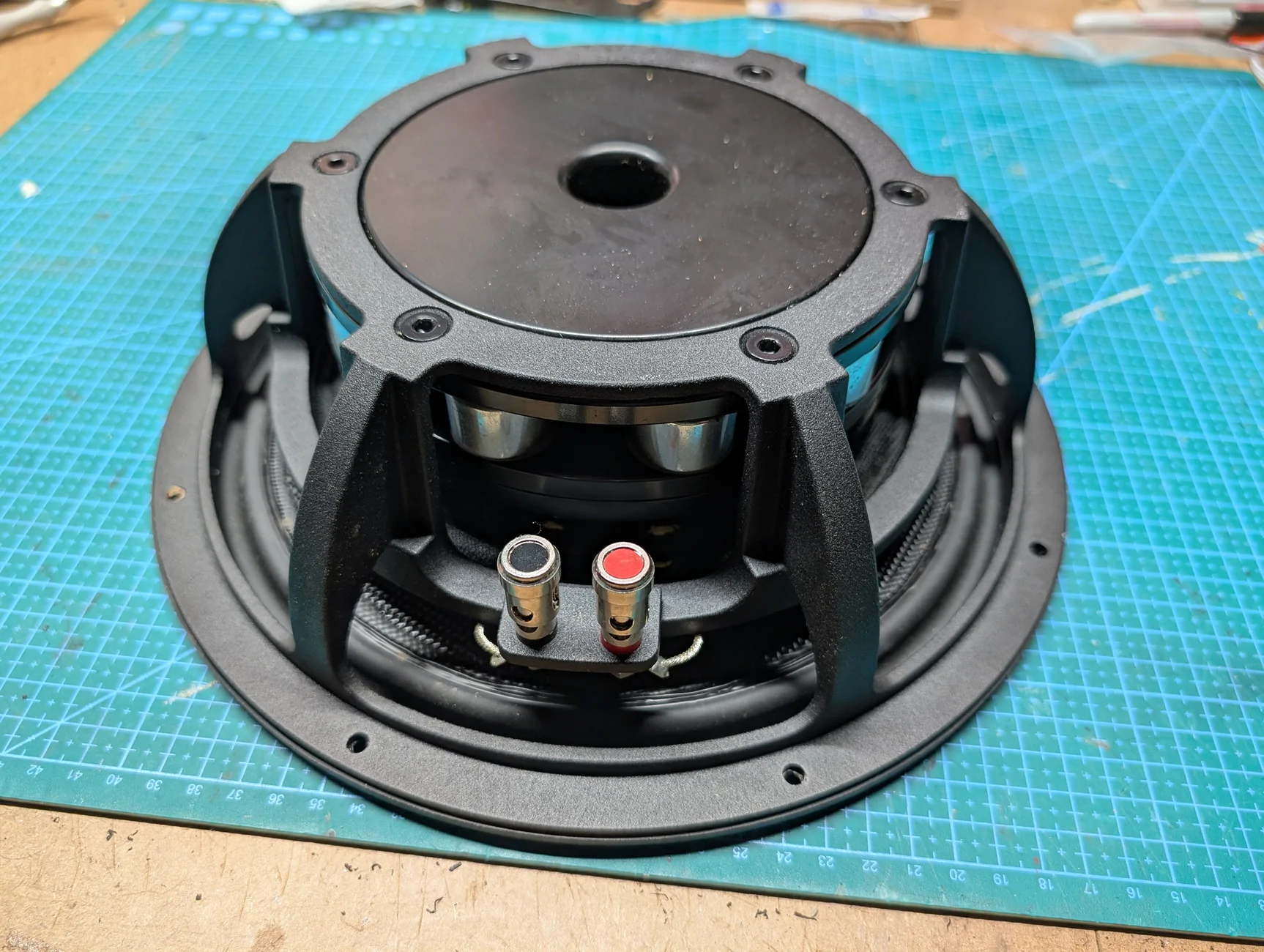

Midbass in the doors, not great, who would have known. I might be a bit overly critical, for the most part they are great, but on certain songs with lots of info in the lower midbass range, they get a little unhappy, and vibrate the door panel. I thought I could live with the compromise, but I cannot. I have been researching options, and landed on adding a front sub. This does a few things for me. 1: it removes energy from the doors, 2: it should allow me to keep the volume up on those heavy midbass songs, and 3: I am hoping to gain or keep the same level of punch, but lower the bass slightly. Not sure exacly where it is going to go yet, I am hoping it will replace the glove box without taking up any leg room.

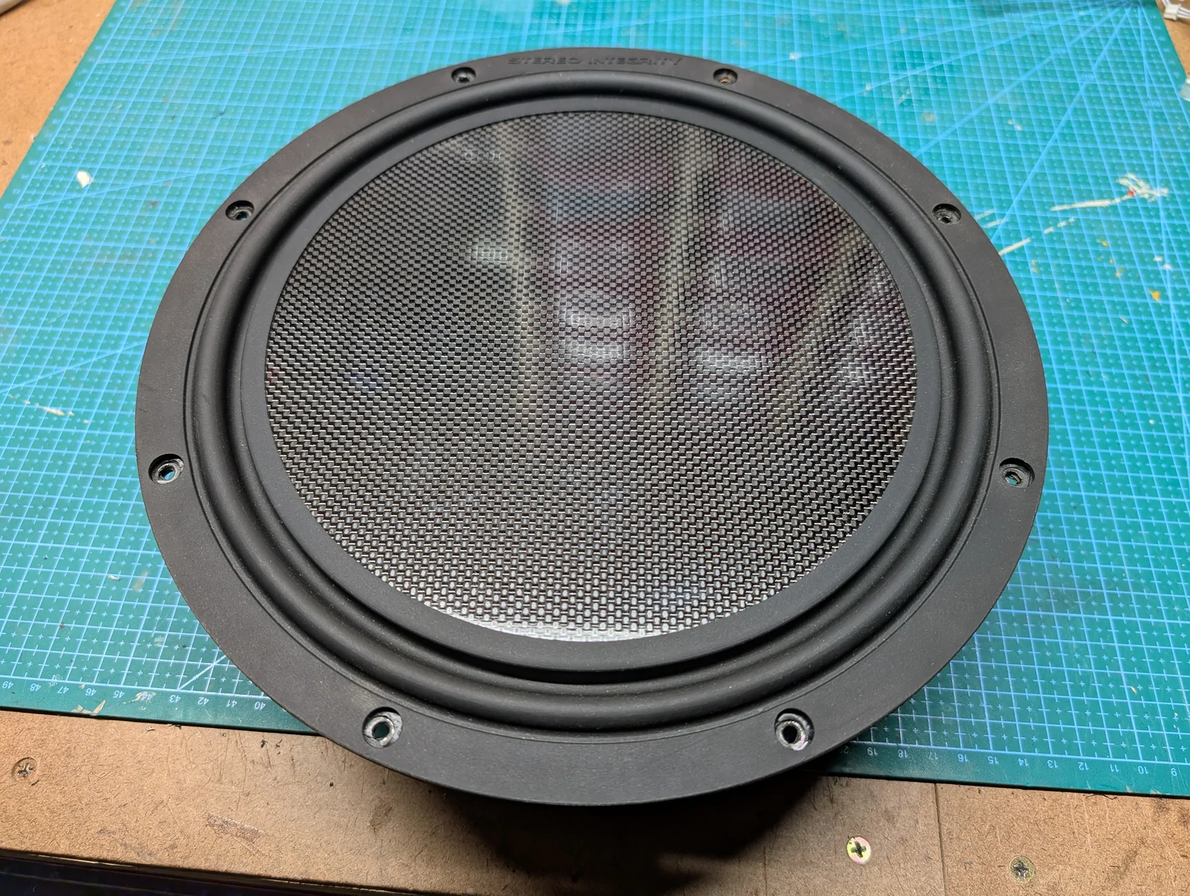

Enter the Stereo Integrity BM-11, I picked this up used. In my research, this modeled the best, and has a great reputation, I feel this will do exactly what I want. Currently the Morel Hybird MW6's are bridged off of the Morel MPS4.400 giving them the potential 200W. I will be switching them to a single channel output, and run the BM-11 bridged instead. One thing that works out is the BM-11 has dual 2 Ohm coils, allowing me to bridge it at full power. The Dayton LS10-44 has dual 4 Ohm coils. It modeled OK, but the BM-11 still edges out. The other option I found was the SB Acoustics SW26DBAC76. It also modeled well, and was in a similar price point as the used BM-11. I think either would have been fine, but I decided to go with the BM-11 due to the great reviews it has had.

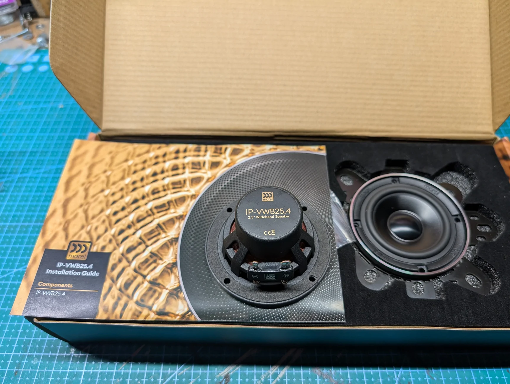

The new mids came in, Morel VWB25.4s. I will be starting installation and tuning in the coming weeks.

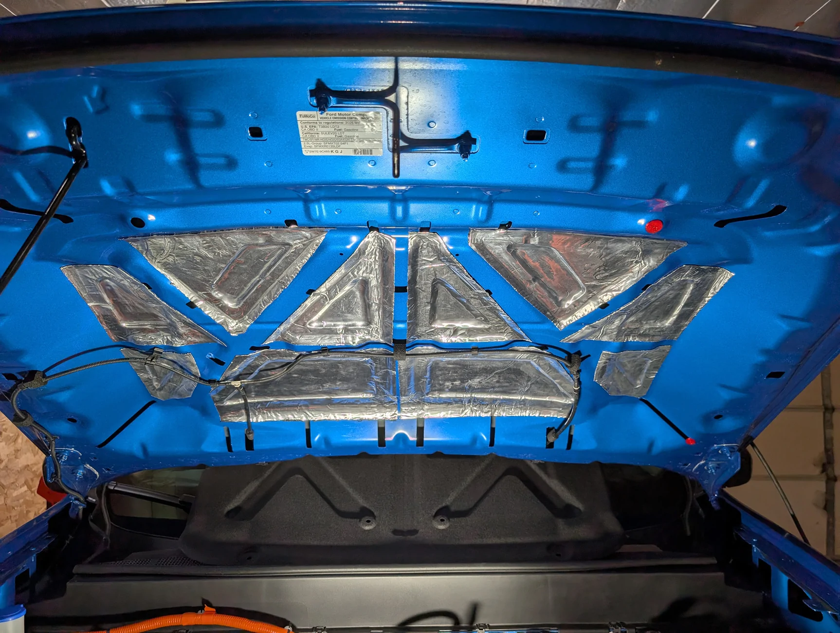

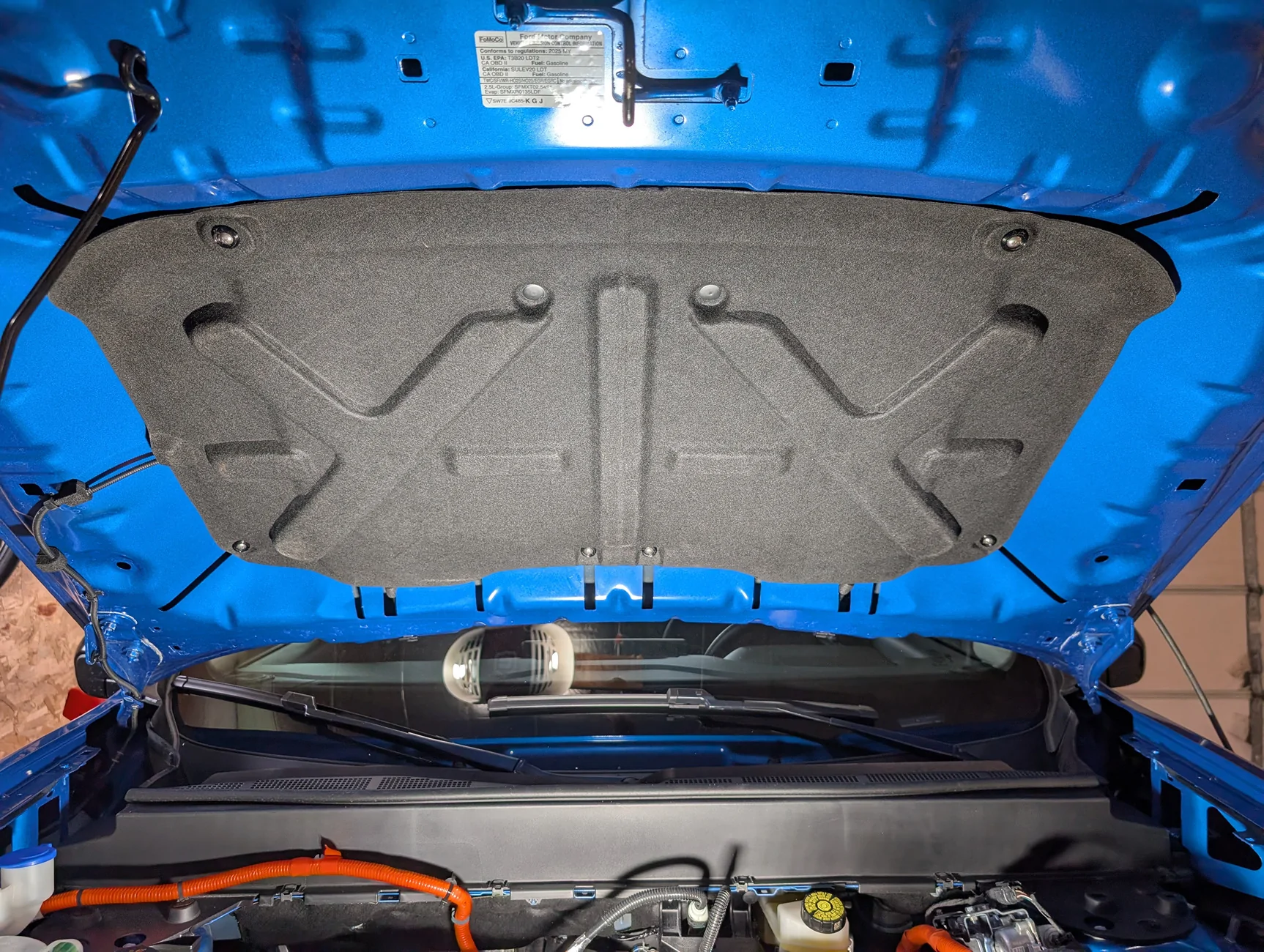

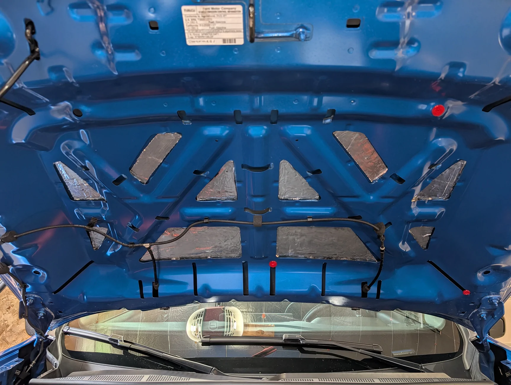

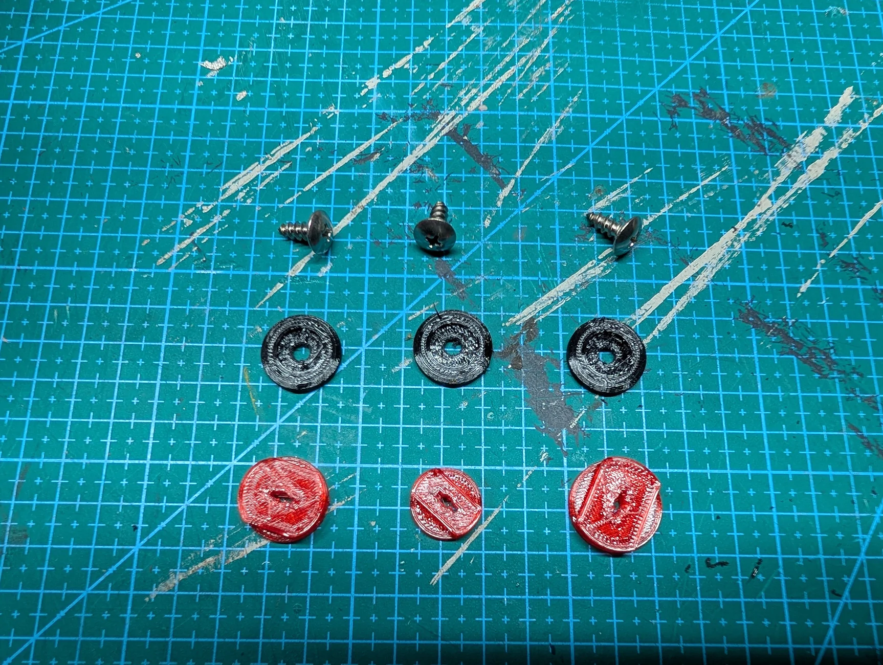

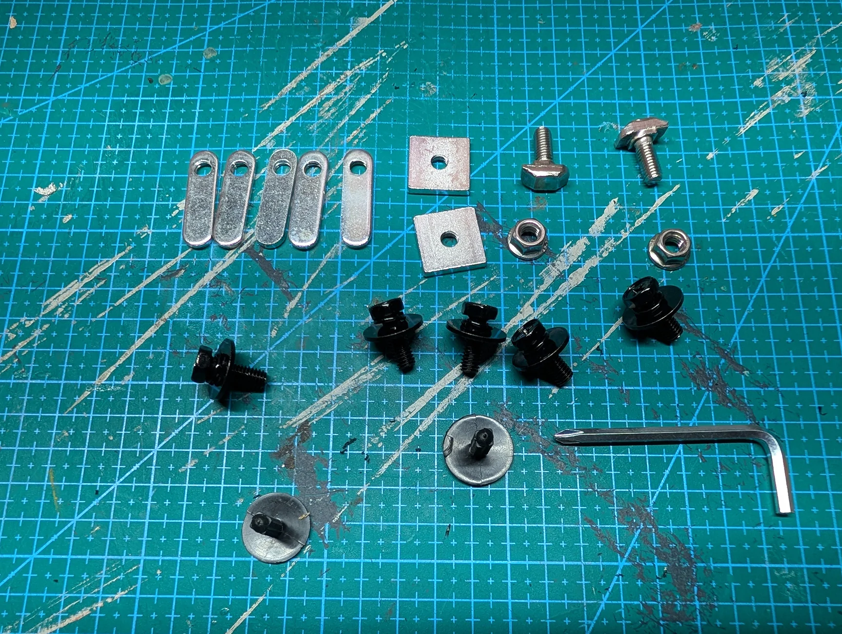

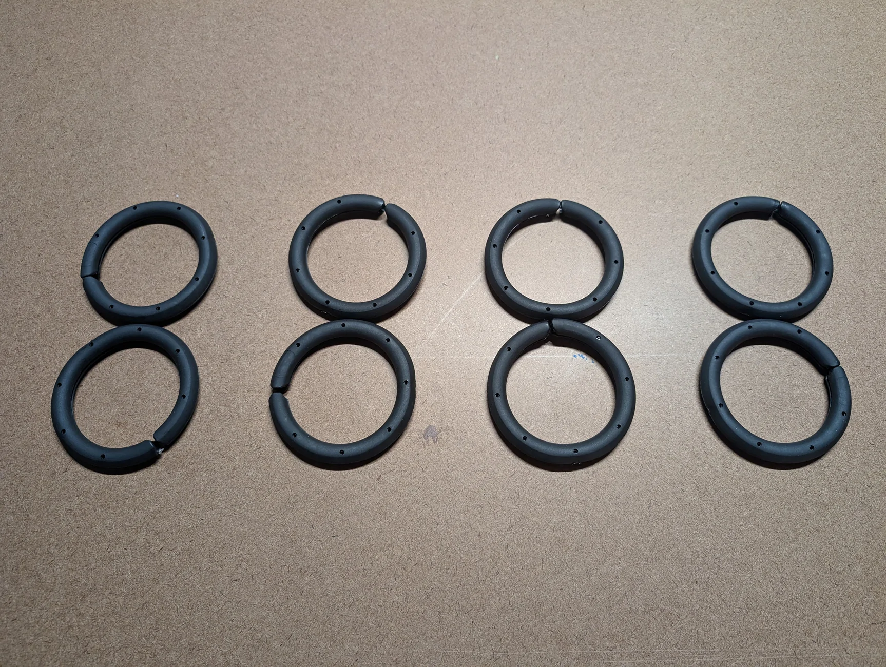

Added some CLD to the hood and installed a Maxzina hood shield. Not sure it will block much sound, but the CLD helps with the resonance of the hood.
I was not a fan of the hardware that came with the hood shield, so I designed and printed some inserts and some washers. Then picked up some stainless screws.
Included hardware
Ford Maverick 2025 Maverick Build Log PXL_20260412_170523530
New hardware
Ford Maverick 2025 Maverick Build Log PXL_20260412_170410021
Added some CLD on the outer skin
Ford Maverick 2025 Maverick Build Log PXL_20260412_174723928
Then some larger pieces over those and on the inner skin
Ford Maverick 2025 Maverick Build Log PXL_20260412_184126536
Then install the rest of the inserts and the shield
Ford Maverick 2025 Maverick Build Log PXL_20260412_190616319

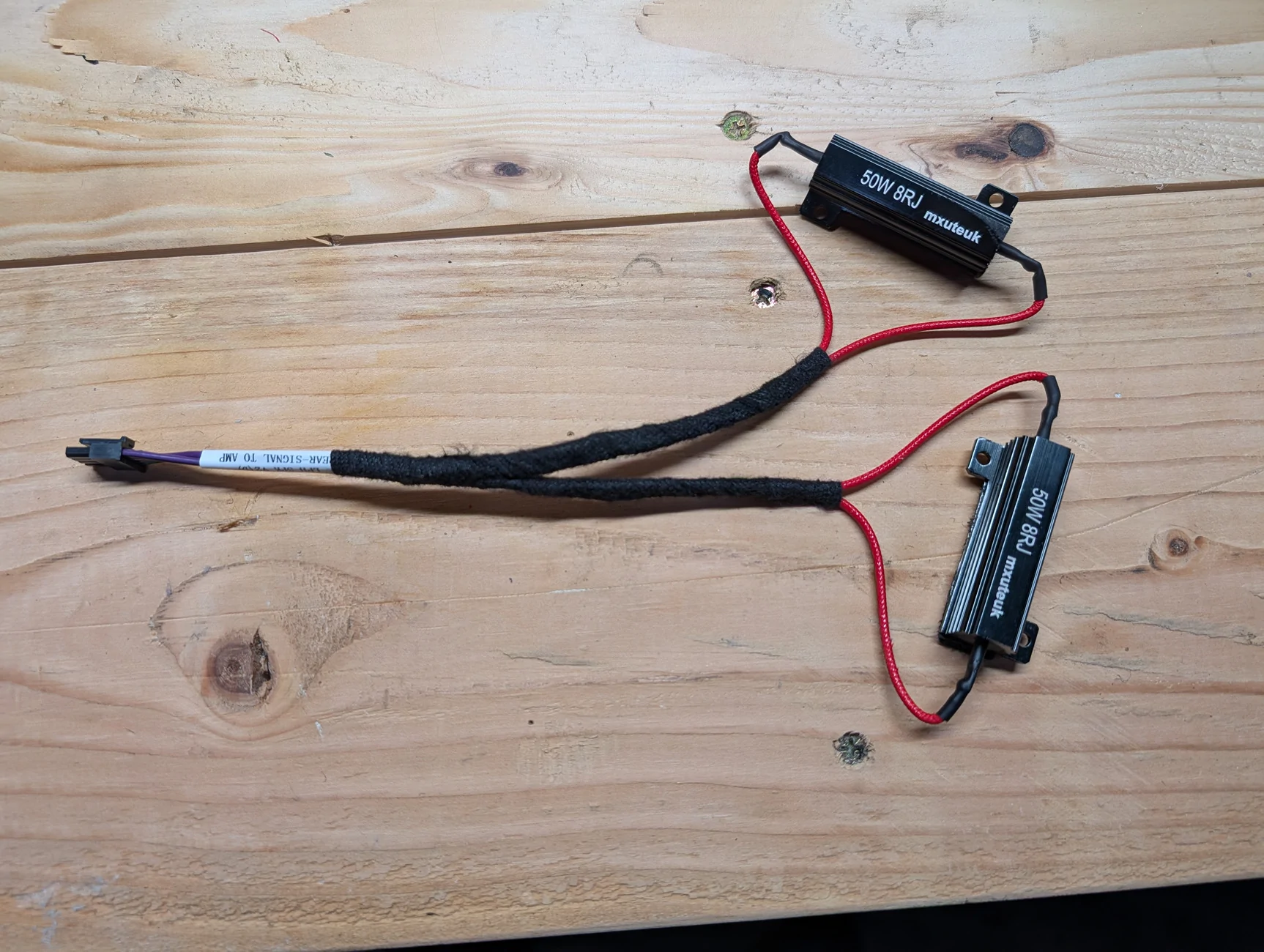

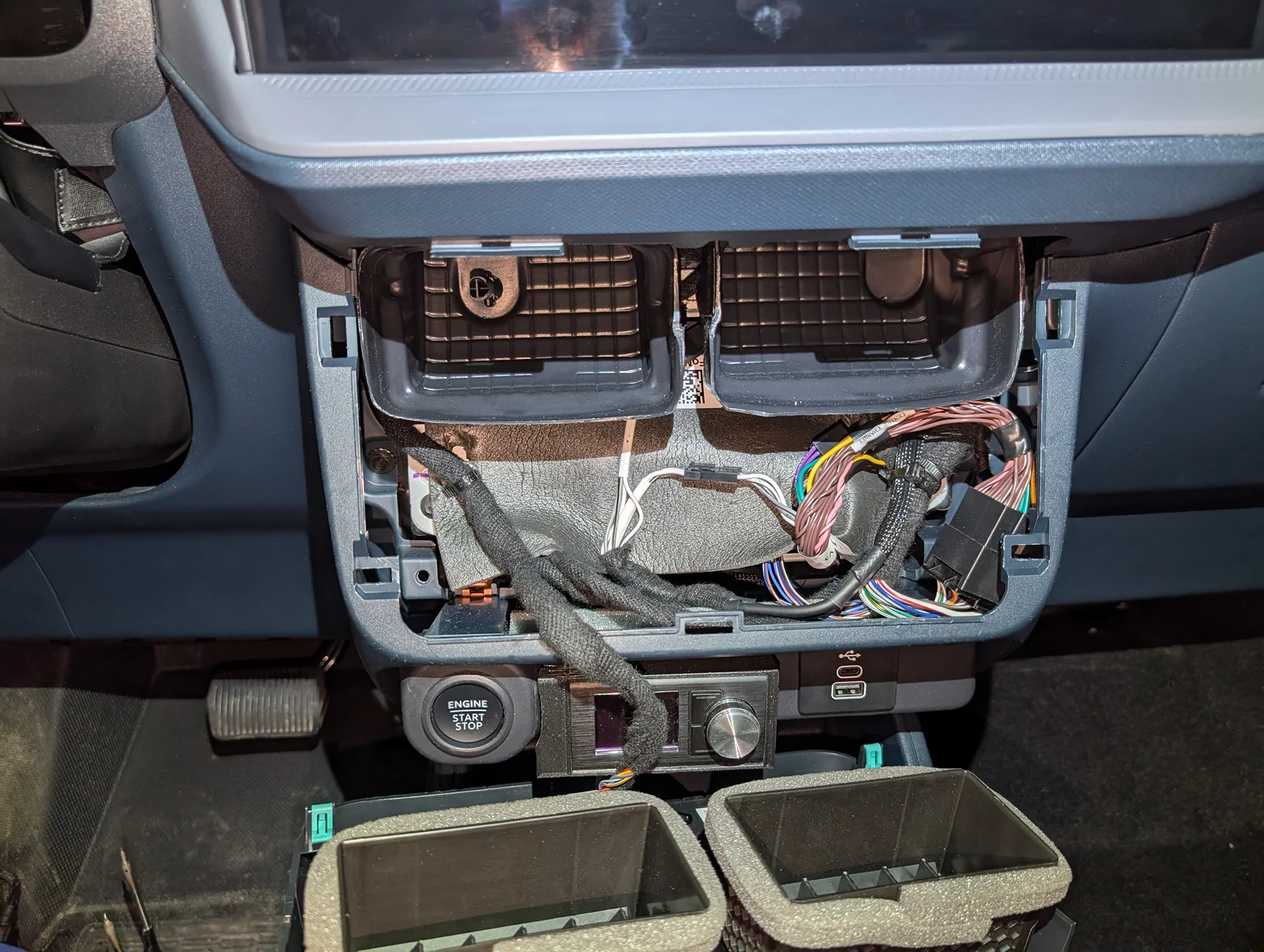

I also added load resistors to the front speaker outputs.
Built a harness using some left over parts from the PAC T harness
Ford Maverick 2025 Maverick Build Log PXL_20260413_014149320
Soldered in the other half into the T harness
Ford Maverick 2025 Maverick Build Log PXL_20260413_014303426
Used some velcro to attach the resistors to the top of the ACM
Ford Maverick 2025 Maverick Build Log PXL_20260413_014809531
Buttoned up
Ford Maverick 2025 Maverick Build Log PXL_20260413_014858185

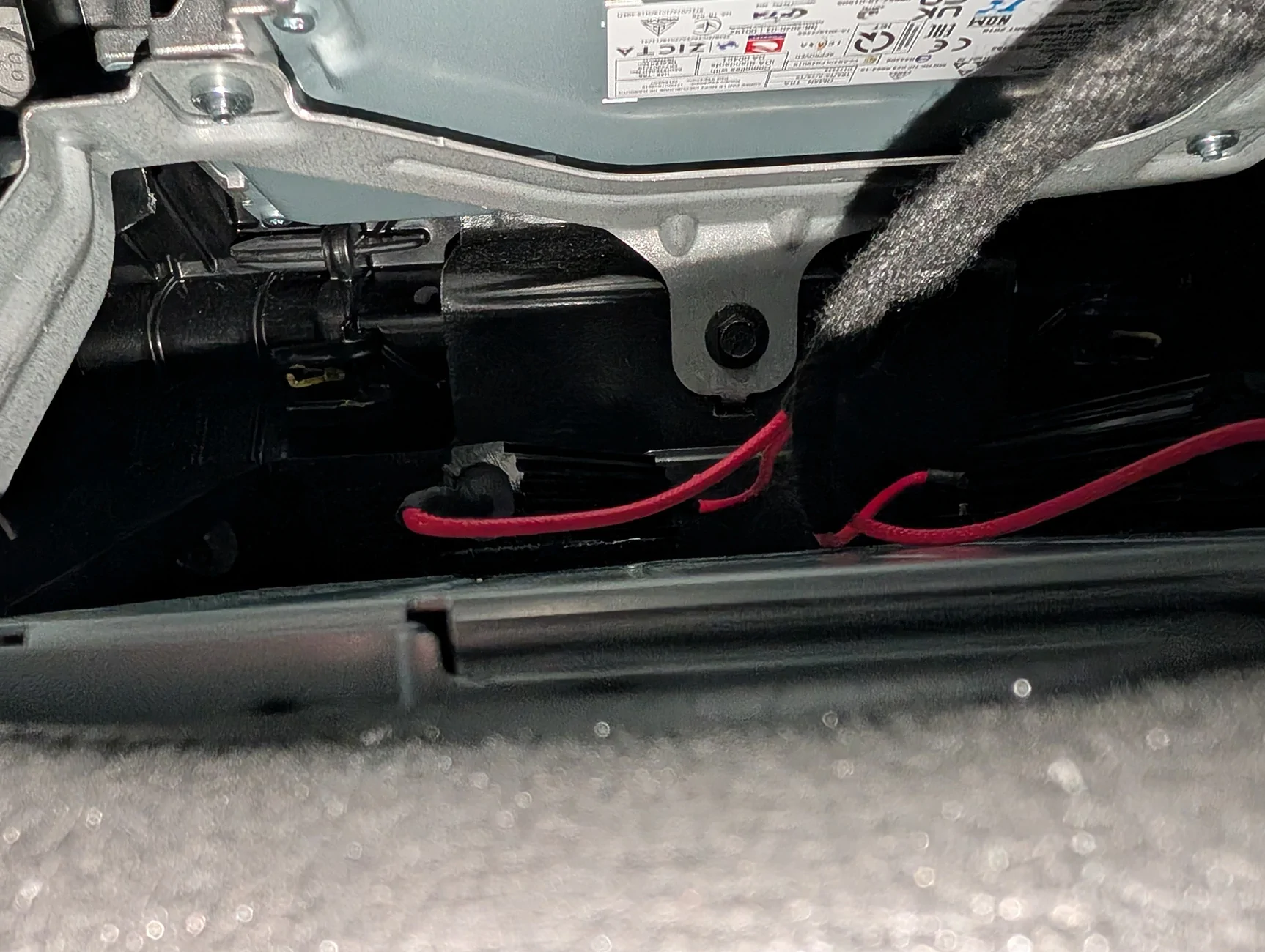

I also switched the remote turn on to fuse 6 instead of ignition switched so the amplifiers stay on after the ignition is off and before the doors are opened. Not a major thing, but it was annoying.

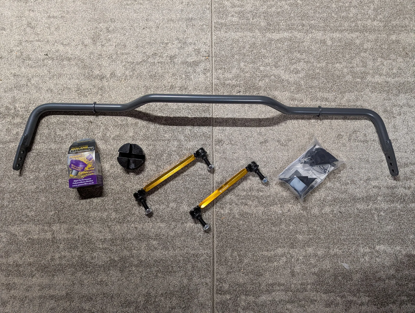

The next project that I have had on my list since purchasing the truck was the suspension upgrades.
Good-Win rear sway bar & bushings, Whiteline front sway bar end links, and a Jack Pad adapter from Good-Win Racing.

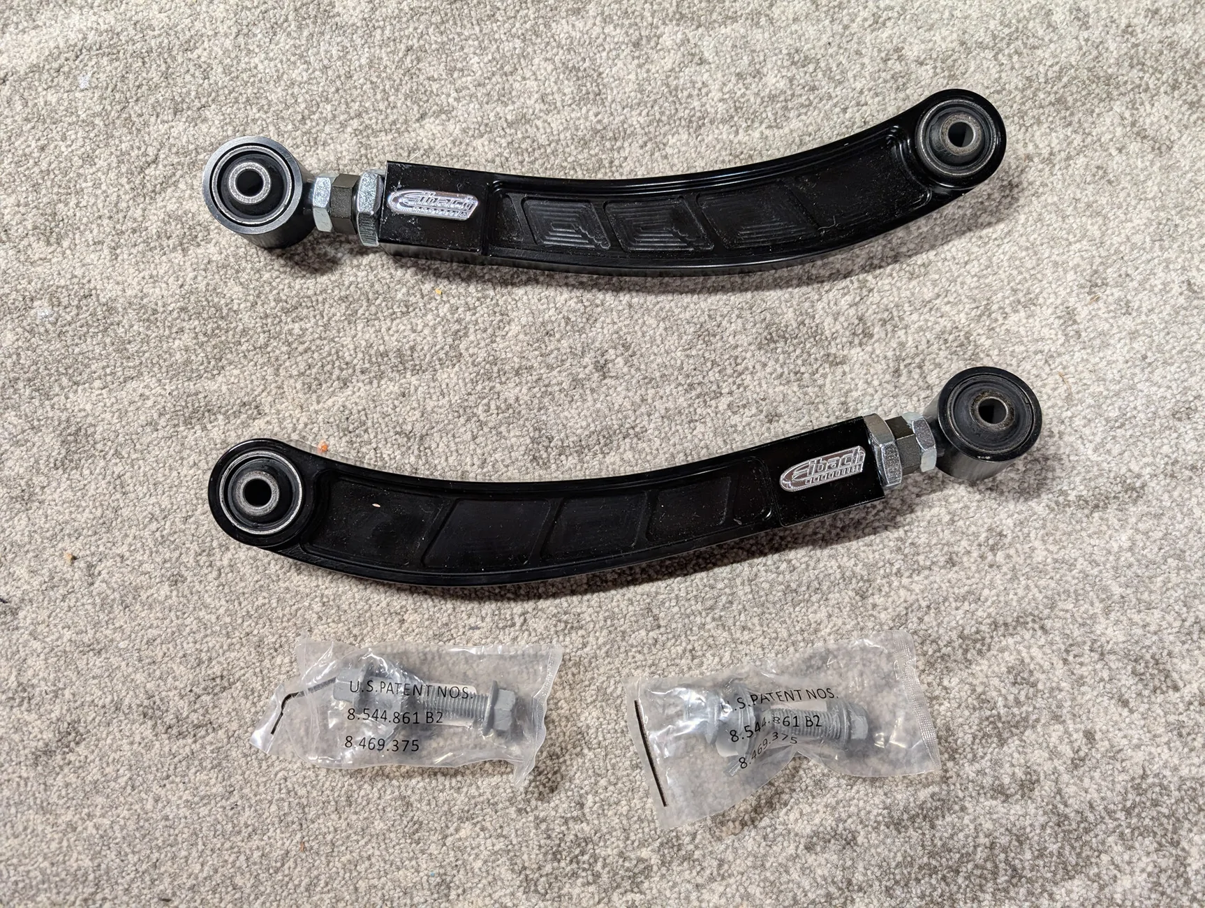

Rear camber arms and Front camber bolts from Eibach.

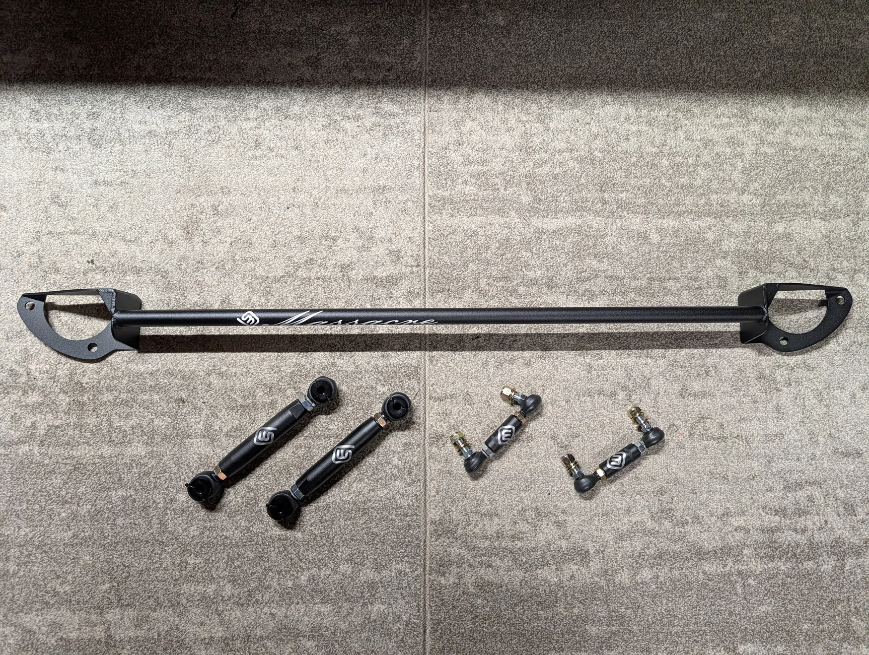

Front strut brace, rear toe links, and rear sway bar end links from Massive.

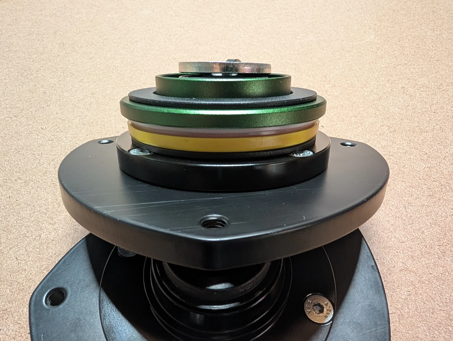

I have a set of Fortune Auto Coilovers on order. Still undecided if I cut the top of the strut tower to allow camber adjustment using the top mounts. I have the camber bolts in case I decide not to cut.

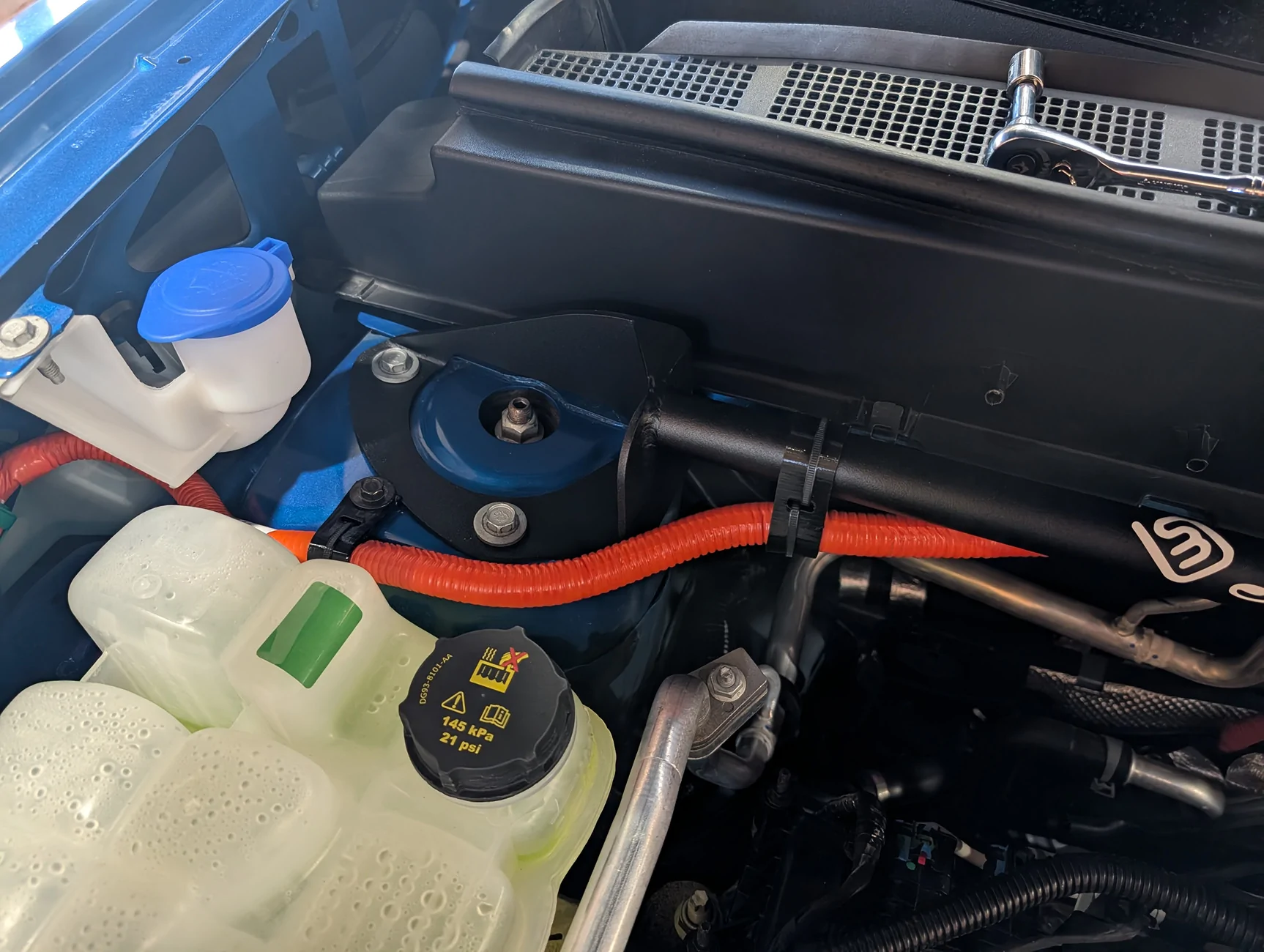

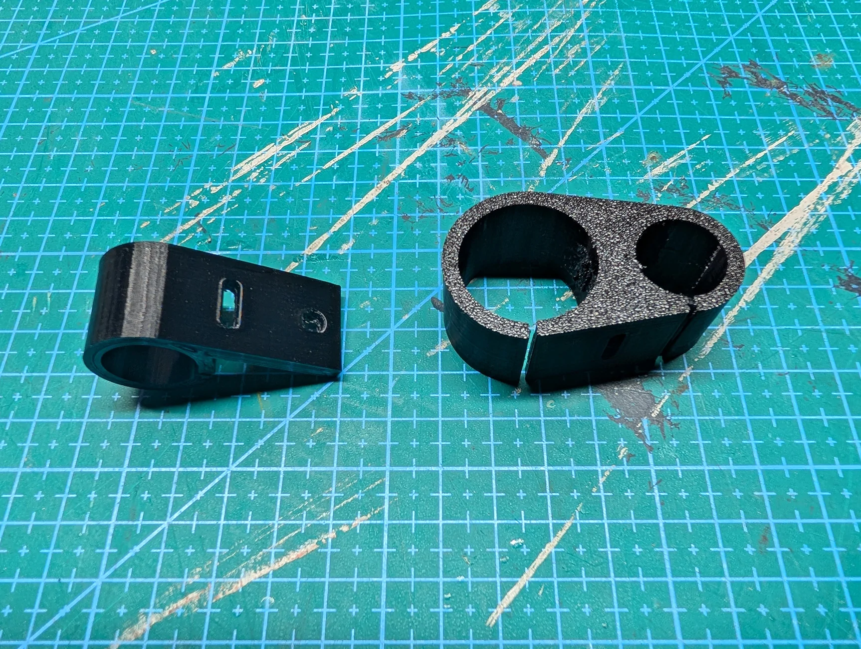

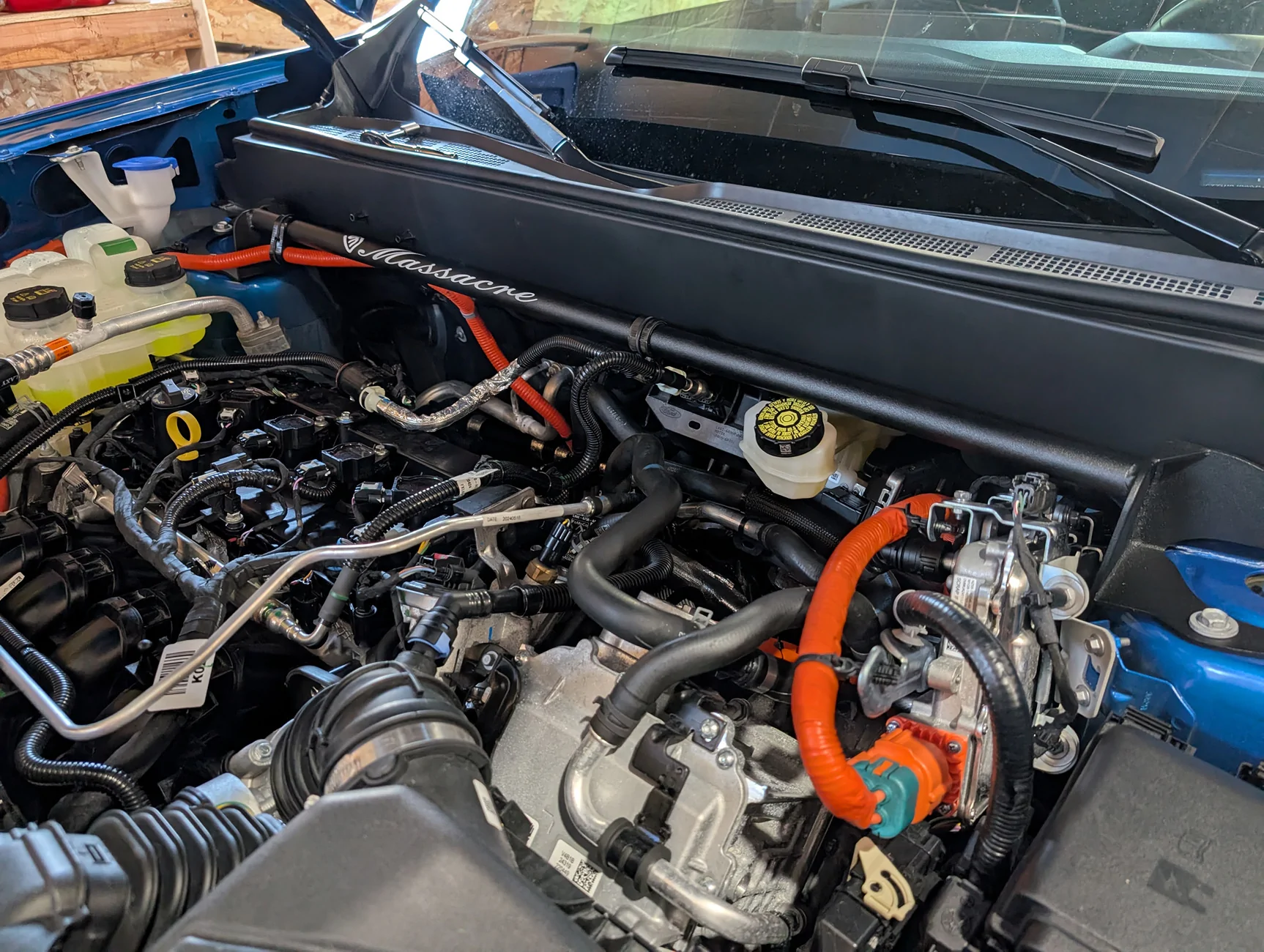

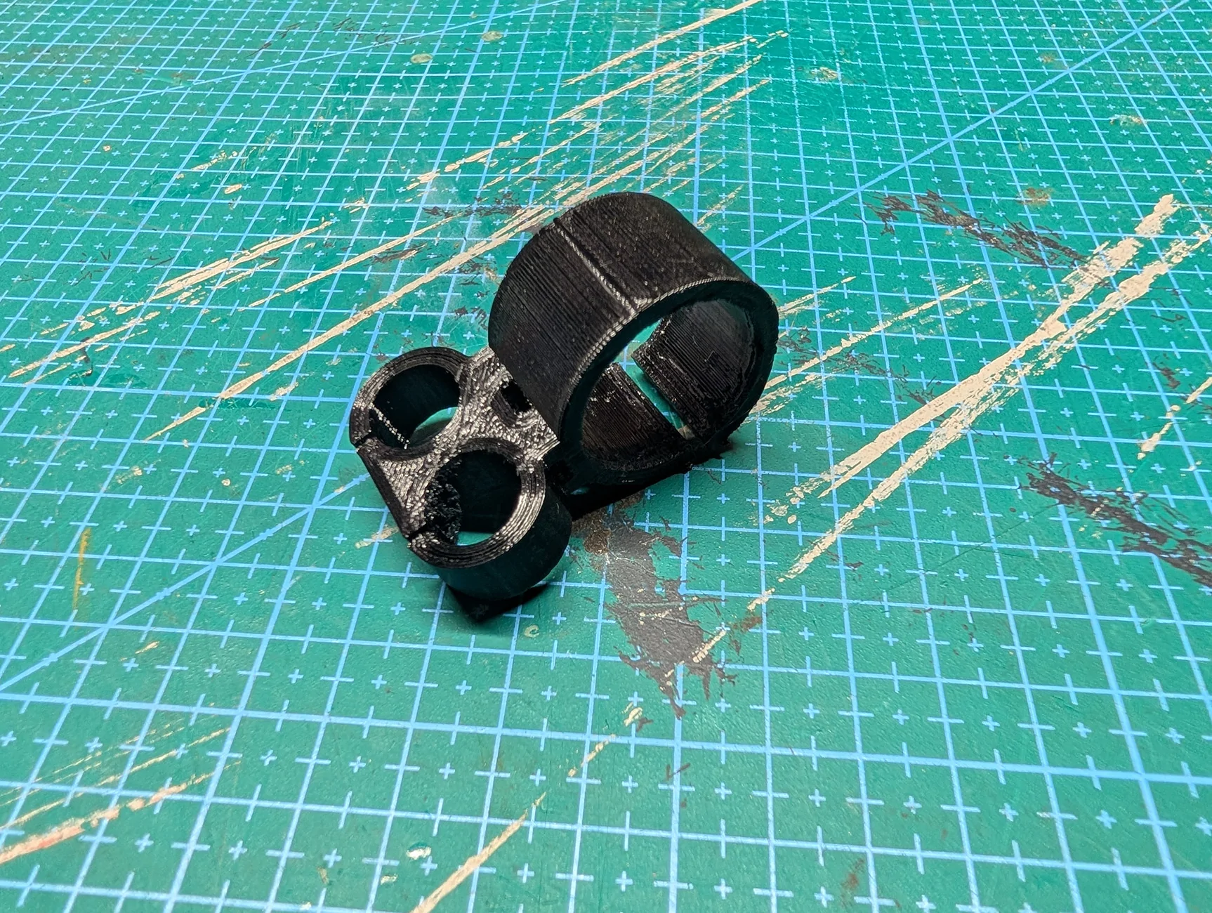

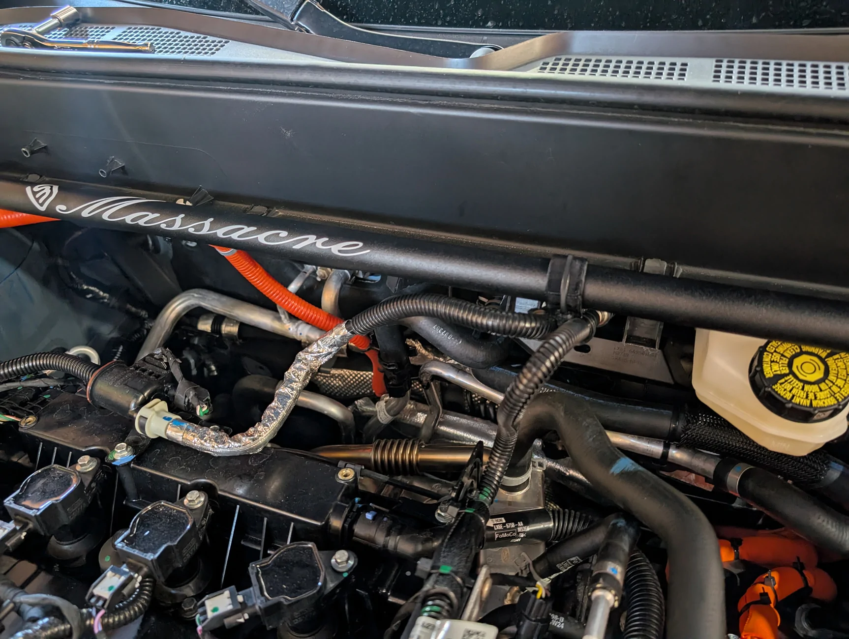

Installed the Strut bar, and needed a solution for the cable and tubes that run near it.
Designed and printed some wire clamps.
2 for the high volt cable that runs around the passenger side strut tower.
Ford Maverick 2025 Maverick Build Log PXL_20260416_225557674
And one for the tubes near the center.
Ford Maverick 2025 Maverick Build Log PXL_20260416_225609548
I routed the cable towards the front of the strut tower, one clamp off of the strut tower and one on the strut bar to keep the wire away from rubbing.
Ford Maverick 2025 Maverick Build Log PXL_20260416_230719036
The center clamp is to prevent the tubes from rubbing.
Ford Maverick 2025 Maverick Build Log PXL_20260416_230729812
Ford Maverick 2025 Maverick Build Log PXL_20260416_230737628
I am happy with the bar itself, it seems well made and no fitment issues. I know it does not add much as there is a brace on the rear of the strut tower, but any little bit helps and it is some good eye candy.

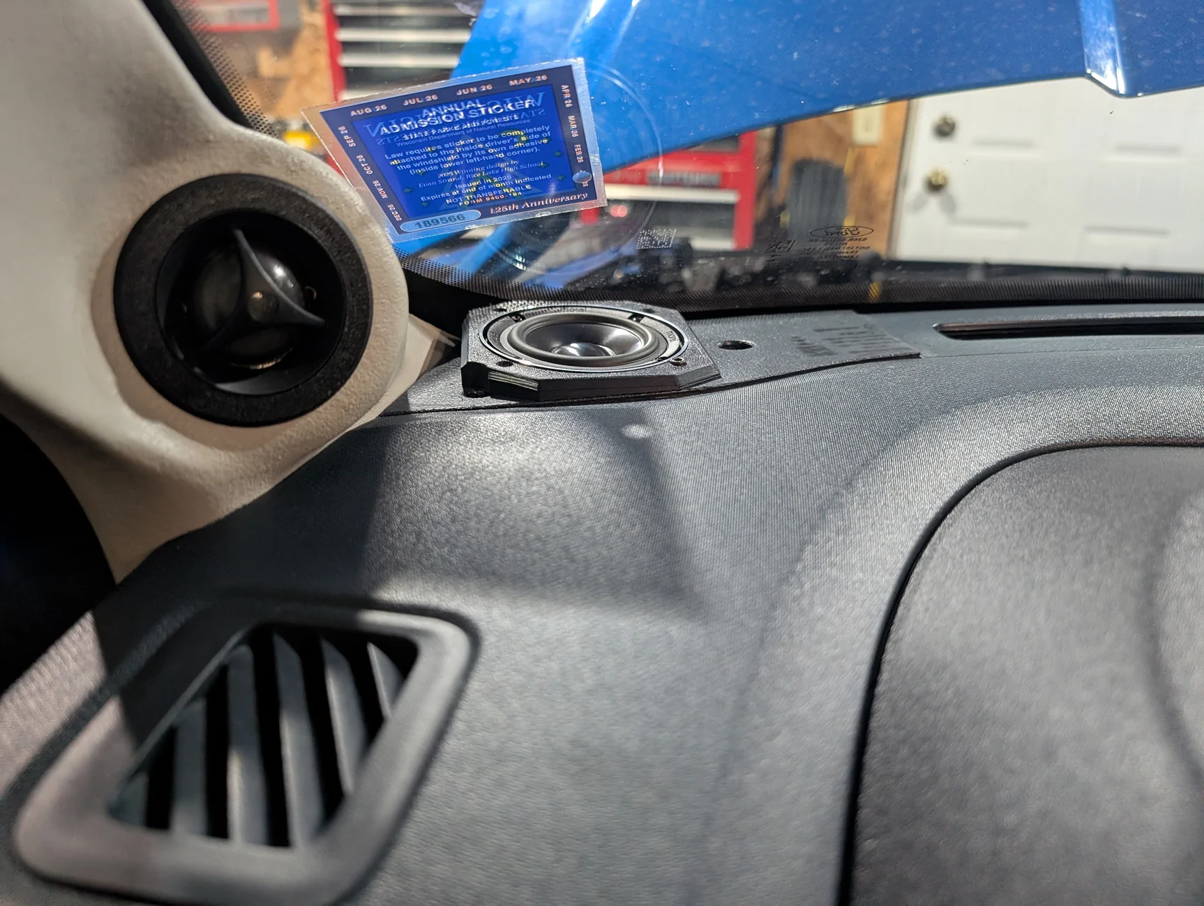

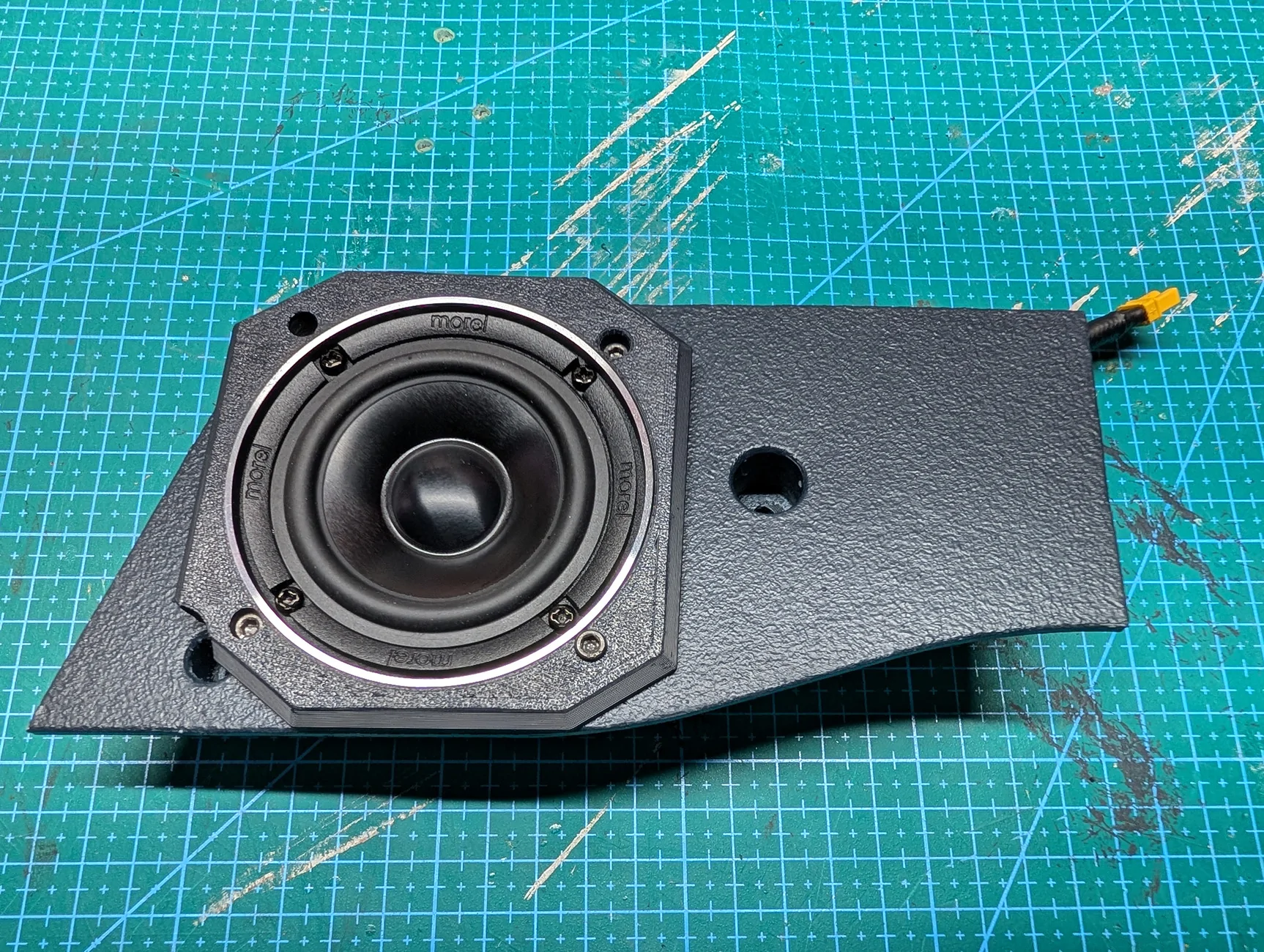

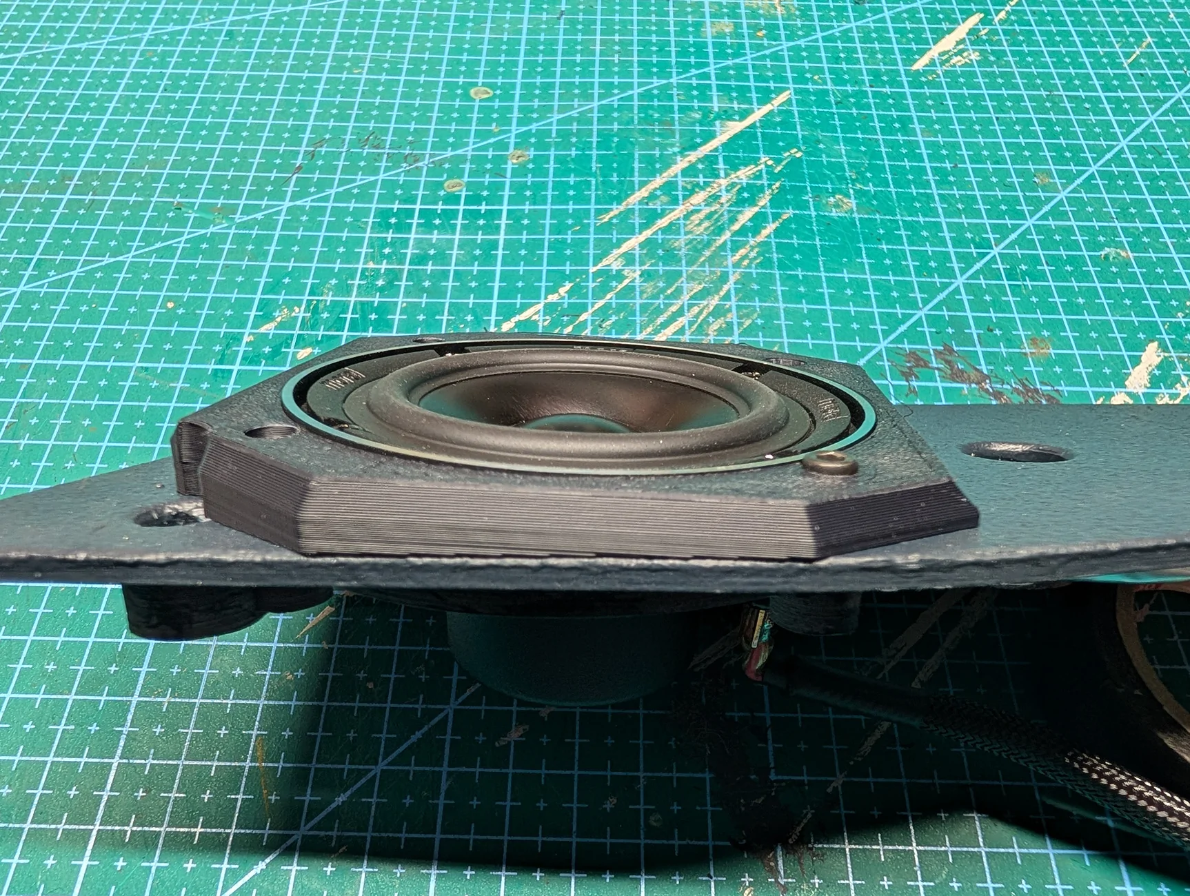

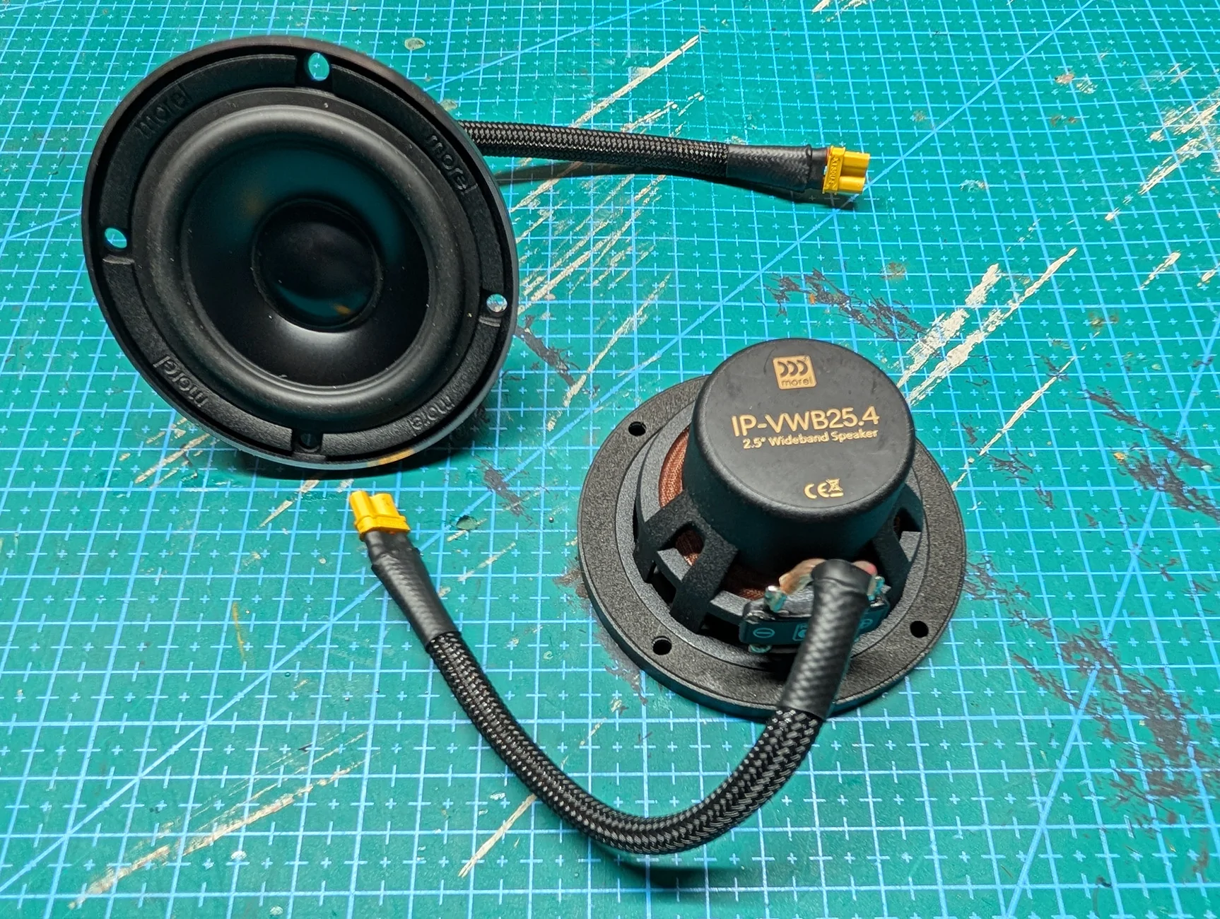

Started on mounting the new mids. I decide to just make an adapter to mount onto the existing baffles I made for the SBs.
Added wire leads to the mids.
Ford Maverick 2025 Maverick Build Log PXL_20260417_202242631
The adapter mounts using the same screws as the SB, then the VWB25.4 mounts into that.
Ford Maverick 2025 Maverick Build Log PXL_20260417_204050299
There is a slight angle inward.
Ford Maverick 2025 Maverick Build Log PXL_20260417_204238119
Mounted into the dash.
Ford Maverick 2025 Maverick Build Log PXL_20260417_205217494
Overall I am happy with how they turned out. I did make a few adjustments to the part, there were a few flaws in the prints, but it will be good enough to get a tune in it.

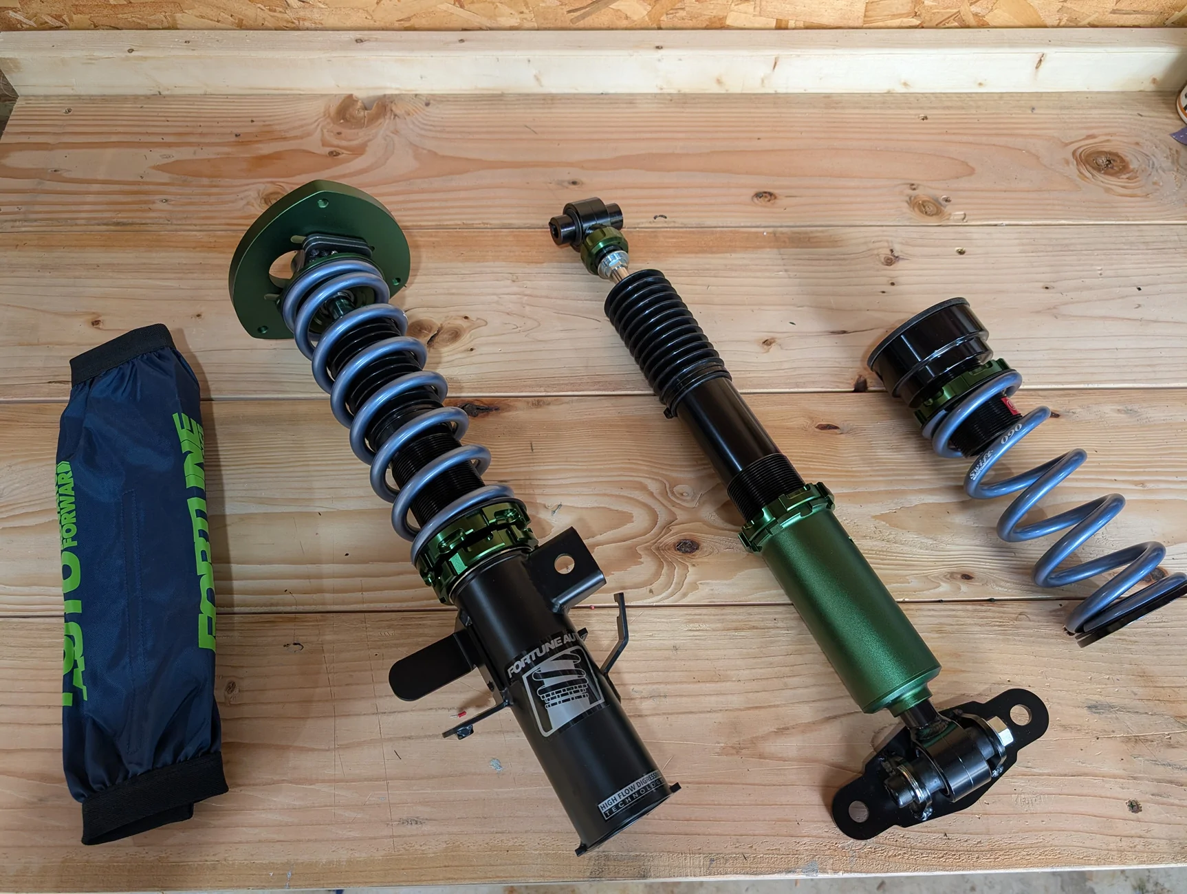

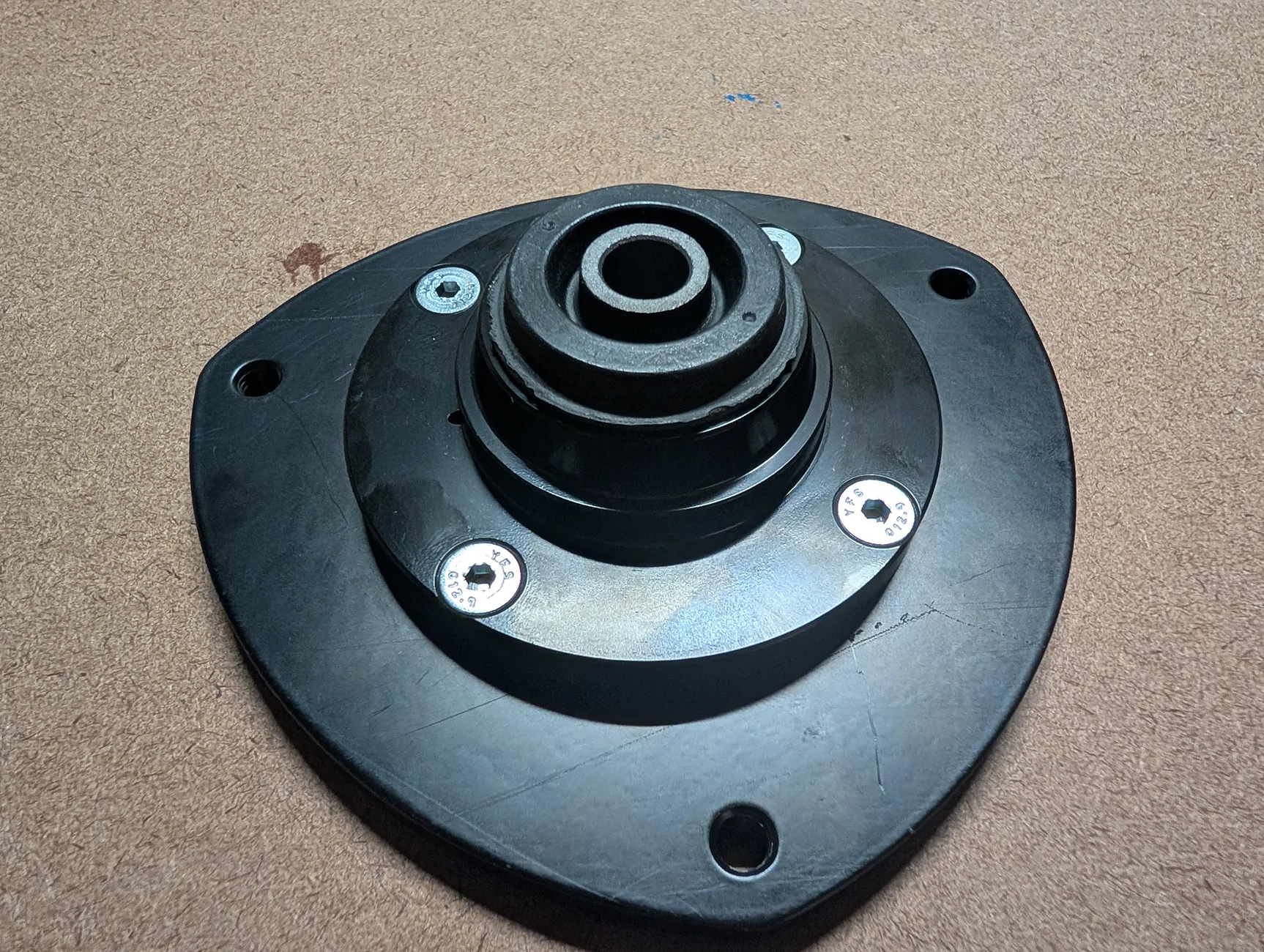

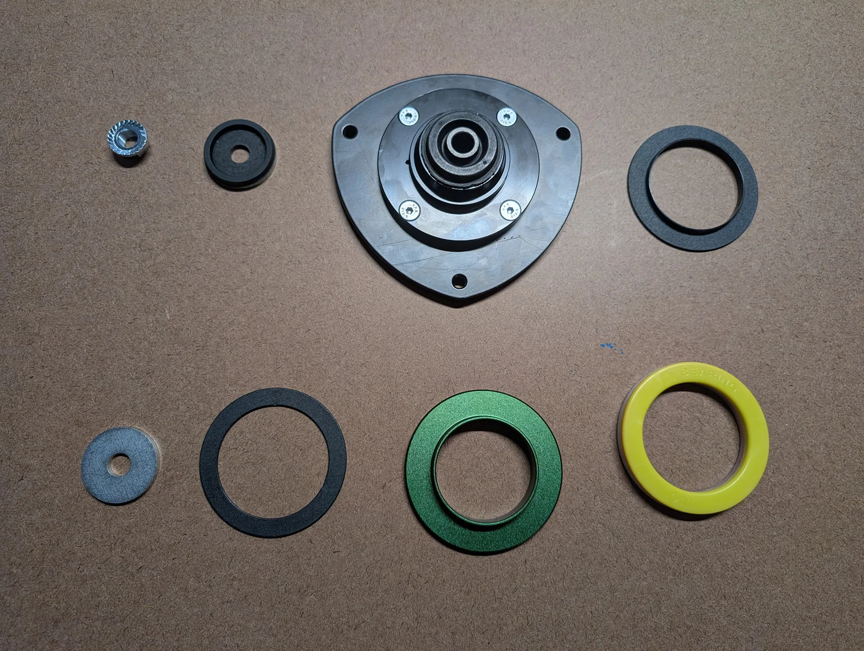

The Fortune Auto coilovers came in a few weeks ago. I opted for the Swift spring upgrade, 5K front and 9K rear.
Ford Maverick 2025 Maverick Build Log PXL_20260516_185412244
Install took a bit longer than I was expecting. Front went on quickly and easily including the Whiteline sway bar links.
The rear was more involved. The sway bar was fun, glad I had help getting the factory one out. Getting the new one was easier. Replacing the camber arms and toe links were fairly straight forward. The toe link bushings were wider than factory, caused by the boots spacing out the spacers. I had to fiddle with them a bit and ended up filing them down slightly to get them to fit.
The work was worth it, I could not be happier with the results. The ride is slightly firmer, linear springs vs progressive, but the ride is not harsh. At higher speeds the ride feels very similar to stock. At lower speeds to feel the cracks or small bumps more, but again, not harsh. The truck feels very neutral in the corners, not twitchyness or unexpected movements, very stable and controlled. Stays very flat and the rear rotates predictably.
I ended up going 2" lower in the front and 3" in the rear. This gives me plenty of ground clearance but closes the wheel gap to get the look I was looking for. All alignment specs are within factory tolerances. They did need to install the front camber bolts to get the camber to -0.6*. This is a daily driver, I prioritized driveability over performance. I am sure it could be better with more aggressive settings, but for how it preforms I don't need any more.
