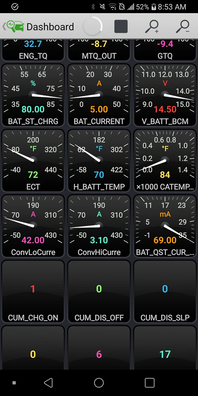

I thought Ford's BMS only charges the battery to 80%. Did you change the battery level using ForScan?
Ford's SOC scale, or the industry standard charts?
I can confirm in logs that the normal below 1A charging does start at 80% Ford SOC scale. Actually once shown in pic below I saw it staying at 5A, which quickly dropped - that was 6 day old new battery.
And on a new battery in the initial 30 days (or a just recharged battery) - it'll reach 85% max it started at - when On long enough.
What's cute in that pic - 1 rounded Ah of Charging logged against a number that doesn't round to 1 yet of combined discharging. And yet with more charge than discharge, how did it ever drop to 80% Ford SOC in 6 days? (hmmm, inquiring minds want to know)
The voltages associated with those levels on standard chart - that's where I've seen confusion in reports. Starting to notice some of the battery monitoring systems that are installed permanently either need a setup for battery type, or they are using another scale.

Self-correction to my question - how does higher charging Ah vs discharging Ah lead to a battery losing SOC in 6 days?
In theory the 2 discharge PID's - system off and during sleeping time - could have added up to more than the charging Ah.
Maybe that's why the BMS was willing to be at 5A charge rate when already at 80% - it sensed an imbalance in the force it was trying to quickly correct.
Sadly the young padawan did not finish it's training - and by 30 day old battery it was still barely off but WAY less V and SOC%.

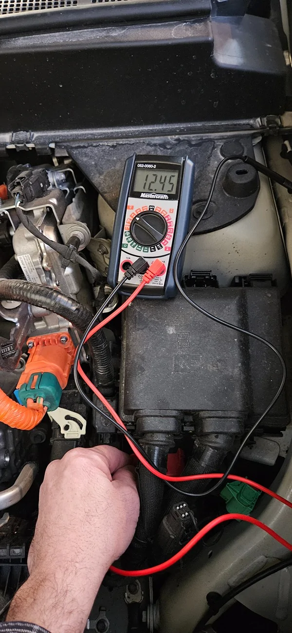

So, I completed my test on this battery saver, what this thread is about.
Approximately 109 hours of peace and quiet for the truck had passed.
This am after I had my coffee, I strolled to the garage with truck key in pocket.
-Driver door unlocked when I touched the handle (good),
- ext lights flashed but did not stay on like normal (also fine, I have lights and windows in our garage) but it is a difference,
-No dash electronics lighting up so that is also part of the battery saving feature, and also fine for me as I don't mind it waiting for me to hit start,
-I then reached up to the rocker switch to manually check and see if the interior lights would come on and when fully depressed to the left the interior lights did come on. So, if anyone needs light to find the hole for their key or to find the start button, just try turning the lights the old-fashioned way (your finger) if needed,
So I then popped the hood and checked the battery voltage (yes, power is on in the background in the truck) and voltage was reading 12.45....so, completely acceptable and definitely not low! So, factor in what the true battery charge level is, the battery is still very well charged.
My conclusion is that the OP is correct, the manual is not accurate.
Is it life altering? No, but that isnt the point.
Thoughts
-The truck may be shutting down as described as there always will be some slow drain of battery power. Not likely IMHO.
-The truck software is written so that after a set time it starts trying to save battery power. Most likely answer.
Either the manual should be updated to reflect reality or the truck software needs work. Thinking option 1 more likely if enough people dislike inaccurate statements.
