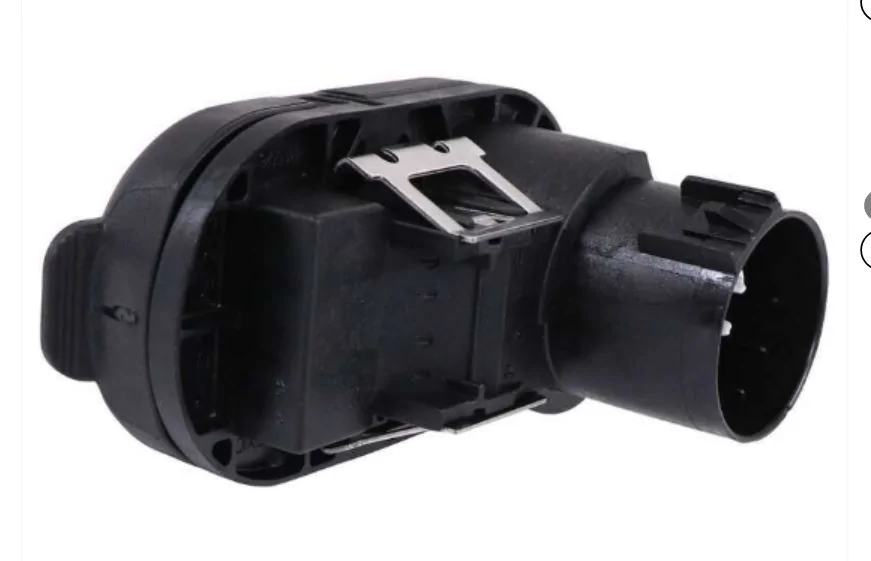

I have a 2023 Maverick AWD with the tow package. Has anyone had any problems with the 7 pin plug not working correctly? I plug in any of my trailers and only the turn lights and brake lights work. No running tail lights or marker lights. I hook up my F350 and everything works fine. Dealer can’t figure it out.
Yes, spent 3 hrs at Long-Lewis Yesterday. There is no “tail light trailer wire” in the wiring harness. It is a mistake from the wiring harness provider. They put The part on order for my truck.
Should be able to somehow temporarily clip into tail light wire if it becomes important enough to you.

One has to wonder if they used the same harness for both the 4 pin and 7 pin. Oops!
True or not...
4 pins have running lights.
7 pins have running lights.
Pin 1 ground
Pin 2 running lights
Pin 3 right turn signal
Pin 4 left turn signal
(Pins 3 & 4 simultaneously constitute brake lamps)
The 5th pin is for trailer brakes
The 6th pin is for trailer back up light (white light if equipped).
The 7th pin is for 12v battery charging, if equipped.

Could be the reason for the constraint on the stand alone hitch?? (Just a guess)
Automate states: the trailer control module that drives the trailer connector. It has micro-chips and some chips are still in short supply.
This is starting to make sense regarding Hitch constraint.............................................

Yes, every Ford vehicle from the factory with a hitch requires a trailer module with micro-chips. And when those chips are in short supply, guess which vehicle gets constrained? The very cheapest one, the Maverick with stand alone hitch.

Does the 4 pin have working tail lights? Could jump it right there at back for temp fix.
