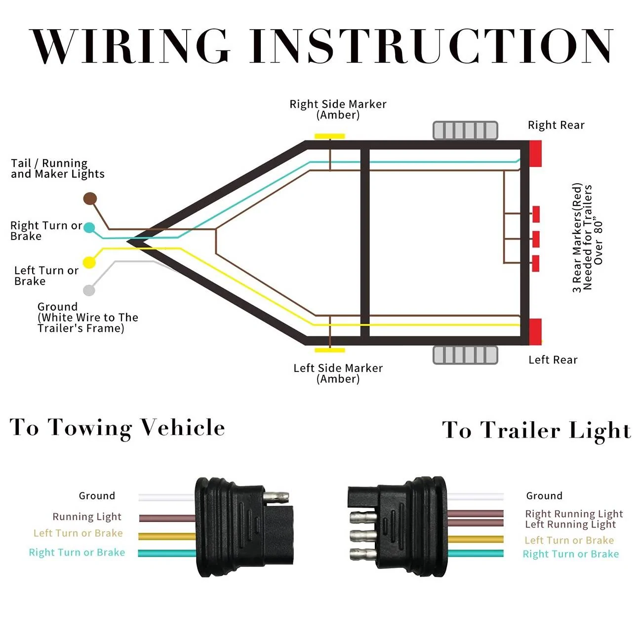

4-pin is very universal.
Contains running lamps, right turn, left turn, (both = brake) and a common ground.
No trailer brakes connection on a 4-pin.
