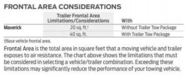

I'm having a hard time understanding the Frontal Area chart. Looks like my Hybrid (without Tow Package) is limited to 20 sq ft frontal area. But the note says this means "Base vehicle frontal area." What does that mean? What is the "base vehicle"?
It seems likely that they are talking about frontal area of the trailer -- not the whole enchilada -- because the Maverick itself has a frontal area of about 30 sq ft. Even so, that would limit me to a trailer about 7 feet wide and 3 feet tall -- basically a motorcycle trailer or a pop-up tent trailer. That's ok with me, but it really limits the hybrid (because no tow package available).
I decided to look into this. I have the time (retired), am restless/sickened/pissed by events over the last few days to the point of wanting to put a brick through my TV if I see another talking head/professional advice-giver with no accountability/Monday morning QB of any political persuasion, and doing this info dive provided a distraction for me from current events half a world away. Semper Fi.
You and others raised some good questions. I’m no expert, for others more knowledgeable than me – please chime in. I know a little about methods to use to answer the question “how much can I/should I (safely) tow?”. I never thought “frontal area” would be of such interest, I was wrong. But my philosophy is (1) there’s a reason for everything, (2) you can never ask too many questions, (3) the devil really is in the details. I hate unanswered questions, so here’s the short version:
To sum up, what I think (P90, 90% probability):
Ford Maverick 2022 Maverick Trailer Towing & GVWR / GCWR Guide basic vehicle front area
  • The vehicle frontal area is a projection of the vehicles shape.
Ford Maverick 2022 Maverick Trailer Towing & GVWR / GCWR Guide def. front area
  • The 20 ft2 frontal area for Maverick Hybrid and non-4K tow package 2.0 EB comes directly from SAE J2807 towing standard tow-test-standards-2016-02.pdf (fifthwheelst.com), it refers to a 20 ft2 trailer. Since the Maverick itself has a frontal area >20ft2, that’s why the footnote Base Vehicle Frontal Area.
  • The 40 ft2 for 2.0 EB with 4K tow package also comes directly from SAE J2807 towing standard. So Maverick frontal area + ? extra exposed trailer frontal area = 40 ft2.
  • The J2807 frontal area values directly match up with Ford’s Trailer Towing Guide values.
  • I wouldn’t obsess about trailer frontal area, if you’re over a little so be it and adjust as needed (route, speed, gear used, etc), just be aware of possible tow vehicle performance issues (cooling, speed, fuel grade, etc).
The long-winded version is here:

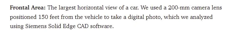

2. If you have an actual trailer to view, have a good camera and are handy with CAD software, do what Car & Driver did in 2014:
Ford Maverick 2022 Maverick Trailer Towing & GVWR / GCWR Guide car driver

Ford’s “Base Vehicle Frontal Area” footnote on Maverick specs – I’m pretty sure Ford is mixing terms, and means “Basic Vehicle Frontal Area” as per the legal definition in EPA reg 40 CFR Part 86.1803.001. eCFR :: 40 CFR Part 86 -- Control of Emissions from New and In-Use Highway Vehicles and Engines (federalregister.gov)
So another bad writer at FoMoCo. It sure does read like they're mixing terms or at least muddied the waters.
Agree with ya.
If we are to believe the # in the official Tow Guide is Mav+towed, well then the Hybrid cannot tow anything. The Mav itself has a frontal area ~34.5sq ft. The guide says the Hybrid max frontal area is 20 sq ft, so the Mav's frontal area exceeds that. Hah! But because Ford has rated the Hybrid to tow something (and by something hopefully they're using SAE methods), then their (ab)use of the term frontal area must be referring to the towed trailer and not the Mav itself. That's how my poor man's logic attempts to understand what Ford wrote.
So a 5' wide x 4' tall boat / jetski / small camper behind the Hybrid.

Turns out we have all been overthinking what Ford means by frontal area.
they literally mean: Frontal Area is the total area in square feet that a moving vehicle and trailer exposes to air resistance. Source: https://www.ford.com/cmslibs/conten...ral/pdf/guides/20Towing_Ford_Ranger_Oct15.pdf
