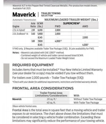

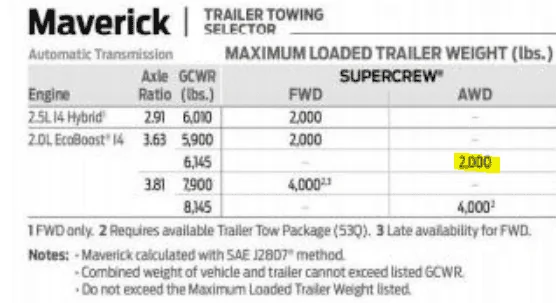

Edit" "My suspicion is that engine and transmission cooling will get you."I don’t know how you can get a real concrete answer, too many things we don’t know. You already know the impacts – more frontal area = more crappy mpg, and more grunt needed for the tow vehicle. Why does Ford specify a max. of 40 ft2 (why not 38.2 or 55.63 ft2) frontal area for the Maverick + trailer? Don’t know.
If we knew the Maverick real drag coefficient (Cd), we could figure out how much more aerodynamic HP is required at a certain speed as you increase frontal area:
*Cd = (drag force) / (0.5 x air density x velocity squared x frontal area)
*Aerodynamic drag force (D) = Frontal Area (S) x drag coefficient (Cd) x Air density (p) x speed squared (V2)
*Therefore power (P) to overcome that force = D x V = 0.5 x S x Cd x p x V3
So if we knew Cd we could figure out P for whatever velocity (speed) you want to assume. But we don’t know Cd, and even if we did, what speed are you going to assume, and what does that resulting increase in HP needed to overcome aero drag really mean regards your engine power, engine cooling, etc?
MPG obviously an impact, but not a limiting factor. I doubt Ford cares if you got only 5 mpg on your tow vehicle as long as the vehicle was actually capable of towing whatever load you applied to it without having the instrument display light up like a Christmas tree with error codes and going into “limp mode”.
My suspicion is that engine cooling will get you. Ford has tested the Maverick (both Hybrid and EB) in line with SAE J2807 towing standard (with its infamous Davis Dam test), so I’m pretty confident that 40 ft2 combined frontal area is a good number as far as that goes. But if you want to know if you could “really” tow a 60 ft2 (tow vehicle + trailer) frontal area, can’t help you.
