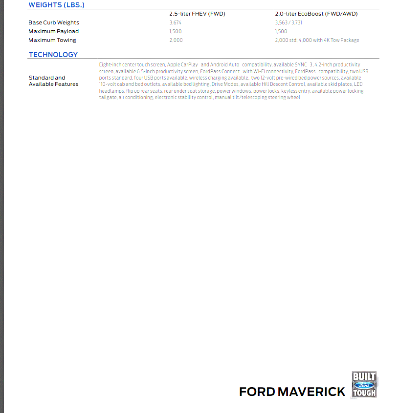

Odd ford does not agree with your facts
Ford Maverick 2022 Maverick Trailer Towing & GVWR / GCWR Guide Screenshot 2024-06-27 094603
Ford Maverick 2022 Maverick Trailer Towing & GVWR / GCWR Guide Screenshot 2024-06-27 095158

The 1500 lb payload is an estimate. Now compare actual payloads of the door jamb sticker that's the difference between actual curb weight and GVWR. EcoBoost FWD tend to be highest, then Hybrid, then AWD. Tremors end up as low as 1325 lbs payload.
Edit: And if you want further information that final gear ratio isn't the be-all of GCWR, from your own second picture the Tremor has a 3.81:1 final gear yet only tows 2k. The 4k Towing's cooling is the important part of the equation.
