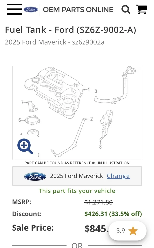

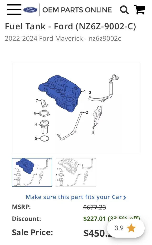

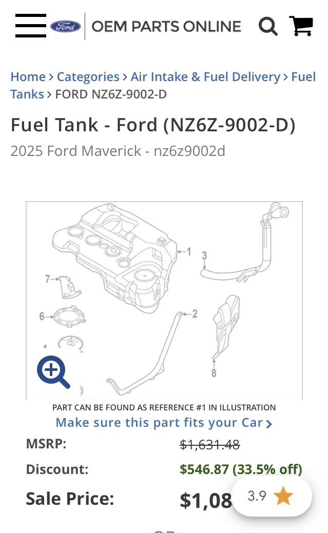

The fuel tank for 2025 is rev “-D” and the 22-24 is “-C”.
D more expensive, but picture looks the same as C (on the outside).

Are these for EcoBoost or hybrid??
It is my understanding that both Hybrid & EB have always shared the same gas tank. Hopefully the EB benefits from a more robust tank than vice versa.
Edit - nope, my 25 EB uses a different tank part# rev -A.
Looks the same on outside but probably lacks the internal baffles etc of the Hybrid

Update - AI states the Hybrid uses a different tank than the EB.
The rev -D may be hybrid & not EB?
AI days there is a simpler rev -A for EB.
My 25 ecoboost uses the rev -A

Hi Glen,
Seems I was wrong. The EB &
Hybrid have different gas tank part numbers…
Look the same on the outside - but it is a mystery what differences lurk within!
Gas Tank Part Numbers:
SZ6Z-9002-A … EB
SZ6Z-9002-B … Corsair
SZ6Z-9002-C … Hybrid
SZ6Z-9002-D … Hybrid revised

Thank you for researching and posting the part numbers. The hybrid revised part numbers could be just a different seal. It does not have to relate to size of the physical tank.
Who knows where the pressurization unit is. It could be external or internal?
Fact remains they still hold more than 13.8 gallons. 👍

The tanks are actually the same, on the pre-25MY anyway.
Ebay has some great photos from many angles - I posted in another thread.
Here are 2 tanks - notice the model numbers actually on the tank are the same. You can look at many listings for sale, and see the same thing.
The attached stickers say the difference - FT Shell for P758 FHEV or ICE. That probably makes the difference for the pump to insert, or something else.
But the tank is the same - they list both applications on the molded imprint.
NZ61 9002A
NZ68 9002B
https://ebay.us/m/KN5Byv - ICE
https://ebay.us/m/wyZQkb - FHEV
