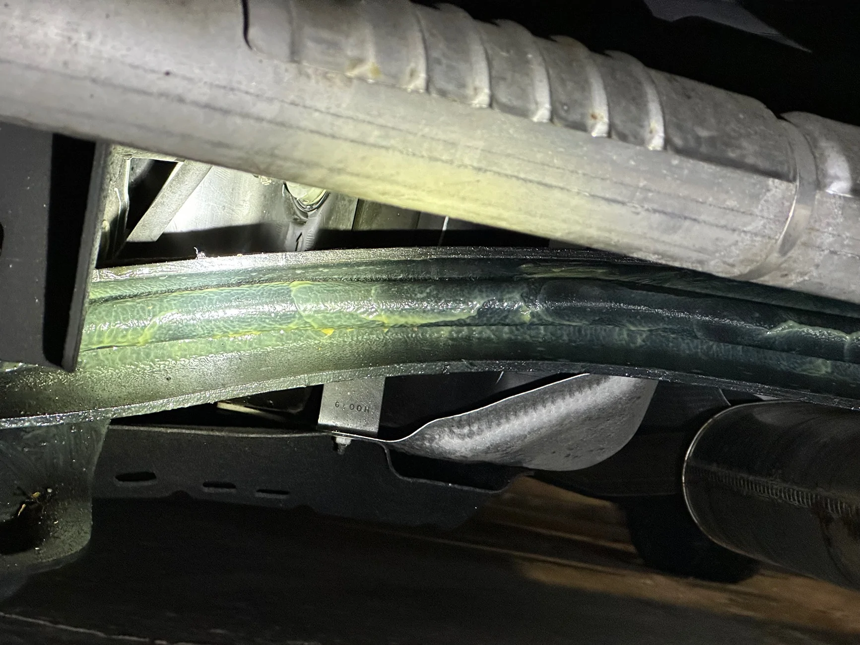

I’ve been dealing with a gas tank leak since the fall of 2024 when I started noticing a gasoline smell coming out of my garage when I opened the overhead door. Thought that it may have been a gas can or something causing the smell, but noticed a leak coming from the fill pipe inlet when I had it up on the lift at home at the end of the year. Took the vehicle under warranty to the ford dealer, and was told that the hose clamp was loose connecting the fill pipe into the fuel tank itself that they confirmed was fixed wire a smoke test. Truck had 18000 miles and was just a couple months shy of 3 years old.
Was sent on my way with the vehicle, and noticed a smell of gasoline and fuel not even two months later (at this point out of bumper to bumper warranty.) Took it back to the dealer and was told that they were unable to replicate any leaking detectable by their smoke test, and that I was good to go. I didn’t see any evidence of a leak nor did I smell any gas from April to November (warmer months in Michigan.)
Once the weather got cold again, took the vehicle back after noticing a much larger leak and smelling fuel during an oil change on the lift again, and am now being told by ford that the fuel tank does in fact need to be replaced as the tank is leaking from the fill pipe inlet. I am no longer under warranty and was quoted $1100 for this repair. Dealership is telling me that the leak was hard to detect as it weeps fuel from that area of the tank in the cold weather (which explains why I was seeing this last winter before the warranty was up and why I wasnt noticing it over the summer when it was warmer.)
I tried to include a pic a took from the rear of the truck, looking at the fill pipe inlet between the torsion beam.
Anybody else running into this problem? I found an old thread from 2022/2023 from someone with a hybrid like me that seemed to have the exact same issue, but it is seeming to not be very widespread.
Also, anyone that has experience wirh ford customer support - is there anyway to get this covered? I feel like this was misdiagnosis on my dealers part when it was under bumper to bumper and since it’s a fuel tank leak, I can’t just let this go without resolving it. It sounds like I may qualify for some “financial assistance” per the dealership but they said it will not be covered 100%, which I feel it should - between misdiagnosis and me bringing it in now for the 3rd time for this issue.

Posting an update on this one, finally got my vehicle back on 01/12, I dropped it off to them on 12/11 so they had it for a whole month. I had to go through ford financial assistance, which I was told will never cover 100% of the cost. After getting a few different figures from them (they initially wanted me to pay $1100, then $300, and finally $100) I have a new tank installed.
The interesting thing? When I was “negotiating” with financial assistance and we were about to order parts, the service manager was working through the parts counter and he told me that the original part number for the fuel tank on my maverick was on stop-sale. That part number was NZ6Z-9002-C. Usually, manufacturers only put parts on stop-sale when they’ve identified an issue with them and they can’t sell them to the public. The new tank installed in my truck is NZ6Z-9002-D and it is noticeably different than NZ6Z-9002-C. Looking up NZ6Z-9002-D I can see it for sale through dealership websites, but not through parts.ford.com yet.
So do we have a recall incoming? I’ve seen a few additional posts on this forum for hybrids having this exact same gas tank issue, and I posted this same saga on the maverick subreddit and have had additional reports in the comments there. I’m sure many more have experienced this issue, they just aren’t active online. So hopefully ford issues a recall for this - leaking fuel/vapors is a major safety issue!
