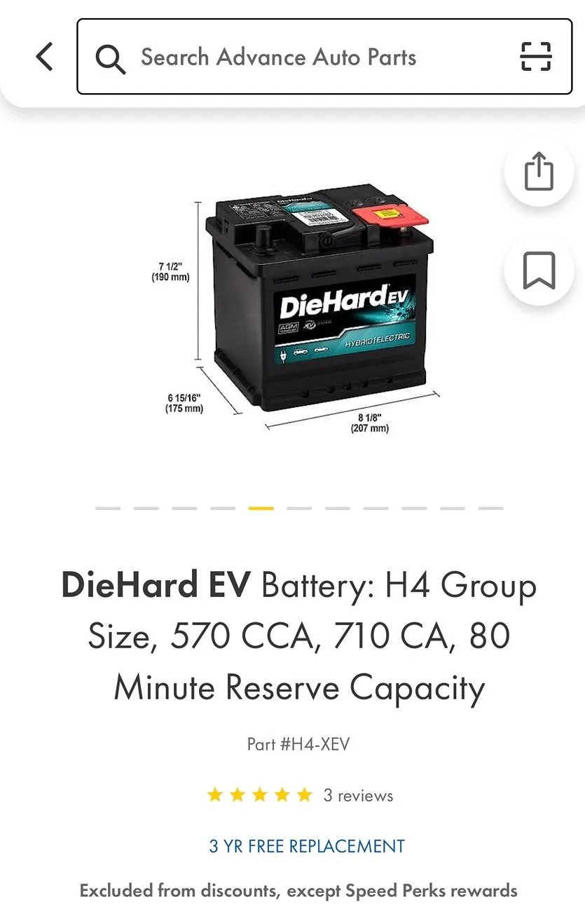

I hate to keep flogging this horse but I’ve been having the deep sleep issue for a year and just had it at the dealer for routine maintenance and asked to have the issue looked into. They said the battery tested good yada yada and they charged it up.
Less than an hour after they dropped it off I got another battery saver message.
I came across a DieHardEV H4 AGM battery on Advance Auto Parts website that seems to be the same dimensions as the T4 Gold accept it is about a half inch taller.
Has anyone tried this one?
This one has shown up in several prior threads and other MTC members have used it. It is a half inch taller but, it does barely fit. The problem is the high cost for this battery verses the alternatives. I was able to purchase my ACDelco LN1 AGM online with no issues for about $90 less than the Diehard EV available at the local auto store. The Diehard EV works but, it’s just too expensive when other options exist.
