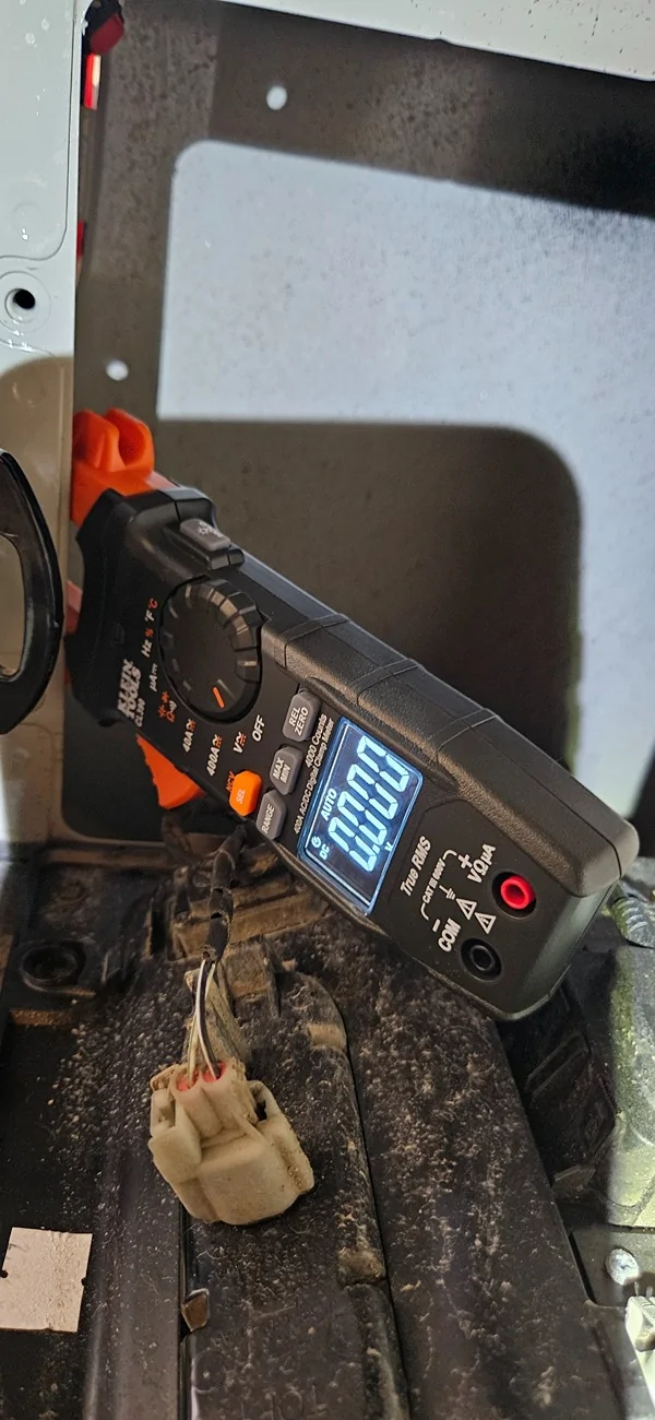

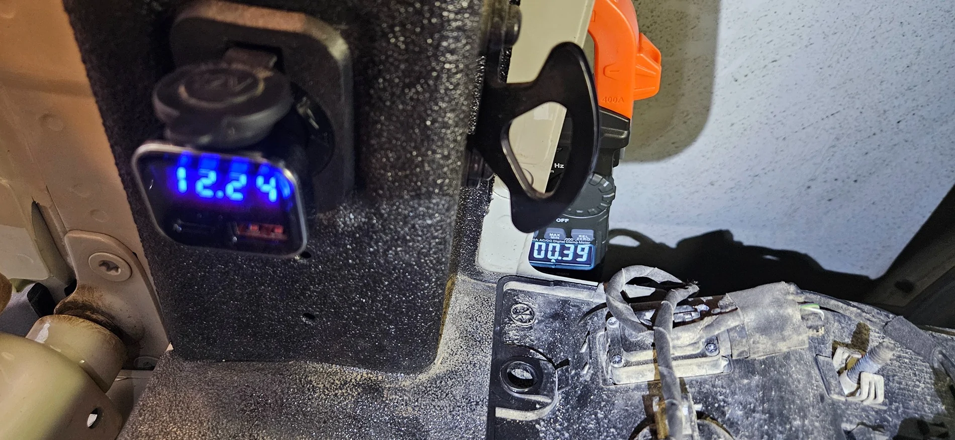

Okay, I just finished several hours of messing with the truck in the garage...gotta like it!
All in trying to see if 12 volt power is or isn't present if no loads plugged i to the 12 volt ports.
I have used my truck, a 2025 Lariat hybrid that has had all updates that are available for it as the test vehicle, and has a battery that was almost fully charged before beginning.
It has no electrical, battery etc issues that I know of other then the need for using MM's lights tricks to keep the battery topped up.
I used my Klein clamp meter (the clamp portion of it) for the first time (read the manual on operation, again) to read the amperage.
The panel in the back left corner of the box that holds the 120 volt plug was removed for access.
Power applied to 12 volt system
This is after the truck timed out and all 12 volt power was lost.
I clamped/metered the wire leading to the 12 volt power port, turned on and off accessory power and with all 12 volt loads removed prior, the 12 volt port was powered, with nothing plugged in, in the truck. I had to use the DC amperage setting.
When the truck timed out after about 90 minutes, all power was lost in the 12 volt system, as expected and as indicated.
Every trucks operation may vary, and battery charge status will affect operation as well.

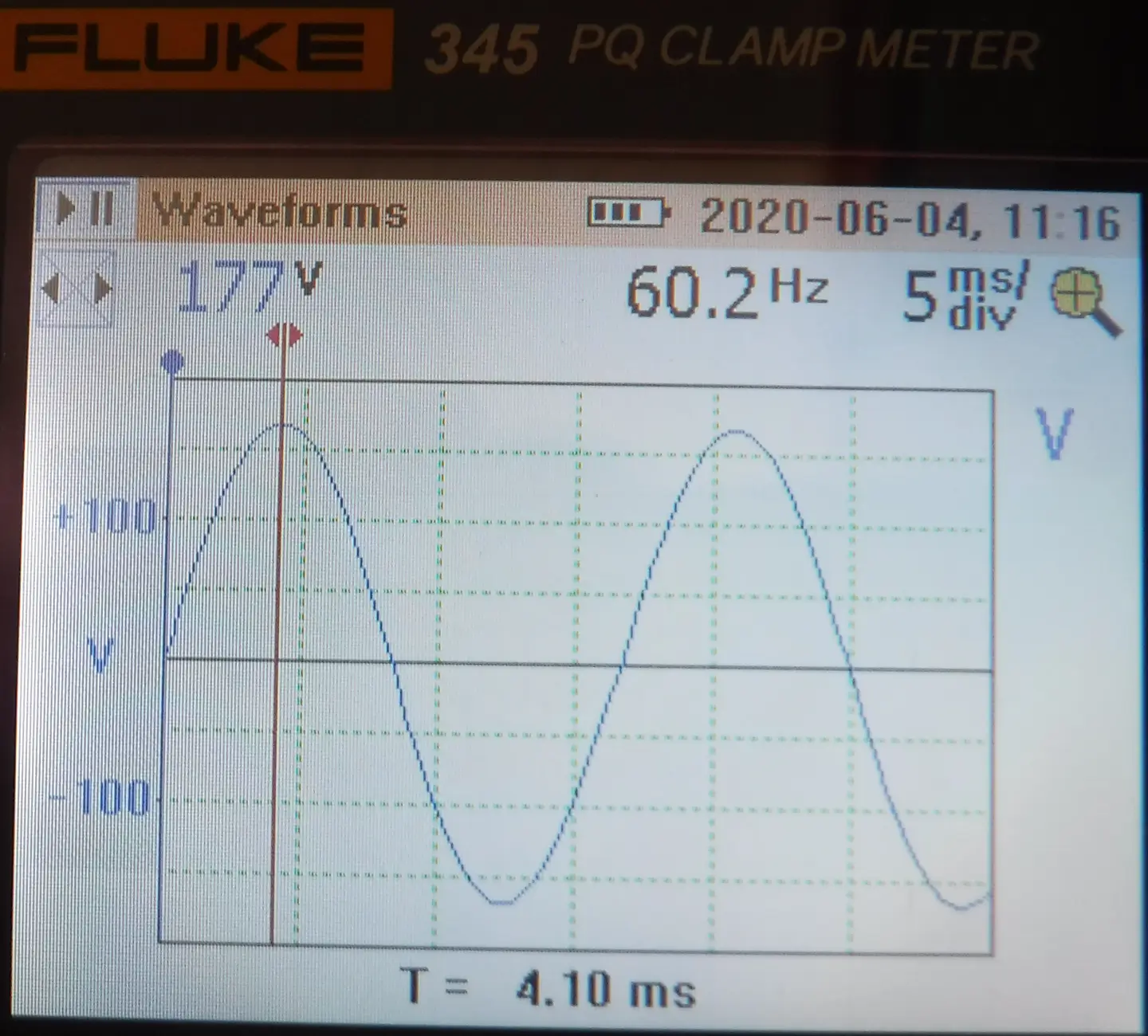

Andy. If you think of it check to see if the 120 volt circuit reads 60 volts between each of the blade plugs separately and the round ground plug (using residential wire colors black to green and white to green). If each leg is 60 volts then this should confirm that the inverter is a split phase inverter. Remember that there is no "true ground" in a vehicle.😁
ETA=
I remember from my plumbing days having to hammer a ground rod wired to pipe rack when everything was wet into ground to prevent being shocked while running pipe threader.🤗🤗🤗

Thanks for using your time and equipment on this Andy. I'm reading this as your tests confirm the 12v flex bed leads continue to supply power for 90 minutes after powering the vehicle down, even if there is no electrical load present?
Good morning, @2024ash
Yes, for my truck, which is a 2025 Lariat Hybrid, I have a truck that keeps its 12 volt power "on" for approximately 90 minutes after I have shut it down. I had removed all loads prior to testing.
I used a clamp meter around the 12 volt power point wire in the rear of the truck bed instead of metering, so that I would not accidentally activate the circuit while using it to see if there was voltage being supplied...just on case, and I already had the clamp meter as I had some electrical troubleshooting to do on our camper van.
I also can confirm I had a well charged battery in our Maverick before I began. Not so much after though!
ETA=

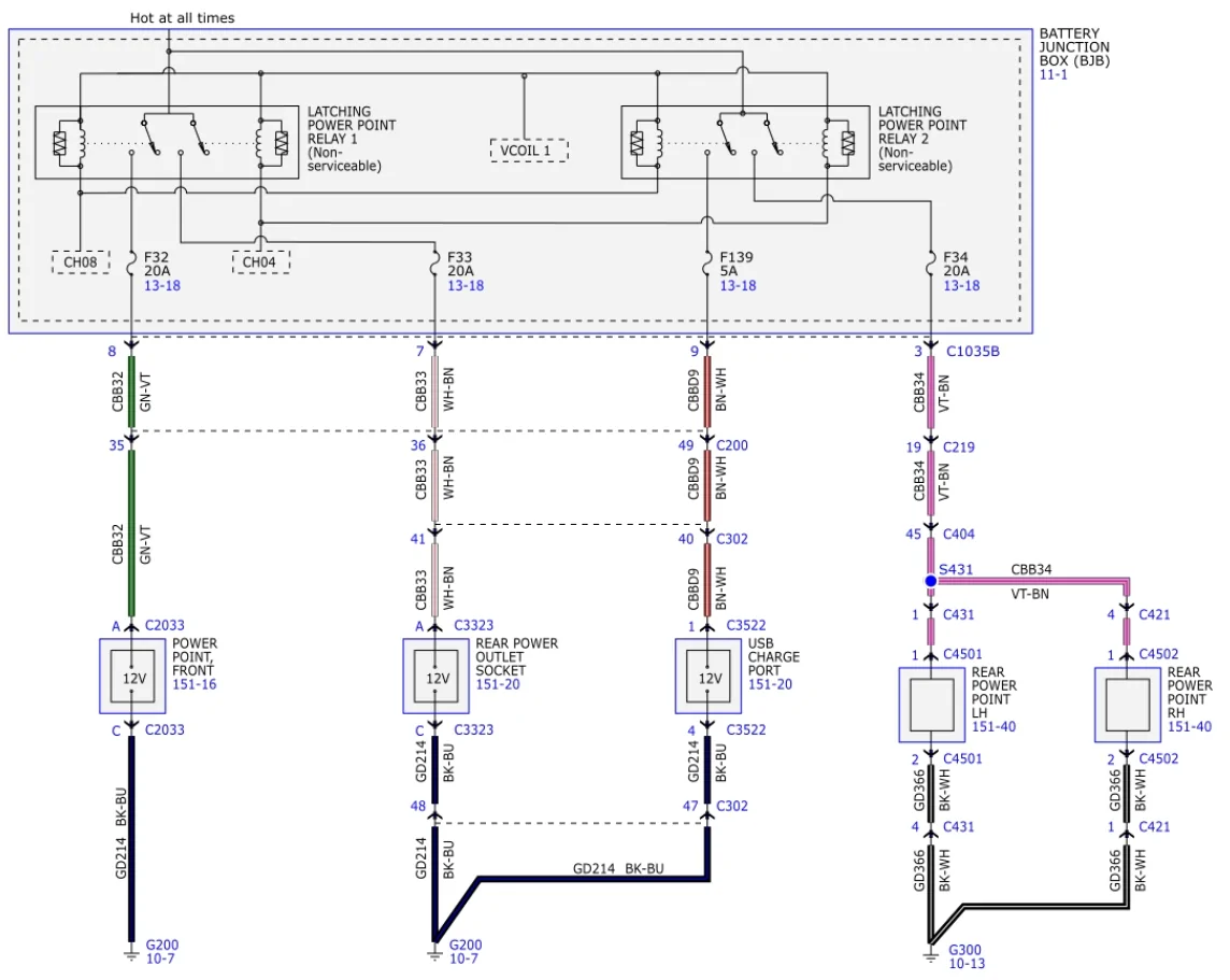

it seems that those that report having the 12 volt power go off immediately on ignition off, I would meter the rear power port or even the interior power port...it is my thought they are are all on the same circuit and should read the same...none...I would meter both, in case I am incorrect in my thoughts.
Andy
I haven't looked at the wiring diagram either, but I suspect you are right.
That would allow the timer to terminate all accessory power to save the 12 volt battery.
It sounds like you are more interested in resolving this so I'll be on the lookout for what you find.
Rather than the power off unless power is used scenario for the bed plugs being a EB vs Hybrid, or model year difference, I'm thinking it may be due to a keyed vs push to start issue.
IIRC, there are others on this thread who reported the same findings I had - No bed plug power used at KEY off shut down means no bed power on.
Since only the XL has a keyed ignition, that may well be the missing variable.
At least in my case, bed plug power had nothing to do with the battery SOC in my test case.
Perhaps someone else with an XL can provide their results...

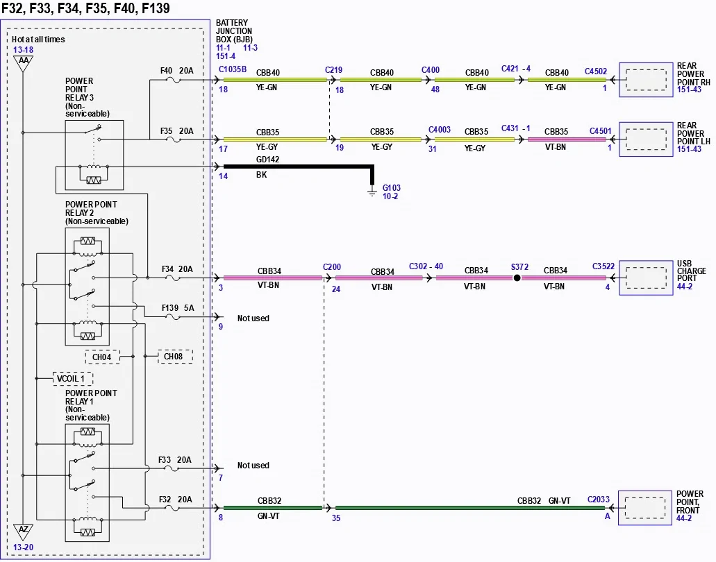

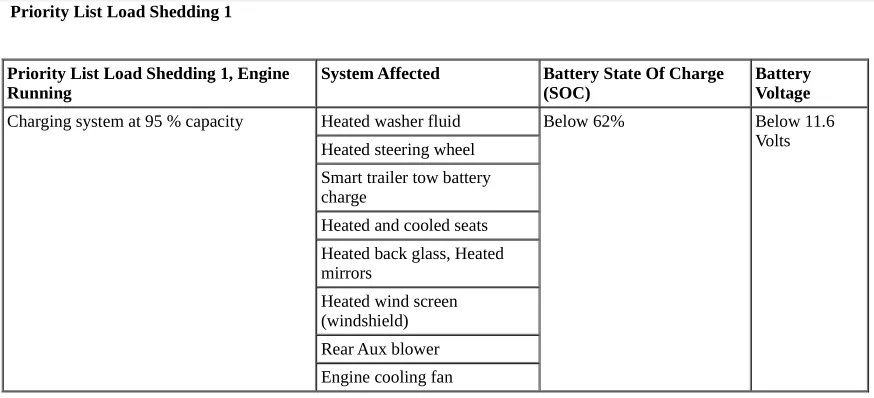

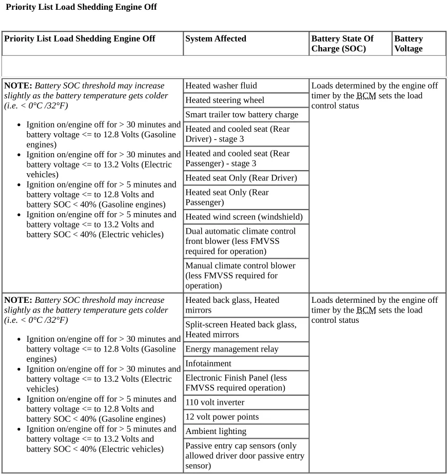

Sounds like the 12V Power Points are operating normally as designed by Ford, just like the HVAC Climate Control. The owner just has to figure out what that is.
Exterior Lighting - System Operation and Component Description
• The BCM load shed strategy is not active (a message is displayed in the instrument cluster, such as Low Battery Features Temporarily Turned Off or Turn Power Off To Save Battery, to indicate that BCM load shed strategy is active).

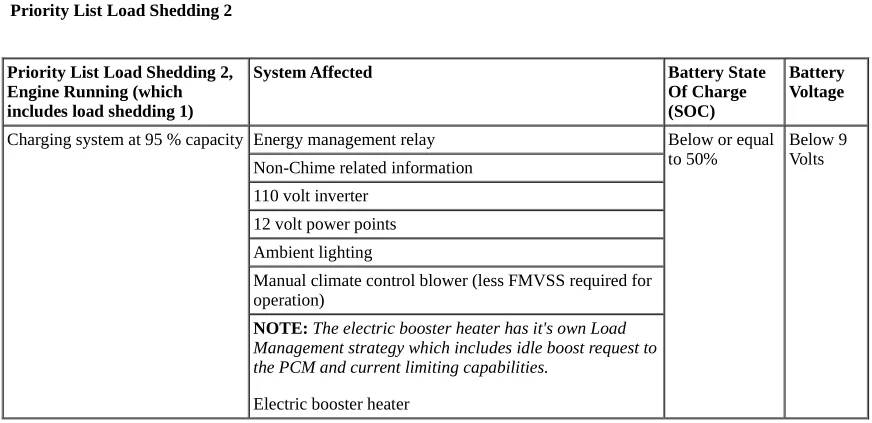

414-01 Battery, Mounting and Cables Description and Operation
2025 Maverick - Procedure revision date: 02/5/2025
Battery Load Shed
The main purpose of controlling electrical consumption with a load management strategy is to:
• Limit battery discharge
• Monitor the battery charge status
For vehicles with gas engines the alternator is not dimensioned to support all loads in all situations.
In some situations energy has to be drawn from the battery. These are mainly during:
• engine idle
• cold climate with a lot of electrical heating functions active
• warm conditions with the engine cooling fan running
• large transient loads (i.e. EPAS )
For HEV/BEV vehicles, a DC/DC converter control module is not dimensioned to support all loads in all situations.
In some situations, energy has to be drawn from the battery.
Vehicles built before 2025 have a partial load shed strategy.
Vehicles built after 2025 contain the full load shed strategy.
During cold conditions, the charge acceptance of the battery is very low which increases the time needed to recharge the battery.
This means that it can take up to several hours of driving before the battery is recharged.
The electrical consumption control is using Ignition_Status, Remote_Start_Status and EngineStateInternal in order to define the load management strategy during the different operating states of the vehicle.
The BCM is the primary module that is responsible for controlling the load management strategy.
The BCM processes measurements of the system and uses the information for calculations and load prioritization.
The strategy allows drain to occur from the battery. Load Management minimizes the drain by controlling the time and magnitude of the drain that can occur.
The battery drain changes depending on the driving cycle and the types of loads the driver has activated, therefore, the BCM must be able to shut down or reduce the loads if necessary.
The intent of the initial load shed stage, LSHED1, is to reduce electrical loads in a manner that is not noticed by the vehicle operator.
During LSHED1, requests are sent in a prioritized order for the appropriate modules to begin shedding available loads.
In order to prevent customer satisfaction issues, the loads are requested to reduce power consumption with minimum impact to the customer.
The second load shed event, LSHED2, occurs in two stages, SHED2_TRANS and SHED2_CONTIN.
During operation of a vehicle equipped with large transient loads, there are transient peaks for current draw.
The Load Management algorithm reacts to these spikes by using the SHED2_TRANS state.

2025 Lariat Maverick:
Power Point Relay 3
--> F40 20A -> Rear Power Point RH
--> F35 20A -> Rear Power Point LH
Power Point Relay 2
--> F34 20A -> USB Charge Port
--> F139 20A -> Not Used
Power Point Relay 1
--> F33 20A -> Not Used
--> F32 20A -> Power Point Front

Hello again, @MakinDoForNow
So I tried to find out for you but wasn't able to get my meter probes into the bed 120 volt blade openings, they are pretty restrictive.
Please remember my electrical expertise is...not expert!
I tried clamping each of the two wires on the bach side of the plug and put a load on the plug and no joy...that only is for amperage and not what I was going for anyways. But I was curious.
Anyways, it is Canada Day up here and I am just sitting down to watch the Jays and Mets game with my wife...I was listening to the radio play by play so didn't miss anything. :)
Battery Load Shed
• engine idle
This state requires all non-critical loads to shed immediately, without customer indication, so that large transient loads can operate normally with little to no adverse impact to the customer.
SHED2_CONTIN is a continuous deactivation of the loads to ensure the vehicle is able to restart once the ignition is turned off.
During SHED2_CONTIN, a message is displayed to the vehicle operator notifying them of the vehicle's charging system status.
Independent of load shed requests, the Load Management control can request boosts to the engine idle speed.
Boosting the engine idle speed allows for increased output of the alternator to deliver more current to the battery.
Idle speed increases are done through network IBoost messages.
The load shed charts provide a general overview of the features available on the vehicle based on the build options.
Load Shed Charts

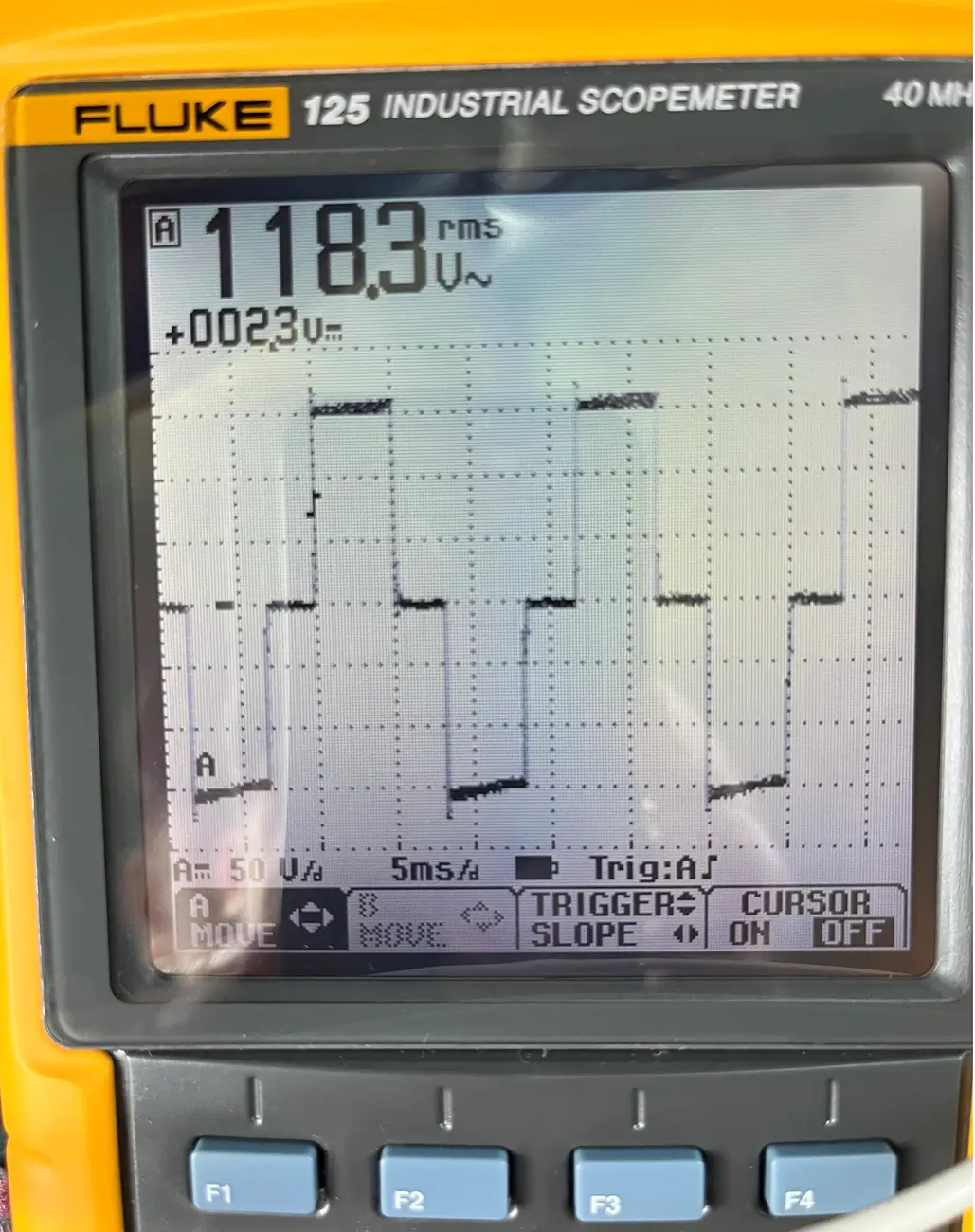

Ford Maverick 12 Volt bed outlet - what can it safely power? 1782938892374-qo
400W Inverter Line-Line measurement I made while a heat pad was plugged in.

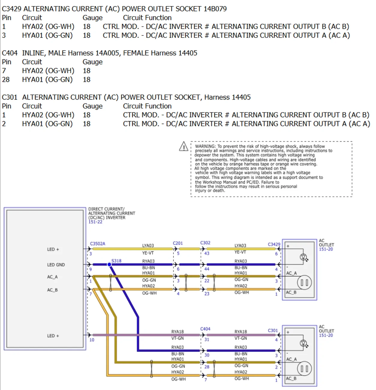

Wiring diagram doesn't show a ground and outlet doesn't have.

Old reading from a Yamaha EF2400is Inverter Generator by comparison.

Found this after reading post #74 which has diagram of wiring similar to residential L1+L2=120+120 for 240 circuit one leg being out of phase with the other. =
The 2022 Ford Maverick’s factory 400W system uses a modified sine wave, split-phase inverter topology that outputs two 60V AC legs relative to the chassis ground. However, because the vehicle isolates the electrical system from "true earth" ground, this configuration cannot safely or effectively be wired into a standard residential split-phase (240V) panel. [1, 2]
Understanding the Factory System
  • How it works: The 400W system shares 400W of total output across the in-cabin and truck bed outlets. It outputs 2 × 60V AC legs out-of-phase, combining to provide 120V AC. [1, 2]
  • Limitations: The factory 400 Watt inverter frequently faults if connected to high-draw appliances, medical devices, or large-motor tools. It is also unsuited for safely back-feeding a home's power grid. [1, 2, 3]
