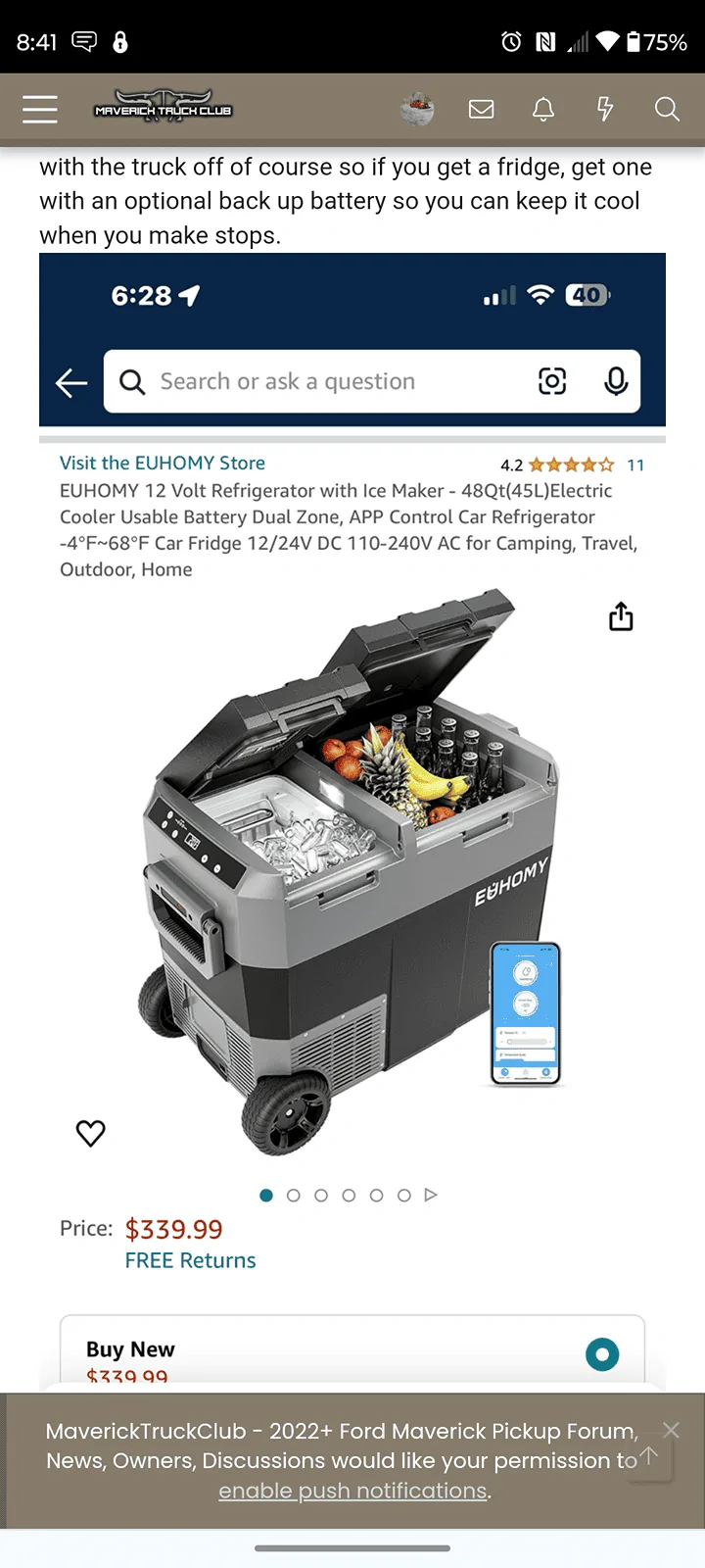

So I have a stupid question but that has never stopped me before. I have a 12v car fridge that I would like to hook up to the 12v power source in the bed. Can I just buy an adapter that plugs into the 12v source that then plugs into the fridge? Or do I need to use the supplied cable that plugs into the existing 12v source and then buy an adapter to hook that up to the fridge? I'm just looking for the simplest way to hook up the fridge so I can have a cold one while figuring this out. If I have to drill holes in the truck or use any advanced wiring I am not interested and will just continue to use a cooler and ice. Thanks
I bought something similar to this and it came with both style plugs
Ford Maverick The outlet in the beds -- can it handle a refrigerator? What can it power? Screenshot_20240616-084134
What are the “both styles of plugs?” Household 120VAC and 12VDC cigarette lighter?
I have used one similar to this for years and it works fine with the bed 120v outlet. It is great for long trips and we always pre-cool it in the house, usually the day/night before.
Also have a Jeep with a 400w plug that will NOT power it, but it works with the 12v plug…
Thanks. I bought a smaller version of the one you have from the same company and it’s arriving today. Glad to know that will work with the lighter output.

Hope you got the measurements down. My height just fit under the cover
