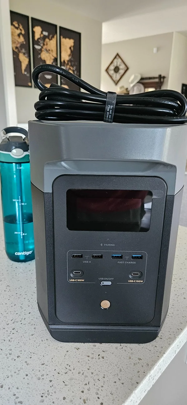

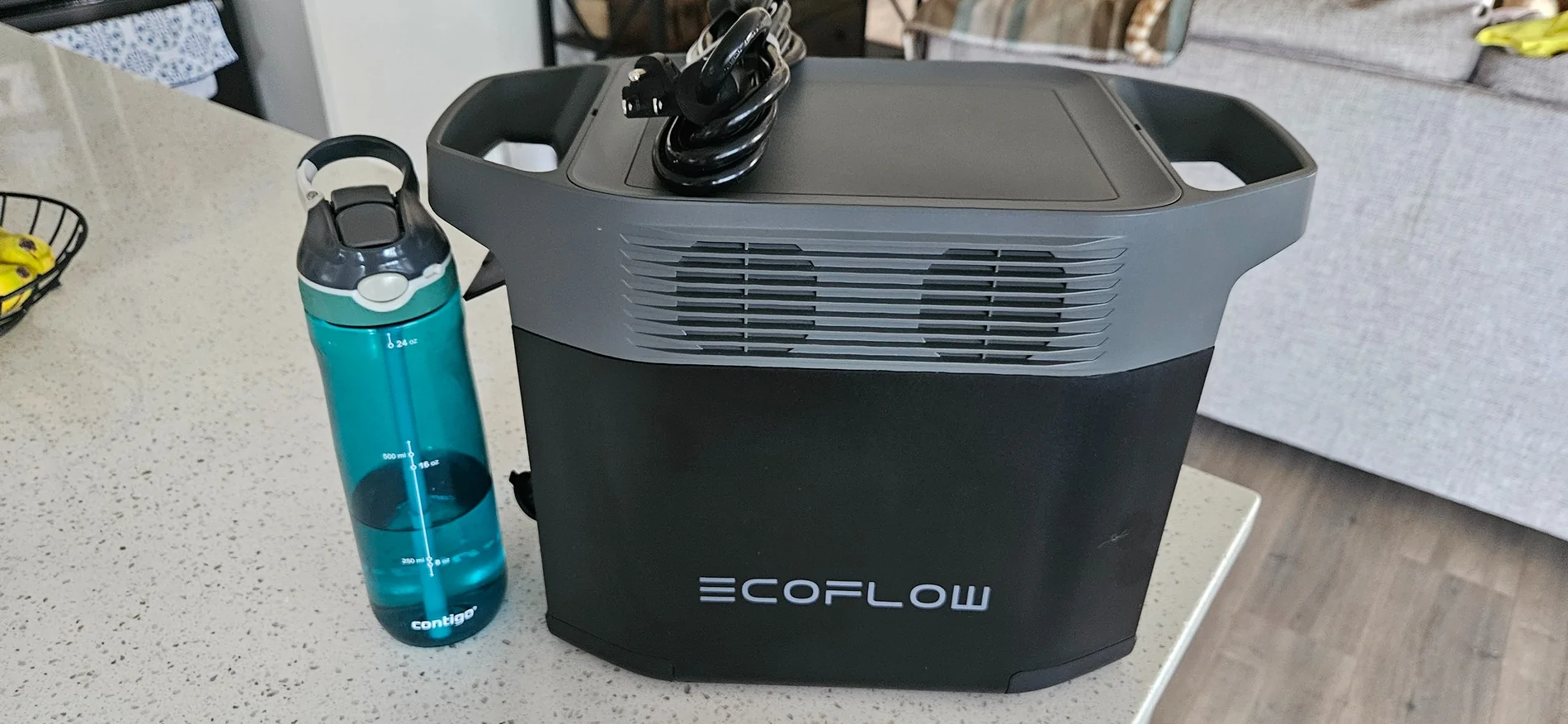

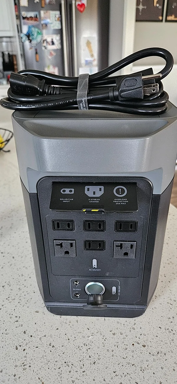

You may want to think about an external power supply, such as we have, and works great!
We have 2 ECOFLOW 1.1 kw power pack...look at their various products. But use the ECOFLOW to run your fridge/cooler when stopped...no need to run your Ecoboost all the time...when you hit the road you leave the cooler plugged into the ECOFLOW, your the ECOFLOW is plugged into your truck power point of your choice, AC or DC...through the app you can set the maximum draw of your ECOFLOW so that it never draws more then your trucks system will safely allow.
We do this all the time in our RV to power the Igloo cooler on the road...and the ECOFLOW can also be used for anything else electrical...we also use if for our KEURIG travel coffeemaker, an induction hotplate at supper stop spot on a picnic table, lights etc. It then recharges when we hit the road again!
We have two and I would recommend the ECOFLOW DELTA 3 and then the DELTA 2...same size, Delta 3 is a bit better exterior design/usage of plugs.
This is the DELTA 2 we have, the DELTA 3 is in use with our house sump pump...in case of a power outage.
So many wonderful ways to use this well made piece of kit.

Just another way to maybe help you out on your trip and like cold food and hot coffee and cold...beverages.
