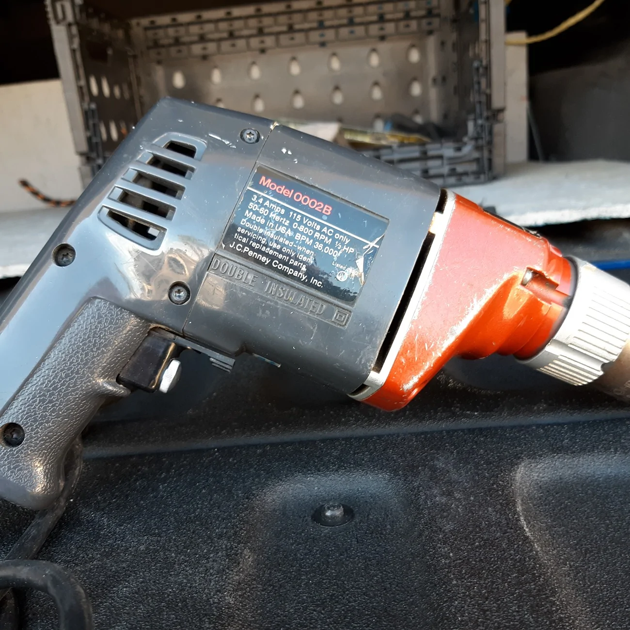

Who still uses a corded drill anyway?
🖐 ** I do.
JCPenney
3 in 1 corded impact, rotary impact or drill.👍
Ford Maverick Can bed mounted 120 volt outlet run small power hand tools? 20250930_075015
I guess I have to add a disclaimer.
**Not plugged into the Maverick.
