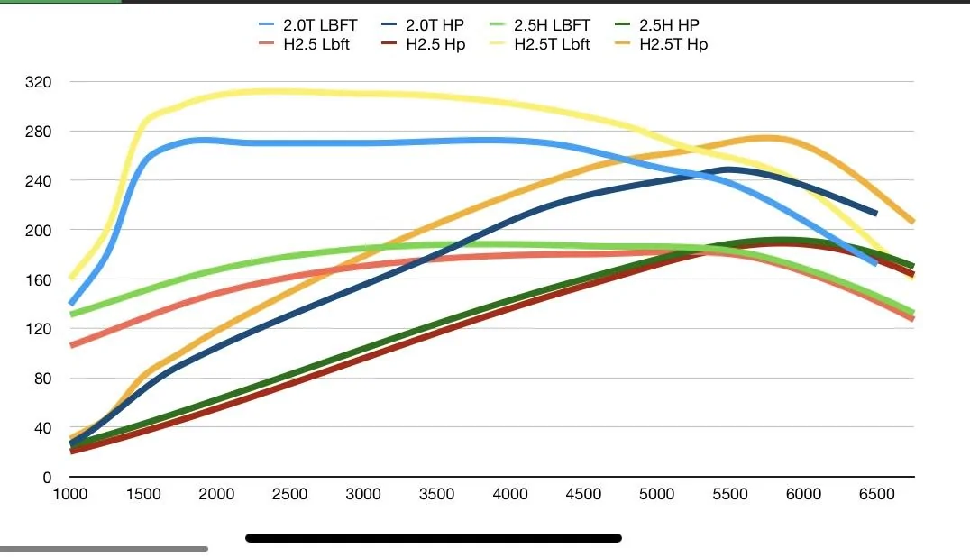

Ford Maverick Maverick 0-60 times (hybrid / ecoboost) 07B9D8E3-90CD-44EB-B6E5-00F41AB1EF1F
looking at the 2.5 n/a Hyundai vs Hybrid Maverick you can see the slightly more torque in lower rev range.
thats Where the Electric motor comes into play.

Dang I have no idea how to read this graph

It’s a Dynograph Curve.
The key is at the top.
lighter colors are Torque (PoundFeet) darker are Horse Power.
blue is the 2.0 Turbo Maverick
Green is the 2.5 Hybrid Maverick
red is the 2.5 N/A Santa Cruz
Orange is the 2.5 Turbo Santa Cruz.
numbers on the left are values.
numbers on the bottom are RPM.
so if you have your foot flat down on the throttle. This represents what HP and Torque your making AT THE FLYWHEEL at any given RPM.
these are estimated based off of real dynos but gives you a great idea of what the car will do.
so look at the light green vs light red lines. That’s the torque for the Santa cruz and Maverick. Both have similar PEAK numbers. But the ford is higher up.
thanks to the electric motor.
so the hybrid will be a little more peppy then I think people will expect. But don’t expect some kind of crazy EV type acceleration.

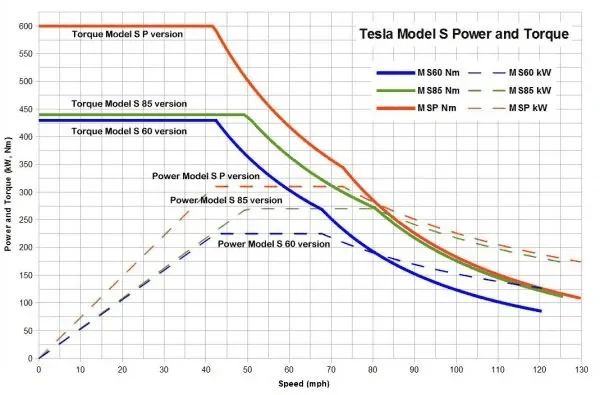

What electric motor? These are all ICE curves. Shapes are very different. EV output starts at peak torque at 0 RPM, stays flat for the "current limited" portion of the curve, then falls off. It won't have Tesla torque levels, but general shape is the same. Love to see EV curves for these cars.
Ford Maverick Maverick 0-60 times (hybrid / ecoboost) 1624926463396

Correct. So you take that curve and add it to the gas motor (2.5L with 155hp) and you get the curve above.
so you can see vs the N/A Hyundai they both have ~200lbft. But the ford has more torque at 1000rpm then slowly falls down to the same as the Hyundai at redline
