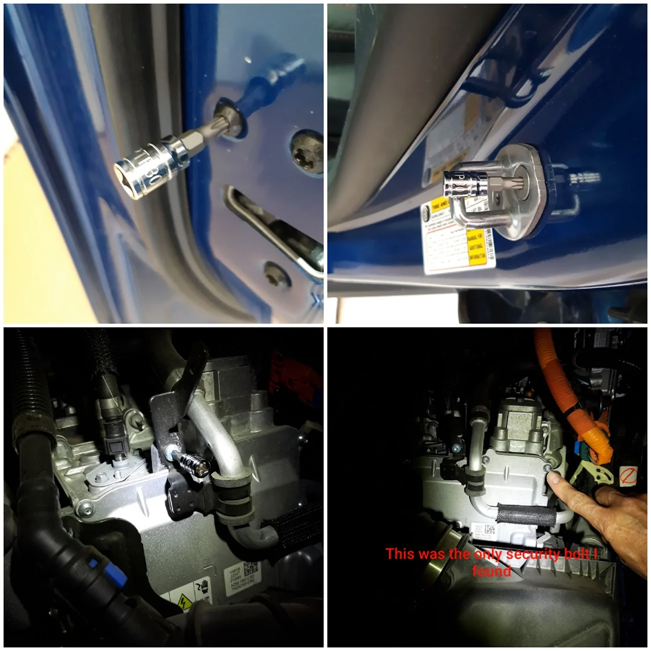

I started this thread because a lot of folks don't understand the differences between Torx & Torx PLUS.
Ford uses Torx Plus on our Mavericks.
The difference between regular Torx and Torx Plus is pretty significant. It becomes a difference between stripping out the bolt and not stripping it. Here are some pictures and a short 9-second video.
Yesterday I received my Torx Plus bit set. $21.06 on Amazon.
https://www.amazon.com/dp/B004UC9WJE
This video shows the slop using a Torx in a Torx plus fitting. For those thinking it. Yes they are the same size. T45/TP45

Wonder if the Mav has any external Torx Plus or any "Tamper Resistant" Torx Plus fasteners (5 lobes vs. 6 with a pin in the middle, requires yet another type of tool).
Glen Baker LLC
Glen Baker LLC
May 29, 2024
7,513
12,814
Central Nevada & Utah
Maverick XLT Hybrid
John,
All the exterior bolts except the one that I'm pointing to in the engine compartment, are Torx Plus. The one in the engine compartment is a Torx security bolt.

Wow, thanks for this. I had no idea. No wonder I didn't like the fit of my Torx bits when I removed the bed tie down brackets in my Maverick (to install a toolbox). I've ordered a small set of Plus bits from Amazon to add to that toolbox.
