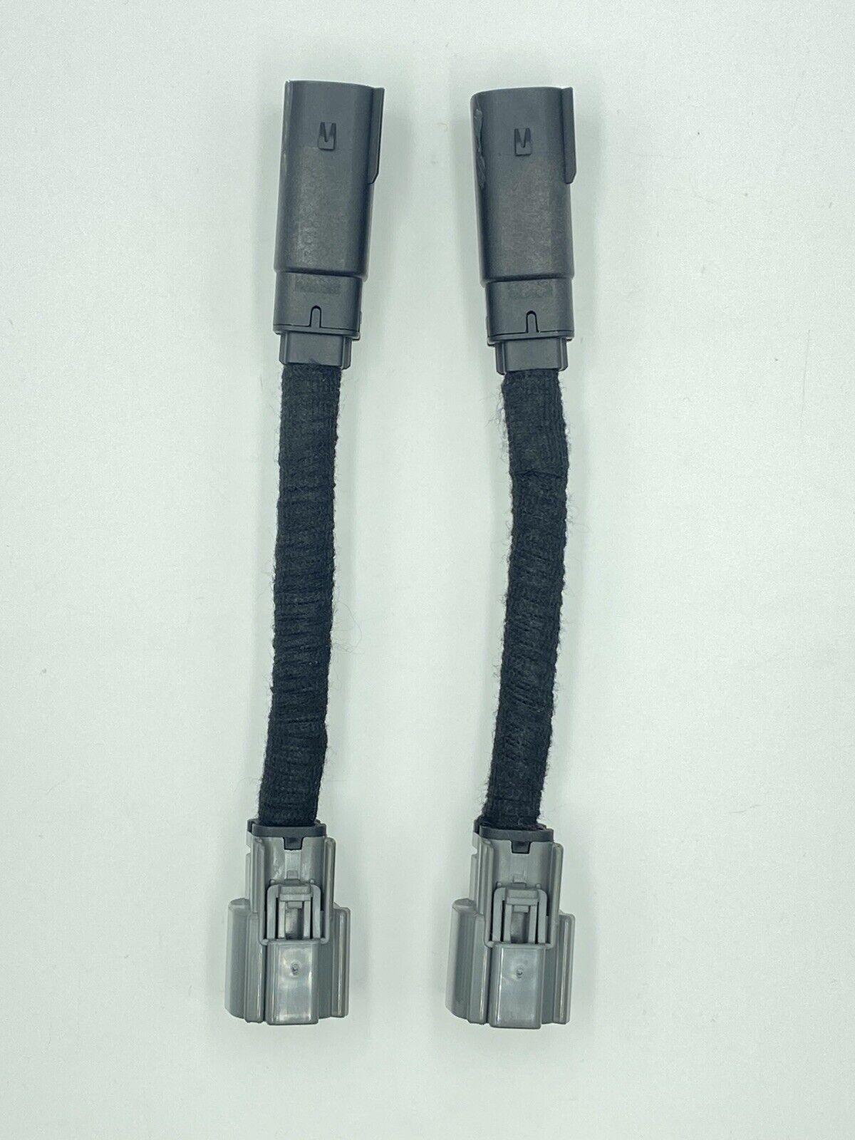

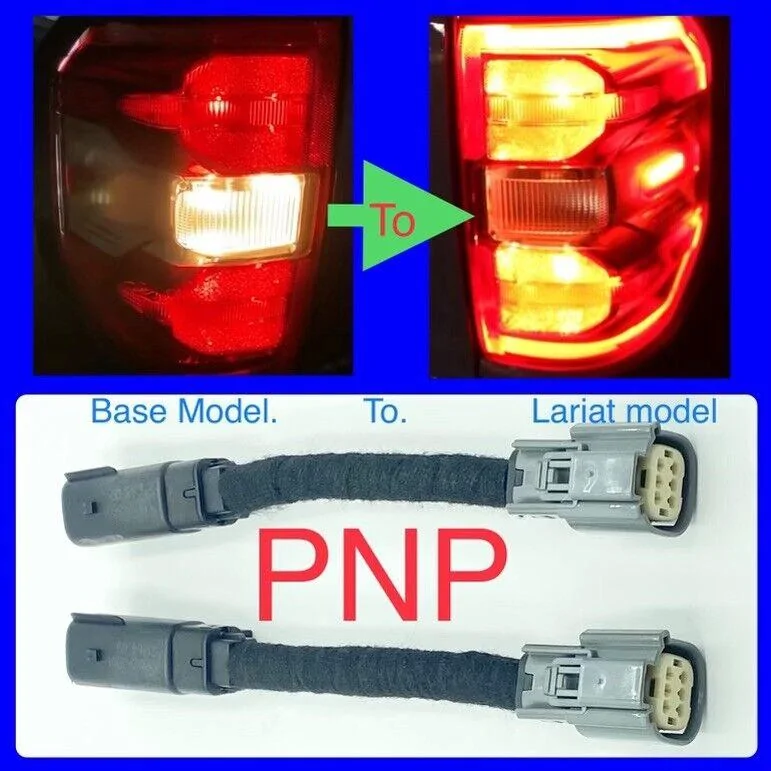

Nice! Do you happen to have a pic of the harness? I’m curious what it does considering mine went in plug and play…

On Ebay there is someone who sells them. Here is a picture. Hope it helps you out.

Thanks for answering so quick. Sorry I just asked about the grill again. Didn't get to your answer. Hope the pictures of the harness answers your curiosity. So I will not need a harness for my truck? I got a 23 xlt delivered 10/14/23. I like the Lariat taillights better. Let me know what you see that is different. Maybe they are the same?

Thanks I have to remove mine to change my Ford grill emblem and add a Maverick emblem to the grill. Did you get my picture of the Lariat taillight adapter? What do you see that is different than you using your original wiring?
The only difference is that Led strip which mine had the wire for from factory. A coworker’s XLT too. You can always get the harness but try without first! And I got BAP lights but the standard lariat still has the signature lighting just not tinted. And no problem!

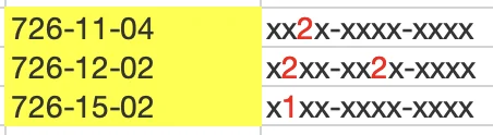

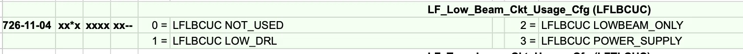

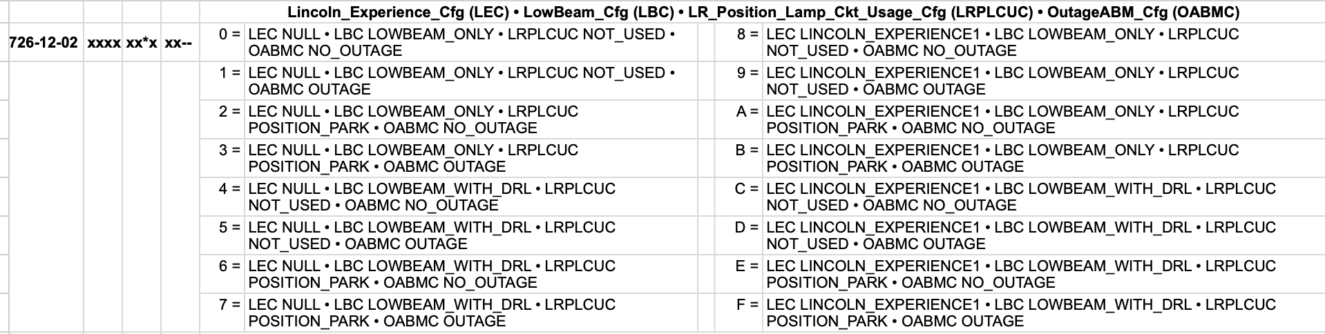

BUMP. @24atlasmaverick and Myself figured out the coding needed after installing the Lariat BAP OR NON BAP headlights on an XL and XLT. A LIN reinitialization may be needed after the coding change. The coding change is pictured below and I will be adding it to the ULTIMATE FORSCAN SPREADSHEET .
