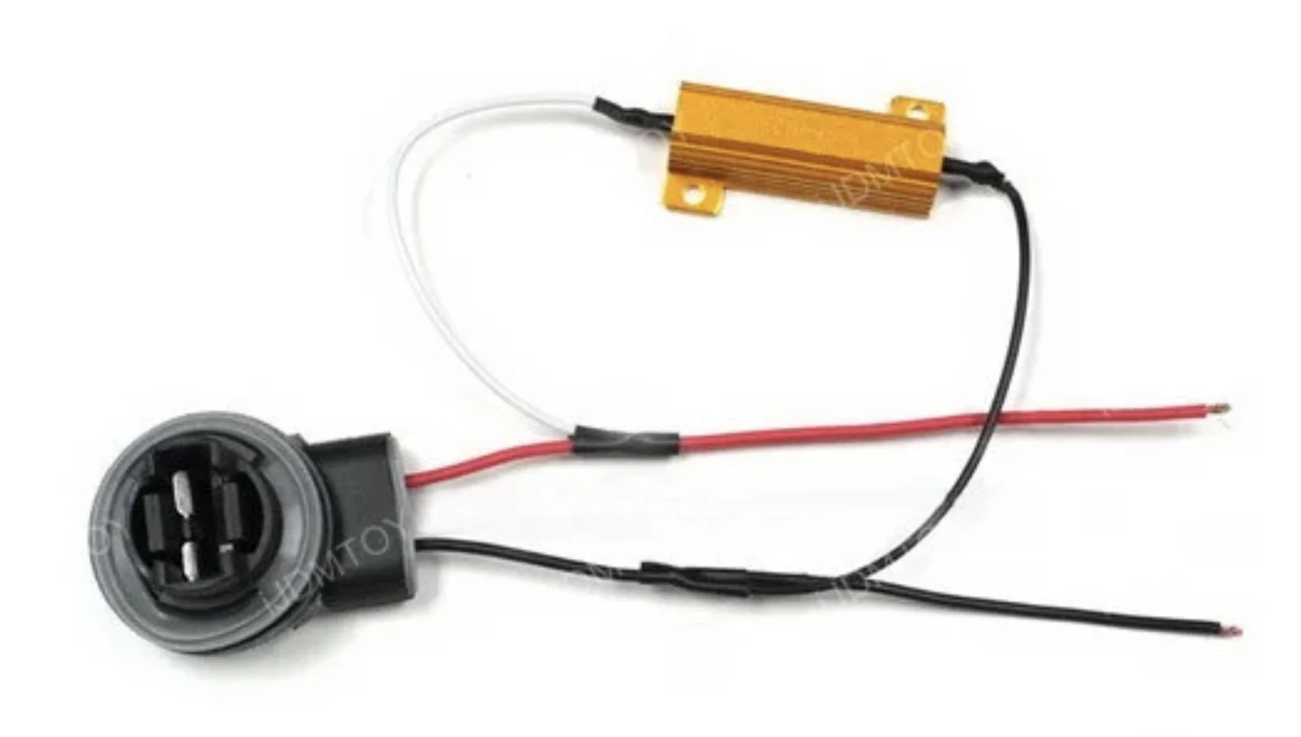

I have a '23 Ford Maverick XL pickup. I installed LED's for the tail lights and added 2ea load resistors per tail light. Each tail light has two Brake, Tail, Turn LED bulbs installed. After doing this, I still have hyper flash on the interior turn signals. Also, when the tail lights are 'On' and I turn on either turn signal, it barely blinks to the point of not noticeable. When headlights/tail lights are off, turn signals work bright as they should. The length of wire that comes with the load resistors are too short. I replaced the wires with 16 gauge red wires. All wires are soldered. Also, I have a tailgate sequential light bar that works fine. Any recommendations?

Halogen bulbs are 28 watts vs LED at 4 watts. Load resistor is 24 watt on 12 volt system.

did you wire the resistors in correctly? one end of the resistor goes to (-) the other goes to (+)

Yes, very simple, thank you!

I installed LEDs on my Lariat front/rear & the exterior lights flashed at a normal rate even though the dash indicators hyper flashed. I solved the hyper flash with FORSCAN. If the hyper flash doesn't bother you it's not really a big deal.

I did do all of the recommend changes in Forscan to prevent Hyperflash. After Forscan changes, I still have interior Hyperflash.

China bulbs yes, but not cheap @ $25 ea x 4= $100 on Amazon. LED bulbs must have all three functions-brake, tail lights, & turn signal in one bulb. Resistors were 50W 6 ohms from the Amazon 'best seller'.
