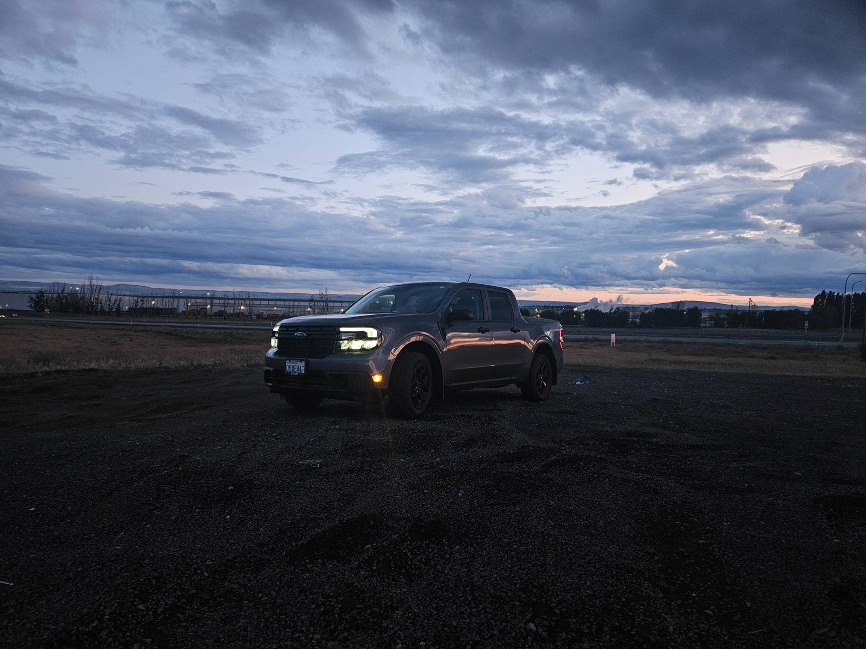

Thank you for the reply! Yeah I figured I could do that too. I was checking wiring diagrams through Identifix (I'm a mechanic) and I see no wiring differences between an XLT and a Lariat. (As far as headlights/turn signals. So I assumed it was done through software. I also looked and the XLT and Lariat use the same lamp sockets with 3 pins and see no changes there.

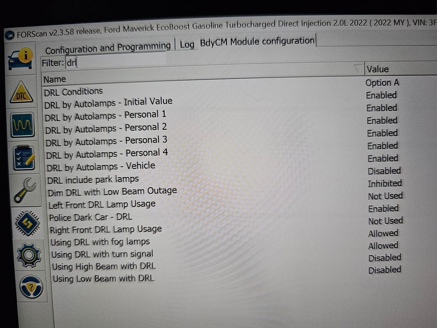

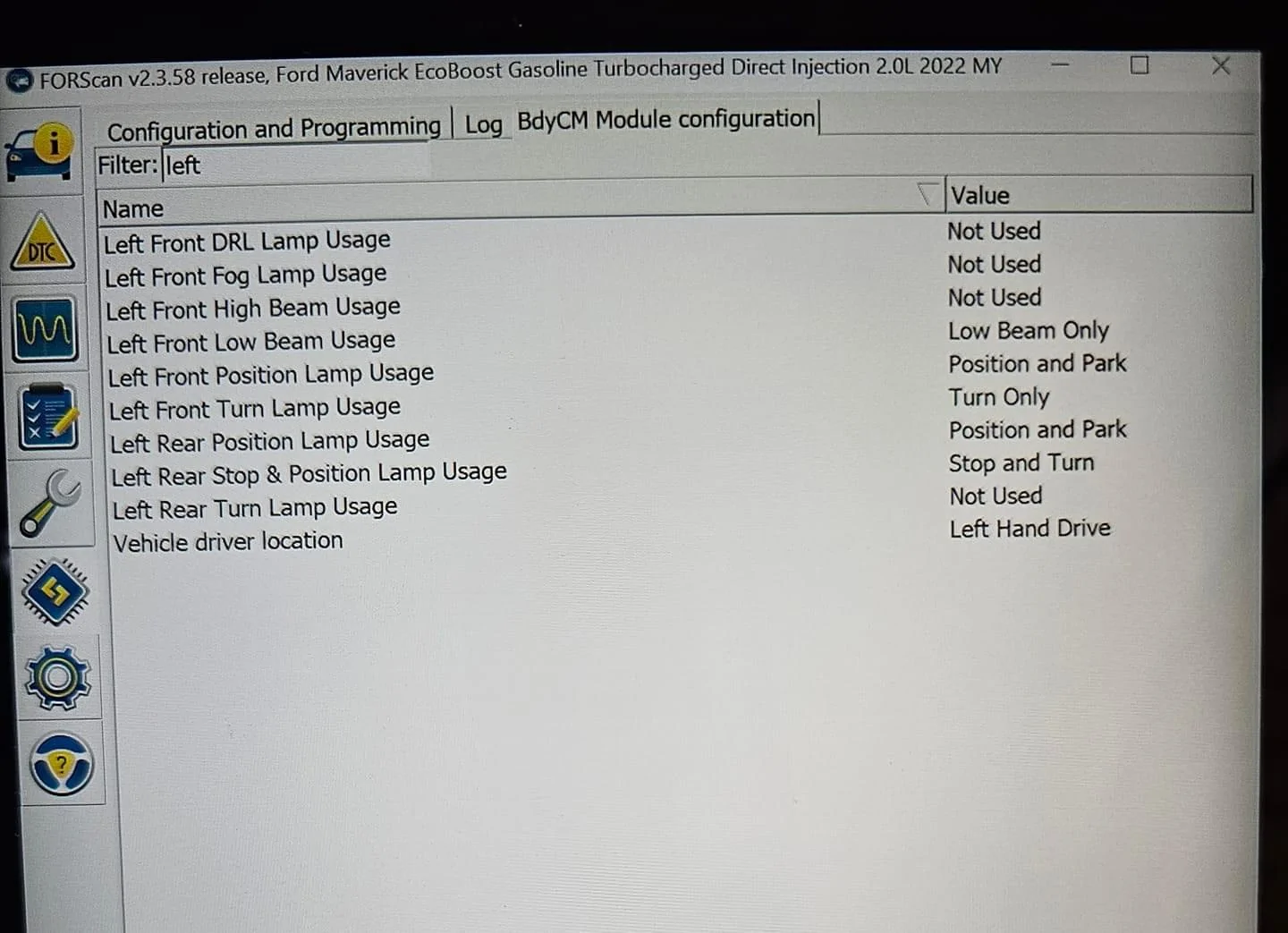

Anyone on here have a Factory Lariat and can share their AS built? Or a screenshot of the BCM settings in forscan for the parking/DRL settings? Mainly curious how Ford did it factory.
Worst case I can do what 24atlasmaverick did
I’m a ford tech, but I’m sure you can see the same wiring diagrams. Essentially, that middle circuit I de-pinned that is present on xl/xlt is absent on lariats. They only utilize pins 1 and 3.
Perfect thank you so much! Happy Mavericking
I'll get the grille bar back on when the black paint drys lol

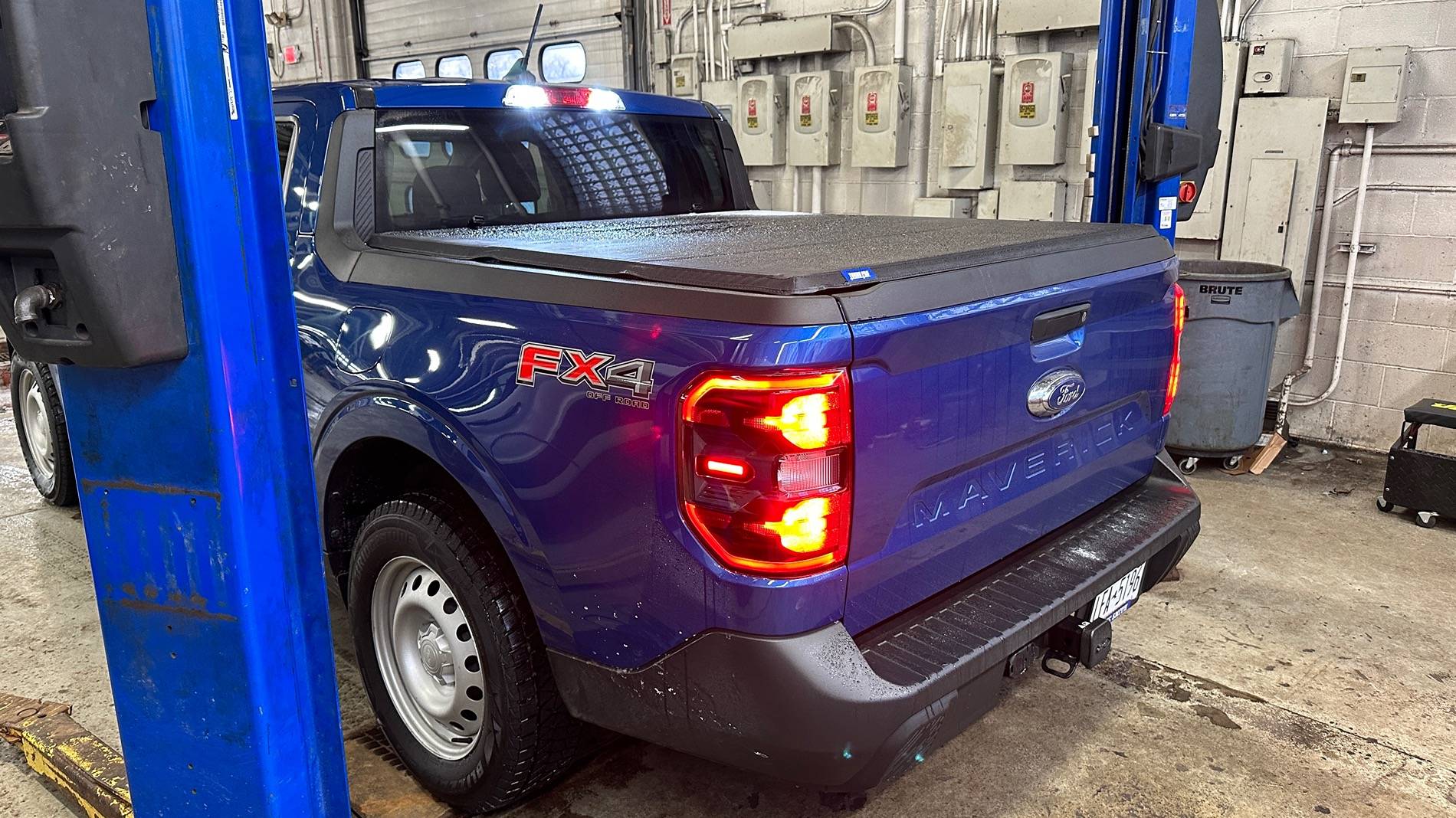

I followed your thread with great interest as I think the Lariat headlights look great. Now that you've documented the process it doesn't look too difficult. Do you plan to do the tail lights too or would that be too much?
I went with BAP/tremor tinted taillights. Both come with the LED accent lighting from factory on xlt or lariat so they are plug and play no mod required!
Ford Maverick Lariat headlights swap install onto XLT? IMG_4224

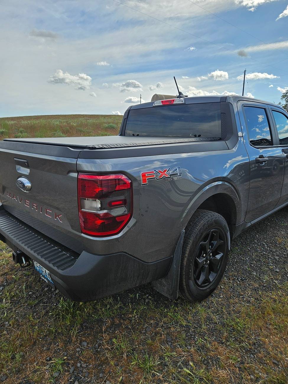

I did also swap the tails. They are plug and play. No mods needed
Ford Maverick Lariat headlights swap install onto XLT? 20250512_164403
