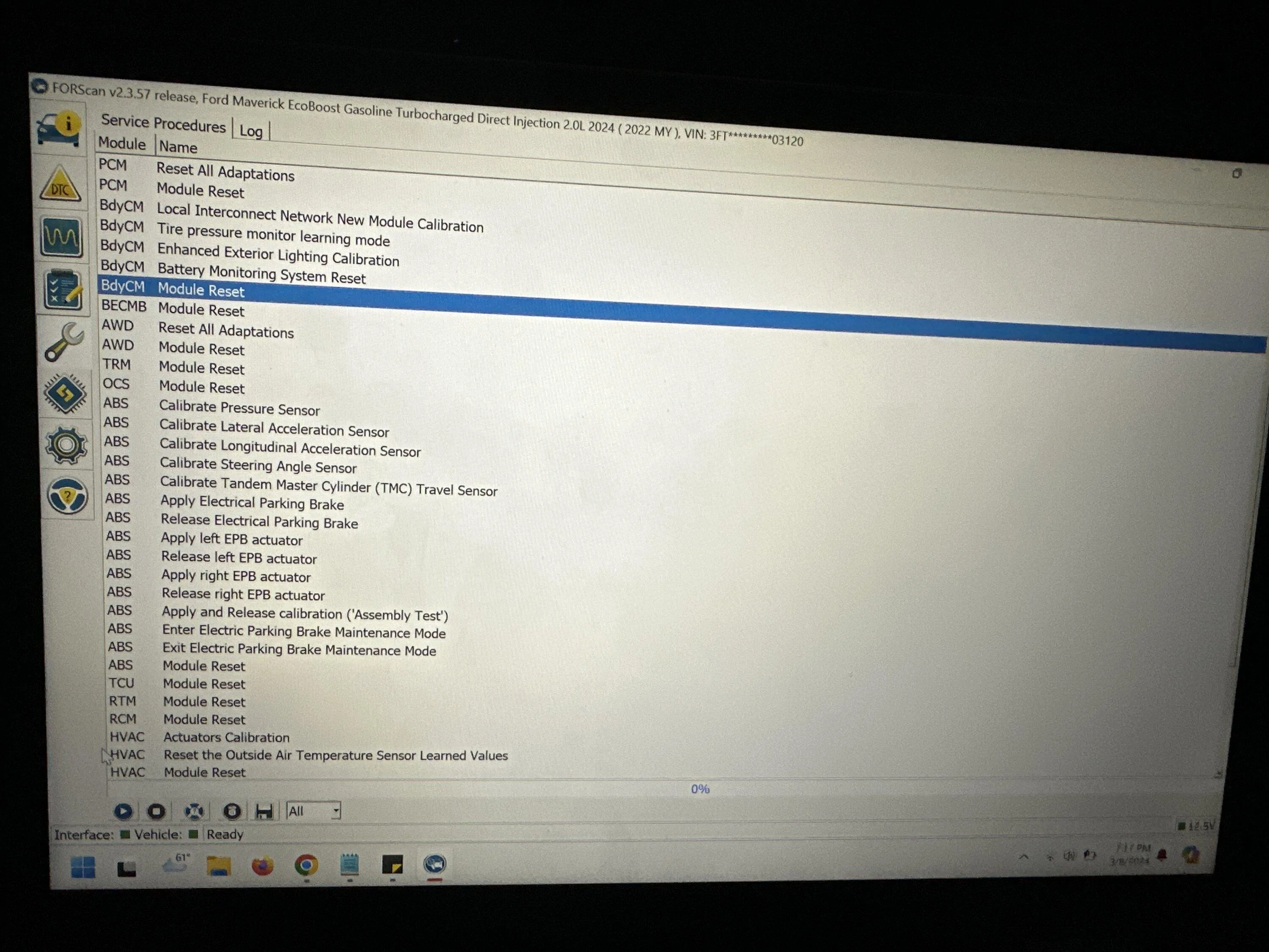

One last question sorry! When you mention “reset”, do you mean actually resetting the module as seen in pic below?

I believe that was it , but it took 2 or 3 times I believe in a row while turning the ignition on and off .cleared log , reread the dtc’s and cleared the dtc’s of that module too.
Mine had dtc’s stating drl not enabled on module.

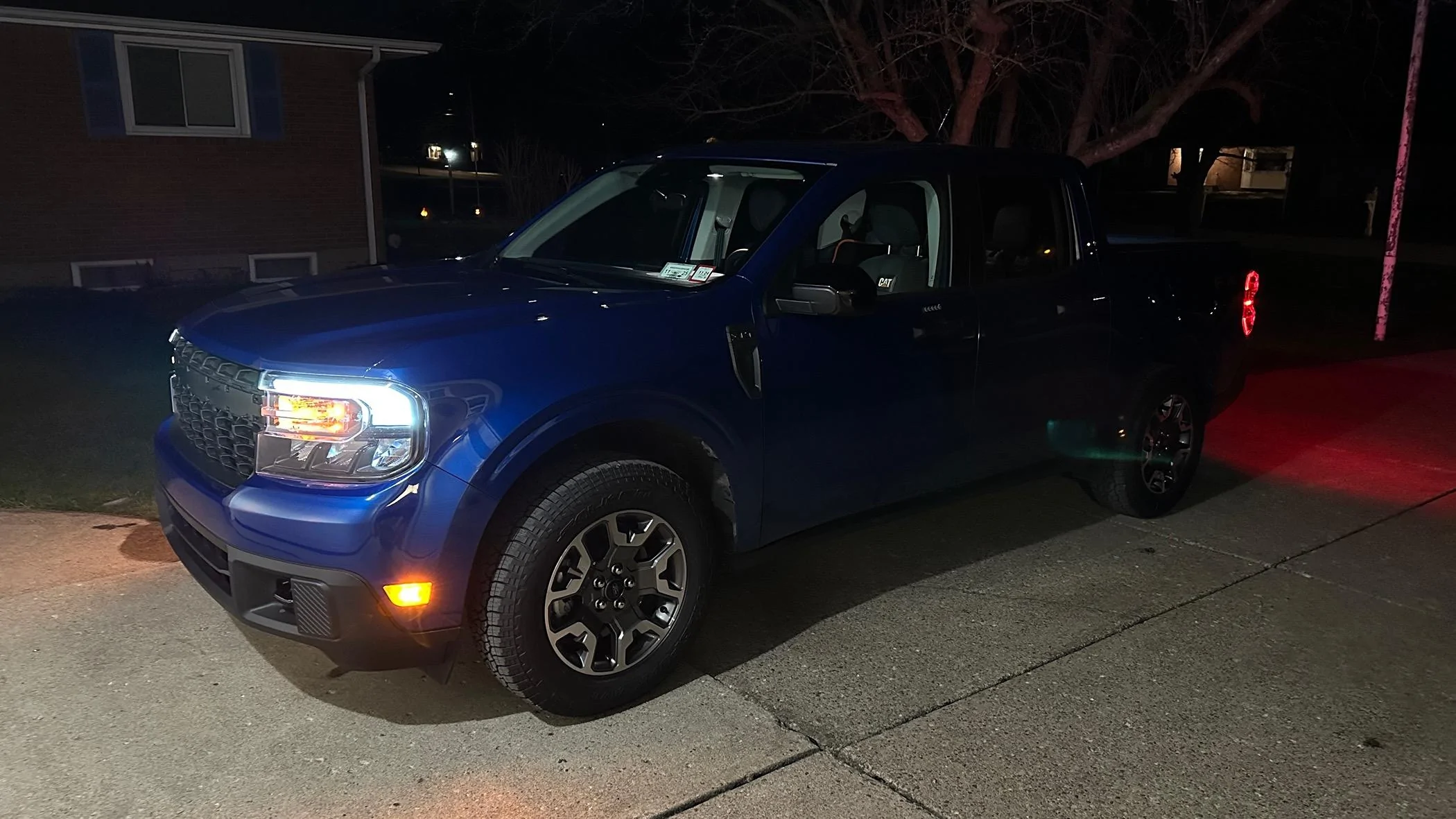

Hi! Sorry to bother you but thought I’d update! Your advice about resetting the bcm several times worked! Lights working great. Just have one question since you said you currently have a lariat. The upper portion, do they operate at one intensity or are they dimmer when headlights are on? Mine currently only operate at one setting and didn’t know if that’s normal or if more fooling around is necessary!

Yeah it was like 3 or 4 times of reset and clearing faults , kind of bizarre .

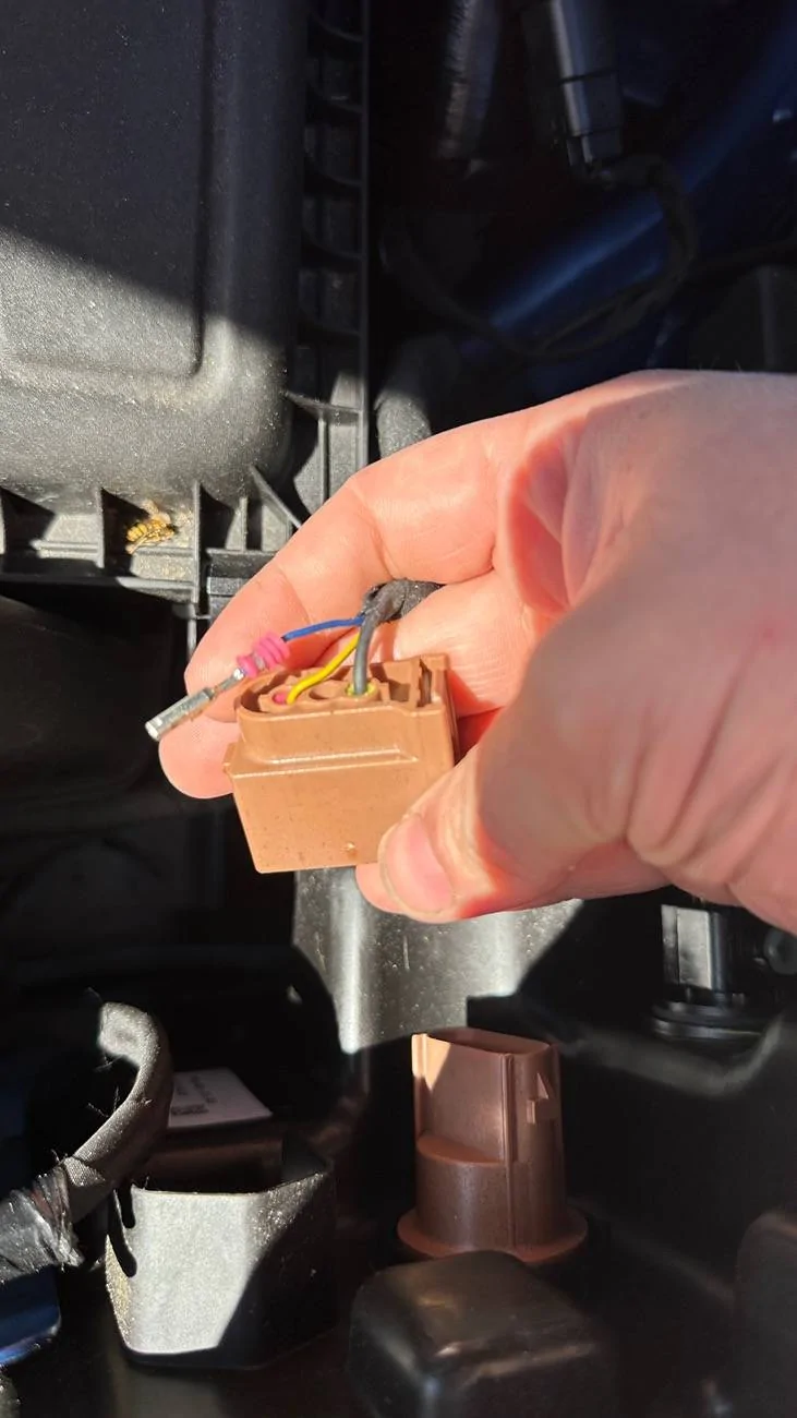

So for that, essentially what I did is, I just de-pinned the connector for each turn signal. If you look at the picture attached, I basically just disconnected them and I then wrapped them in electrical tape so that I don’t cause a short circuit. That pin is for the park whites and doesn’t affect turn signal usability because the other pins left in the connector are for ground and turn signal power.
Thank you for the reply! Yeah I figured I could do that too. I was checking wiring diagrams through Identifix (I'm a mechanic) and I see no wiring differences between an XLT and a Lariat. (As far as headlights/turn signals. So I assumed it was done through software. I also looked and the XLT and Lariat use the same lamp sockets with 3 pins and see no changes there.
Anyone on here have a Factory Lariat and can share their AS built? Or a screenshot of the BCM settings in forscan for the parking/DRL settings? Mainly curious how Ford did it factory.
Worst case I can do what 24atlasmaverick did
