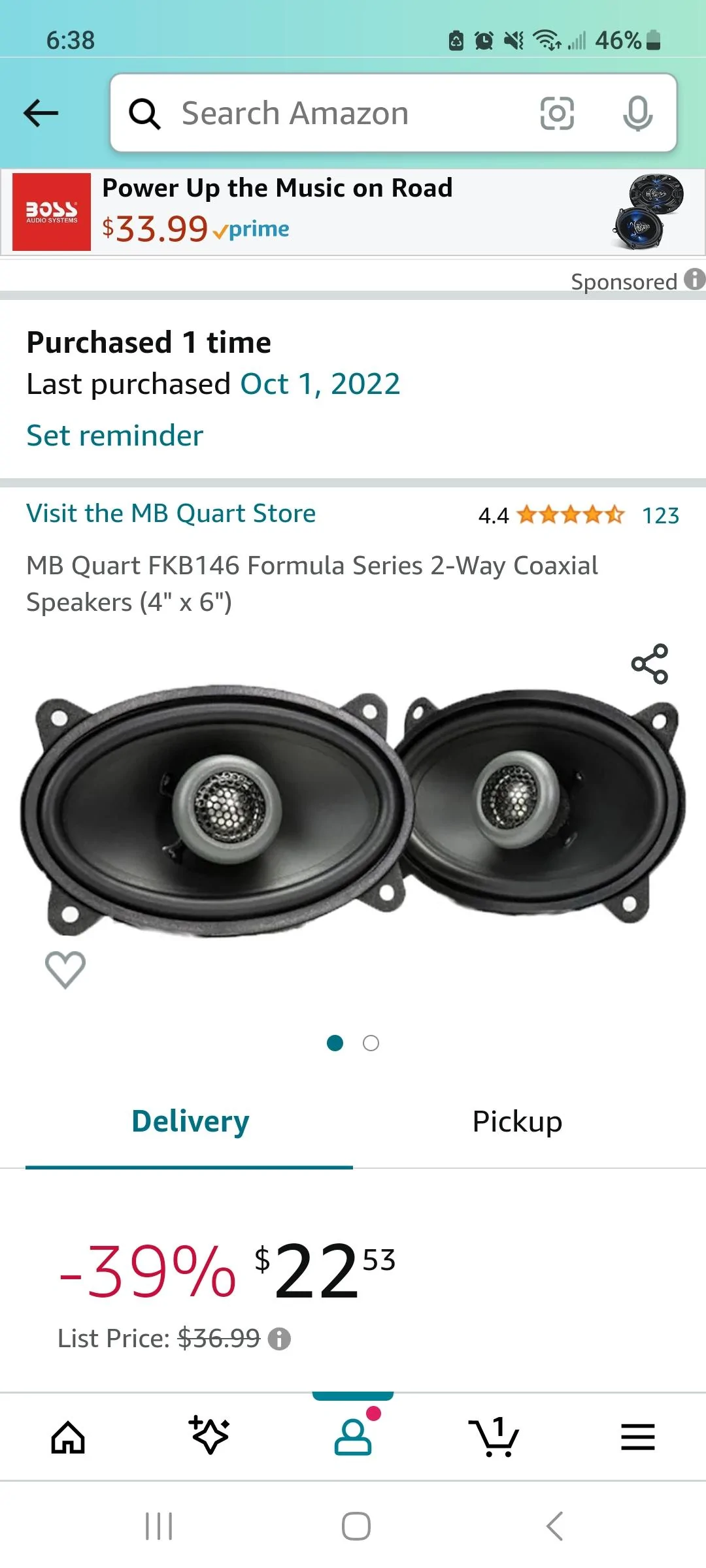

Which speakers did you replace the rears with? Overall I have been happy with the base XL stereo but I like the fade set to more towards the rear and those sound a bit "weak".
This was not a drop in exactly. It took finagaling to make them work and some sound deadening to pack in the pillar to create a small pocket instead of a open and empty C pillar. Then I mounted the speaker as flush as it would sit and sealed it with more sound deadening. Works great and it keeps up if not surpass the front stock speakers in clarity. I'm fine with that since the front stage is not bad with the amount of bass thats reproduced from the stock XL stereo.
