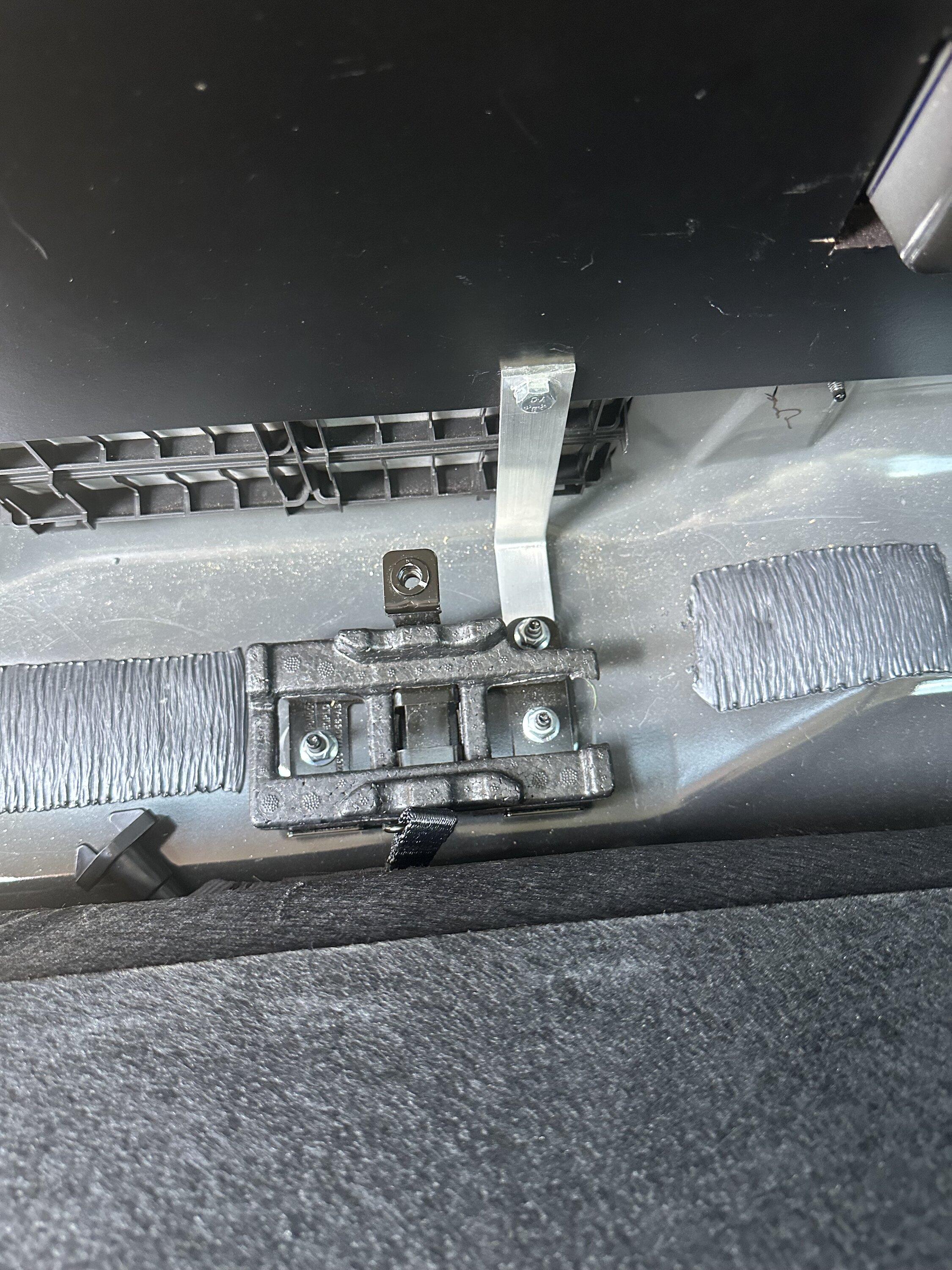

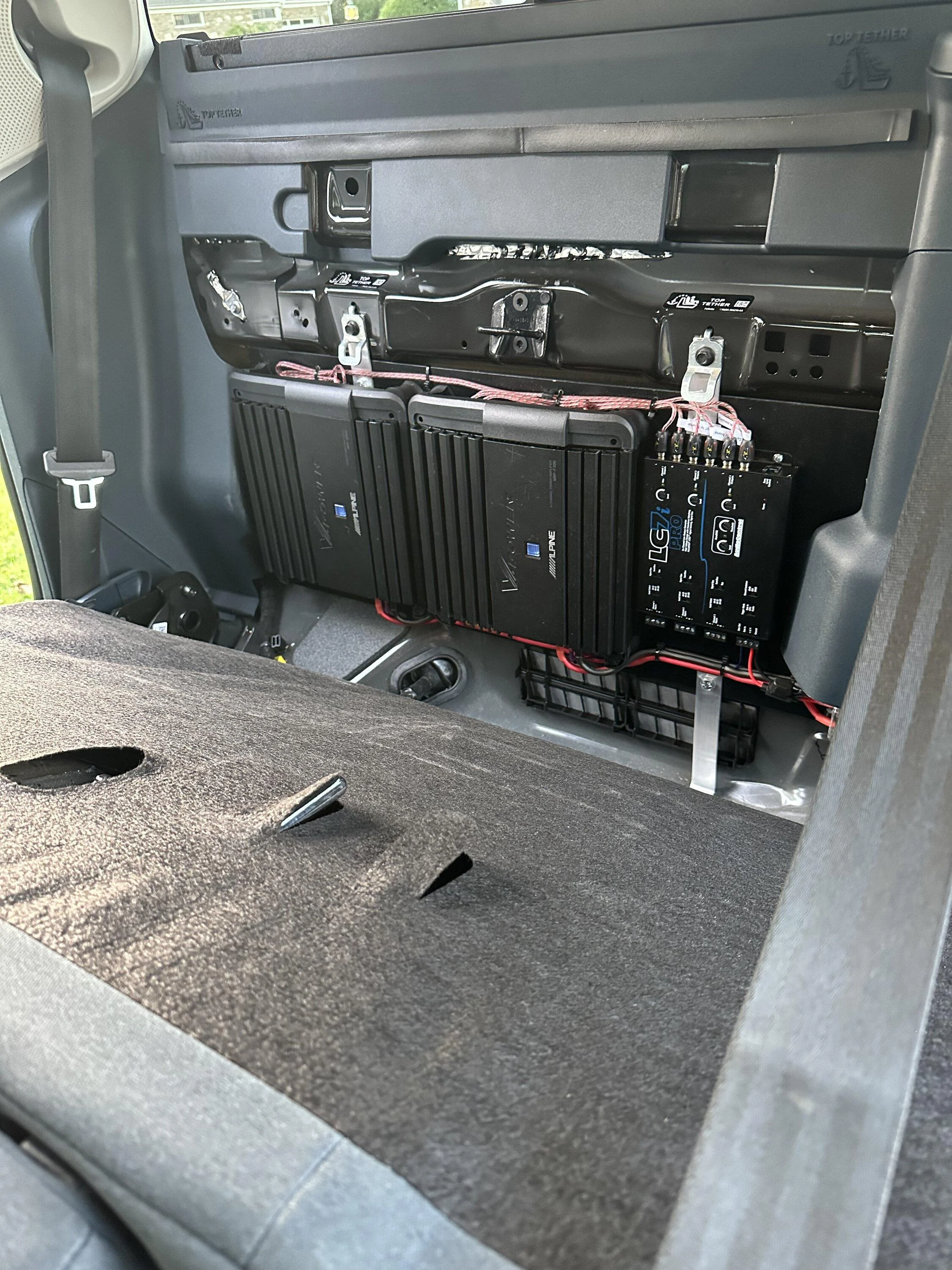

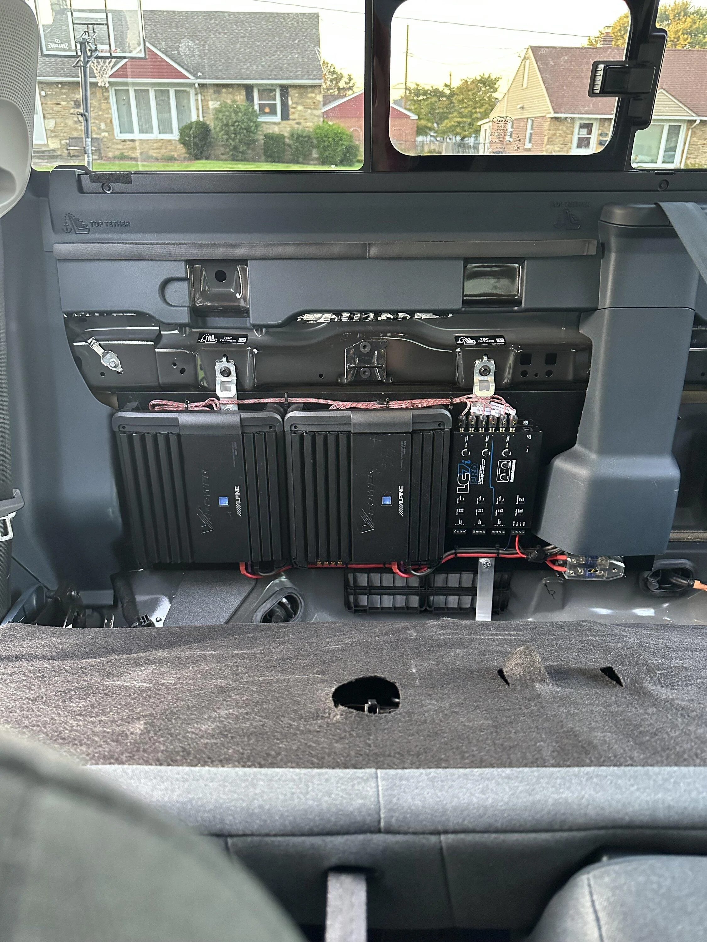

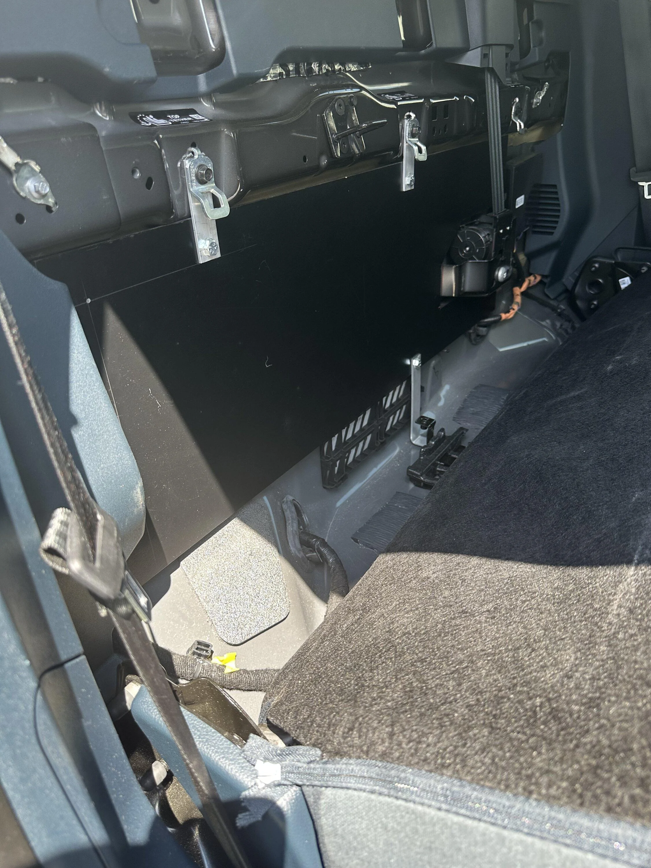

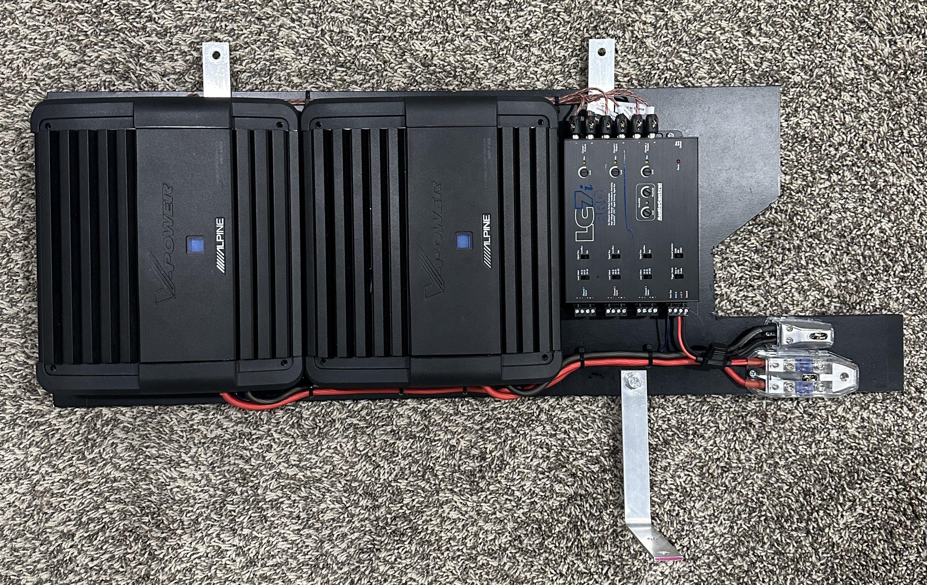

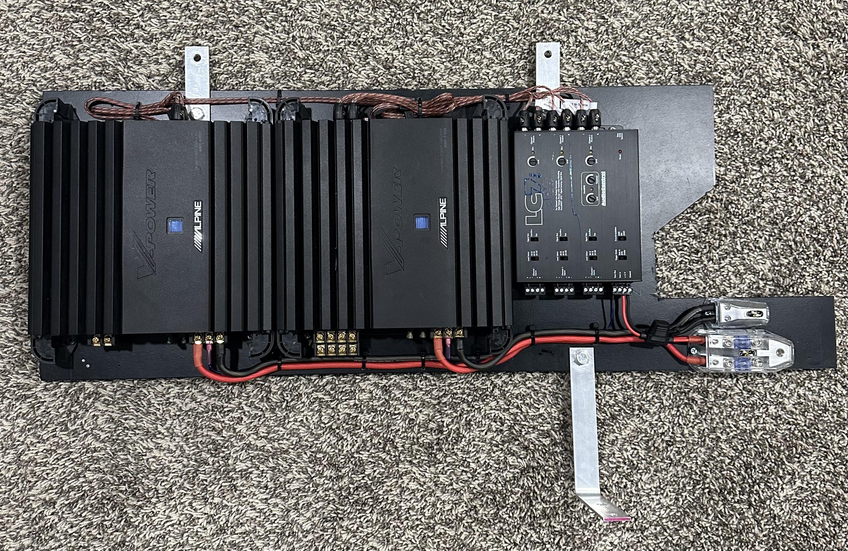

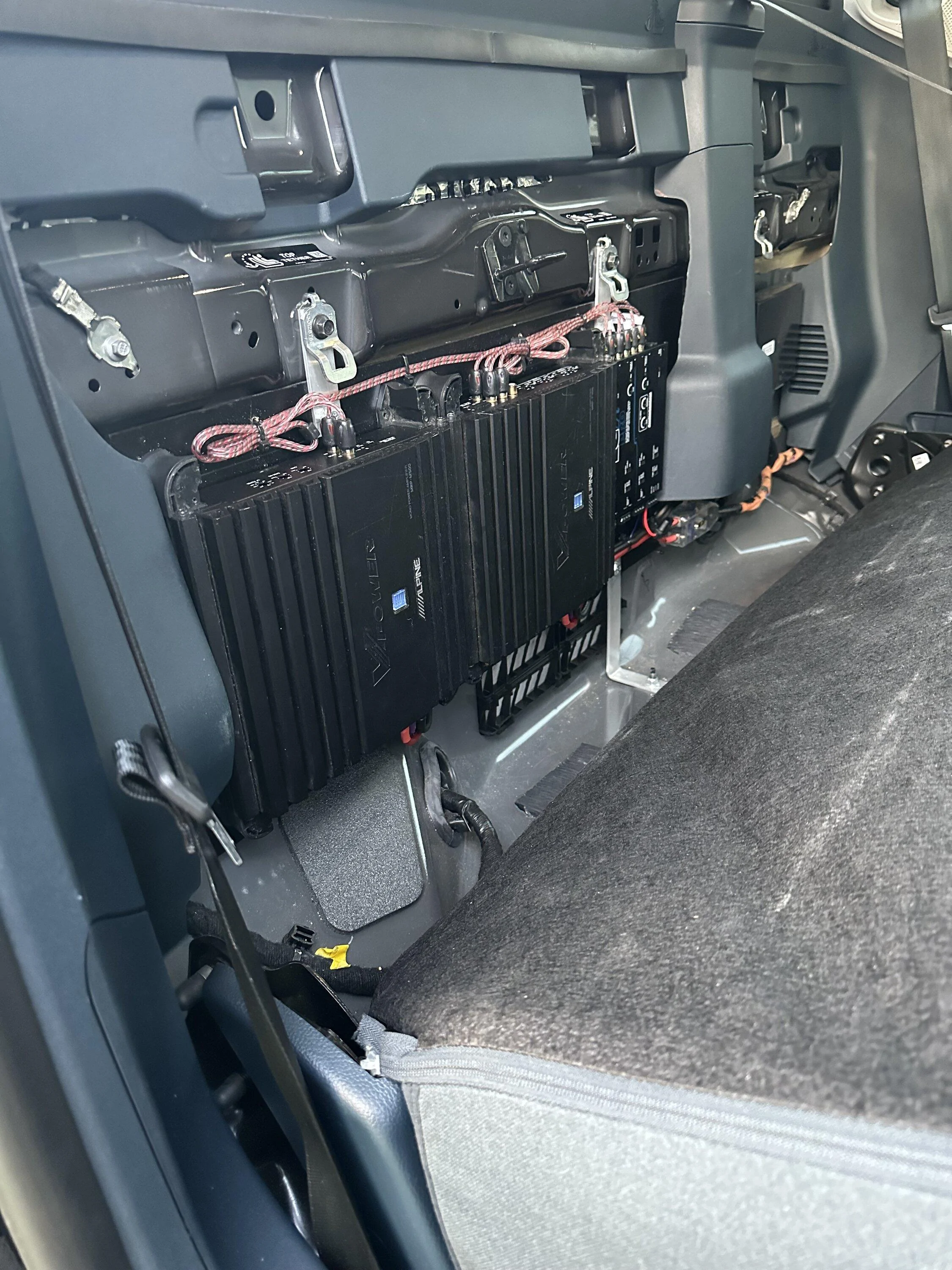

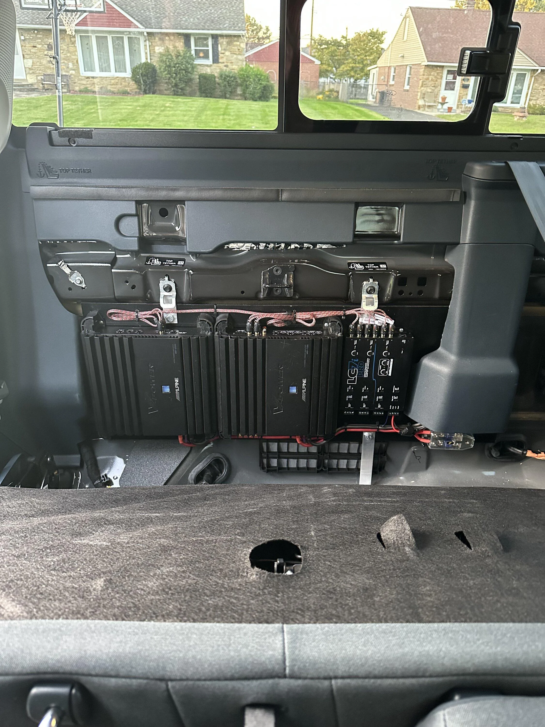

Slow process is better then no process I guess lol. Finally got around to getting the amp rack done. Might add one more brace to the left side and still have to sound deaden behind it but just wanted to mount it to see what it looked like. Next up is running the power, loopback harness and install speakers. Here’s some pics of the amp rack.

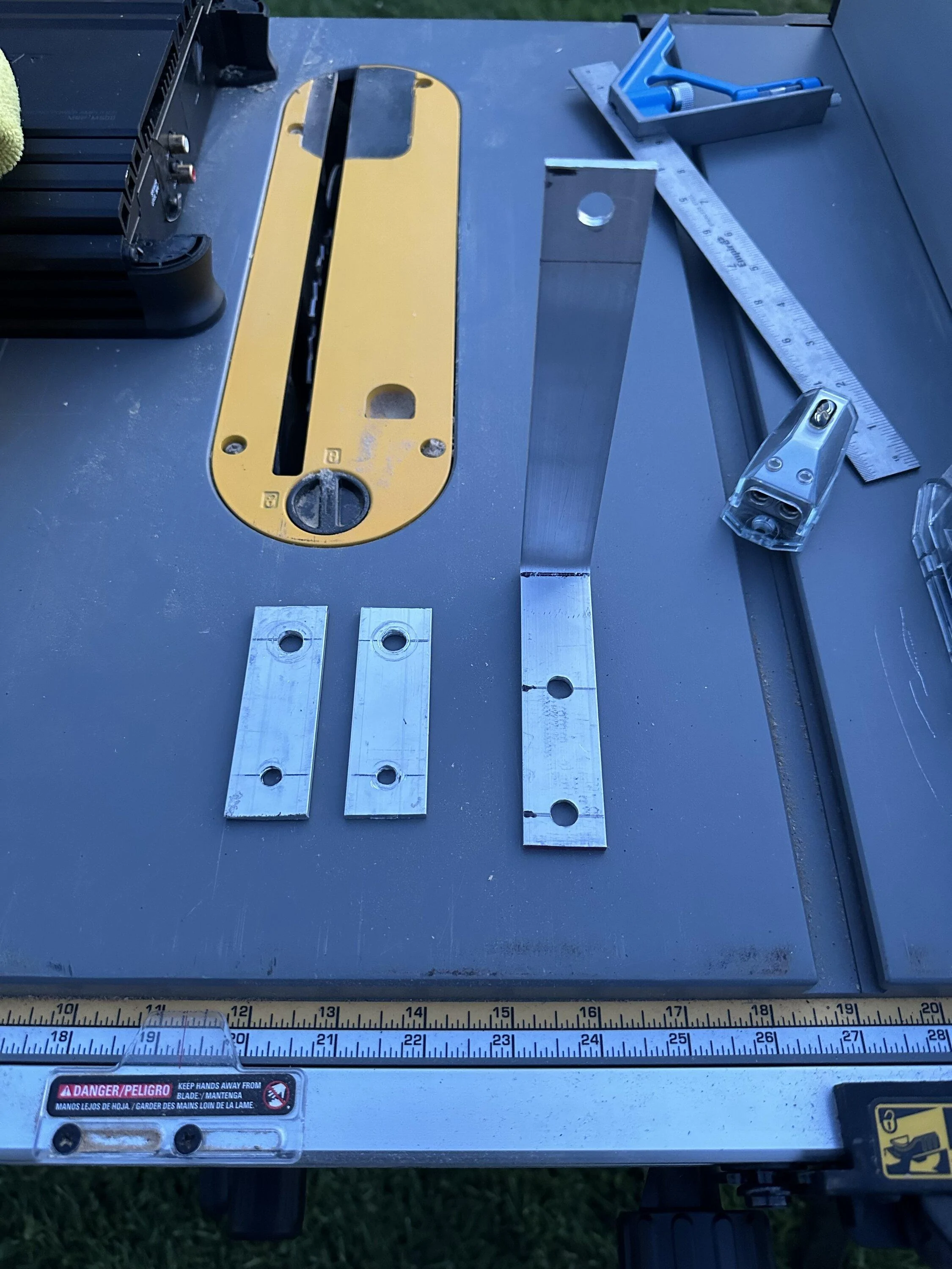

That's nice and tidy there. I like the way you made brackets to mount it using existing bolts.
That's a clean install. Beautiful job..

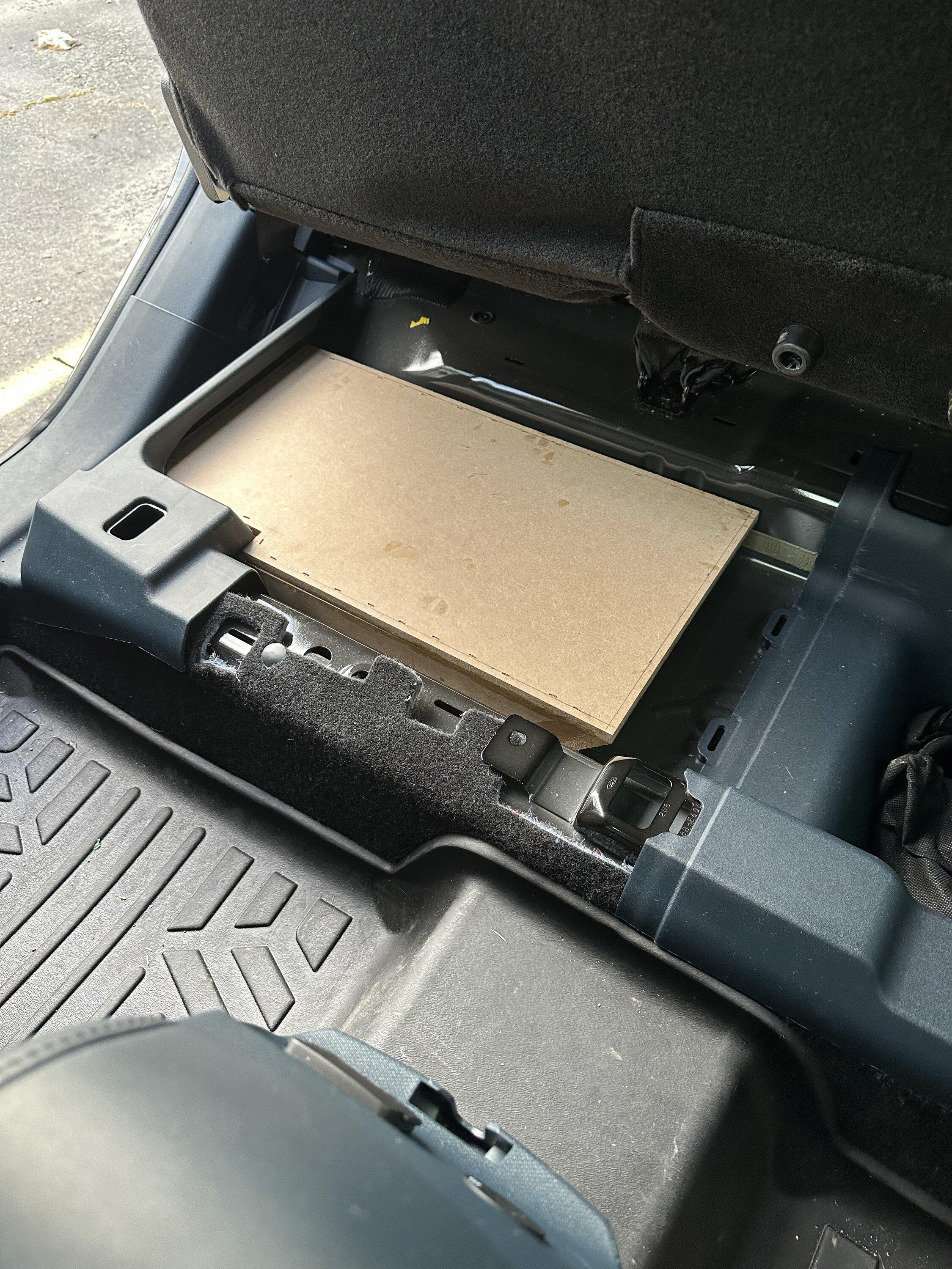

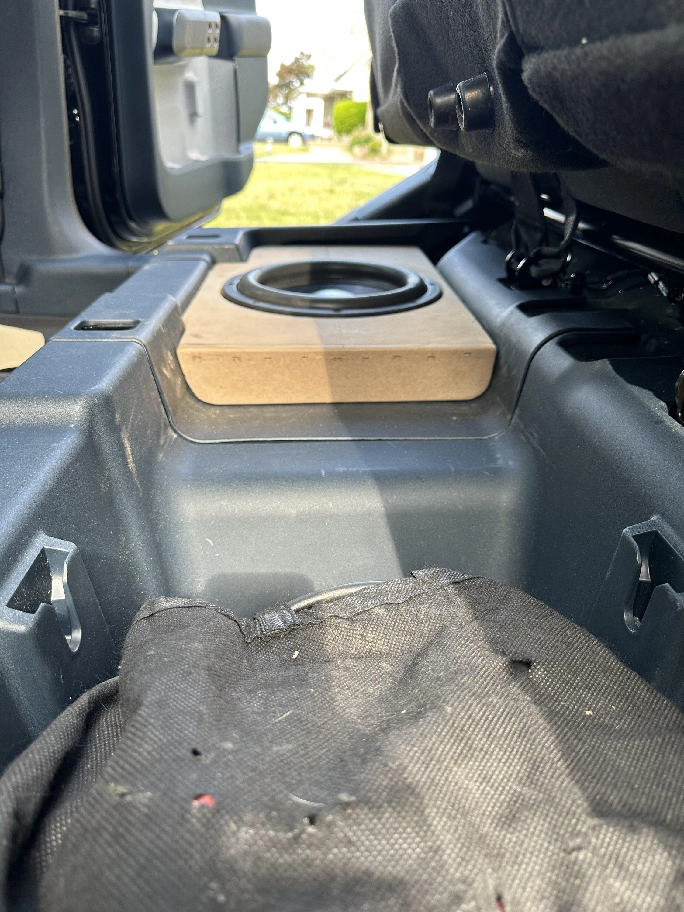

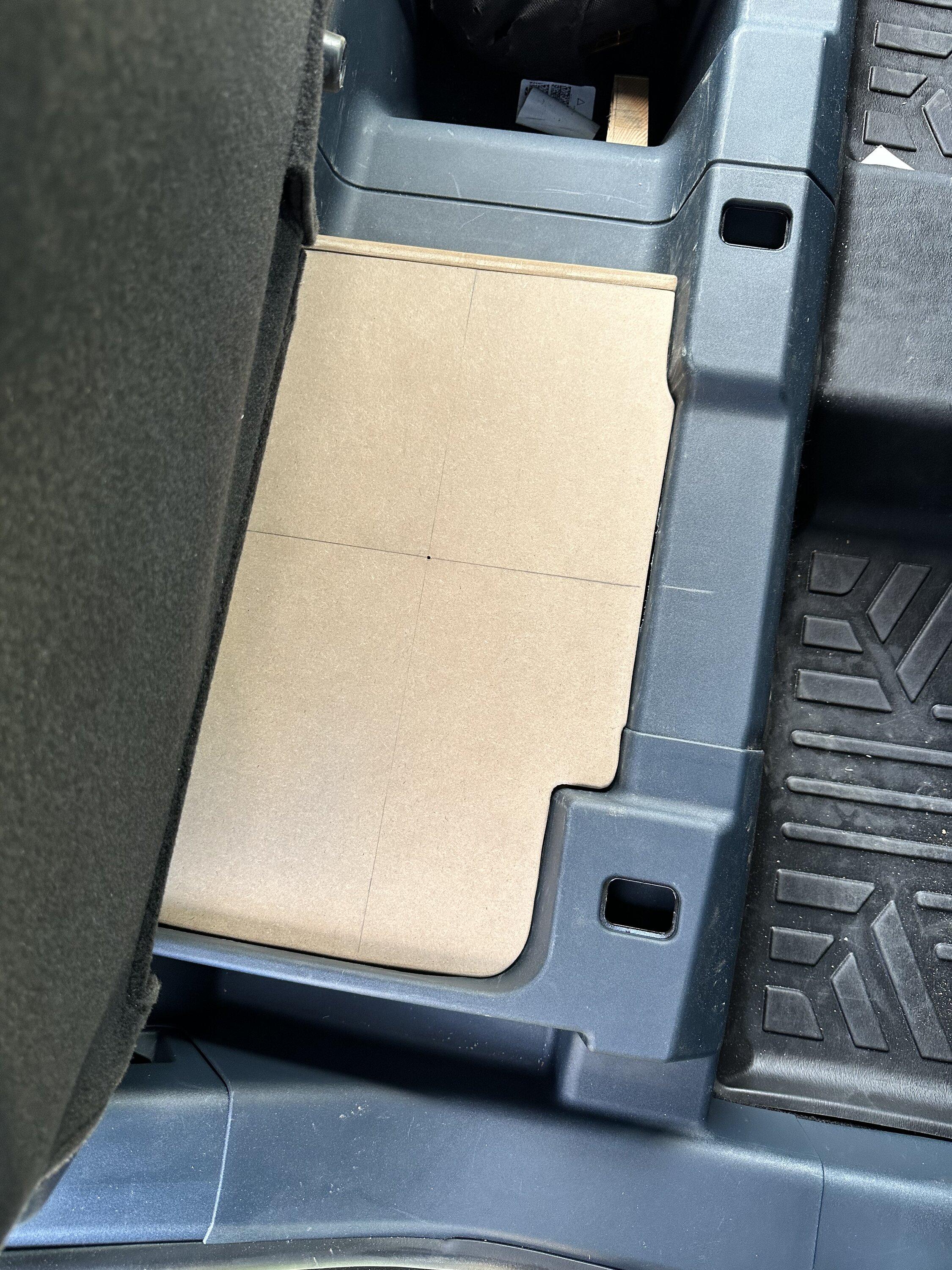

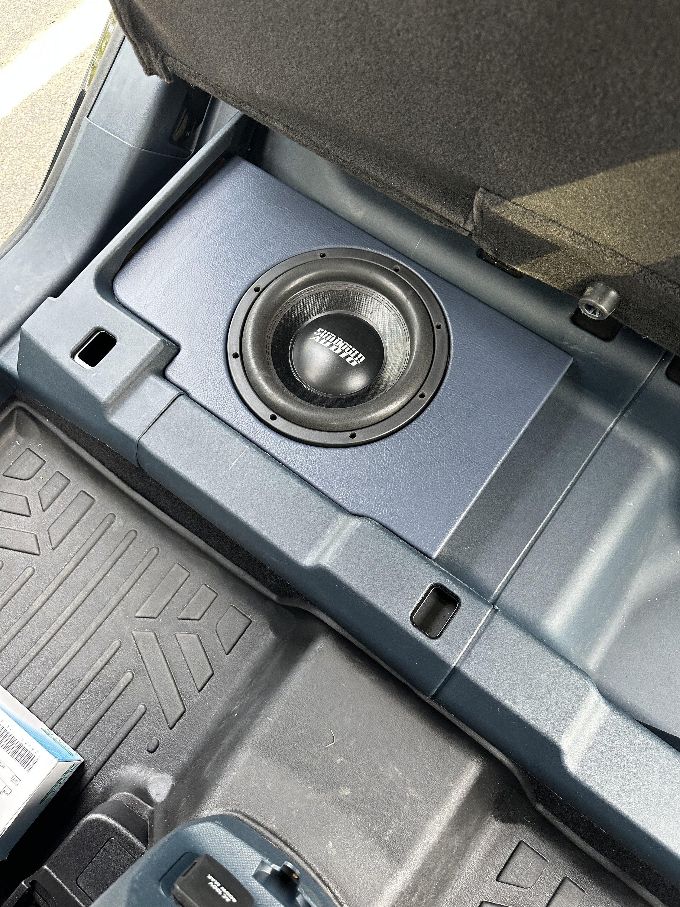

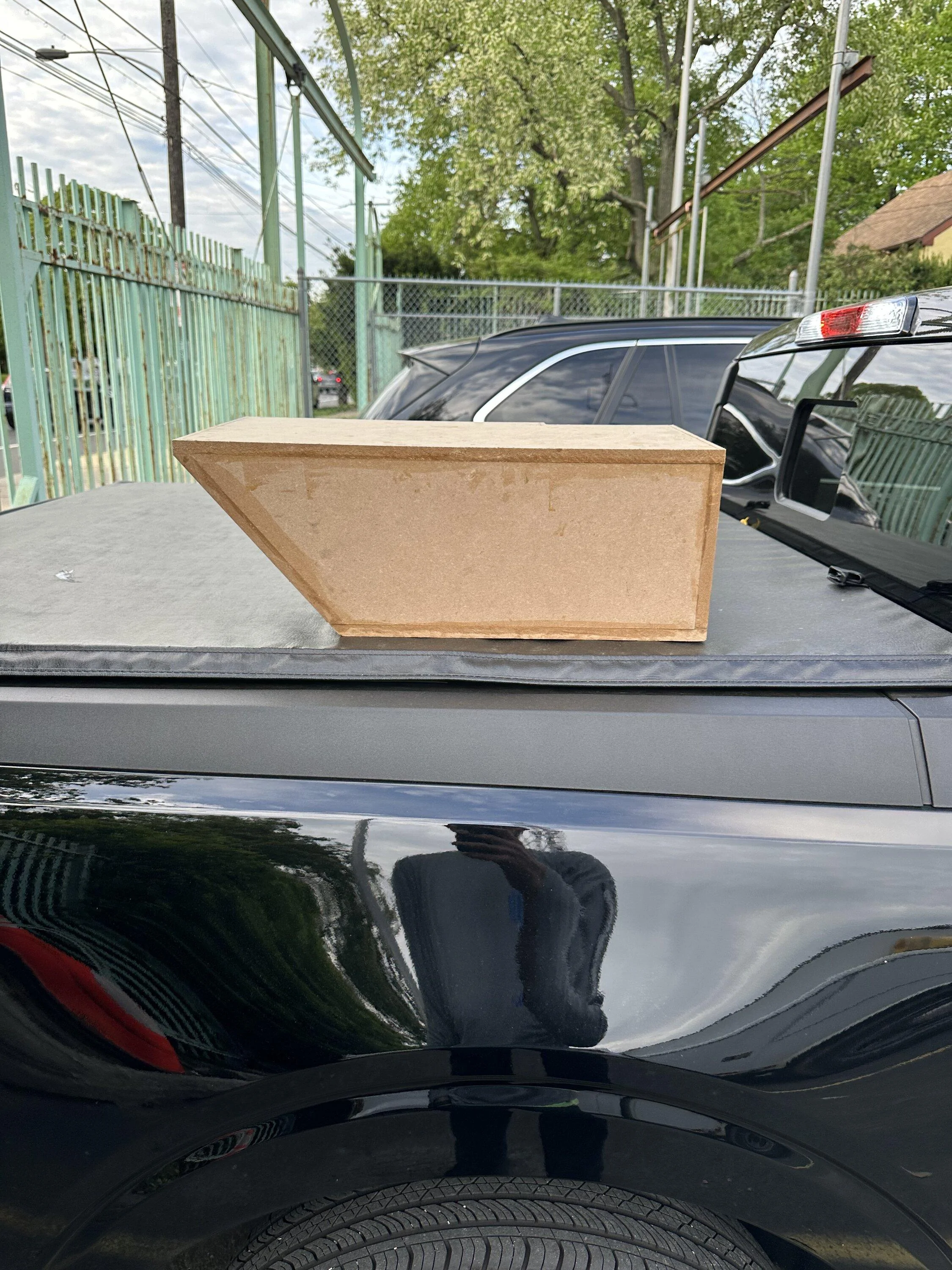

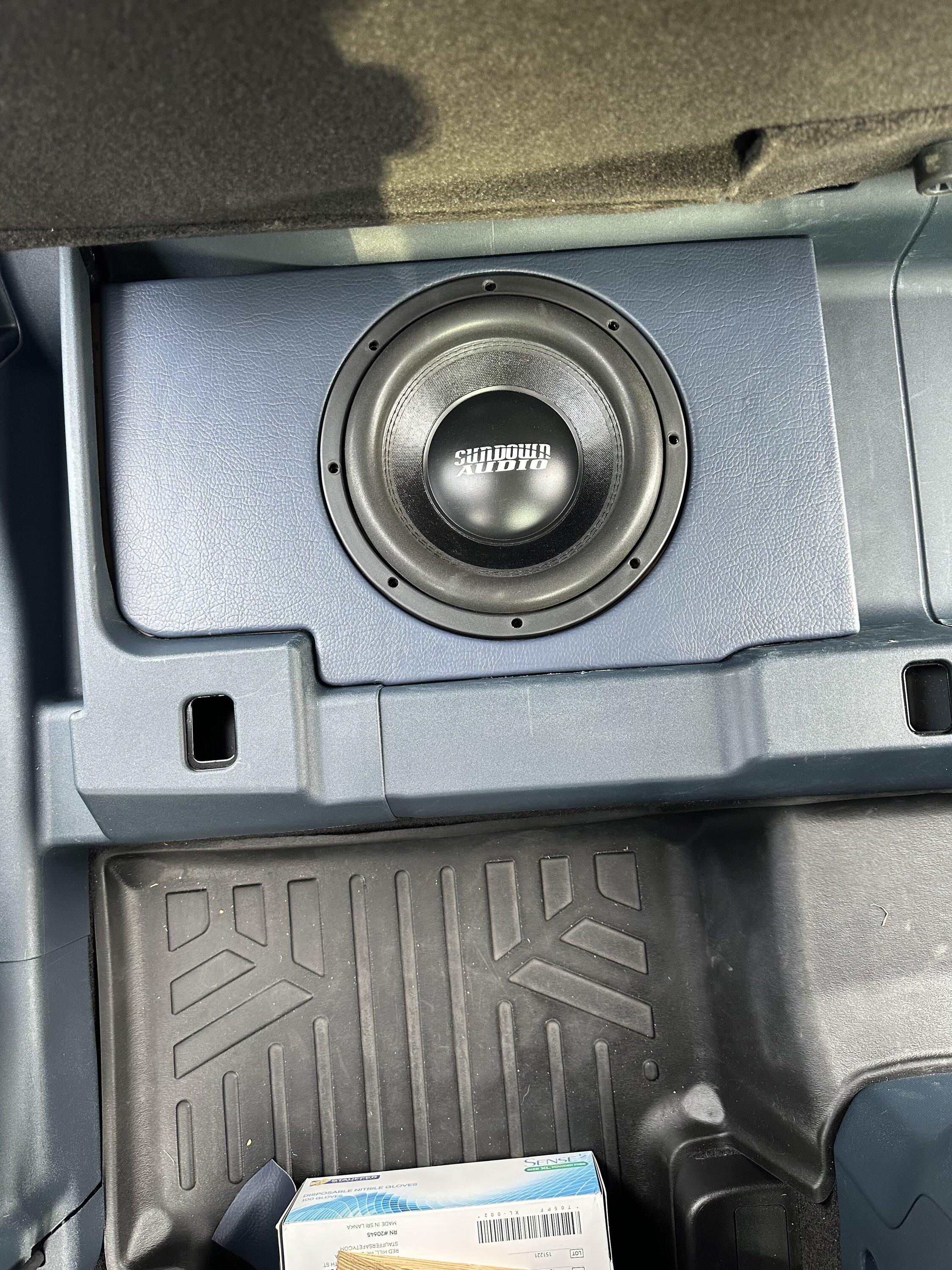

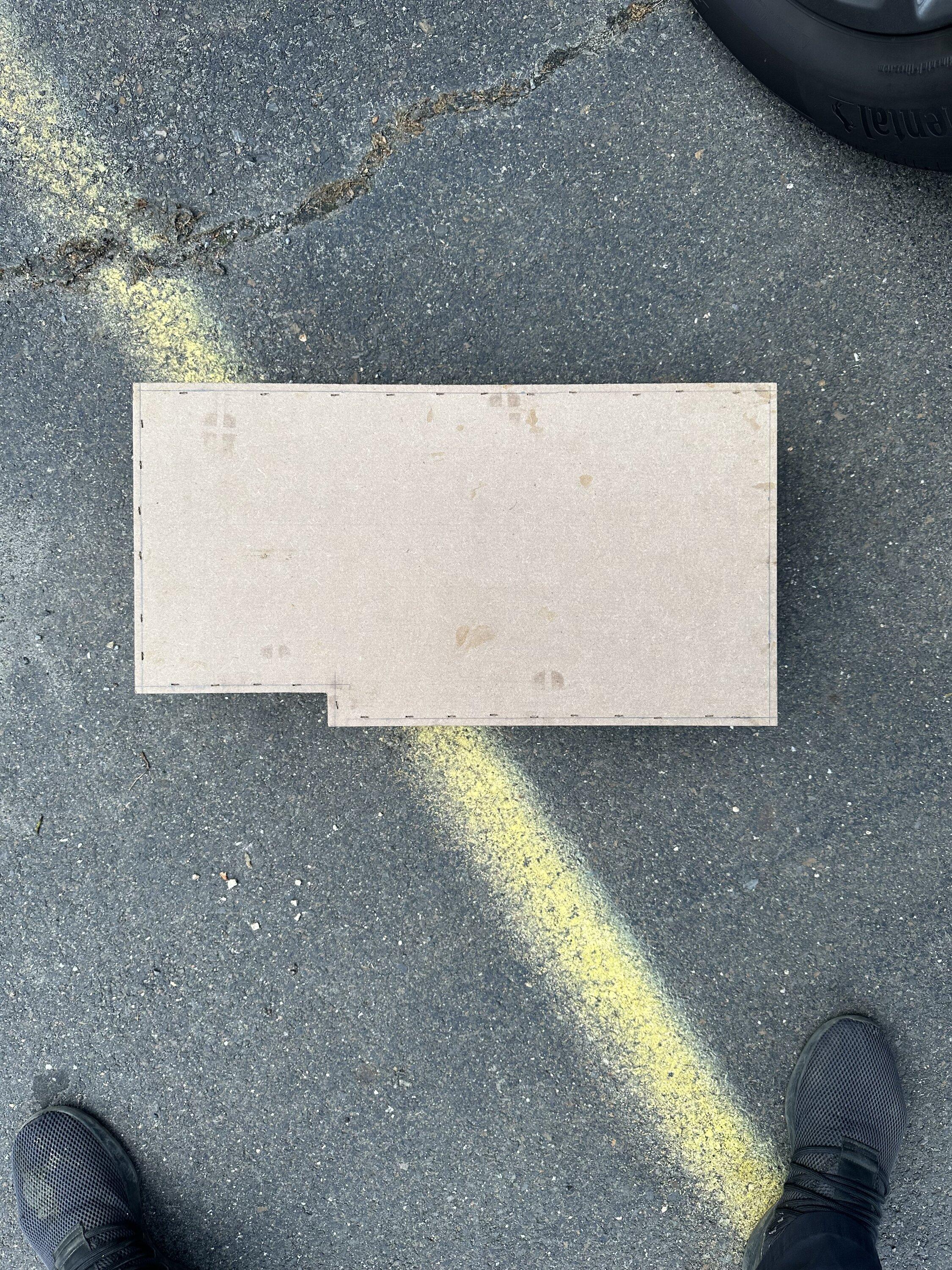

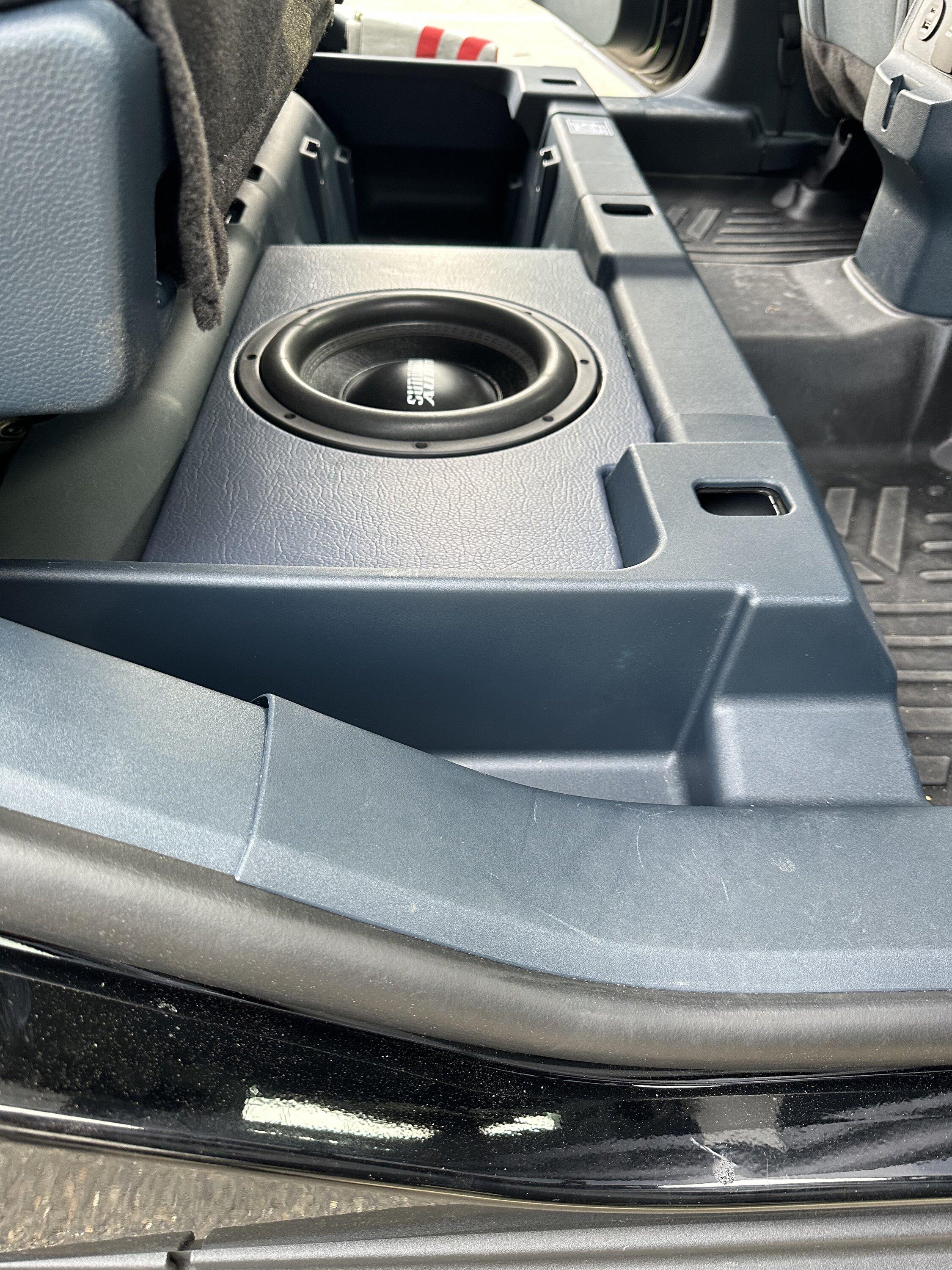

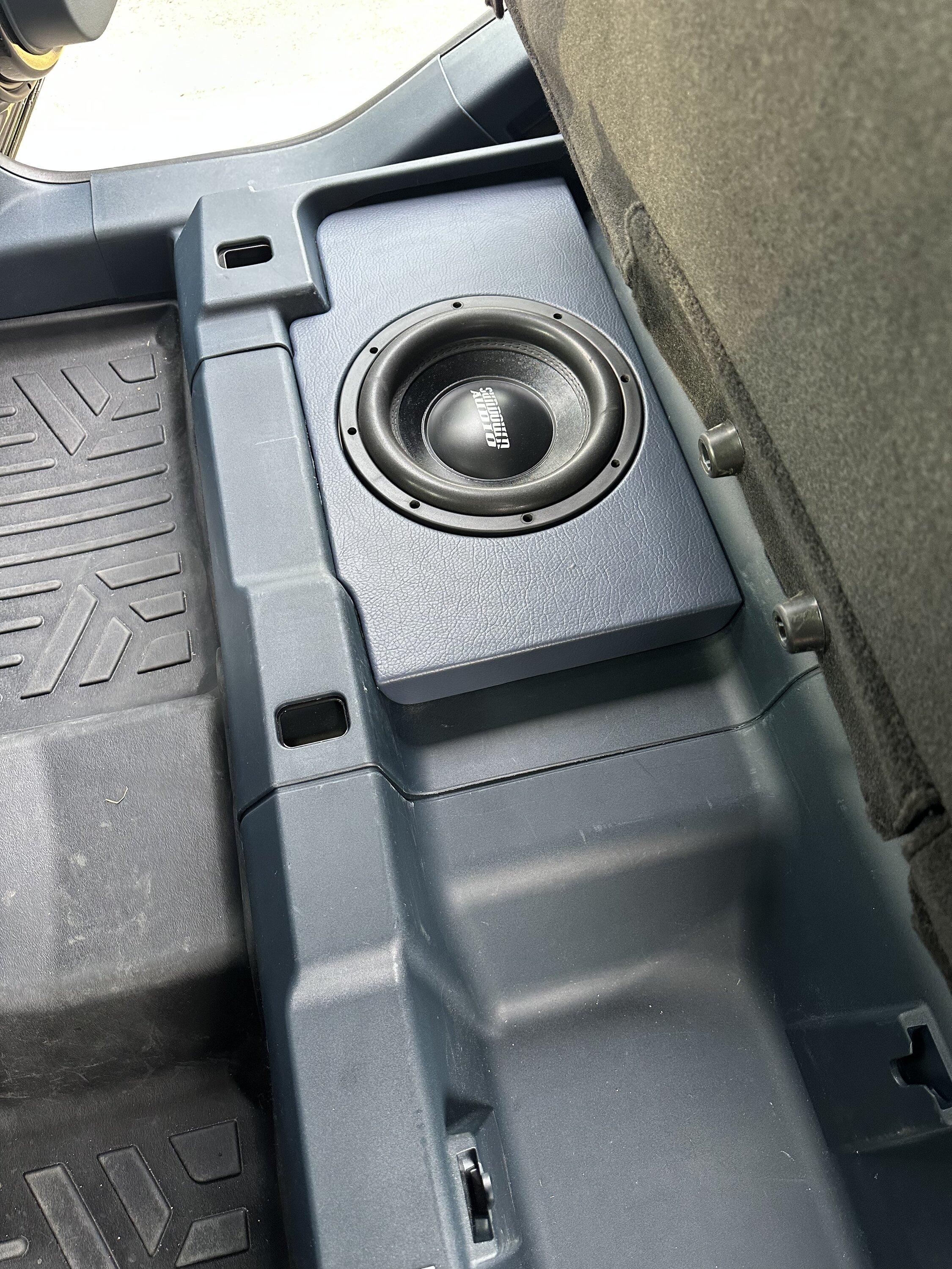

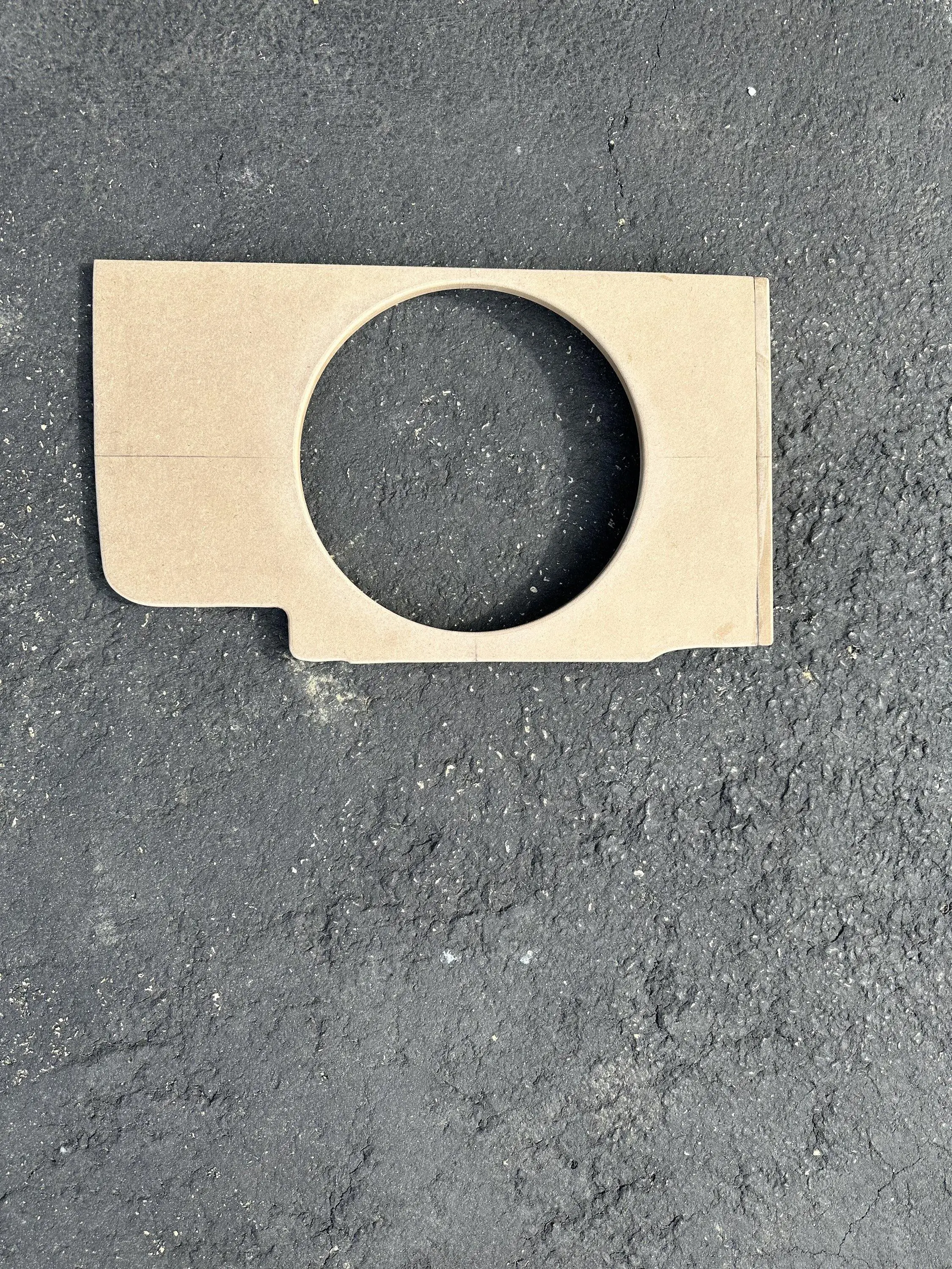

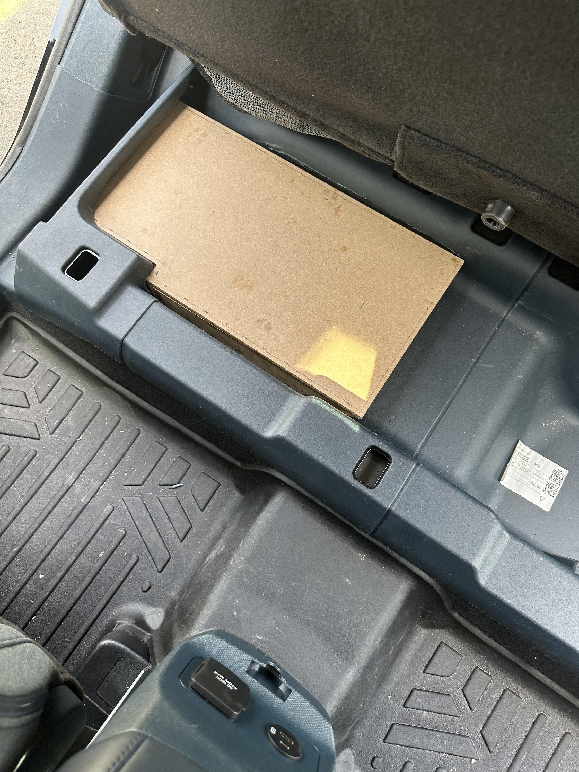

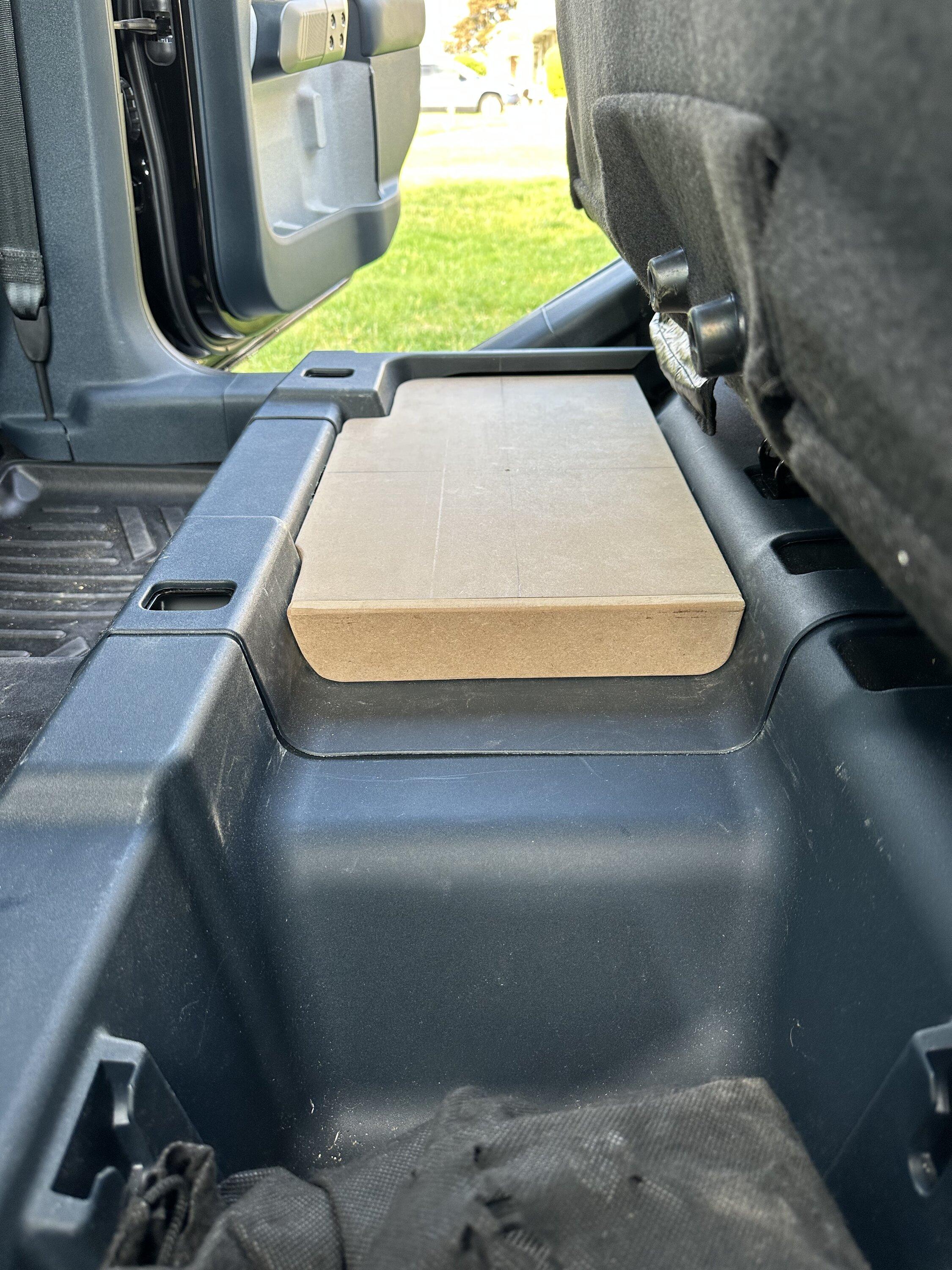

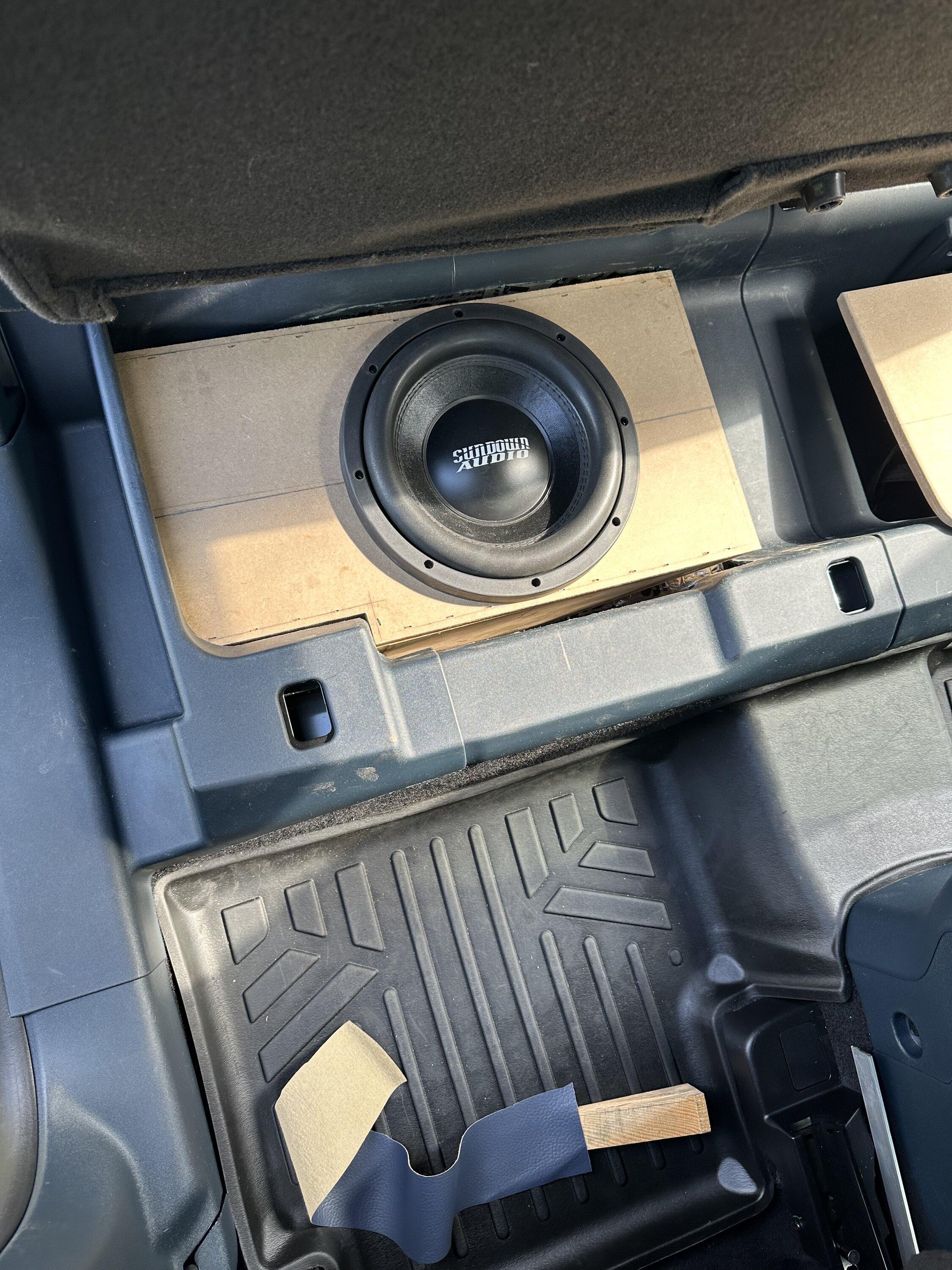

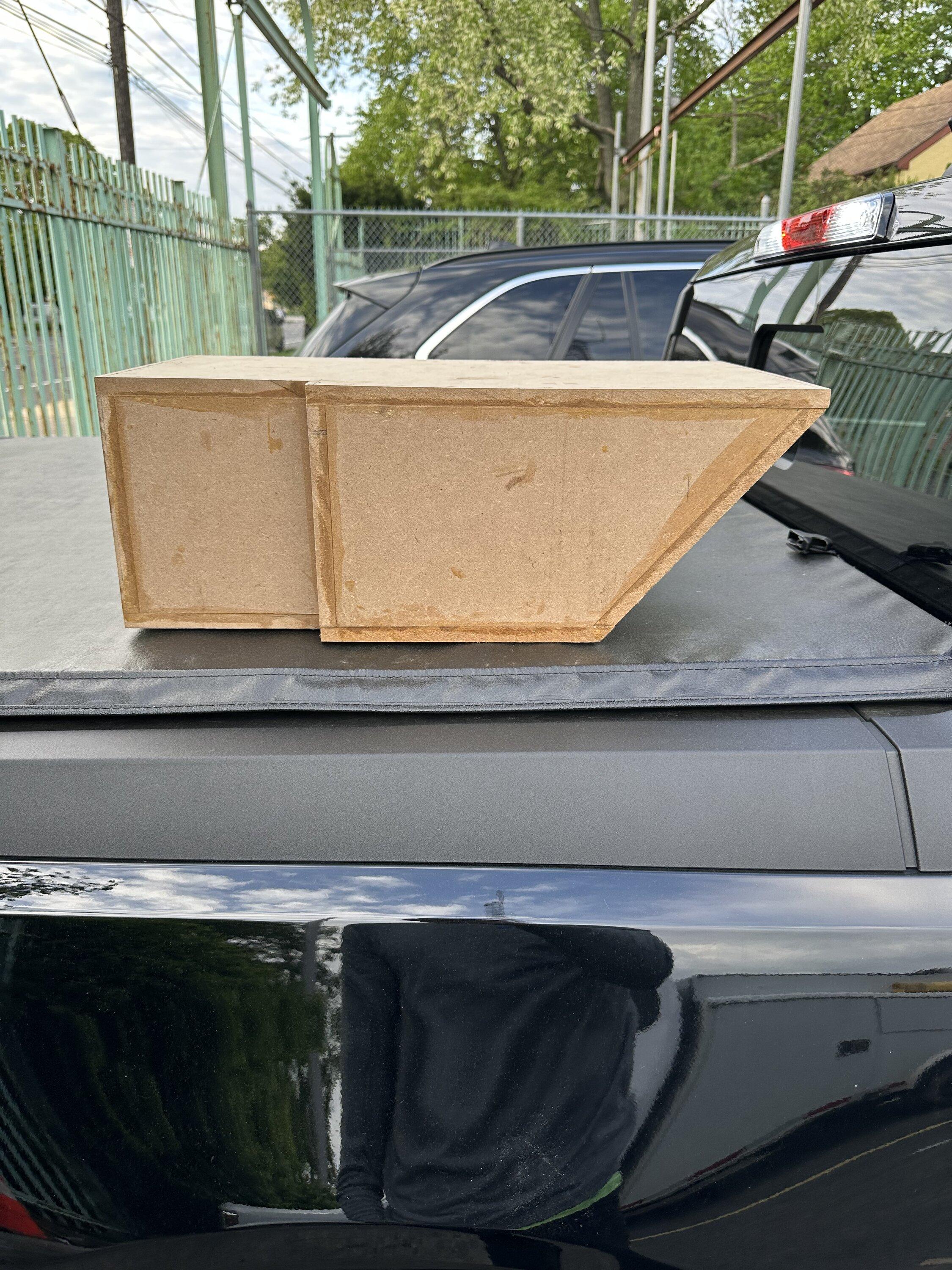

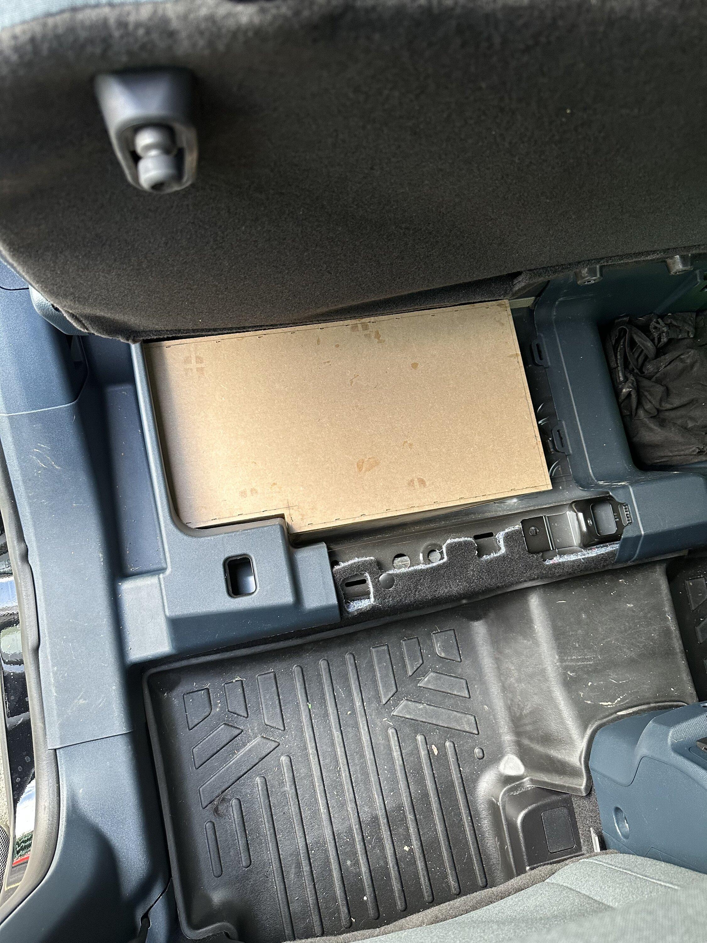

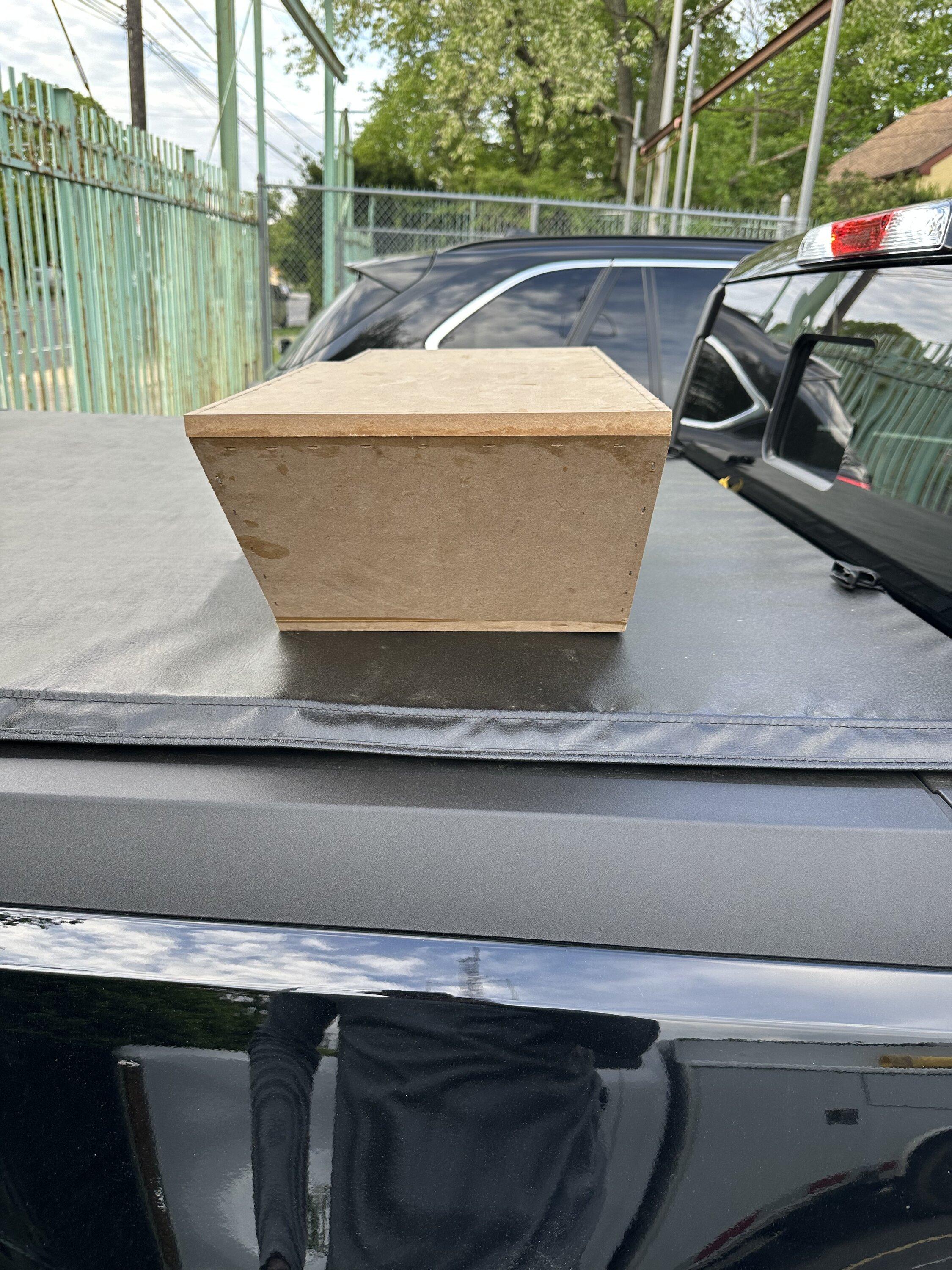

now for the box. This is my first box that I ever built. My 10” sundown called for .5 cu ft so in order to get the right volume I had to use 1/2” mdf.
had to cut out all the sides and the bottom of the plastic bin in Oder for the box to fit.

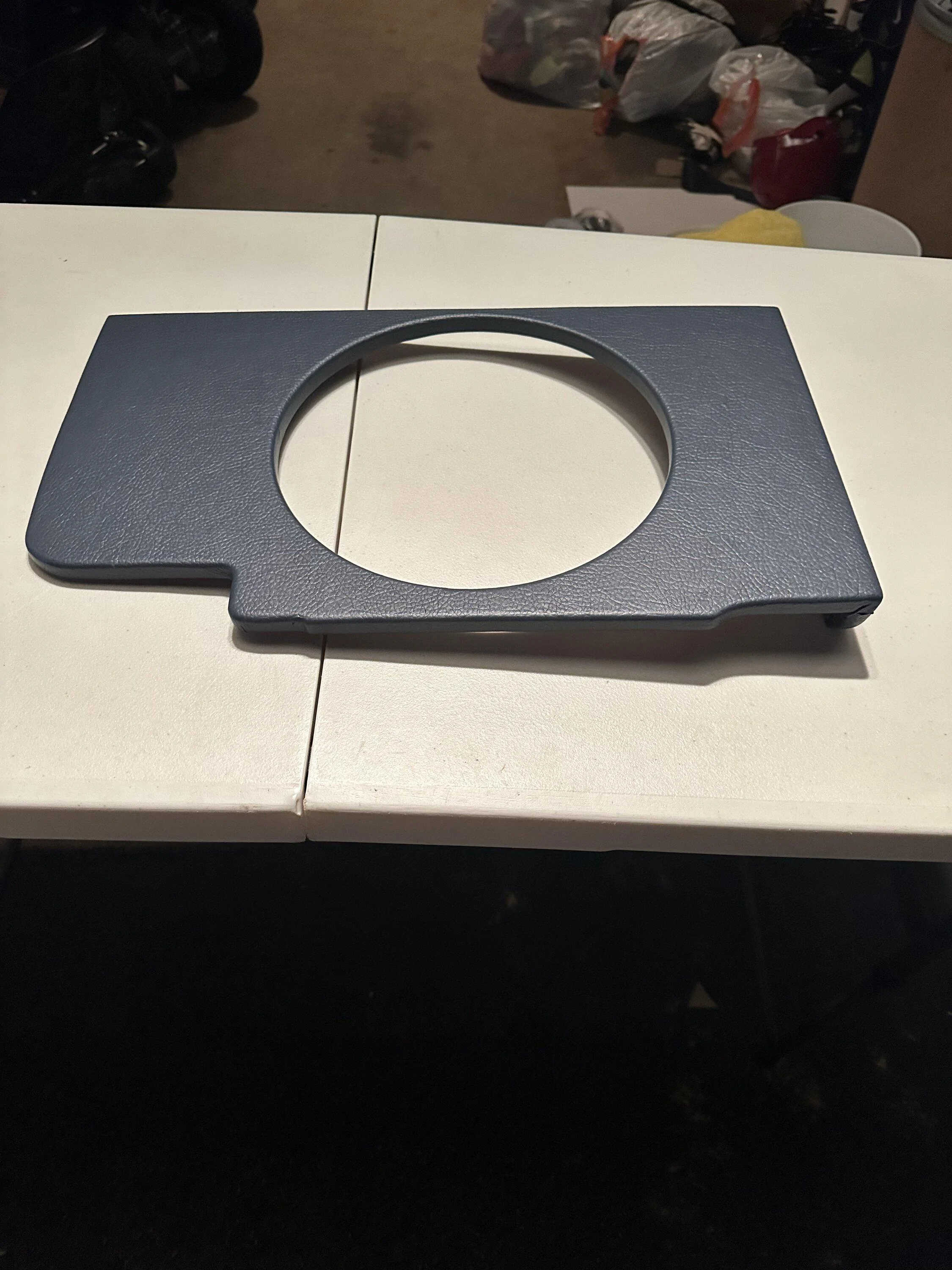

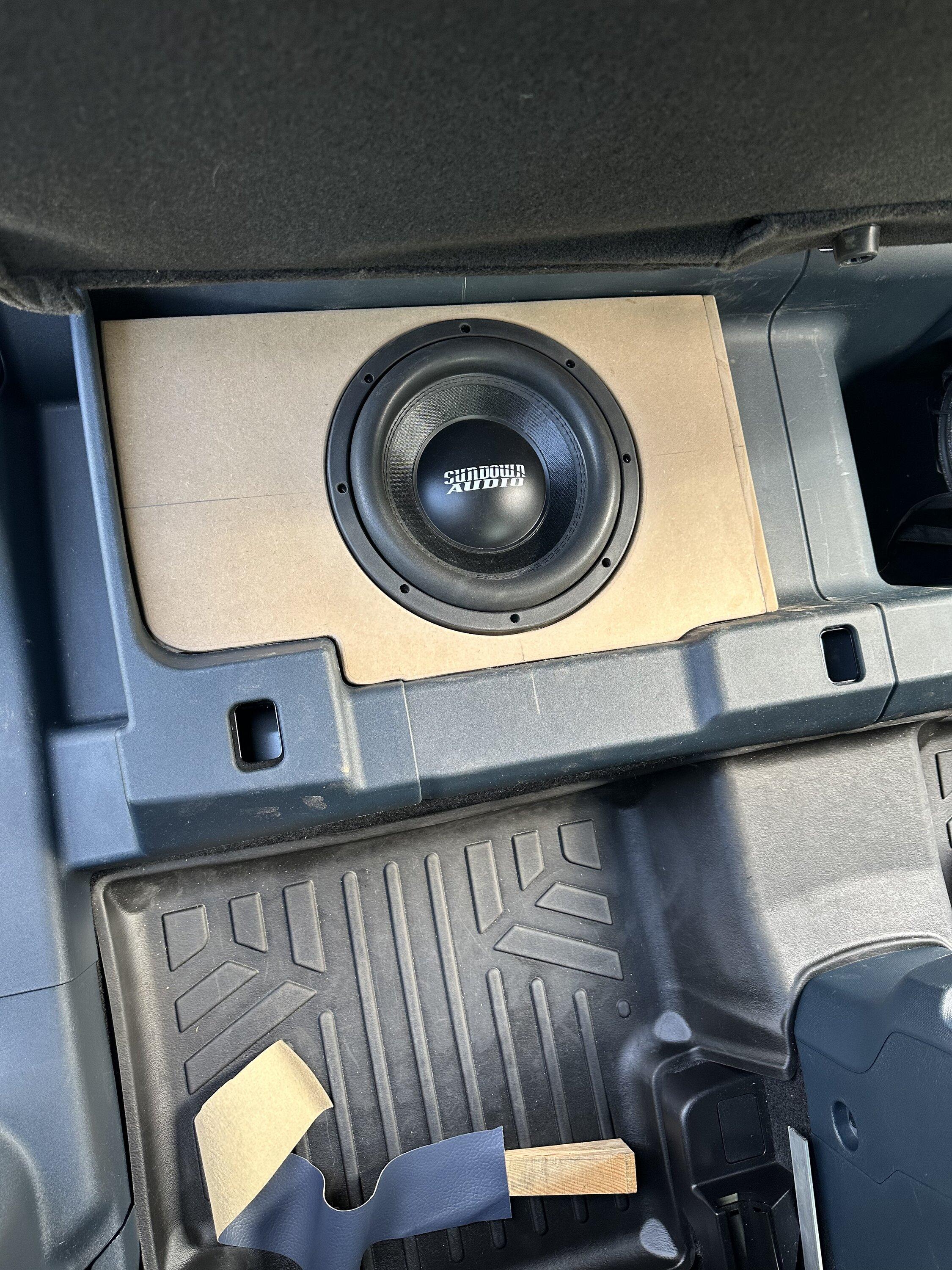

Now for the top trim piece to finish everything off. This is all 1/2” mdf

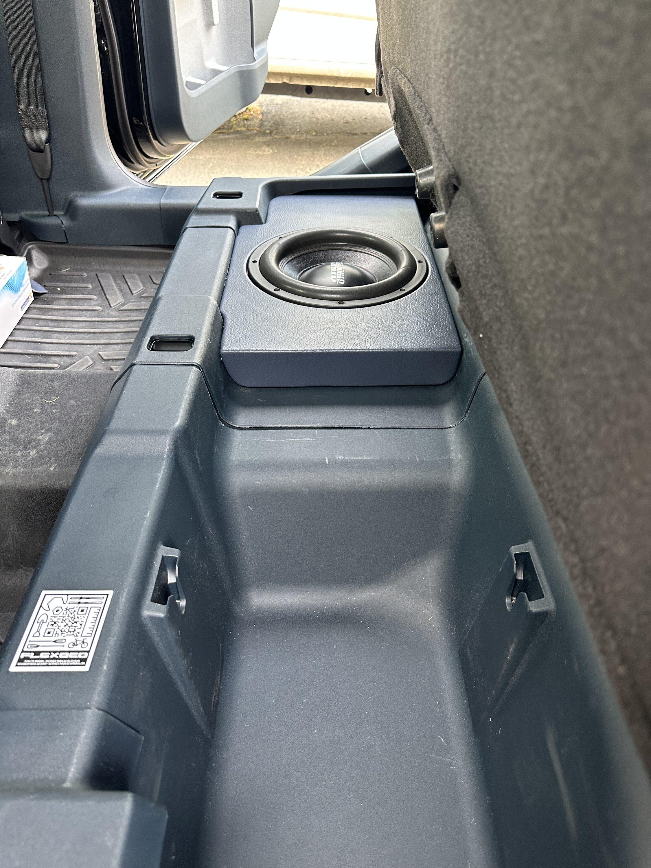

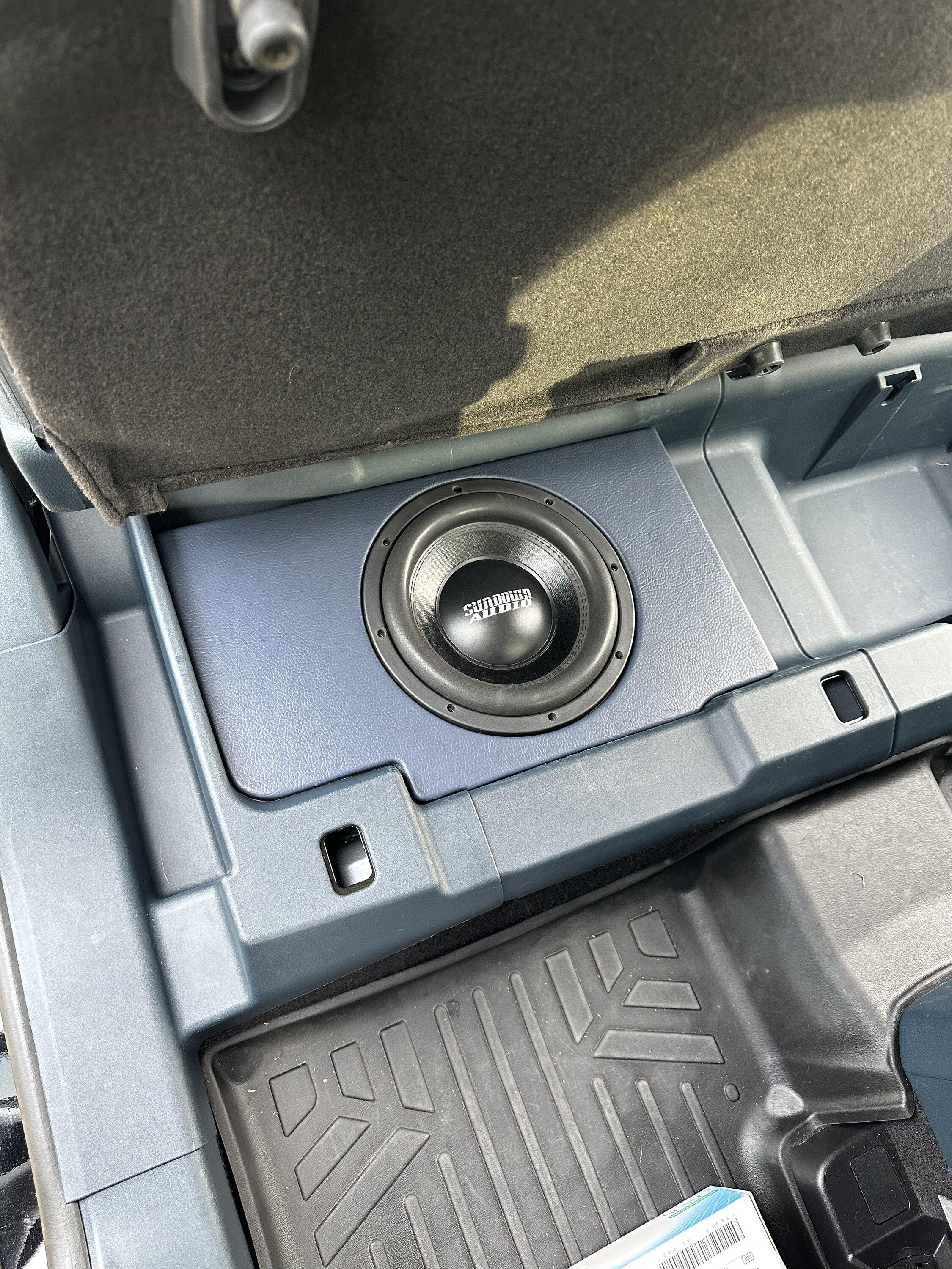

last the holes cut and cover piece covered in leather
Whoa, you are a master! Looks great. I wish i were that handy. Nice job, and i'm sure it sounds awesome!

Great build! Did you get this buttoned up? I have the same sub from a previous truck too. Is the box .5 cube empty, or did you take the volume the sub uses in consideration?
