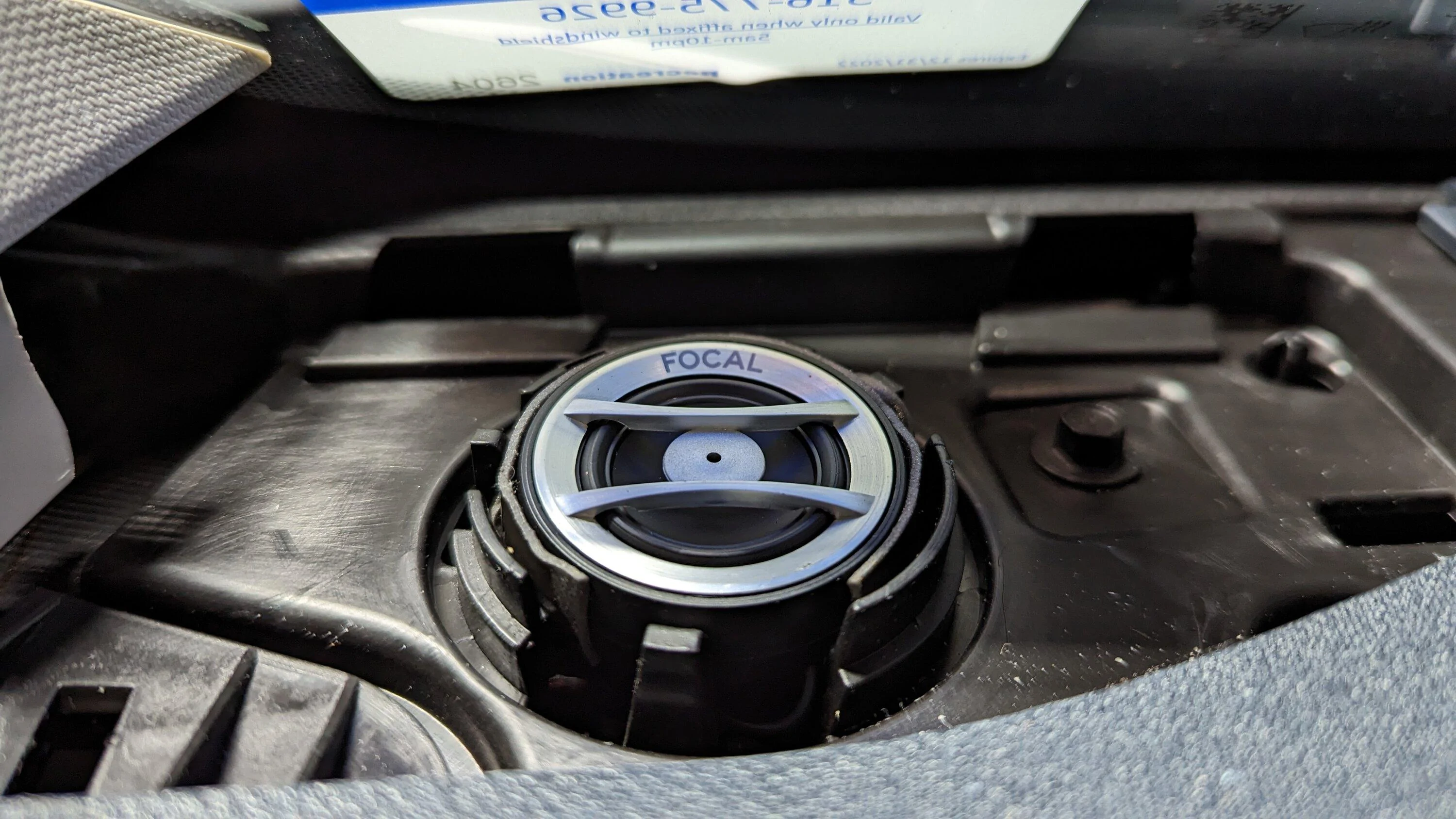

The dash tweeter locations are not bad at all, I would start with that and I have a strong feeling you'll be satisfied with it. Definitely bi-amp and fade the rear all the way gone or very low, leaving them on the head unit.

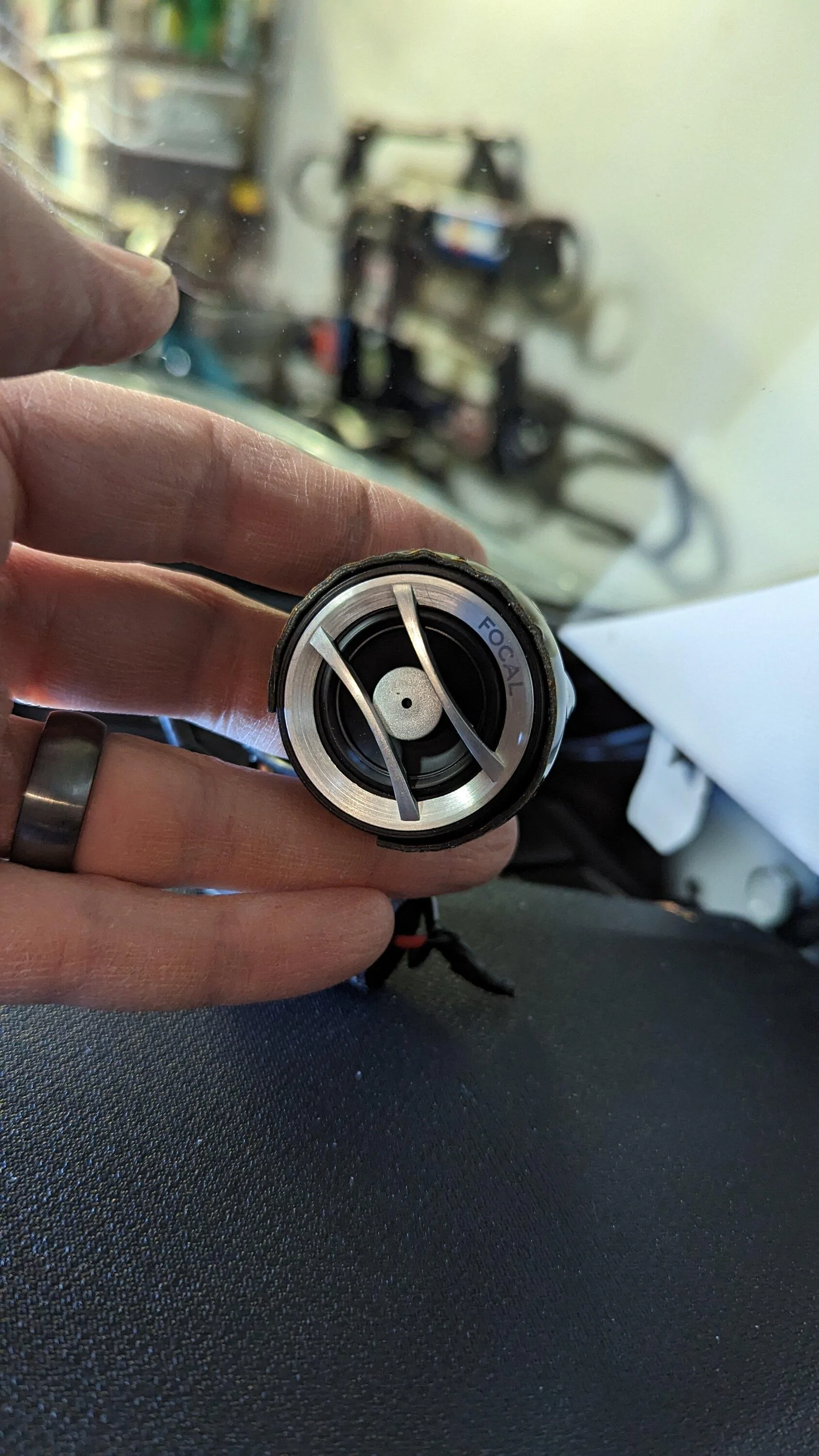

I just looked at the C2-C650 and I would use the flush mount housing for the tweeters and then cut the factory tweeter mount with a heated knife or dremel (flex head will be super useful). Make the opening a little bit larger than the tweeter and then put double-sided tape on it to secure in place. Here's that process on my Focal tweeters, except I was lucky that they fit loosely without any cutting.

That is the tweeter from an rse-165 component set. I'm very happy with them. I listened to all the Focal on a local dealer's demo board and I like these better than the flax Evo. The flax tweeter produces crisp cymbals but it is a little bright for me. And I loved the kx2 but I don't have the amp or the desire to spend that much. 😆

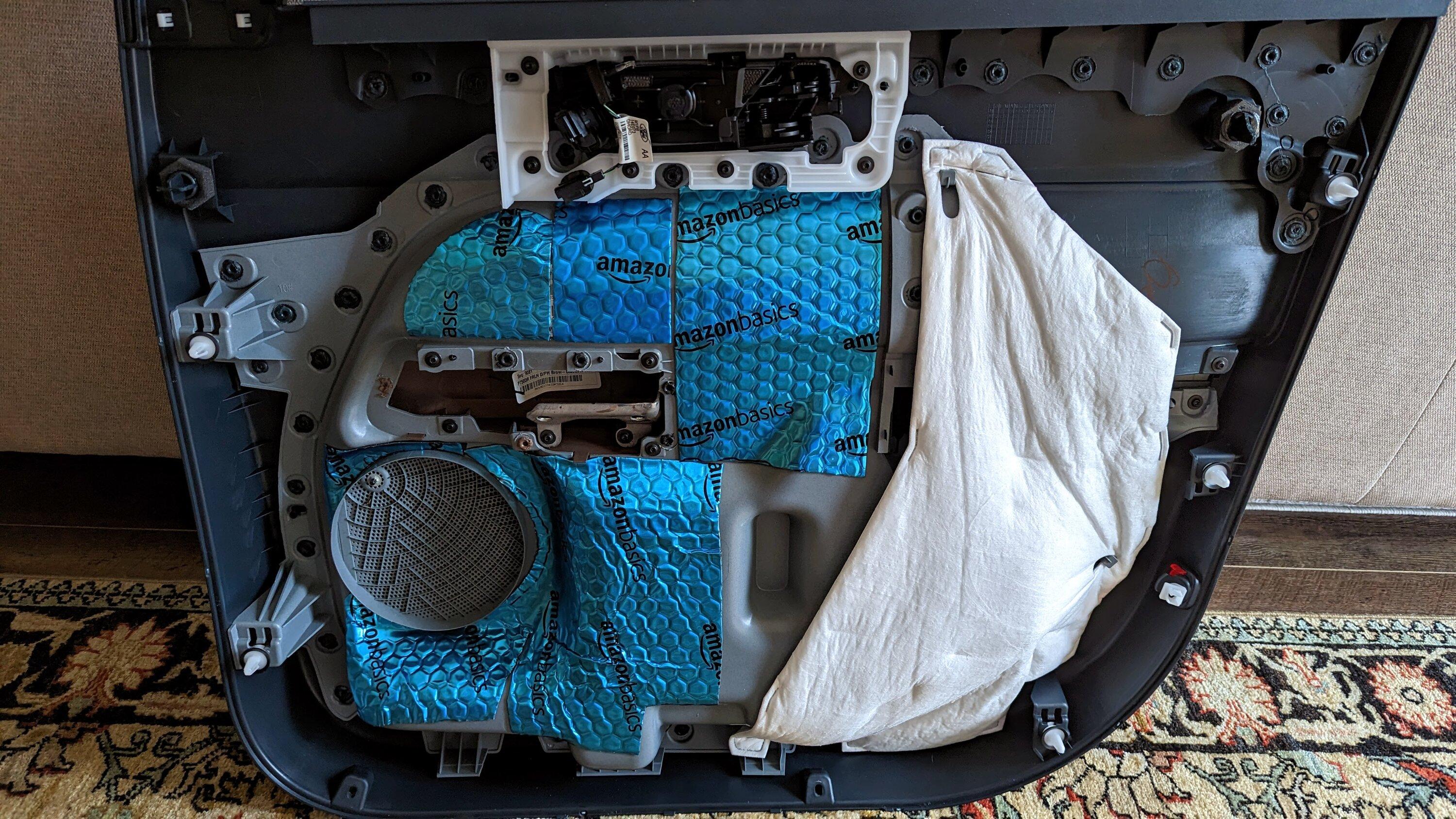

No tricks with the door speakers. Yes, I used Amazon basics deadener. I think the package I got was 8x14 sheets or something and it's enough to do both doors, anything I needed in the back and still have several sheets leftover.
If you have this factory cloth noise damper, I recommend pulling it aside and applying deadening behind it. I didn't and wish I had.
