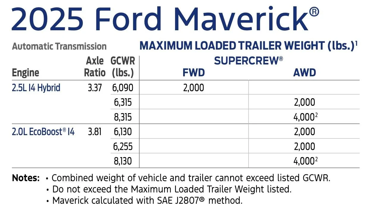

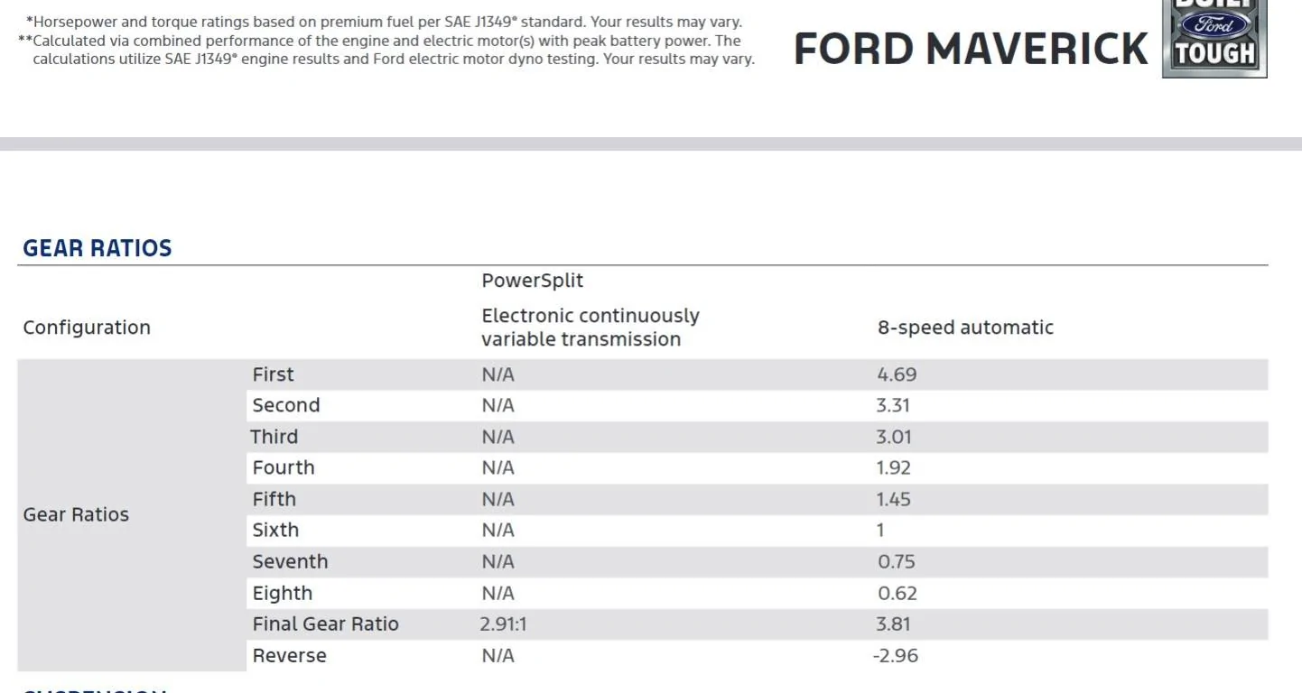

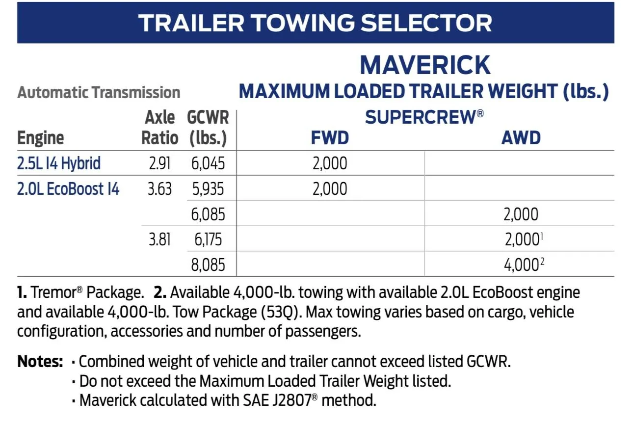

Interesting, but the 2025 different gear ratio when equipped with the 4K Tow Package is also applied to the Hybrid AWD? Where can I find the info?
The 2025 4k towing equipped models do not have a different gear ratio than the base model vehicles. The alternate, lower, gear ratio that came with the 4k towing package only applies to 2022-2024 ecoboost models. The place you can find the info is in the ford maverick towing guide.
2024:
Ford Maverick With or without the 4K package ??? IMG_2066
2025:
Ford Maverick With or without the 4K package ??? IMG_2067
Notice that the 2025 base model ecoboost final drive ratio is 4.96% lower than the 2024, while the 2025 hybrid final drive ratio is 15.8% lower than the 2024 model. That is great news. The lower hybrid ratios should really help it off-road or when towing.

2025 XL Hybrid, AWD, 4K
Looks like Ford disagrees with themselves lol

I don’t have any way to prove it, but I’m believing the maverick towing guide pdf over the maverick technical specifications pdf.
it just makes the most sense that if they’re going to have a 4k towing rated hybrid that they would give it a lower final drive ratio.
