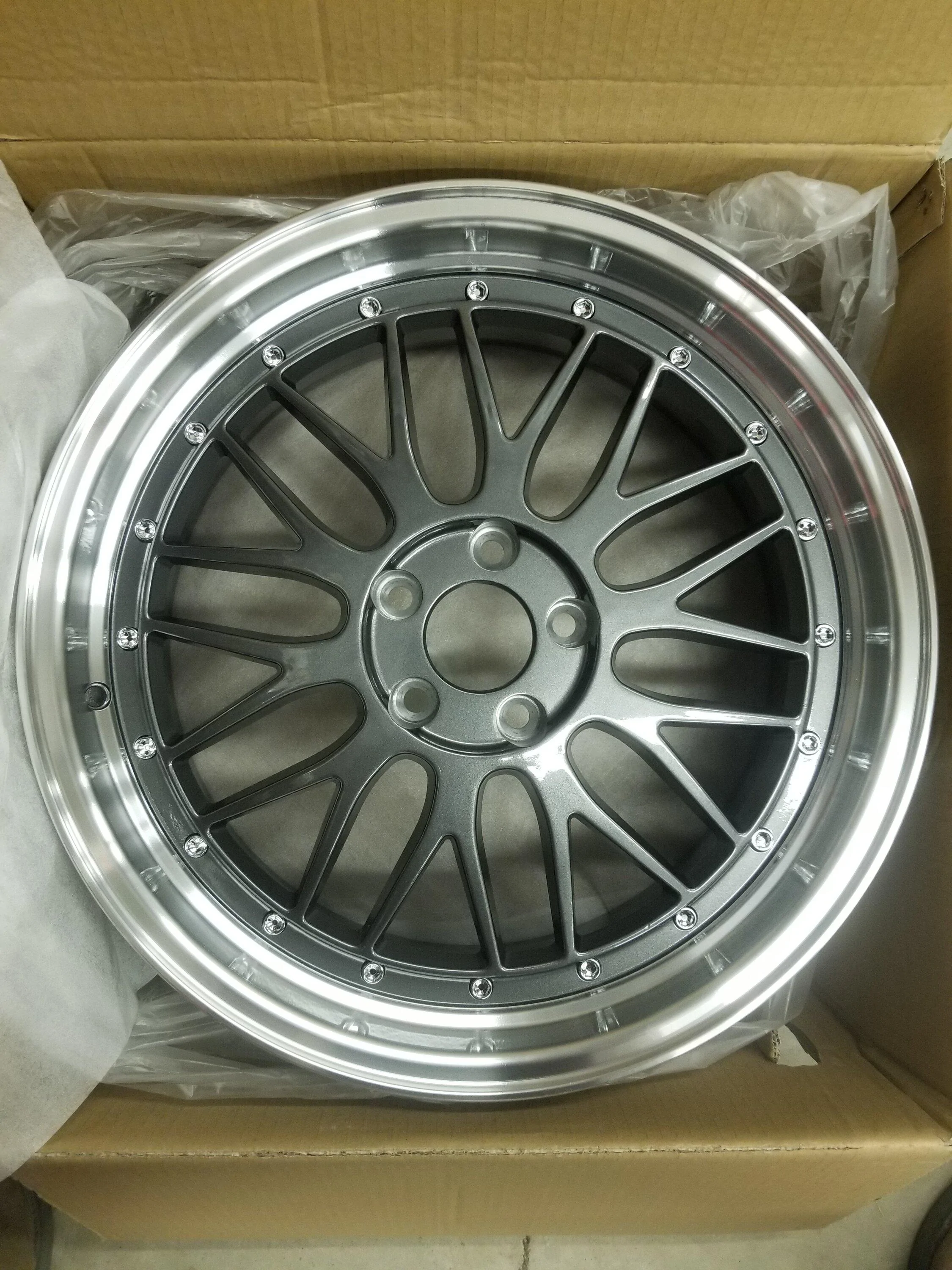

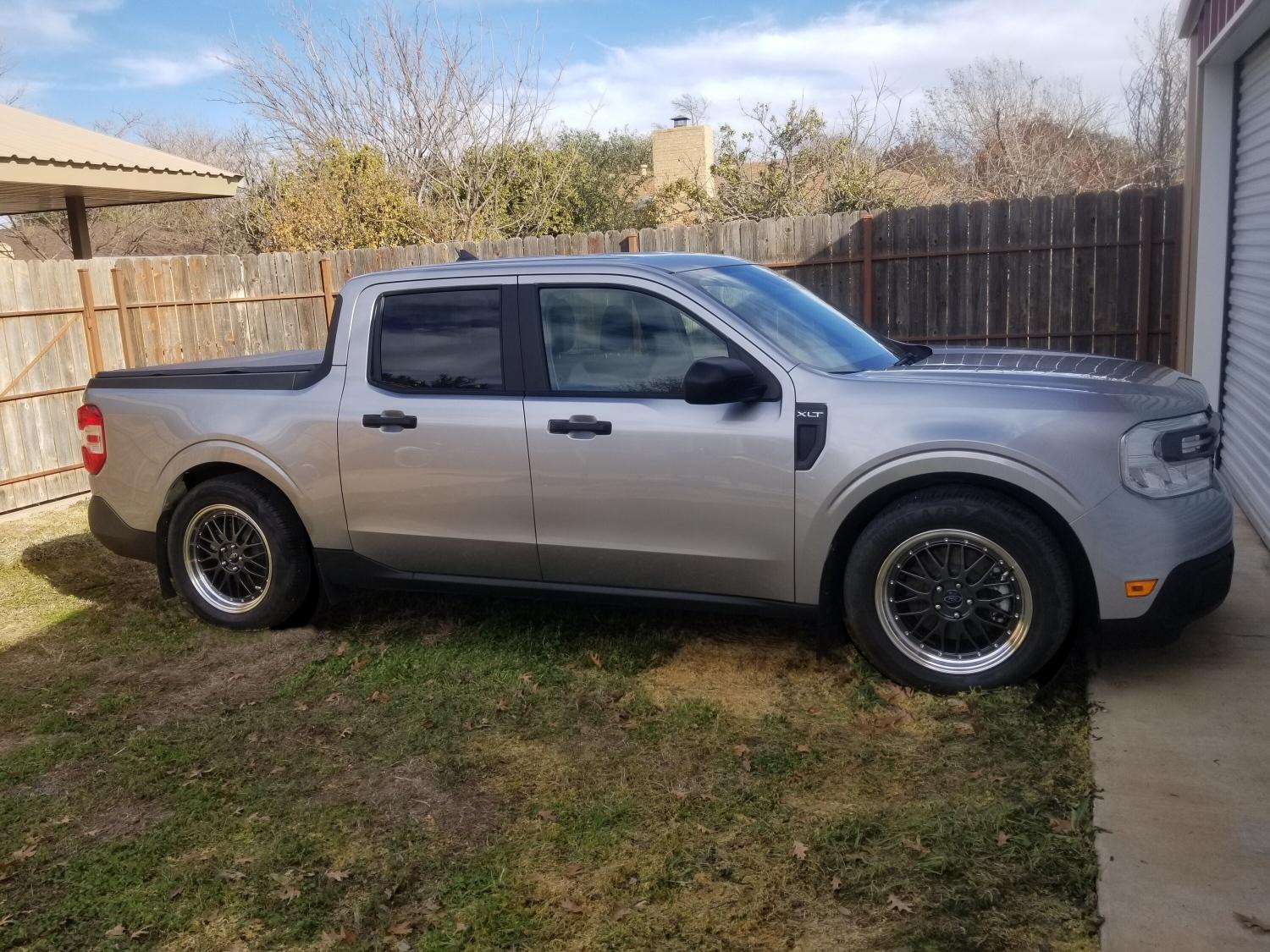

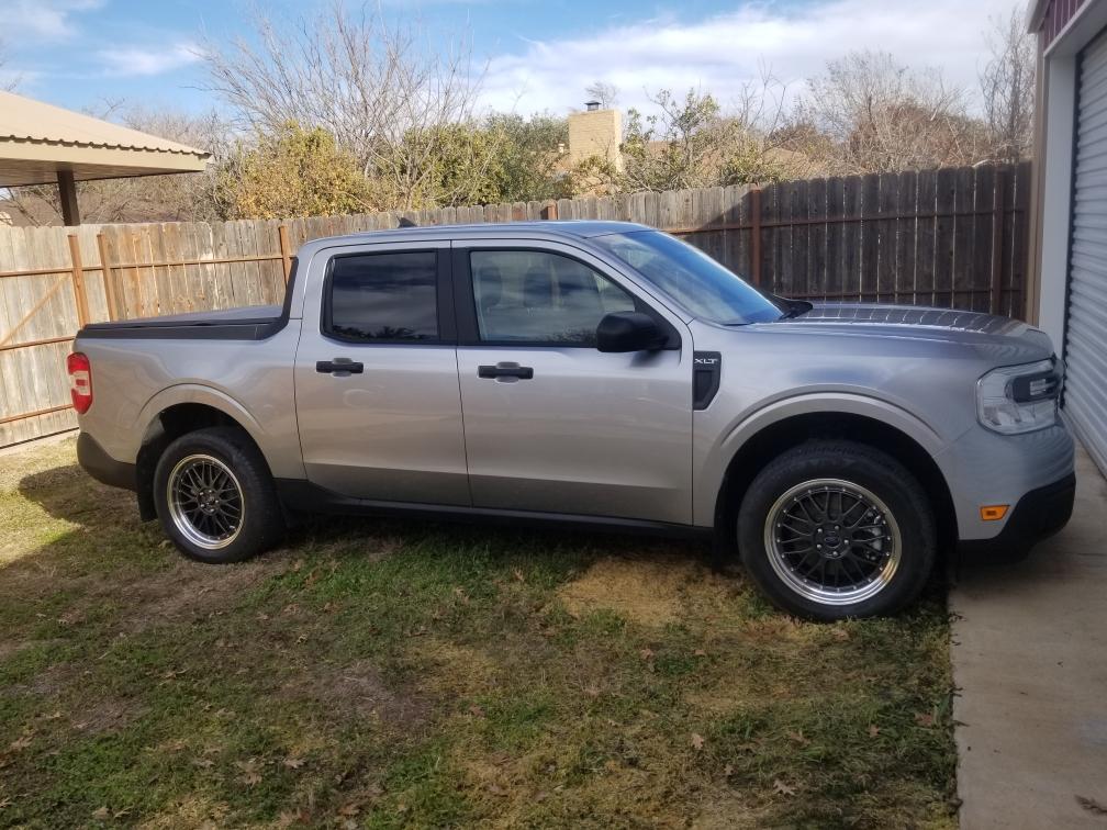

No rubbing at all. Running them on 18x8 circuit performance CP30s with 35mm offset. These are actually Focus RS spec. I plan on installing Eibach drop springs this summer. The second pic was photo shopped. it's not that low yet. Heres pix.How are those 245/55 r18 on your mav? Any rubs? I’m running the stock 225/60 r18 Michelins and been wanting to change them out and had researched tire size the 245/55 r18 is the same overall size as the 225/60 r18 except for the width being about 3/4 inch wider.
