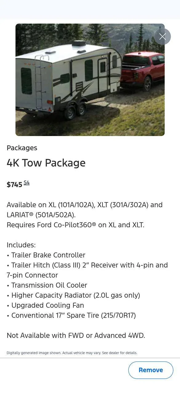

Waste of money! Forced to buy extra copilot package too. Almost $2k of mediocre features, get the FX4!
Not discounting some of the features and advantages FX4 has, it fails miserably for increased towing from standard 2000lbs max.
I disagree that the 4k tow package is mediocre features. The transmission cooler, spare tire, brake controller, 7 pin connector and job 2 backup assist, hitch assist just to name a few. Besides I think the biggest advantage is the different gear ratio that I didn't see for 25 listed. So I googled the response from that search.
360 co-pilot also a big plus which you have not considered the benefits. Also both the brake controller and 7 pin connector making it legal to tow over 2000lbs. Many states require trailer brakes at towing 3000lbs or more.
Ford Maverick With or without the 4K package ??? Screenshot_20250119-213450
Yes, the 2025 Ford Maverick has a different gear ratio when equipped with the 4K Tow Package, featuring a lower axle gear ratio compared to the standard model, typically going from a 3.63:1 ratio to a 3.81:1 ratio, allowing for better towing capability;.
Key points about the 4K tow package gear ratio:
  • Lower gear ratio:
    The tow package includes a lower axle gear ratio, which provides more torque for towing heavier loads.
  • Improved towing capacity:
    This lower gear ratio significantly increases the Maverick's towing capacity.
  • Other features:
    Besides the gear ratio change, the 4K tow package also includes a transmission oil cooler, upgraded radiator, and trailer brake controller.

Google "AI" is wrong.
THERE IS NO GEAR DIFFERENCE BECAUSE THERE ARE NO GEARS
This thread is about the 2025 hybrid Maverick. Hence, same fuel economy on 4K package.
