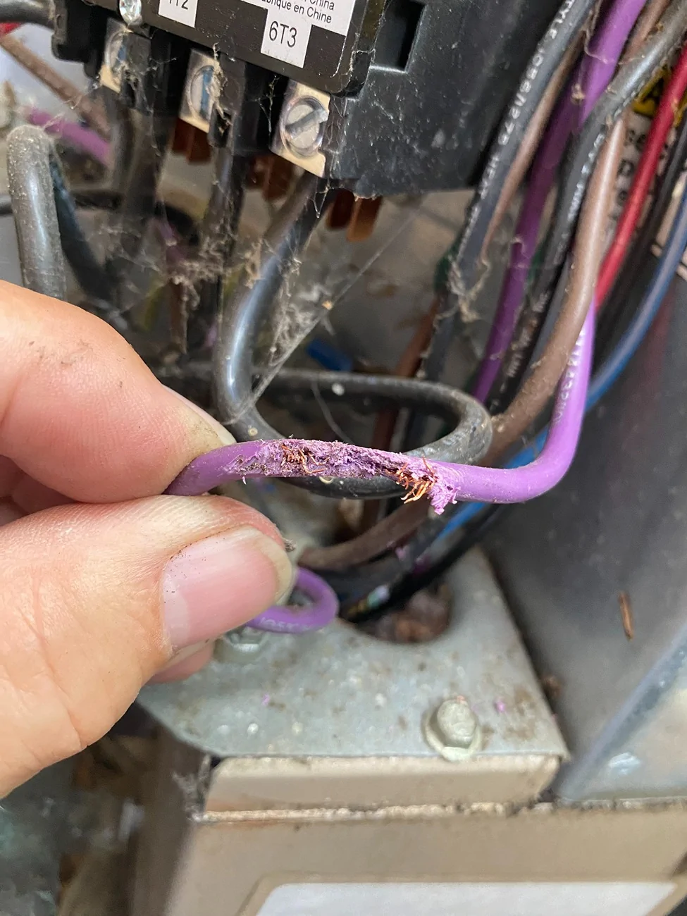

And it's not just limited to automobile wiring. Here's an air conditioner that quit due to mice having a feast on the 480volt 3-phase power. when I repaired this,
Ford Maverick Wire damage from mouse IMG_2203
I didn't find any dead mice .... was a bit surprised.

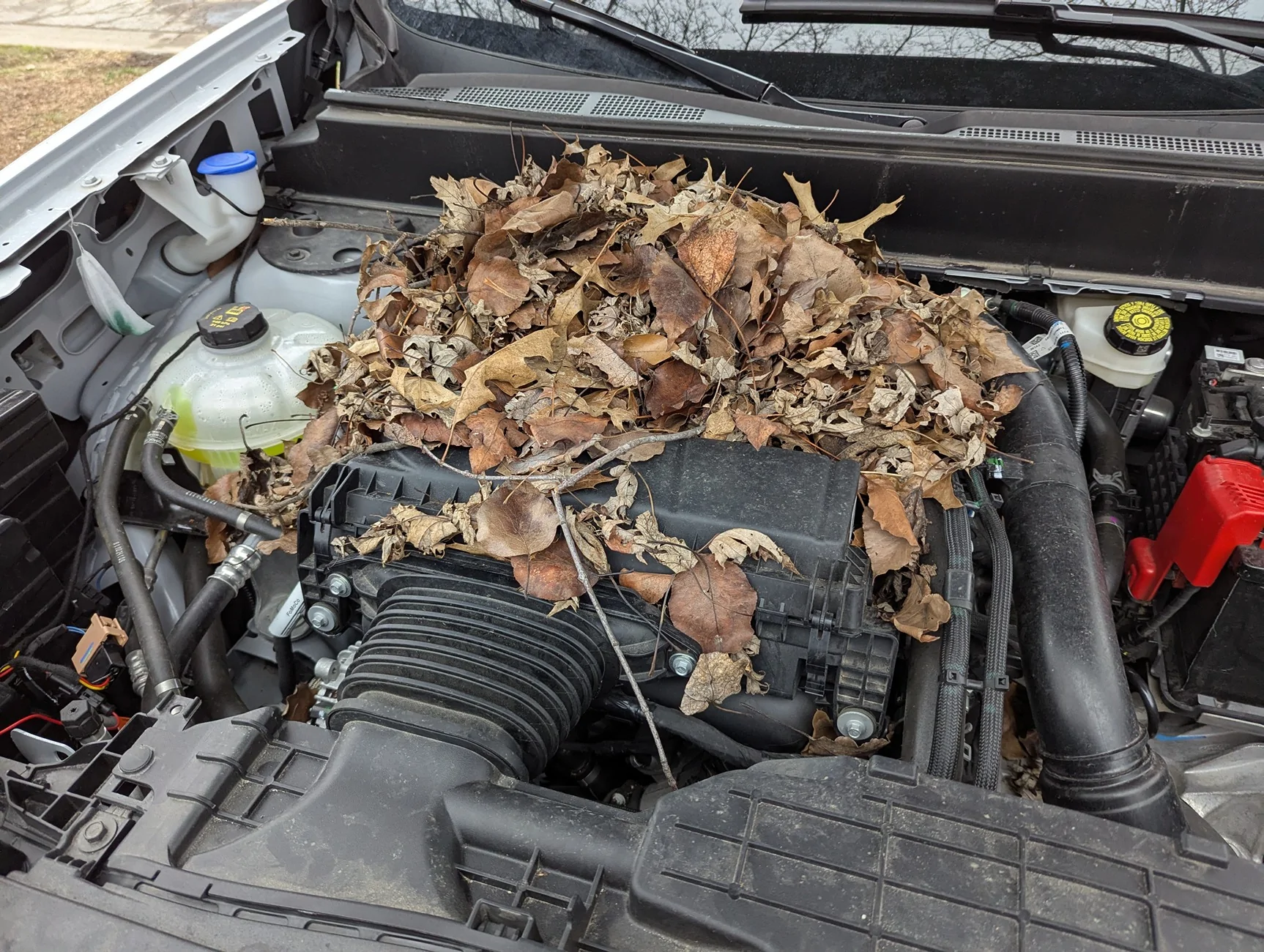

It happened again this time I am sure it was a squirrel. One more trip to the dealership. Put in rodant repellent after the first one. Did not help sprayed the motor area with penetration oil to get rid of there sent and got a trap to catch them. See pics of the nest they built in 10 days.

I did not leave it open. That is what I found when I opened it.
