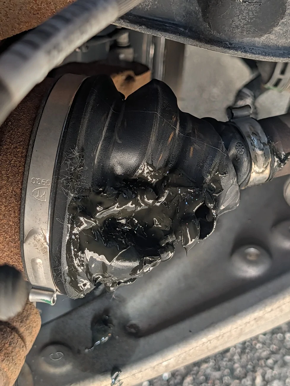

Only the second time my 18yo daughter drove my truck and she steered it into a parked car while turning in. So wheel at open angle toward curb. I was out of the area and just got back today to look. I am assuming catastrophic failure of the front right cv joint and possibly axel. It was towed to shop and they tried to drive it inside today and just got grinding noises so stopped immediately.
What collateral damage should I have them looking for. This is the cv joint.

The whole axle 100% will need to be replaced. I'd also have them inspect the tie rod, lower control arm bushings, and sway bar link.

Inspect the tie rod lower control arm bushings and sway bar link

do you have front frame damage? looks like fender, bumper and grille from photo.
$10,500 seems high
