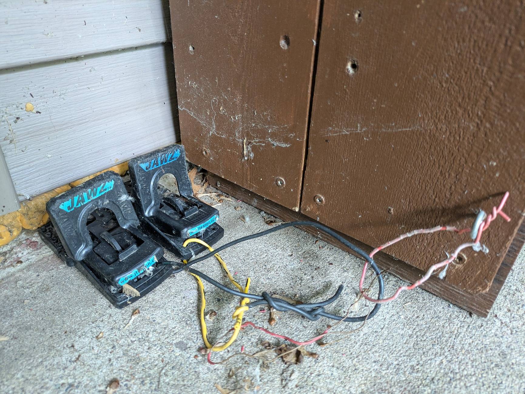

Also need the mechanical units. Live cats have limited capacity. Works best in pairs. The fast rodents will only catch a hind quarter. They will then try to eat the trap and wires to get away. I've had to replace the anchor wires a few times when a trap ran away.
Ford Maverick P0446 Rat Damage PXL_20250722_195951473
